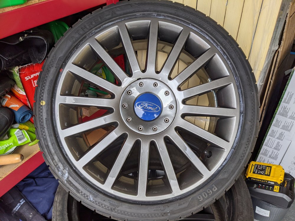

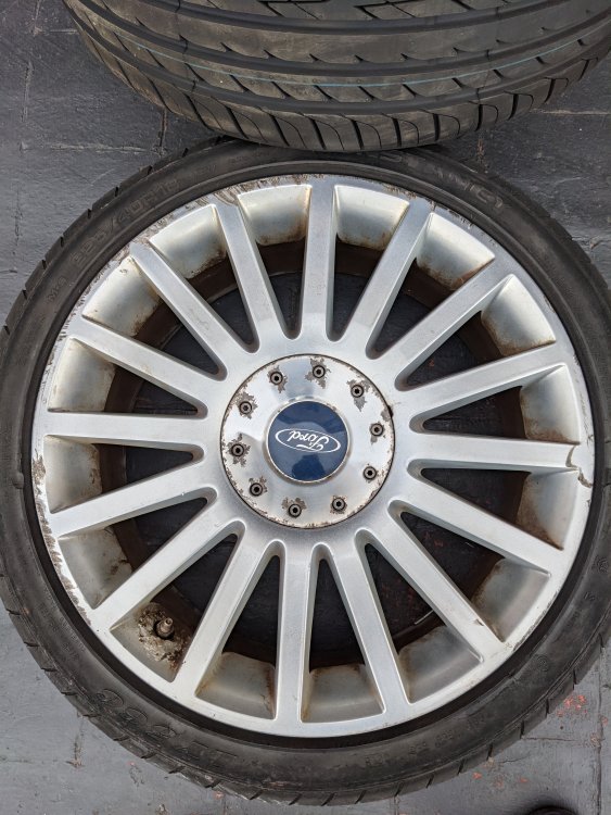

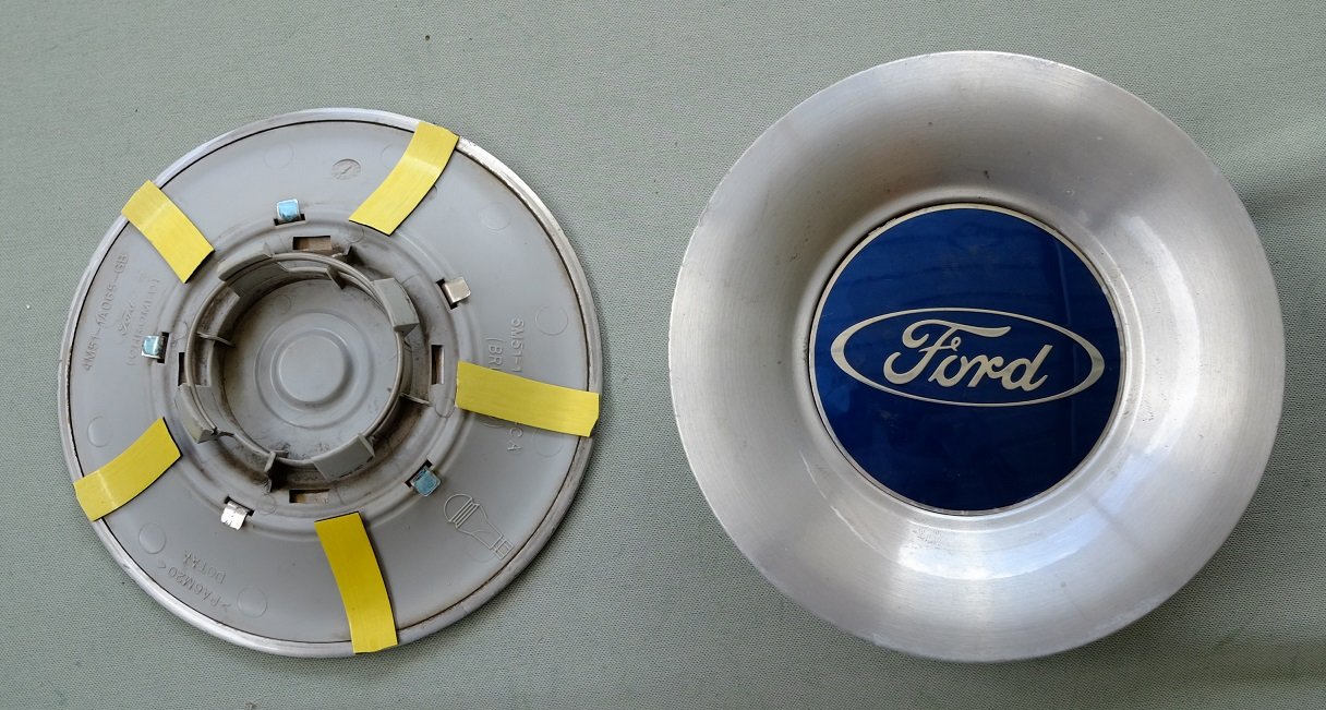

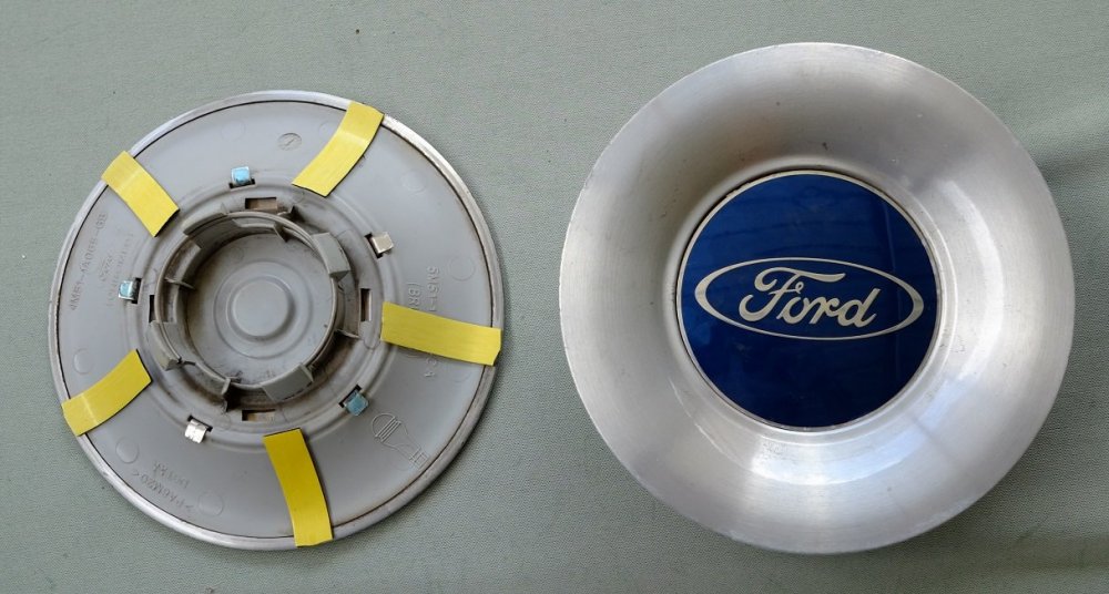

Moderator Rally Pack 2000 Posted December 13, 2021 Author Moderator Report Posted December 13, 2021 The car had a flapping noise from the start which I suspected one of the front tyres as it seemed close to its wear markers so when all the tyres were replaced I expected the noise to vanish and it did for the first day or so but then came back even louder. That tipped me off to what the problem was. All the centre caps were really really loose! Noisy blighters! Expanded the springs and added some cushioning tape should silence the beggars. Wouldn't mind getting some replacement Ford symbols for the centre as a couple of them have faded but most most on Ebay seem to be a tiny 54mm while these Ghia ones are huge! Slowly whittling down the rattles and problems.
DT36 Posted December 13, 2021 Report Posted December 13, 2021 8 hours ago, Rally Pack 2000 said: The car had a flapping noise from the start which I suspected one of the front tyres as it seemed close to its wear markers so when all the tyres were replaced I expected the noise to vanish and it did for the first day or so but then came back even louder. That tipped me off to what the problem was. All the centre caps were really really loose! Noisy blighters! Expanded the springs and added some cushioning tape should silence the beggars. Wouldn't mind getting some replacement Ford symbols for the centre as a couple of them have faded but most most on Ebay seem to be a tiny 54mm while these Ghia ones are huge! Slowly whittling down the rattles and problems Look at one of the site sponsors, DMB Graphics as they do loads of sizes and are good quality. About £20 a set. I've just had a set made at 75mm by a local lad for £15. My original badge was 73mm. My centres are very similar to yours and the pic below shows them stripped down for powder coat as only the outer is metal. I rebuilt the caps, but put Stickaflex between the components before re-assembly. Also look at the rear of the cap and it will have a locating lug that lines up with an indent on your wheel centre. This probably lines up with the tyre valve. Lots of garages/tyre bays don't put the caps back in this position, so they rattle a bit. 1
Moderator Rally Pack 2000 Posted December 13, 2021 Author Moderator Report Posted December 13, 2021 7 hours ago, dt36 said: Look at one of the site sponsors, DMB Graphics as they do loads of sizes and are good quality. About £20 a set. I've just had a set made at 75mm by a local lad for £15. My original badge was 73mm. My centres are very similar to yours and the pic below shows them stripped down for powder coat as only the outer is metal. I rebuilt the caps, but put Stickaflex between the components before re-assembly. Also look at the rear of the cap and it will have a locating lug that lines up with an indent on your wheel centre. This probably lines up with the tyre valve. Lots of garages/tyre bays don't put the caps back in this position, so they rattle a bit. Those are unusual centre caps, what do they look like complete? (Im certain the designer of the Mk2 Rubber rear spoiler had deep workbench shortage issues)
DT36 Posted December 13, 2021 Report Posted December 13, 2021 37 minutes ago, Rally Pack 2000 said: Those are unusual centre caps, what do they look like complete? 1
Moderator Rally Pack 2000 Posted December 13, 2021 Author Moderator Report Posted December 13, 2021 47 minutes ago, dt36 said: Ahhhh now I know the ones, Its funny you need to see them on the wheels to know which they were as off the them they look completely different. Do you find going from your older cars that its touchy off the line? I have been told its just the fly by wire system as opposed to cables but I simply cant get use to it and it surges off the line or just creeps slowly I cannot feather it from the start at all. I dont seem to be improving with time either.

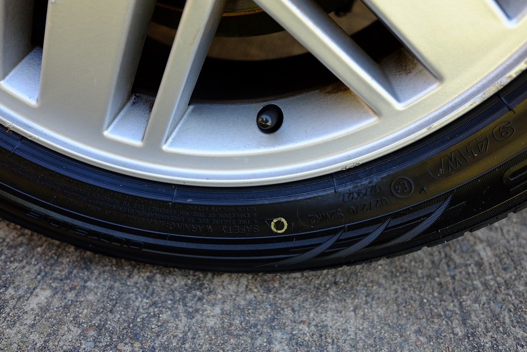

katana Posted December 14, 2021 Report Posted December 14, 2021 (edited) 14 hours ago, dt36 said: Completely off subject but I was always instructed that the yellow dot on the tyre should be located adjacent to the valve as its the lightest point of tyre so fitted at heaviest point of wheel - Discuss? Edited December 14, 2021 by katana 1 1
DT36 Posted December 14, 2021 Report Posted December 14, 2021 (edited) 20 minutes ago, katana said: Completely off subject but I was always instructed that the yellow dot on the tyre should be located adjacent to the valve as its the lightest point of tyre so fitted at heaviest point of wheel - Discuss? Just Googled this and you are correct. I've learnt something here today. The yellow dot indicates the lightest part of the tyre sidewall. On a wheel or rim, the heaviest part is generally the valve stem. During fitting the yellow dot is aligned with the valve stem of the wheel. Having the dot and valve stem in alignment means technicians won't need to use as many balancing weights. Spookily, I messaged the guy that did my powder coat about an hour ago, as I have another wheel I need doing this week, due to recently hitting a pothole disguised as a road. Will let him know about this. Edited December 14, 2021 by dt36 1
BaileyMex Posted December 14, 2021 Report Posted December 14, 2021 2 hours ago, katana said: Completely off subject but I was always instructed that the yellow dot on the tyre should be located adjacent to the valve as its the lightest point of tyre so fitted at heaviest point of wheel - Discuss? Every day you learn something new, cheers!
katana Posted December 14, 2021 Report Posted December 14, 2021 Just thought i'd pass it on - maybe explains why some wheels have soooooo much lead attached. Bike tyre fitters seem anal about getting this right! 3

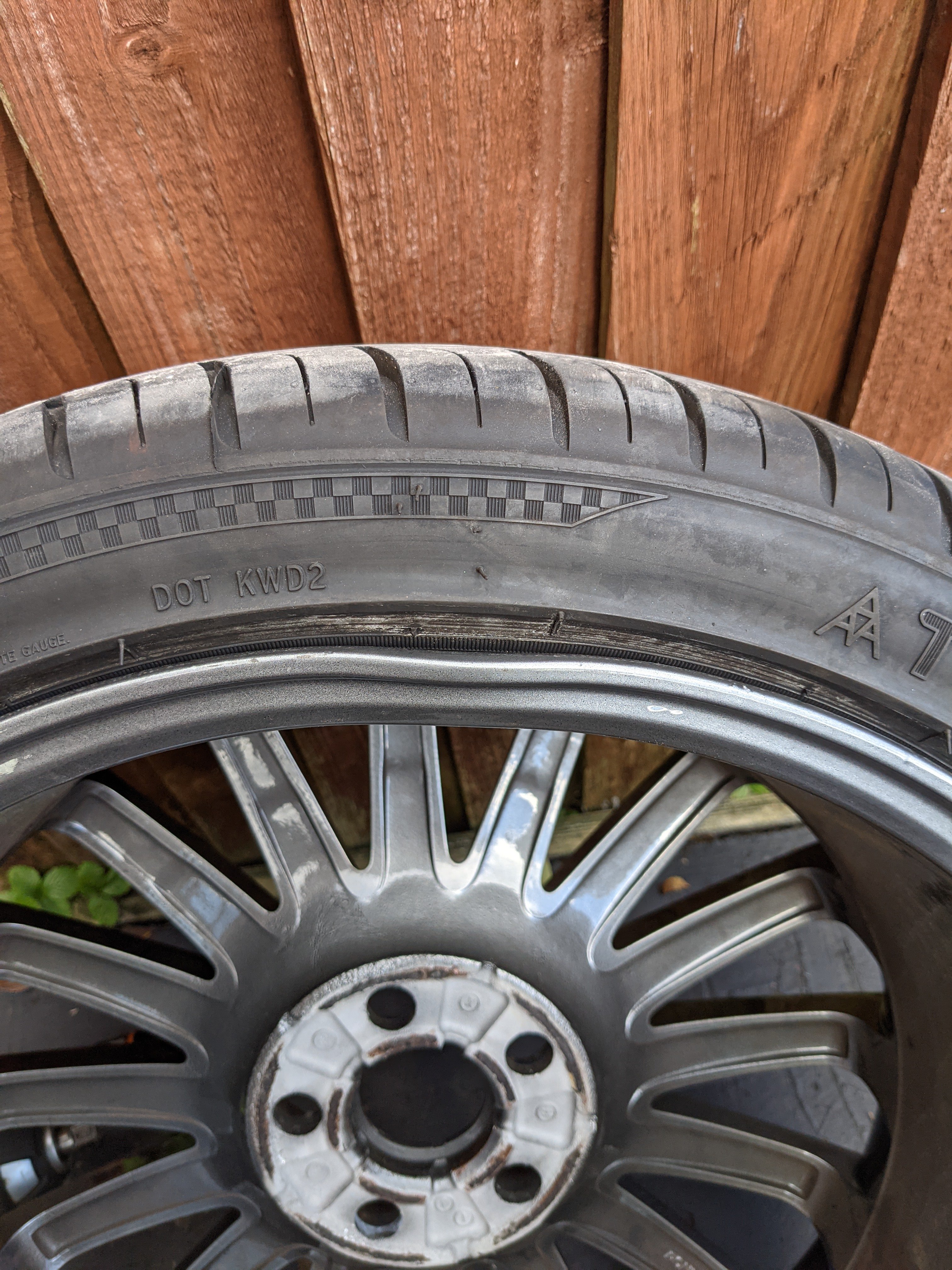

Moderator Rally Pack 2000 Posted December 15, 2021 Author Moderator Report Posted December 15, 2021 16 hours ago, BaileyMex said: Every day you learn something new, cheers! 14 hours ago, katana said: Just thought i'd pass it on - maybe explains why some wheels have soooooo much lead attached. Bike tyre fitters seem anal about getting this right! I didn't even realise they had yellow dots! I never paid that much attention. I just went out and looked at the tyres just put on the Focus last week and sure enough the yellow dot has been aligned with the valve on all 4. Credit to the local mechanic who is not an official tyre retailer as such he just supplies them when needed for servicing and rego checks but he has a wheel balancer and gets his son to put on the tyres and he obviously knew to match the dot and valve. What are the red dots for then? 1
katana Posted December 15, 2021 Report Posted December 15, 2021 The red dot is the opposite of the yellow. Some wheels will be made such that the valve will be positioned to make it the lightest point so the tyre should be positioned red dot / valve. Its confusing as there is no clear identification of what's what with the rims! I can't remember seeing red dots on bike tyres but they are clearly more safety critical for out of balance tyres! 1
katana Posted December 15, 2021 Report Posted December 15, 2021 Also it just occurred to me that the current 'must have' tyre pressure monitors fitted in each wheel will likely also have a balance effect - one would guess opposite the valve would be ideal although usually located on the hub to avoid tyre iron damage!
DT36 Posted December 15, 2021 Report Posted December 15, 2021 39 minutes ago, katana said: Also it just occurred to me that the current 'must have' tyre pressure monitors fitted in each wheel will likely also have a balance effect - one would guess opposite the valve would be ideal although usually located on the hub to avoid tyre iron damage! Just dropped my newly acquired second hand wheel off with Powder Coater during my lunch break and raised the subject. He said he was aware of it, but he found it didn't make any difference to how he balanced tyres up, so doesn't bother now 😁 Cost me £50 for wheel and another £50 to get refurbed. Expensive pothole, but I guess I'm not going out spending my pocket money on any rugby matches and beers again this Christmas 1
Johnny Boy Posted December 15, 2021 Report Posted December 15, 2021 I am not young 😄, and I have always put the red dot to the tyre valve, and not needed to balance. who knows what dot goes where, but I do know that it works for me every time.
