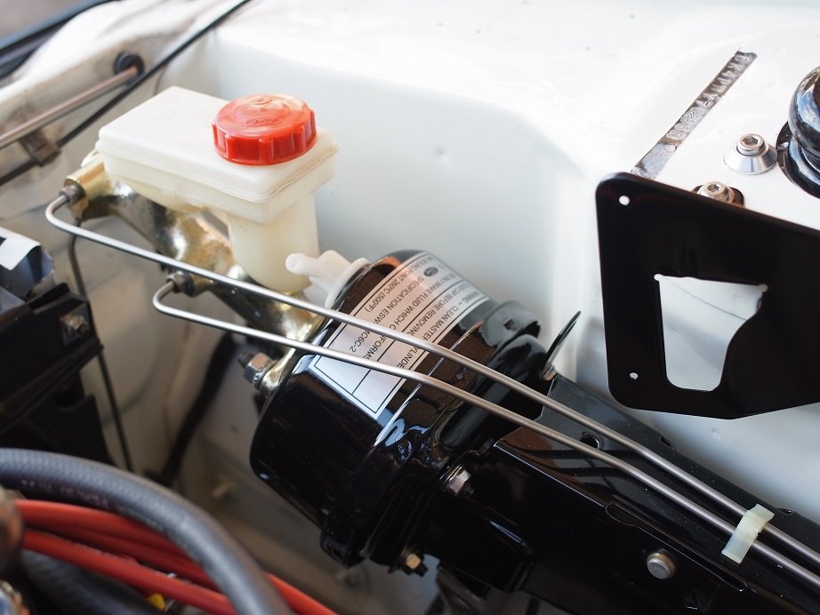

Moderator Rally Pack 2000 Posted March 4, 2022 Moderator Report Posted March 4, 2022 4 hours ago, katana said: Hmmm! Powder coating does involve heating and I'm fairly sure the rubber components won't tolerate much if any! Low temp coatings are possible but usually not very durable. I think I'd rather trust smooth Hammerite and try not to knock it around too much! I had this same issue, having just had the booster rebuilt. I actually had the tower powder coated but used Eastwood Chassis black on the booster itself. It has such a deep shine and slow drying matched up with the powder coating perfectly 1 hour ago, kevs mk2 rs2000 said: cheers exactly what i was thinking but il use upol gloss black As mentioned above I used Eastwood chassis black. In their specs it mention that it has reasonable chemical resistance so I figured that would help with the inevitable fluid leaks. It doesn't like remnants when spraying it on thought. The back deep grove in particular must have been a collection point for stray brake fluid as it took some serious cleaning out to decontaminate. 1 hour ago, colr6 said: You’ll find most of the black components are satin black. That's true most of the blacks are satin black, bumpers, dash and window frames but my original booster and tower were gloss black for some reason. I always thought it was down to a hard coating choice that help repel chemical fluids. It was remarkably resistant to brake fluid actually but I doubt my new paint and powder coated tower will fair as well. I always wondered what the originals were coating in?

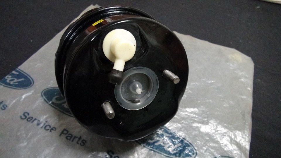

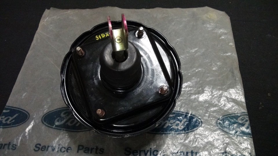

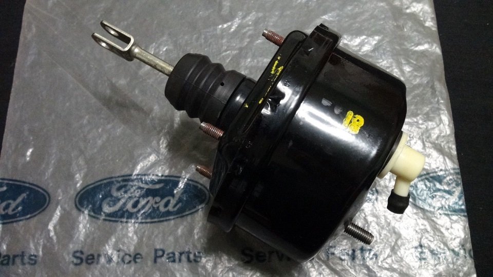

Ray Posted March 4, 2022 Report Posted March 4, 2022 all the NOS servos ive bought for the mk1s, have always been gloss, with the rest of the parts either satin or a mid way between the 2 if you send the servo to someone like past parts for overhaul, they can powdercoat the casings gloss while apart, however it does take a bit of persuading that particular company to do it, because they have to sub contract that part, and they prefer to just paint them in house with normal paint, but it does look well when they do do it
Moderator Rally Pack 2000 Posted March 4, 2022 Moderator Report Posted March 4, 2022 2 minutes ago, colr6 said: I painted mine in what was supposed to be satin black but the supplier forgot to put the matting agent in and the servo/ tower came out mirror finish. If I’d wanted mirror finish I couldn’t have done it better !! Placed it in the engine bay and tbh I thought it looked shite. It was so in your face and just looked wrong in full gloss. It was re painted in satin and to me looks better. If you want a touch more shine you could always wax it to lose a bit of the satin. I think the quick and cheapness of the original paint does give it a gloss shine but because it is done on the cheap its by no means a mirror finish. Im not sure about the European boosters but ours have an instruction decal over the top face so most of the gloss is only seen on the periphery.
Moderator Rally Pack 2000 Posted March 4, 2022 Moderator Report Posted March 4, 2022 3 minutes ago, kevs mk2 rs2000 said: expensive new if you can find one That one was about 300 quid in its box. I was tempted but I had just reconditioned my old one and thought it would have sat on the shelf for decades waiting to be used so decided against it. I saved the photos to remind me what I missed out!

Moderator Rally Pack 2000 Posted March 4, 2022 Moderator Report Posted March 4, 2022 3 minutes ago, colr6 said: That’s not to bad on the gloss side, more of a dim gloss. Mine turned out so shiny you could read the labelling on my wiring harness in the reflection 😳😳😳😳 Mine did too. The powder coating of the tower was pretty good and the Eastwood chassis black was a finer finish than the original giving it a deeper gloss. Once I put the Ford decal on it it wasn't as in your face as there was no area left visible from the top that would give a large mirror finish just minor reflections. Not quite original but reasonably neat all the same. 1
