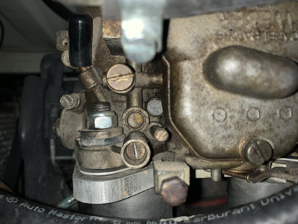

Miniliteman Posted June 14, 2022 Report Posted June 14, 2022 Progression holes have nothing to do with how it's running on idle. For twin 40's I would start with 50F9 's. And ofcourse adjust the mixture screws to get it running smoothly. Can you post a photo of the old type carbs with the plug over the port?
Johnny Boy Posted June 14, 2022 Author Report Posted June 14, 2022 17 minutes ago, Miniliteman said: Progression holes have nothing to do with how it's running on idle. For twin 40's I would start with 50F9 's. And ofcourse adjust the mixture screws to get it running smoothly. Can you post a photo of the old type carbs with the plug over the port? I'll put up some pics tomorrow. The 59F21 , best idle at 2 turns out, with a noticeable drop off 1/4 turn either way. The other jets run lumpy, even with the best mix screw position.
Johnny Boy Posted June 14, 2022 Author Report Posted June 14, 2022 25 minutes ago, Miniliteman said: Progression holes have nothing to do with how it's running on idle. For twin 40's I would start with 50F9 's. And ofcourse adjust the mixture screws to get it running smoothly. Can you post a photo of the old type carbs with the plug over the port? I am aware the progression holes have nothing to do with the idle🙄 😁
Johnny Boy Posted June 15, 2022 Author Report Posted June 15, 2022 Here’s the fitted old 1980s Webers, with a blanking plug over the progression holes, I don’t know how many these carbs have without removing them, but I suspect it’s 3 holes

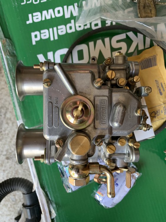

Johnny Boy Posted June 15, 2022 Author Report Posted June 15, 2022 Here’s the Reedmoral replica Weber, brass top removed , and 3 progression holes.
Johnny Boy Posted June 15, 2022 Author Report Posted June 15, 2022 Here’s a pic of the Reedmoral 40 DCOE

Miniliteman Posted June 15, 2022 Report Posted June 15, 2022 It does idle very well on the F21's. Never seen or heard of "Reedmoral" DCOE replica's.
Johnny Boy Posted June 15, 2022 Author Report Posted June 15, 2022 (edited) 42 minutes ago, Miniliteman said: It does idle very well on the F21's. Never seen or heard of "Reedmoral" DCOE replica's. That are made by a big carburettor factory in china, called Lantech. they are very nicely made, not cheap looking like the “no make” ones. I bought them as a back up set 😀 Edited June 15, 2022 by Johnny Boy
