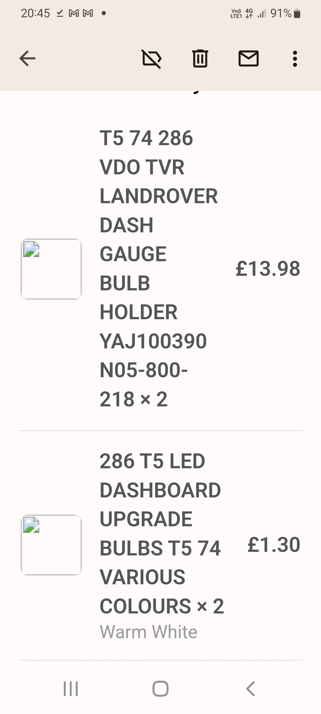

If any of the bulb holders are  dodgy you can get good replacements from Autosparks - see pictures.
You have to do an earth wire to a screw on the clocks as they don't have the brass clip but they are an easy job.
