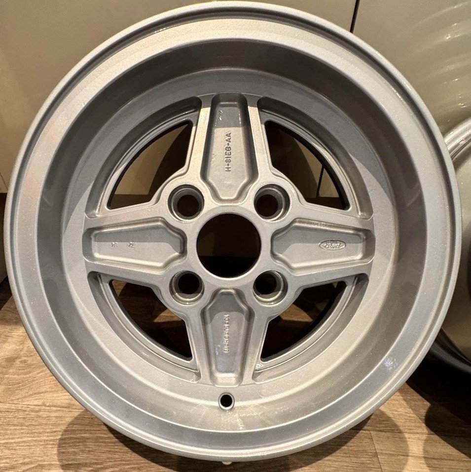

venetian-red Posted October 14, 2025 Report Posted October 14, 2025 Morning all; I know this has been talked about before, but are these wheels here genuine RS alloys, or just 'Capri' please?
Miniliteman Posted October 14, 2025 Report Posted October 14, 2025 (edited) (Early) Ford RS wheel made by GKN (not Ronal not ATS). Not a Capri Laser wheel (that has a 81EB code). Edited October 14, 2025 by Miniliteman 1
venetian-red Posted October 14, 2025 Author Report Posted October 14, 2025 So, if they are GKN, that's the main way to identify?

YellowTaxi Posted October 15, 2025 Report Posted October 15, 2025 Easiest way to spot Lazer wheels at a glance is are by the circular casting around the bolt holes, twice as thick on Lazers. 1
Miniliteman Posted October 15, 2025 Report Posted October 15, 2025 The Mk2 GP1 RS wheel also has the thicker webbing. 1
venetian-red Posted August 18 Author Report Posted August 18 These are Lazer wheels guys? From what you say above, I think the casting around the bolt holes is thicker and Ford markings on them? Thanks again.
venetian-red Posted August 18 Author Report Posted August 18 Thought so, thank you, much appreciated.
