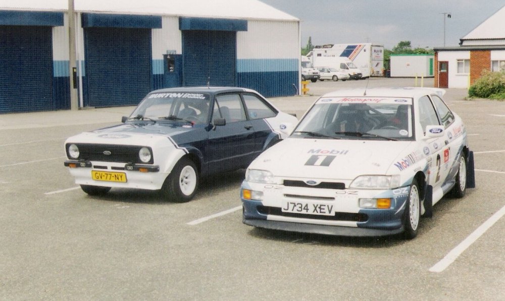

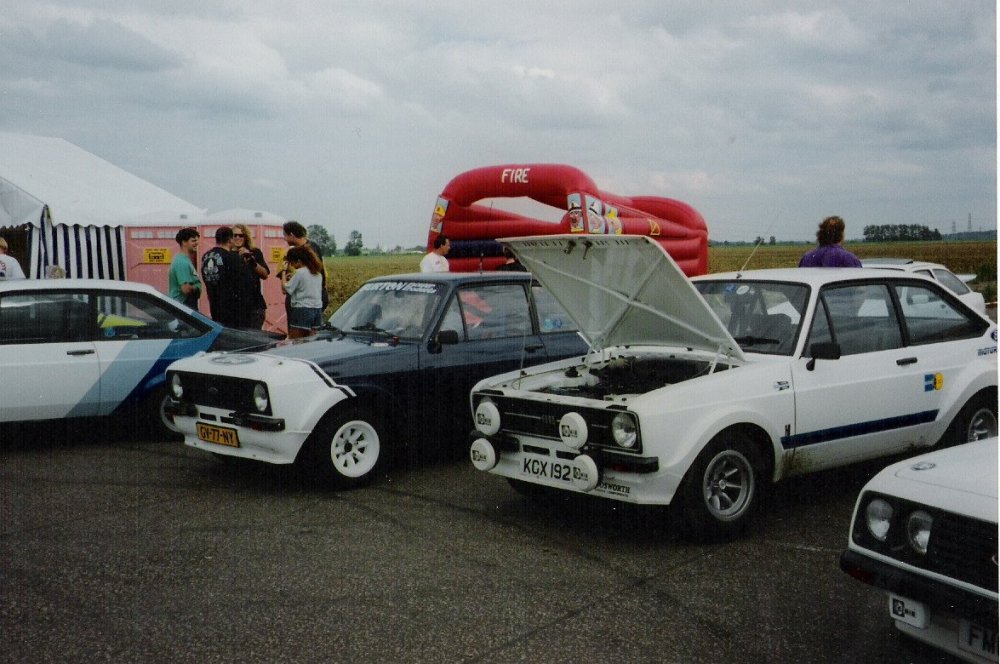

  15. In the early 90's we (every year) went for a day out in the Mk2 visiting the Essex RSOC regional day at Boreham. Night ferry on Saturday from Hook of Holland to Harwich, 7am arrival on the Sunday in Harwich. Short drive to Boreham for the event. This is 1993 when the Escort RS Cosworth just had arrived. At the end of the day back to Harwich for (again) the night ferry back. Back at work at 9am on the Monday !
