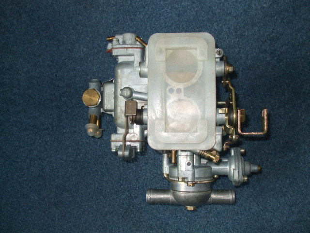

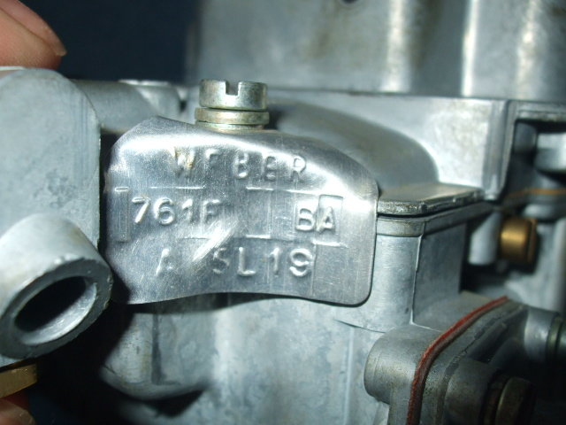

  13. Hi, Lots & lots of interest in the carb, the little aluminium tag has 761F BA now that comes back as a 32/36 DGAV 5D carb, but this carb on the bottom edge has stamped into it 32 DGAV 5 D and it deffo has 32mm throttle butterflies, I have a 32/36 Weber off my from new 1600 Escort MK2 Ghia Auto, the tag on that is 771F CA and that comes back as a 32/36 DGAV, the throttle butterflies on that are one of 32mm & one of 36mm. It has 2 diaphragm's on it, one mechanical via a lever, the other is a vacuum operated one, and I think that is the Anti-stall device. I assumed that all 32mm twin chokes were intended for 1300 Crossflows, and all 1600 GT Crossflows and GT spec 1600/2000 Pinto had 32/36 and jetted as per engine. Any how, I have added some pic's. Ford used so many variations on carbs, it is very confusing. Al.
