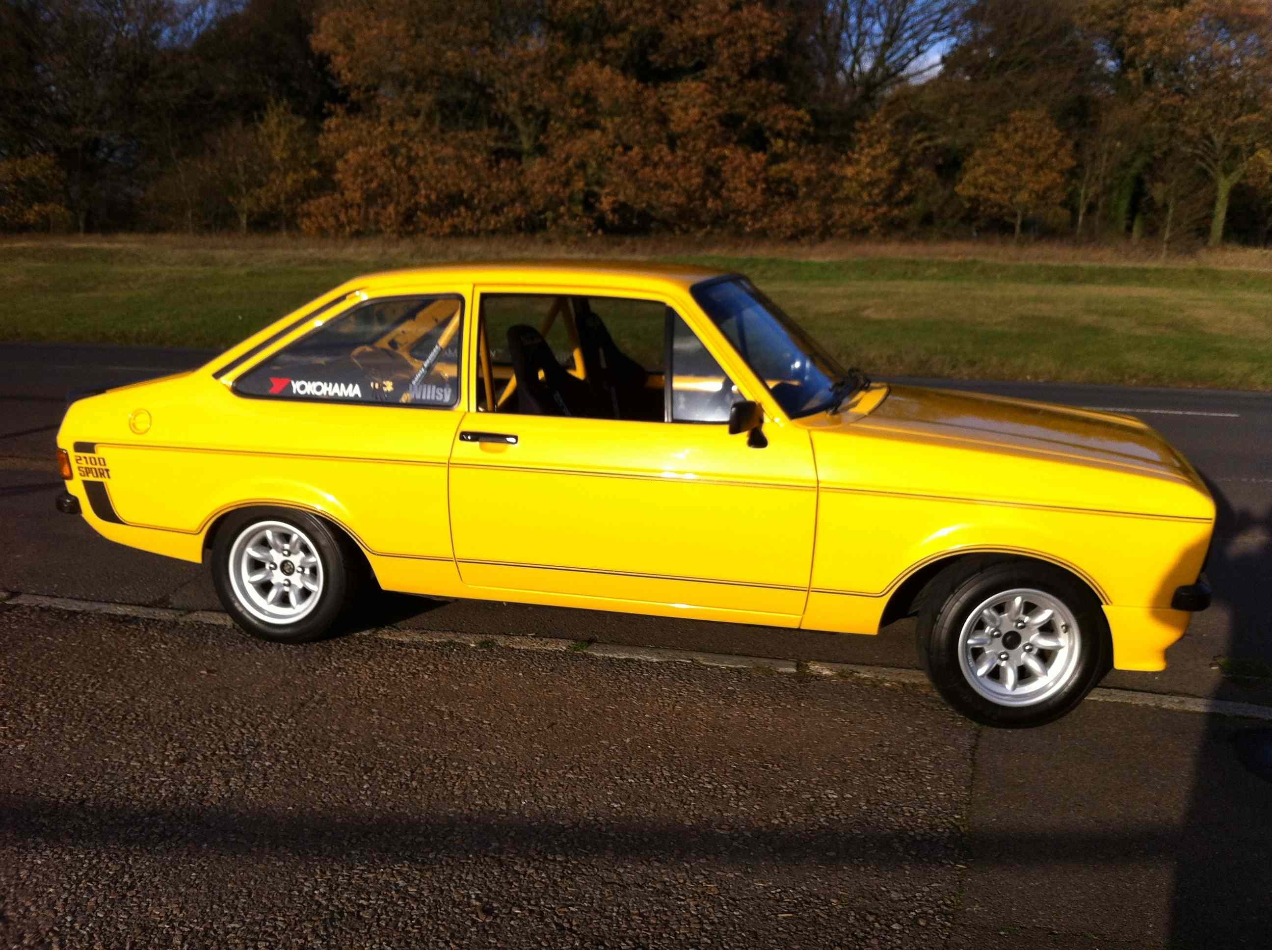

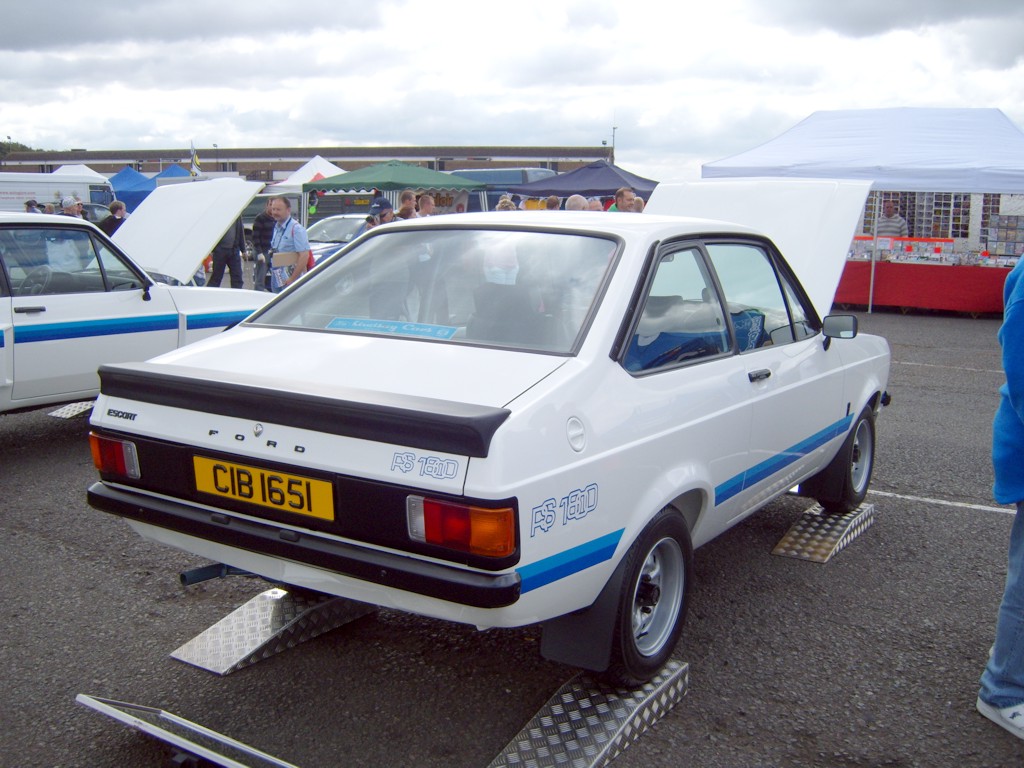

I recently bought a mk2 Escort 1600 2 door.
Im thinking about either a 1600 Sport replica or a Mexico replica,
Im getting the car delivered this week and cant wait to get to work.
If anyone could give your opinions on what you think are the best looking Mk2's or post some pics for inspiration because at the moment i have too many ideas in my head for my first project!
thanks

Thanks for the replies, One of my ideas was a red mexico although with a black bonnet. I once saw a Dark gray harrier with the black and white decals instead of the blue and that looked nice.
Welcome to the site Brett
You have a blank canvas there bud, spend a while on Google images and the gallery on here and I'm sure you will get inspired
