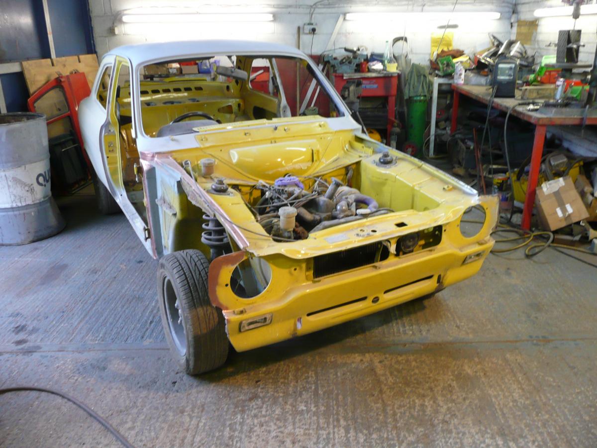

This is my MK1 Mexico after 3 and a half years after i have finished a full restoration . the photos are from when i first saw Mex in a corner in a local bodyshop to just after the Mot in october 2016. it has been a joy to do and its my first Ford motor i have owned in 36years of driving , just goes to show your never too old !!!.
Looking at the pics the panel work looks absolutely mint, a very proffesional job. Should be proud to own that one. Maintaining that sort of standard throughout the build it will be one Beutiful car when done. Top marks

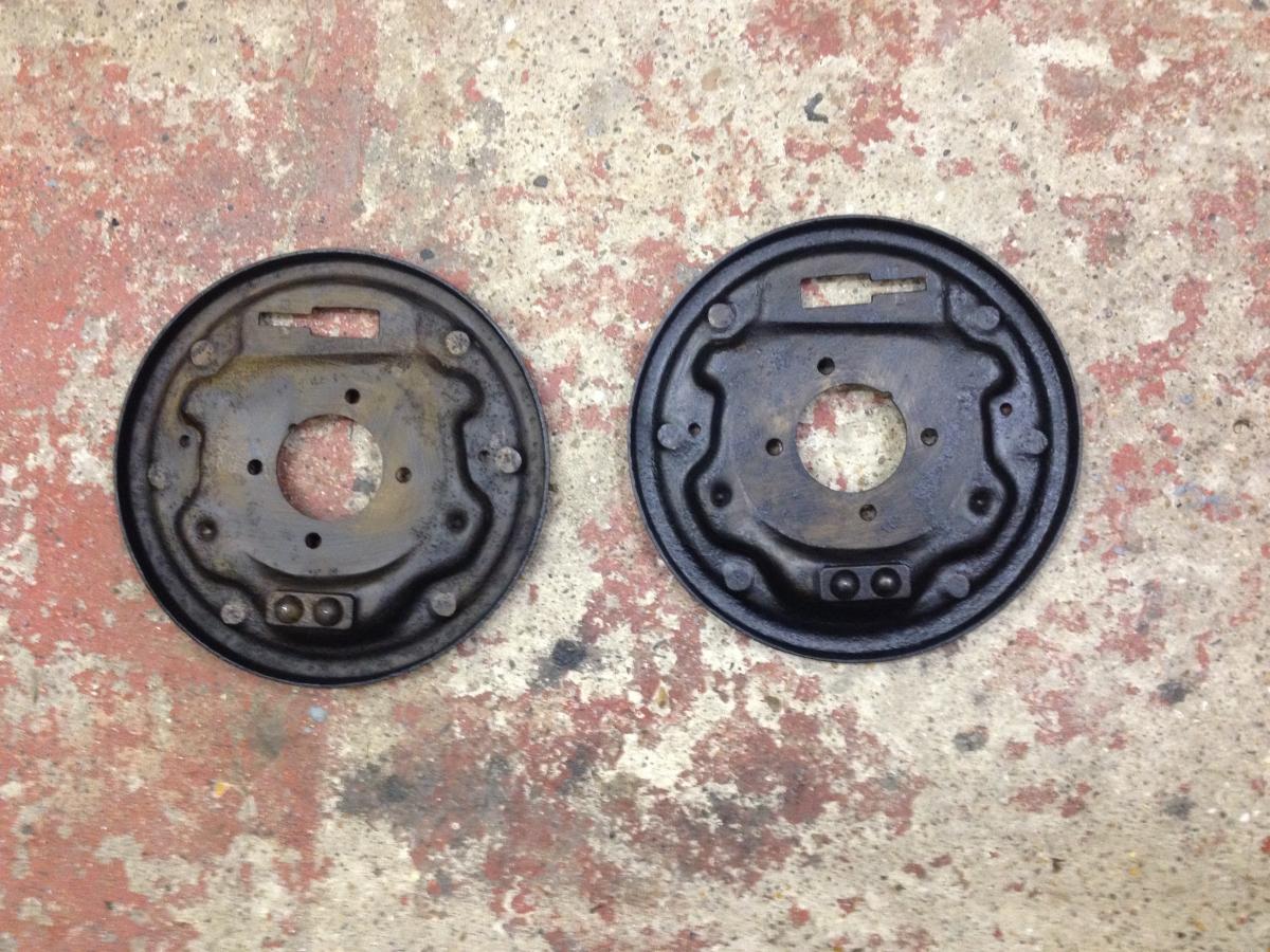

drivetrain was completely stripped and overhauled . gearbox had new main shaft and all  bearings, seals gaskets were replaced . it came with Milton race short shift  already fitted , so I left that and re engineered a standard Mexico gear knob to fit the thread, to keep the original look ,The standard back axle came with virtually a brand new  TranX plated LSD already fitted , I had this reset by Jwe Engineering in Bexley , as when I took it out of the axle it was very notchy and didn't feel right . I checked the half shafts for concentricity and fitted new RHP bearings and seals, the axle was then reassembled with overhauled diff . the propshaft was treated to new UJ's and professionally balanced,all the brake components were replaced with new parts except the shoes as these were virtually brand new , and the original 9" drums as these were well within limits of spec. all parts were shot blasted and repainted .

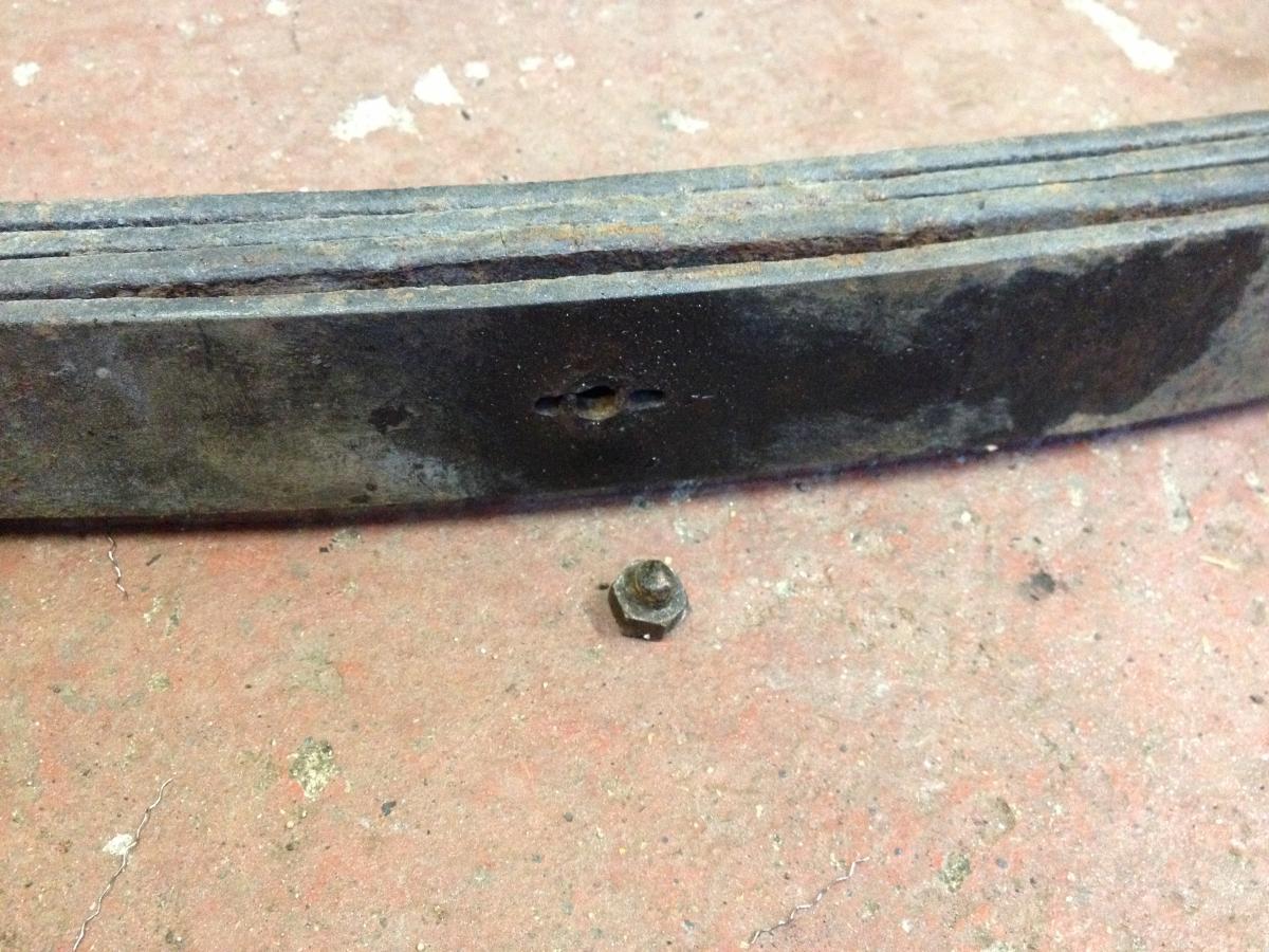

I had to replace the  rear leaf springs as the  originals fell apart when I took them off the back axle ,the  front struts were also overhauled , I used new gaz strut inserts instead of the oil filled originals ,I had to machine the new locking nuts to suit the original strut casing to stop the insert moving also made a small sleeve with a groove in it  to fit over the outside diameter of the insert and the inside diameter of the strut tube  at the bottom , all worked well with a bit of oil in the tube when assembled as well .  I fitted Gaz rear shock absorbers too .Again everything was shot blasted and repainted .
