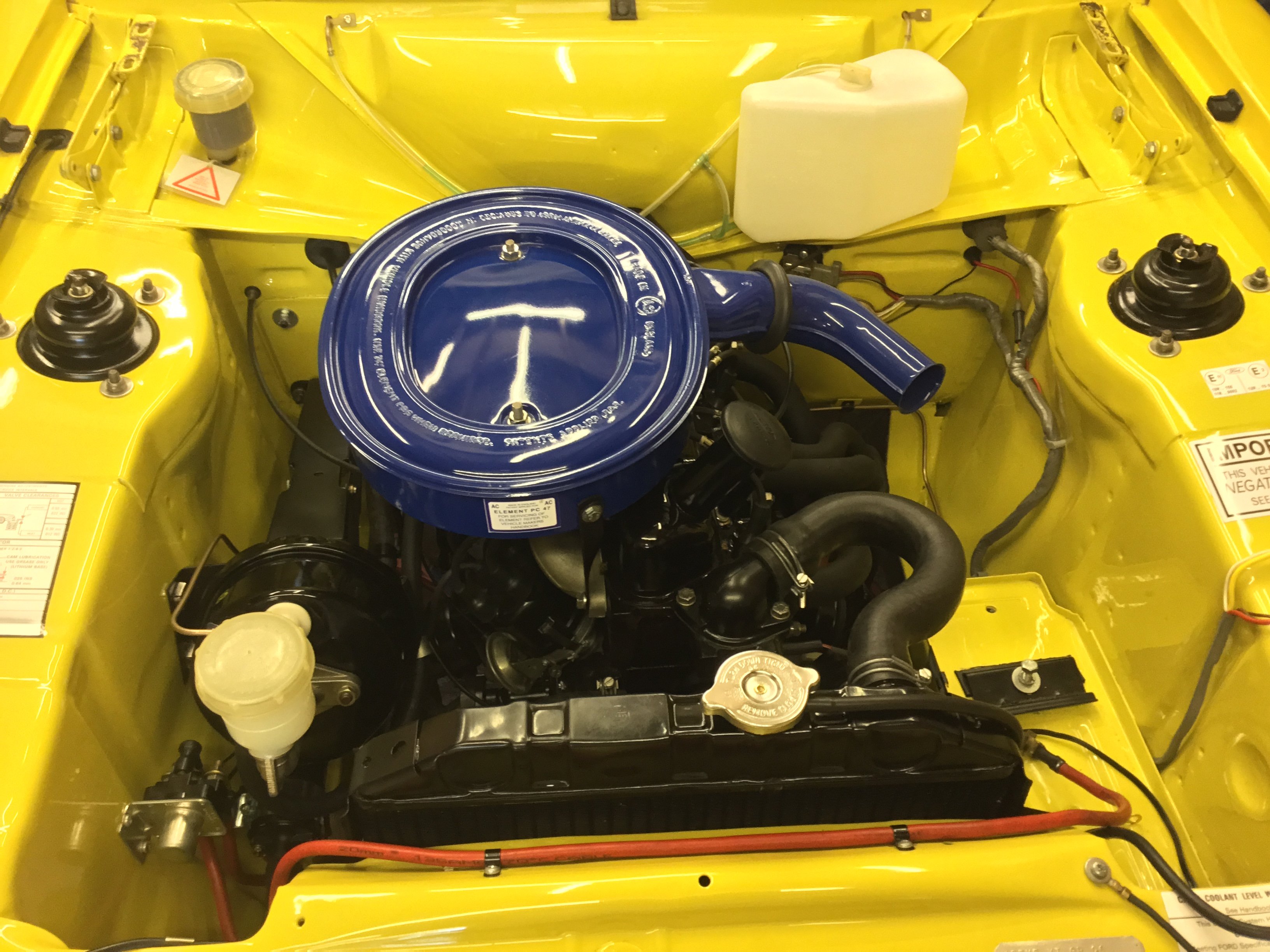

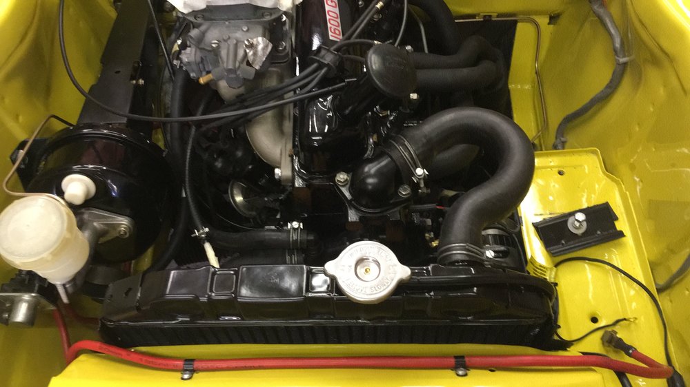

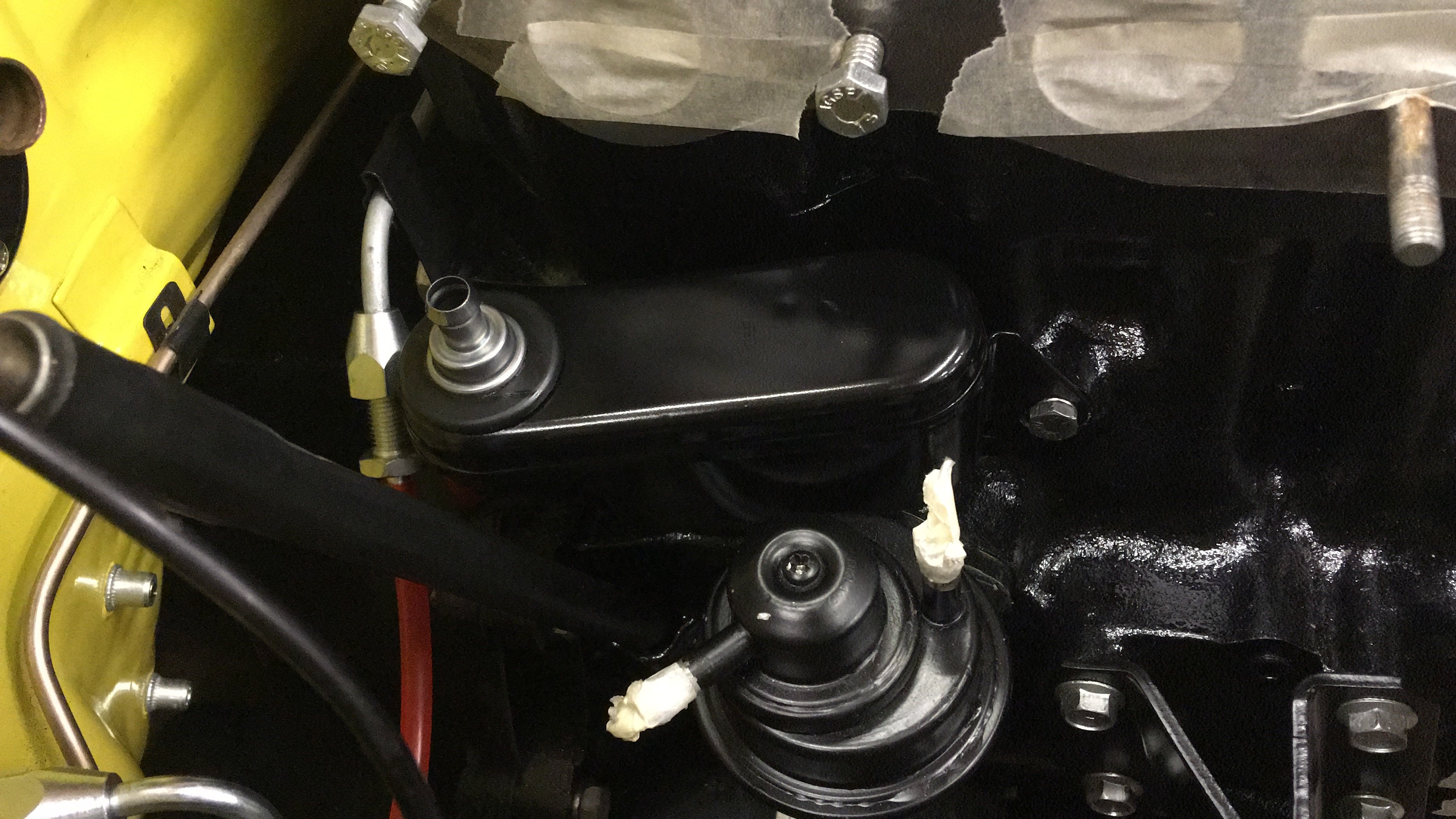

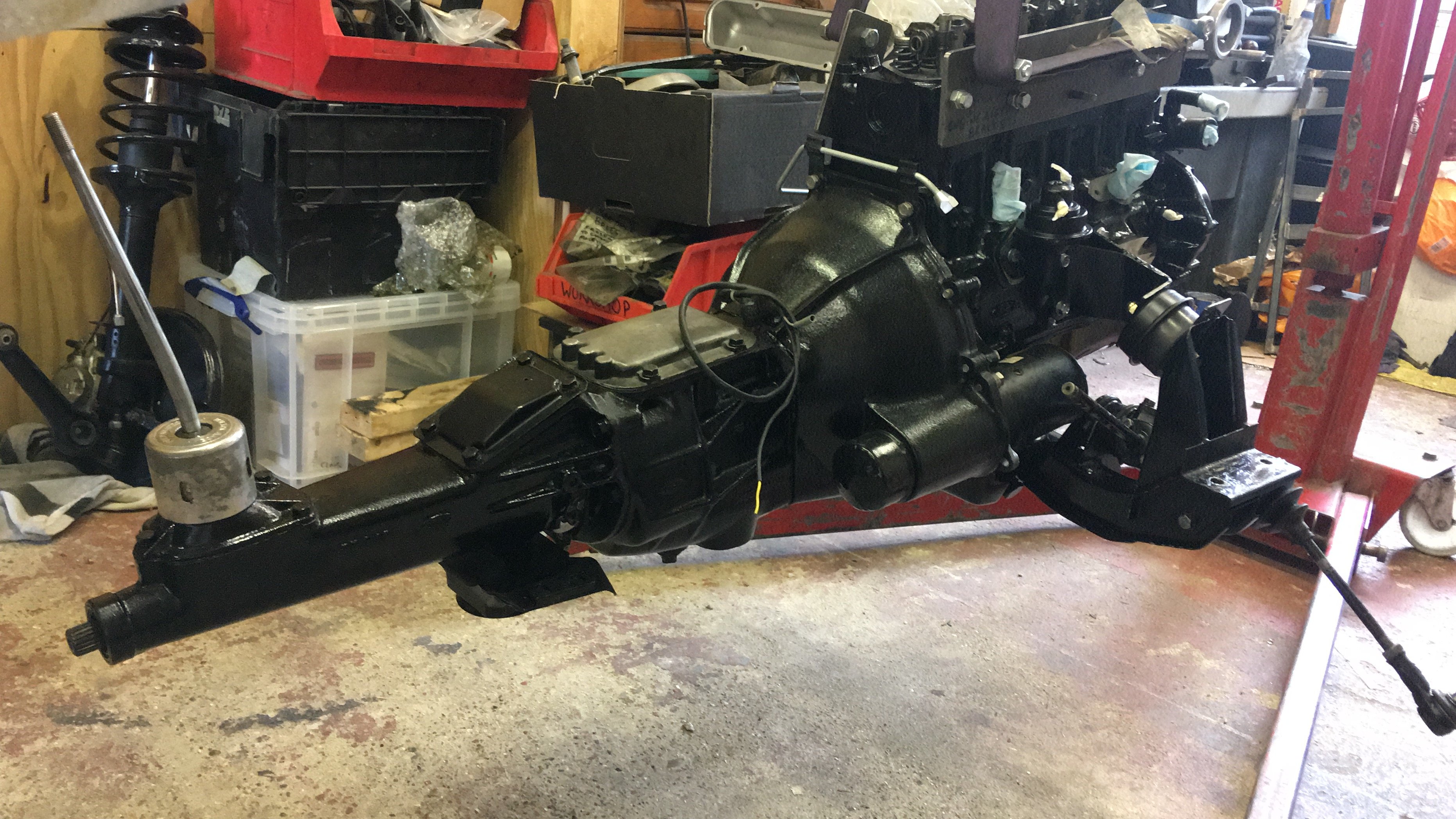

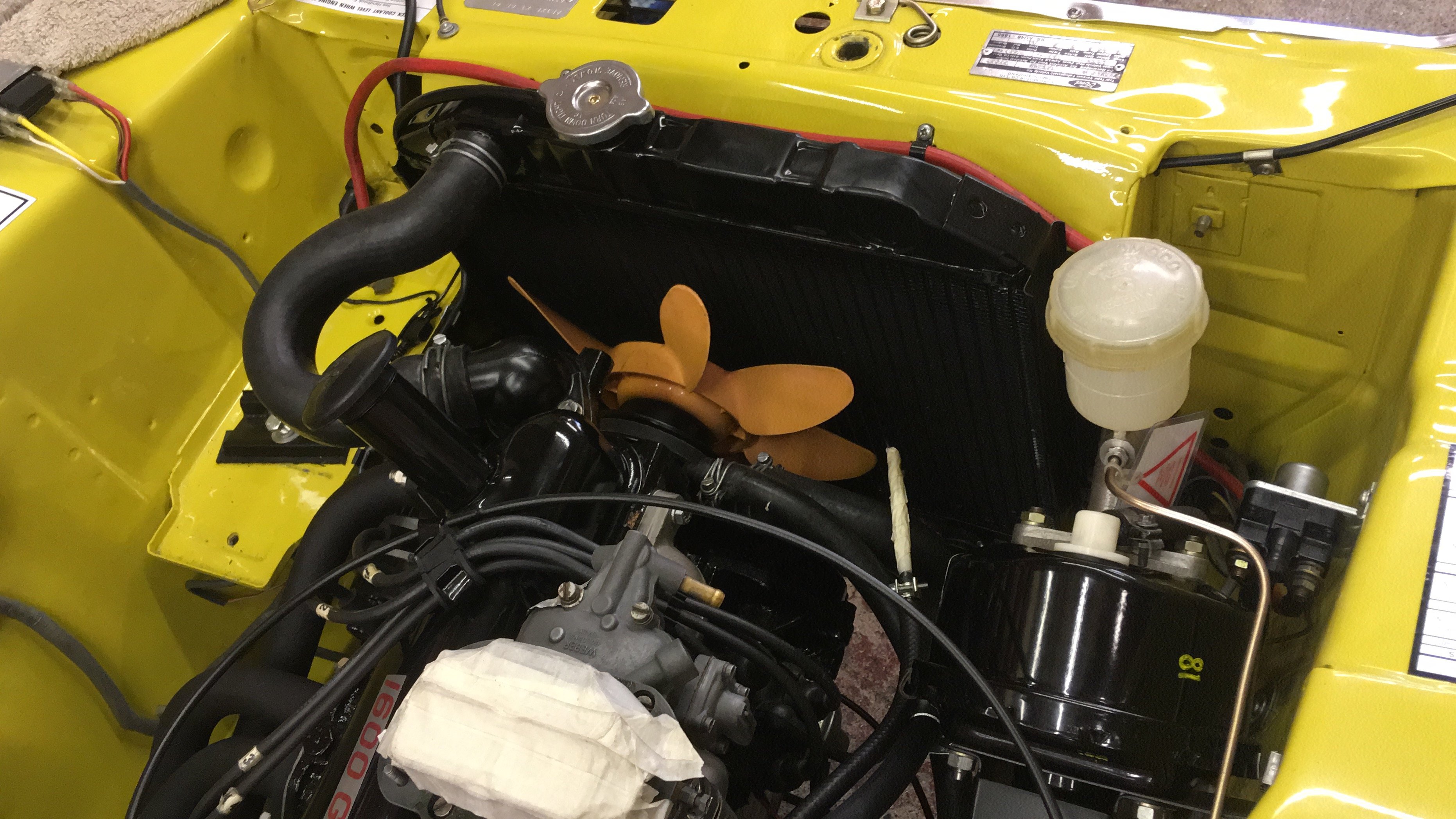

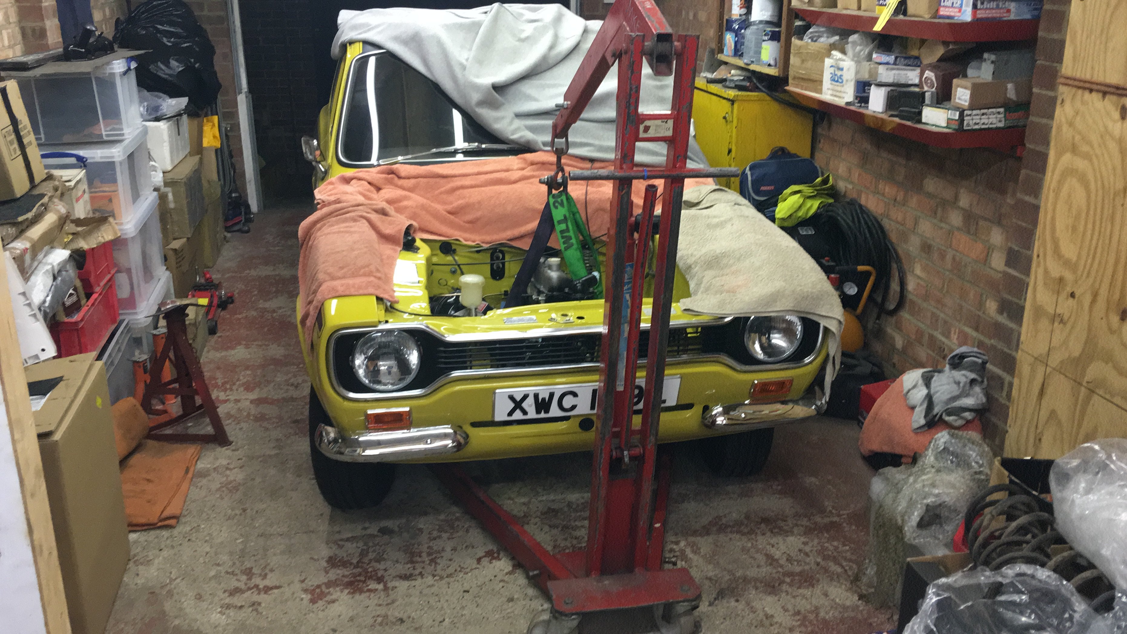

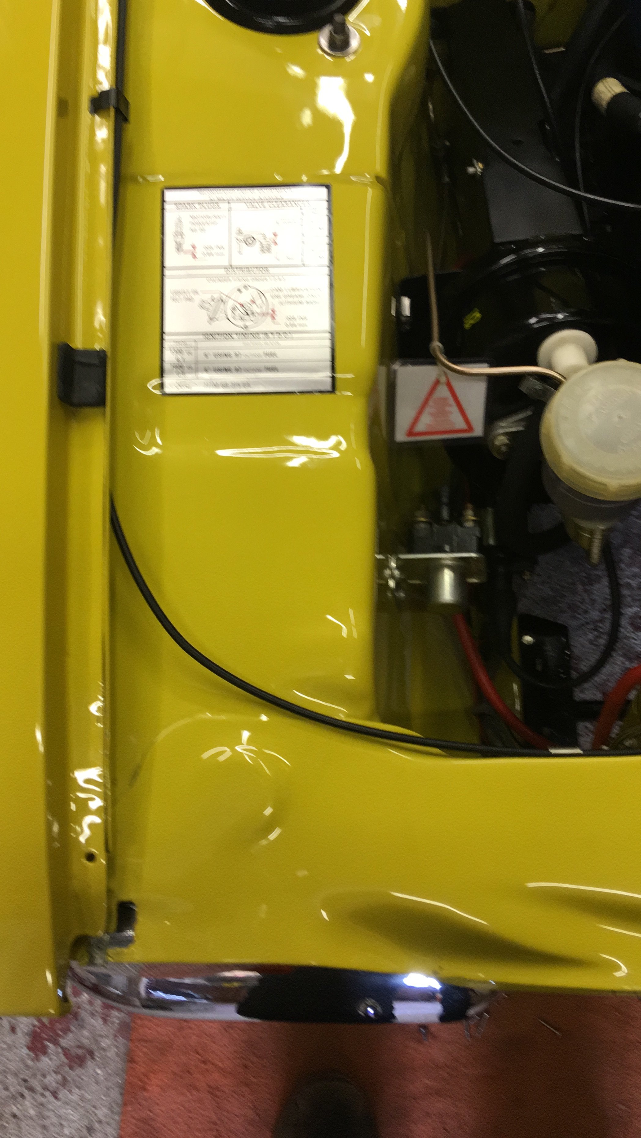

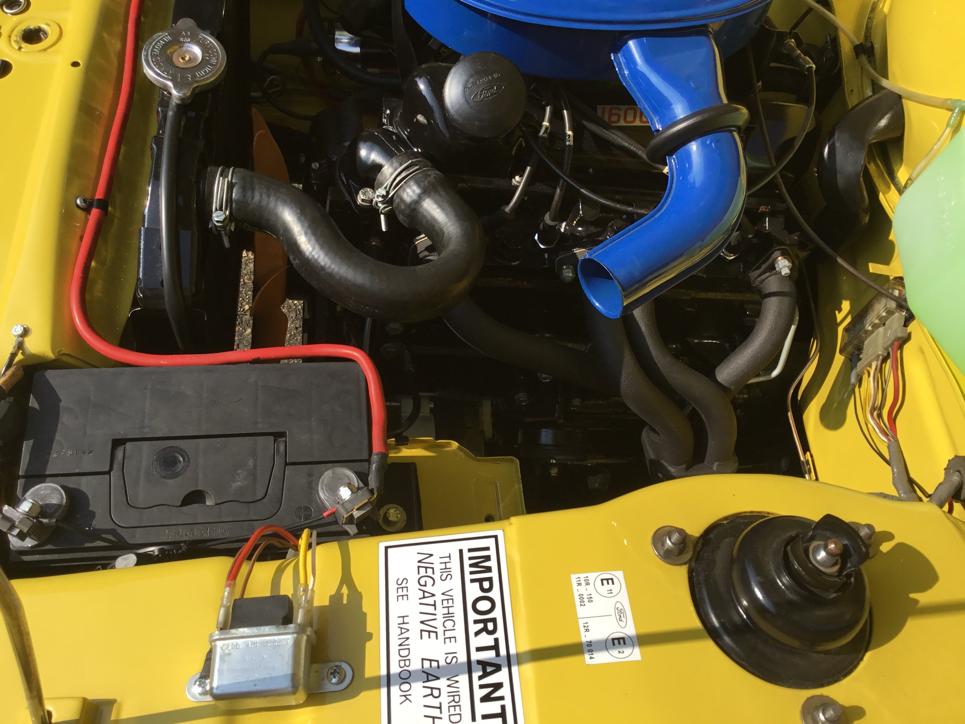

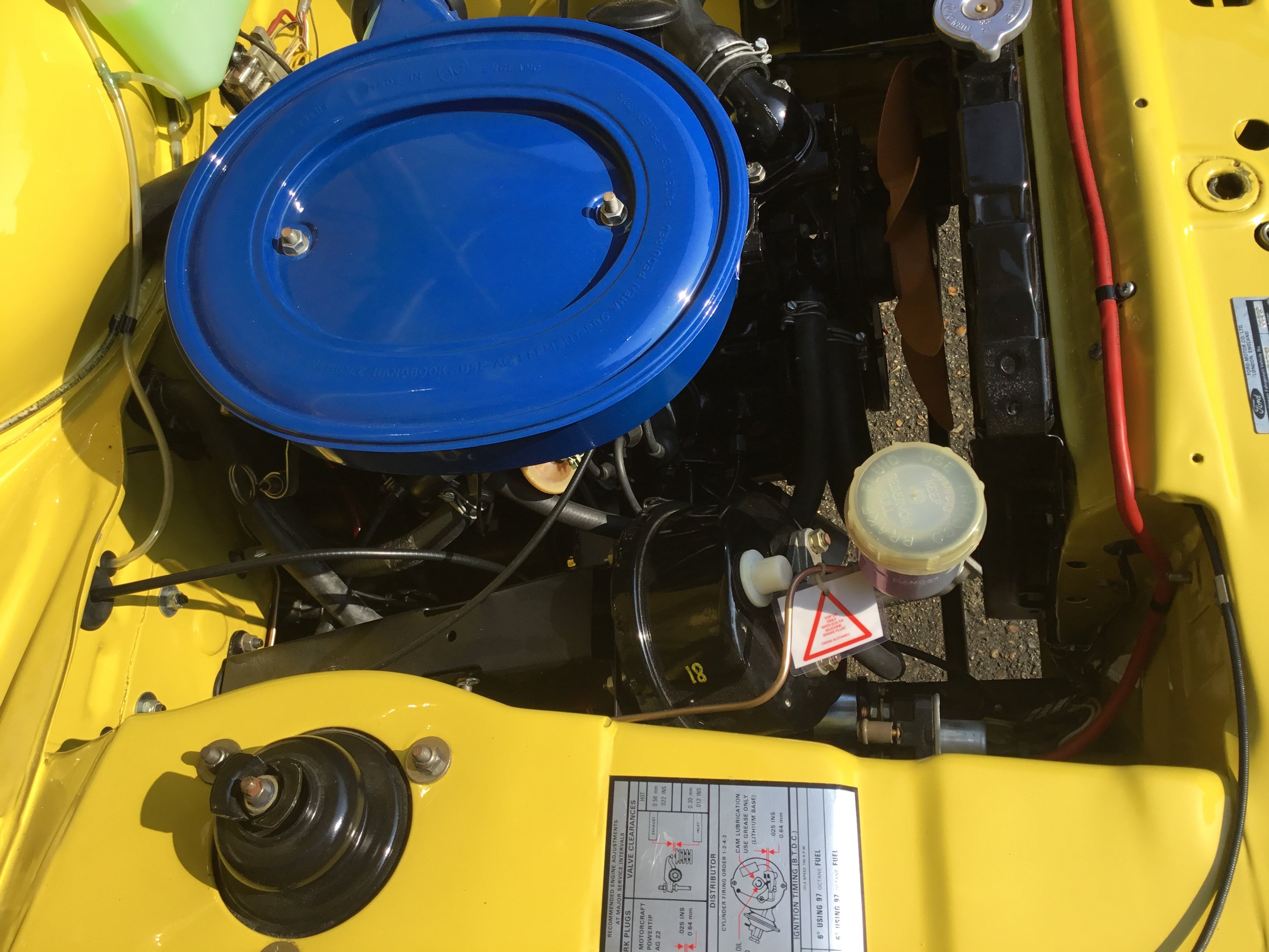

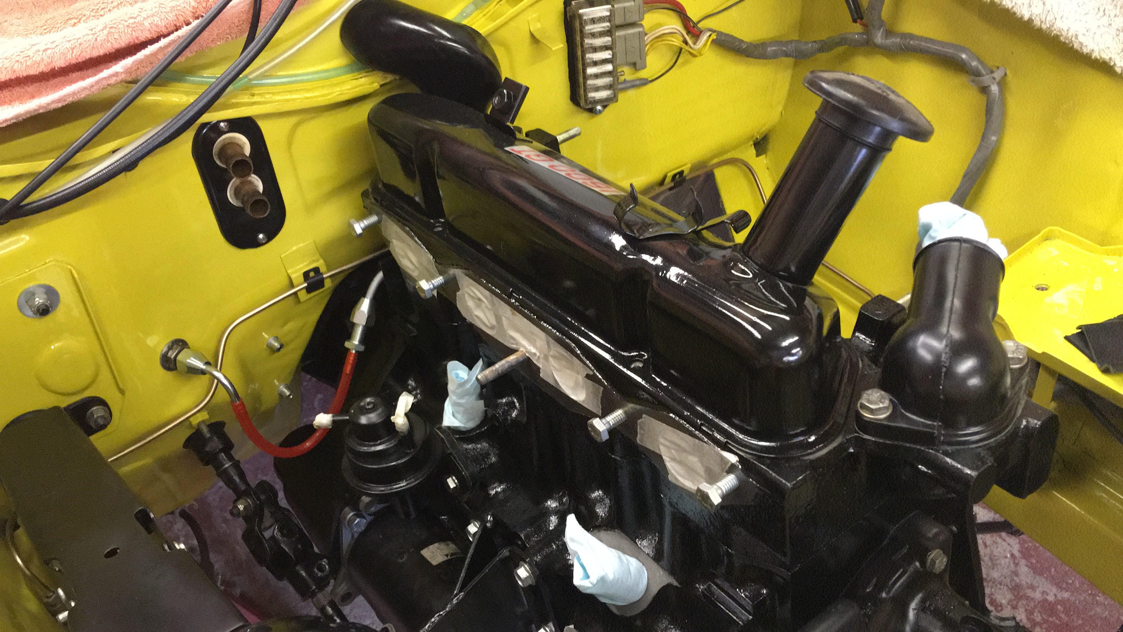

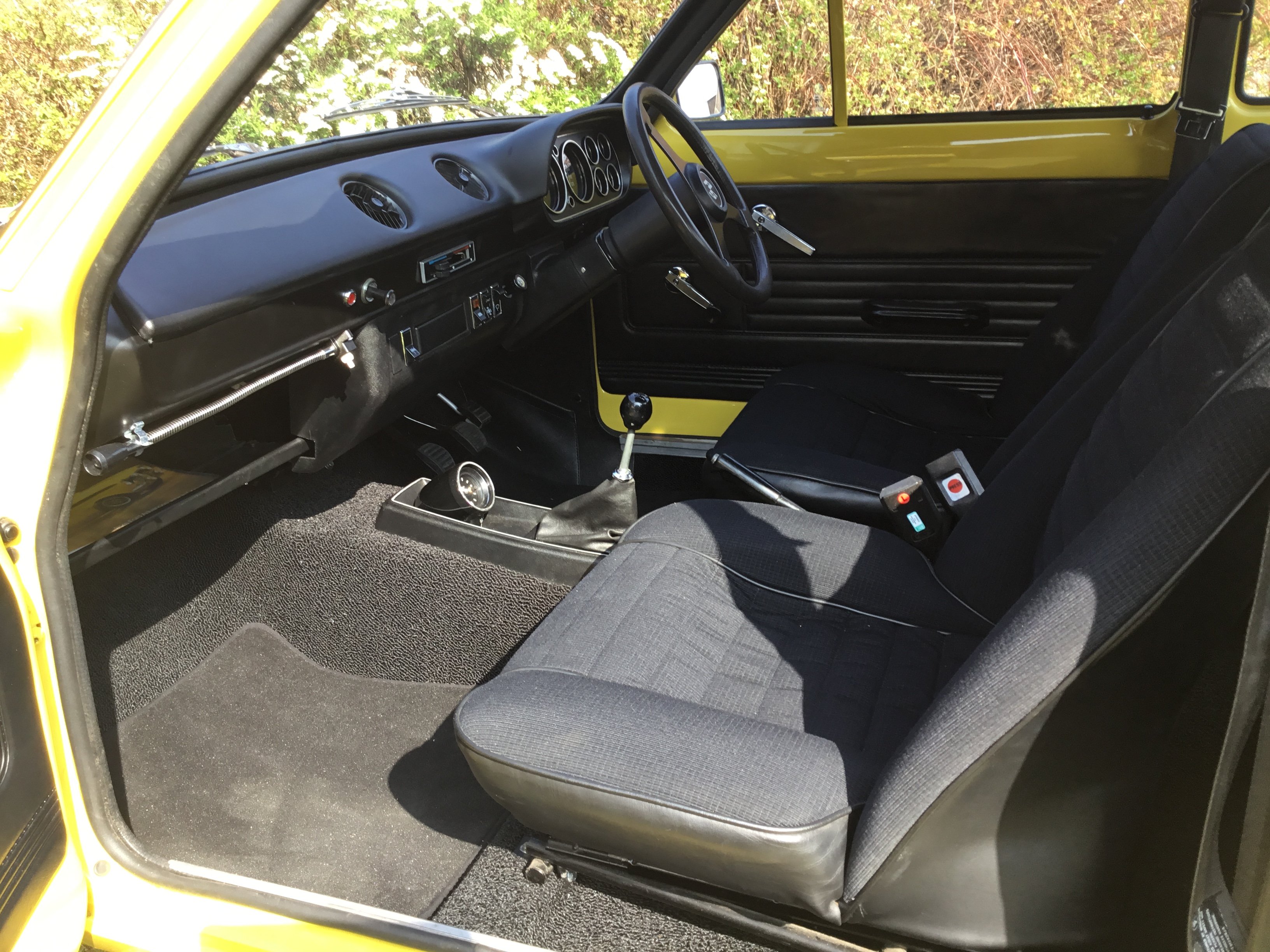

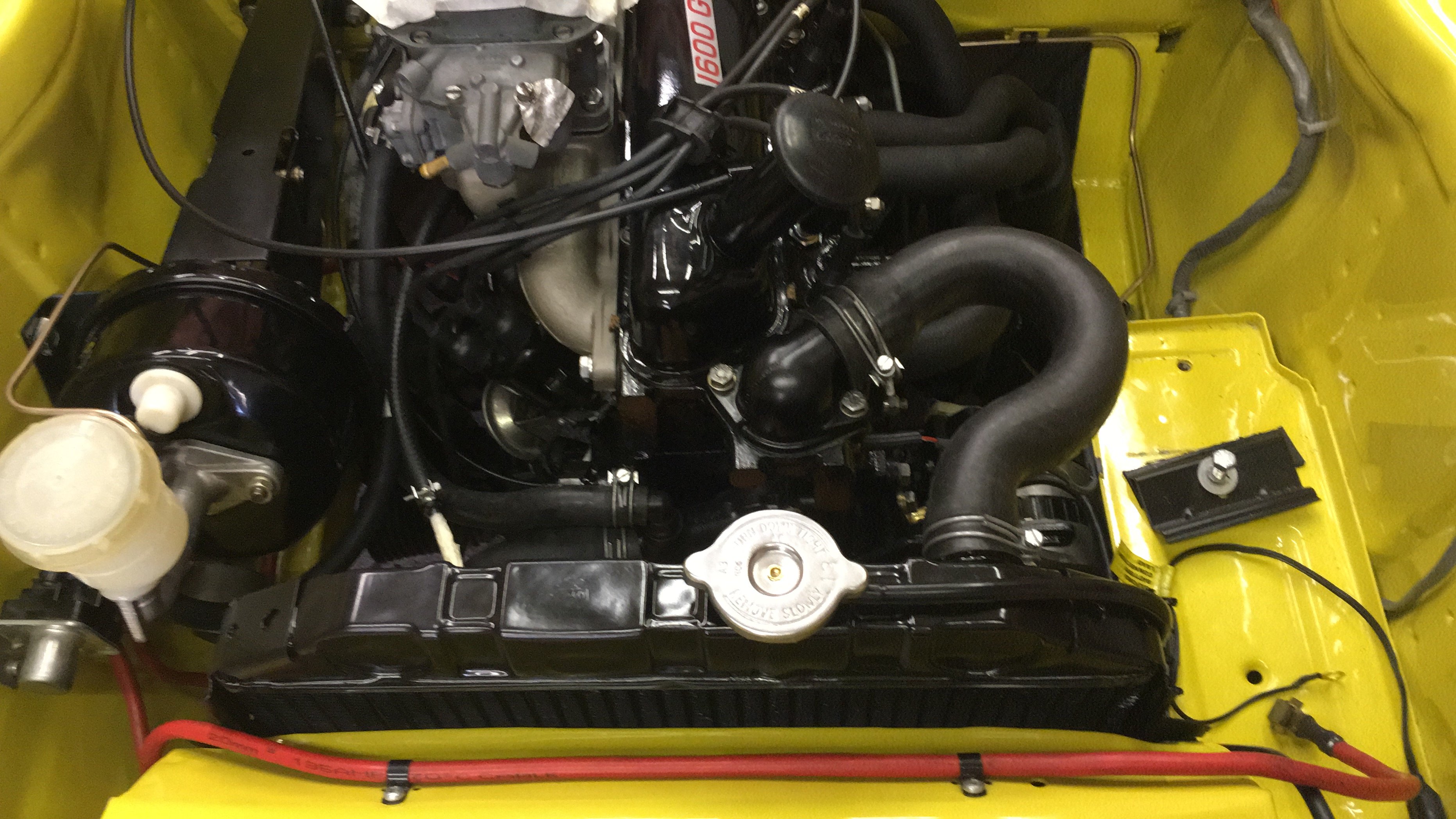

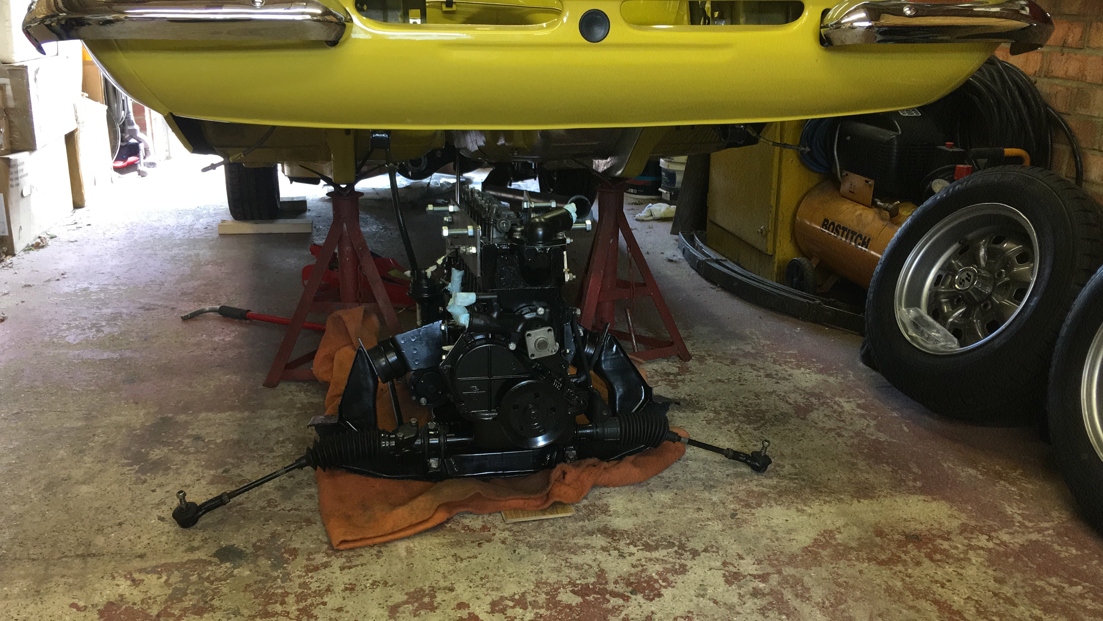

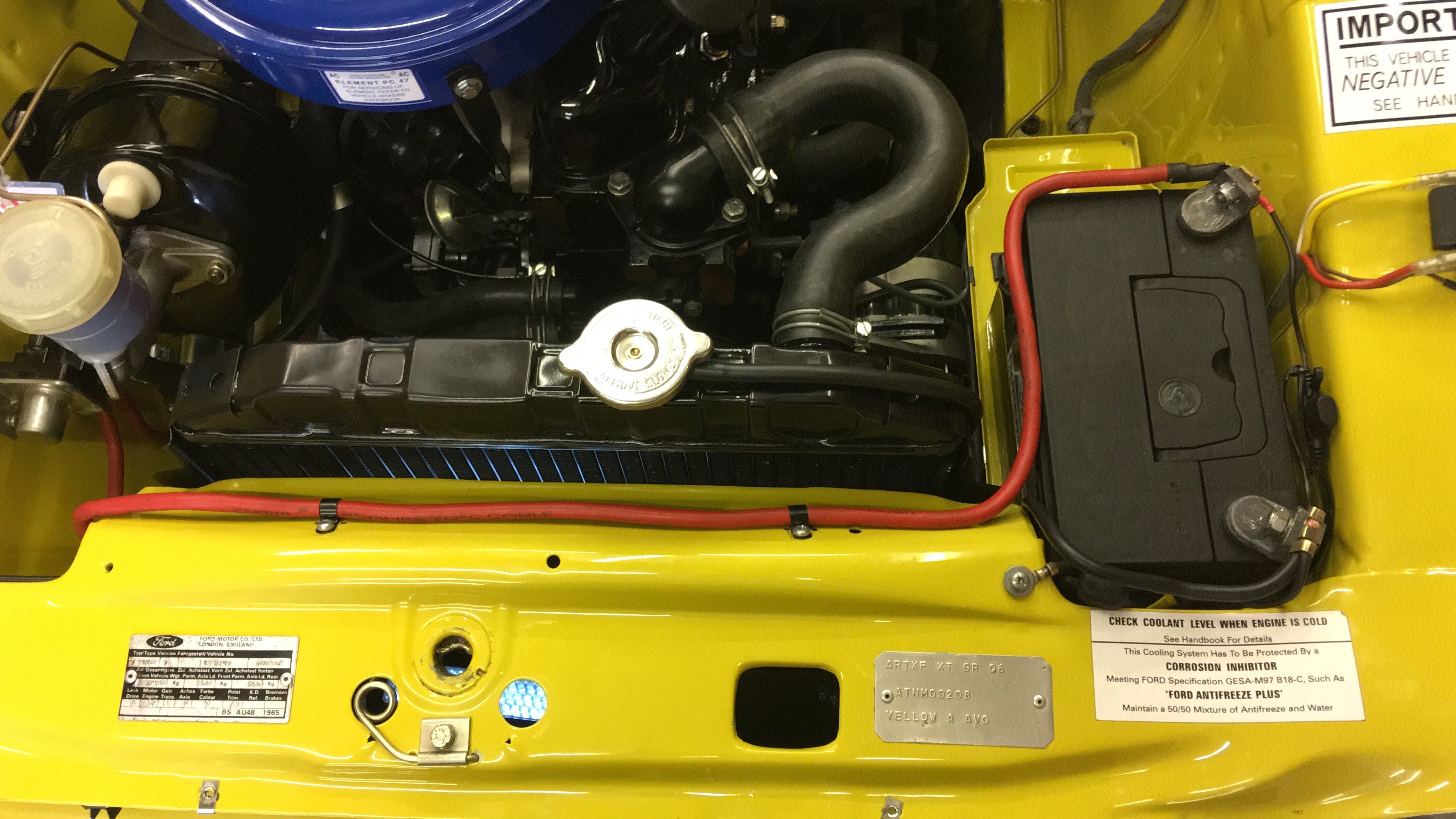

Since the original recommissioning of my Mexico  til this engine rebuild i have been accumulating more oiginal parts and ones to correct things that were wrong on the car from when i bought it , this was the ideal opportunity to change and fit these . Some of the parts were :-
Nos rear heated window loom .

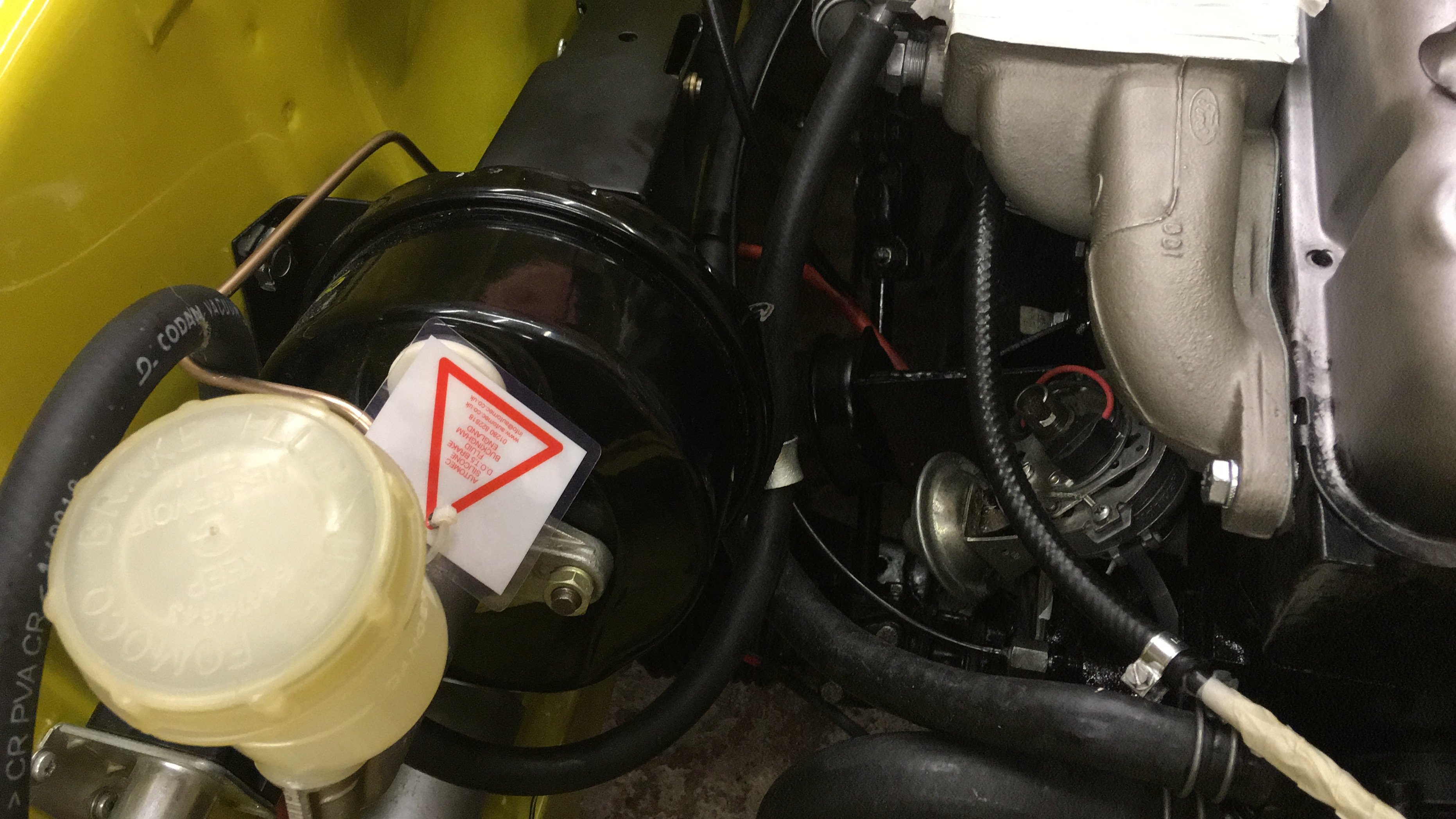

Nos girling servo
Nos girling brake master  cylinder
original nos ford mexico speedo cable
correct mexico inlet manifold
various pipes , clips etc
original fuel pump and motorcraft fuel filter

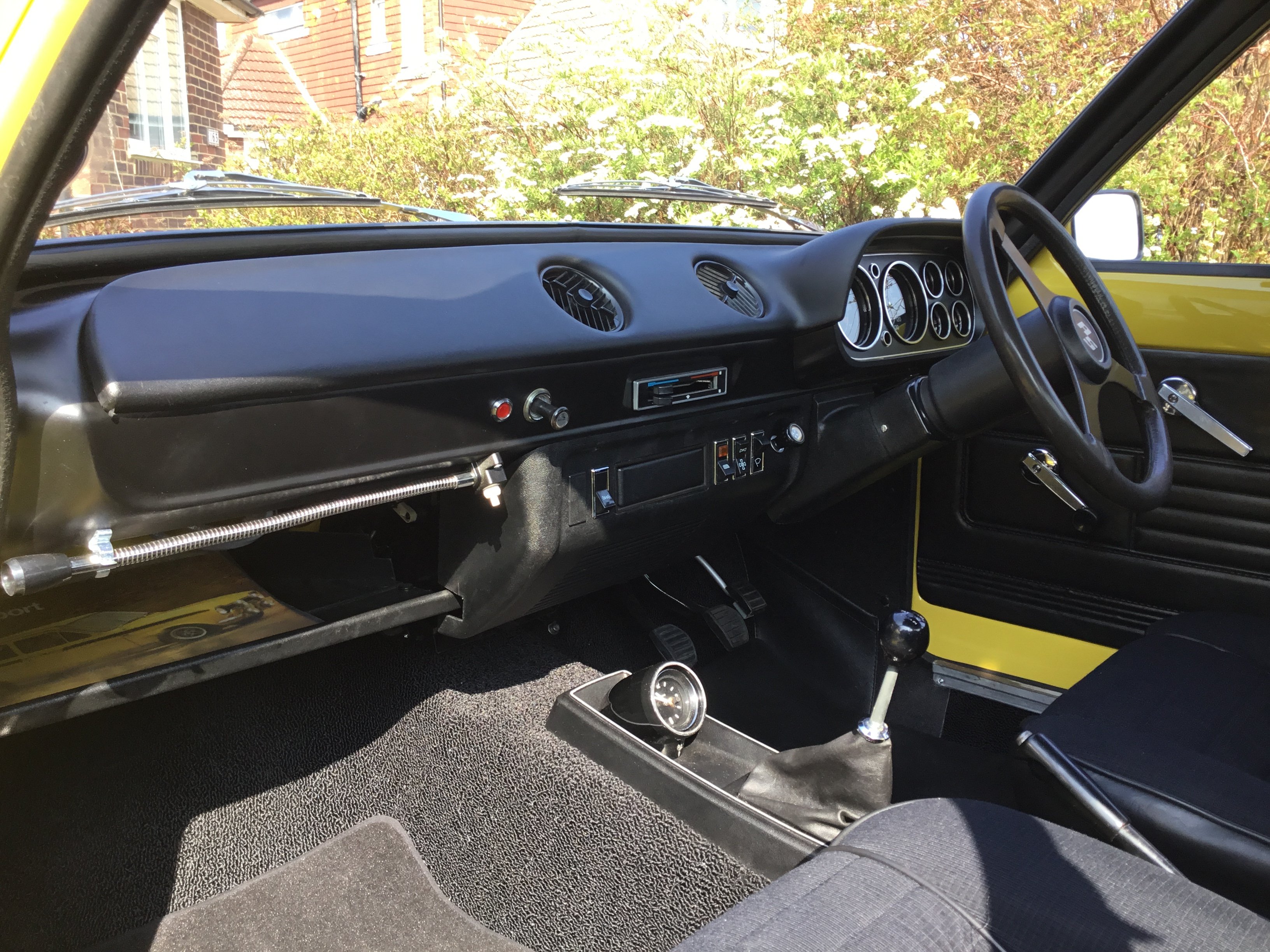

centre console clock and pod

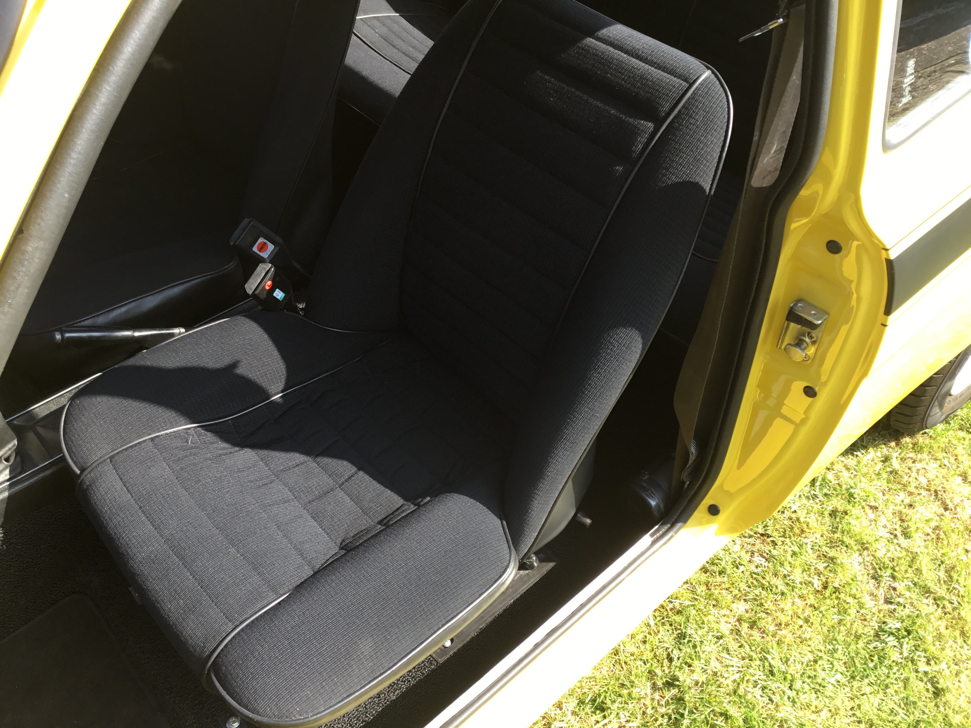

Original mk1 inertia seat belts

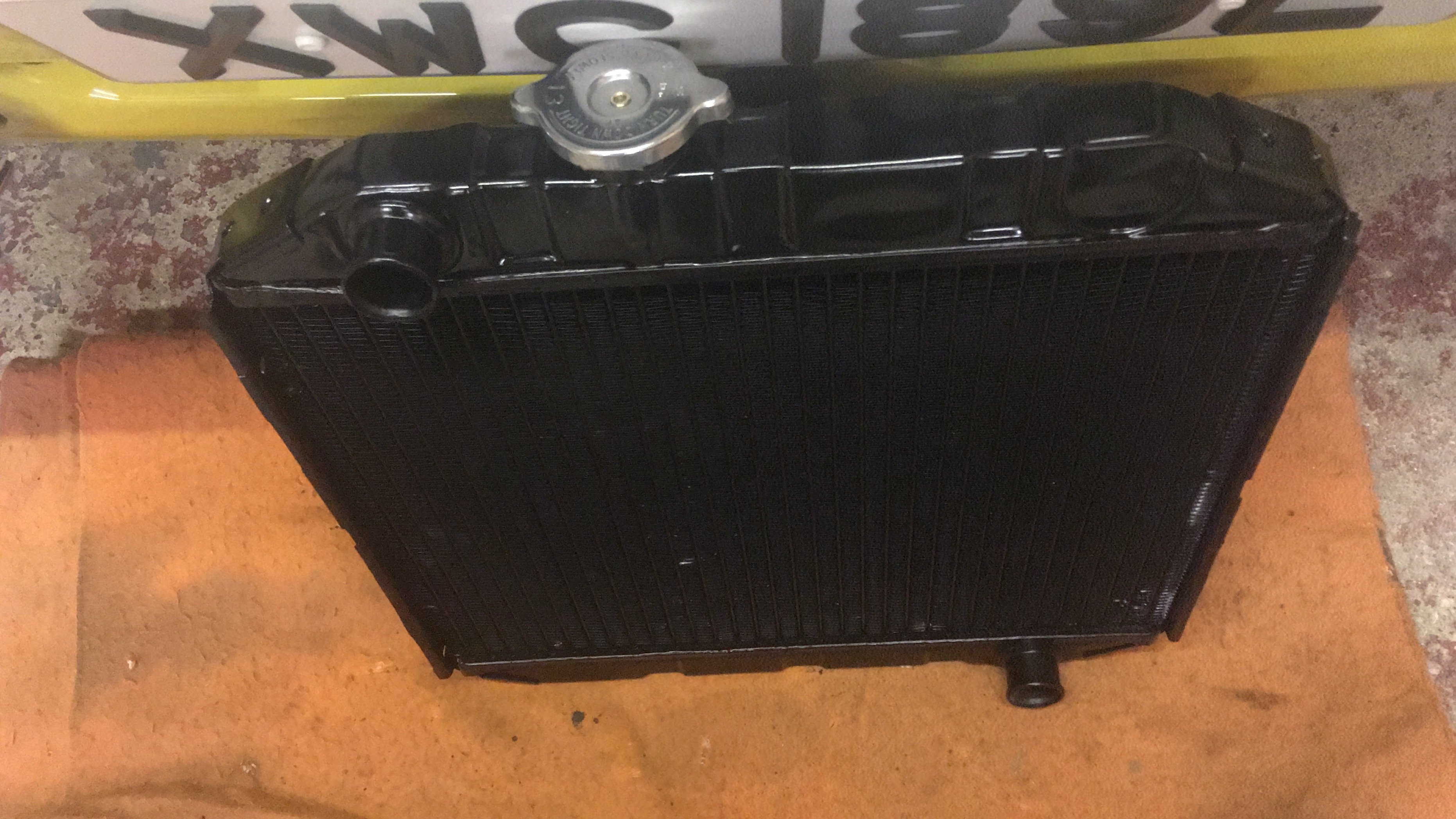

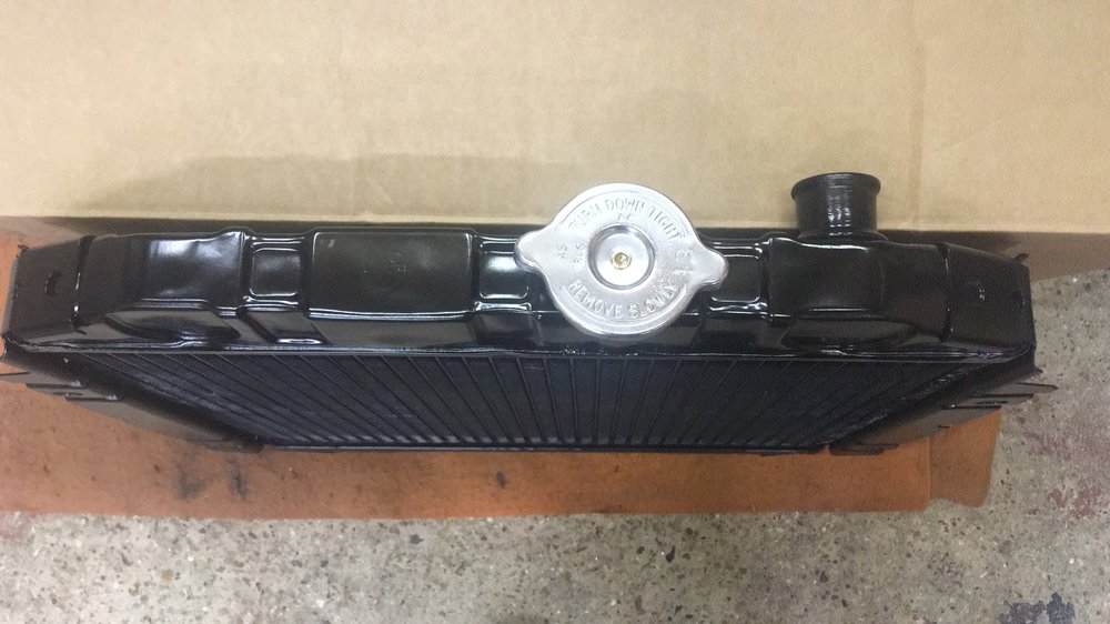

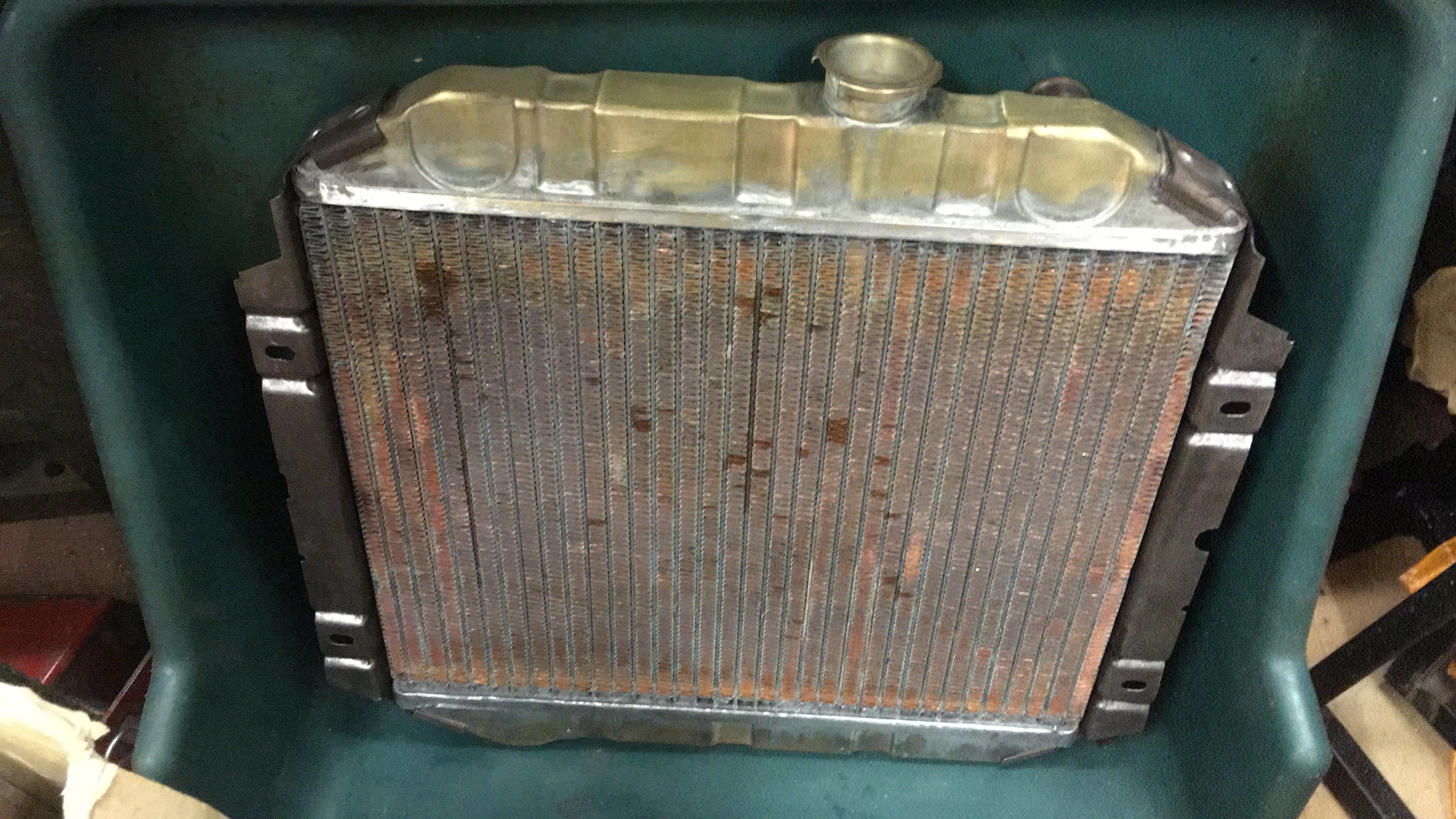

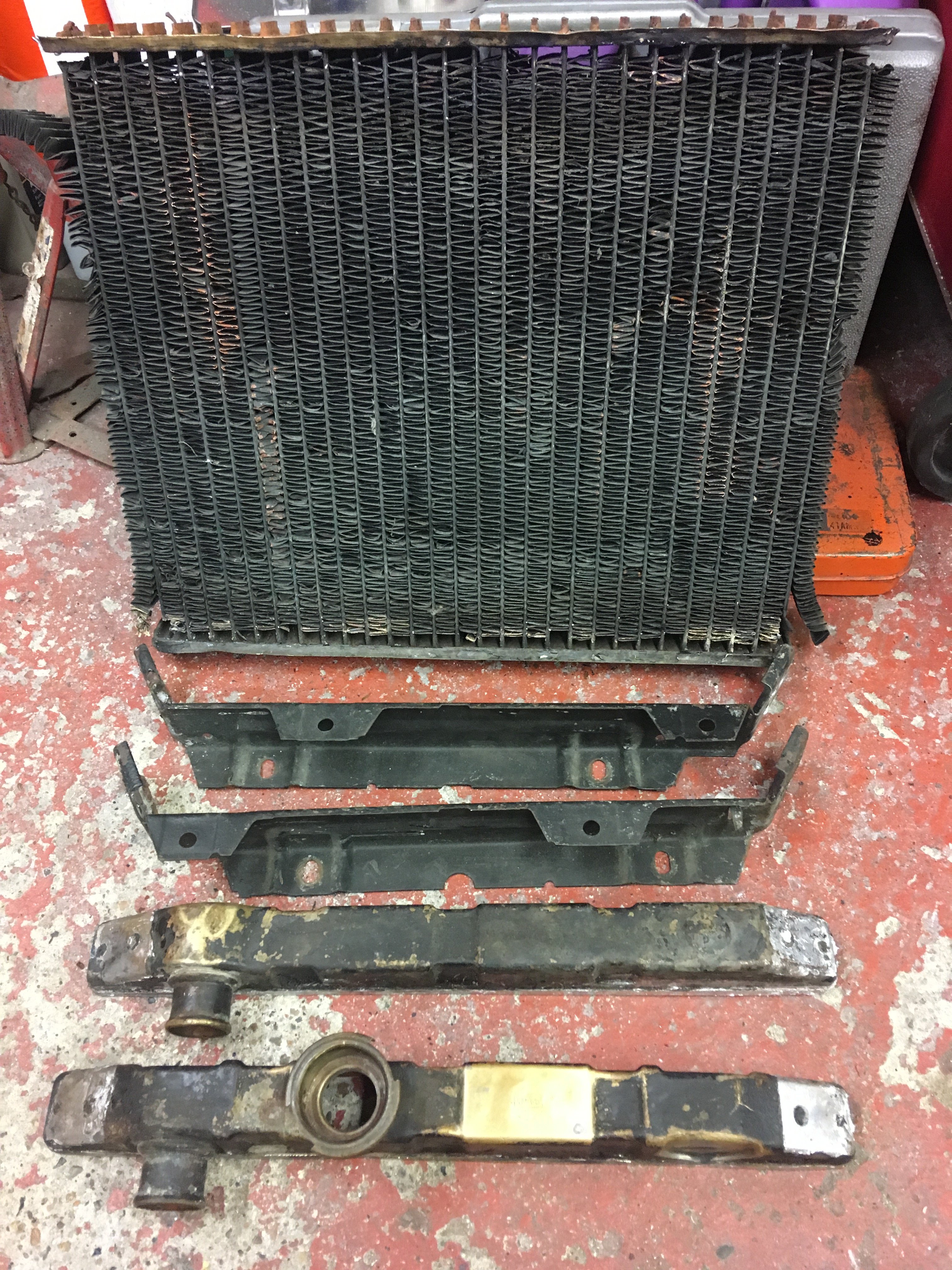

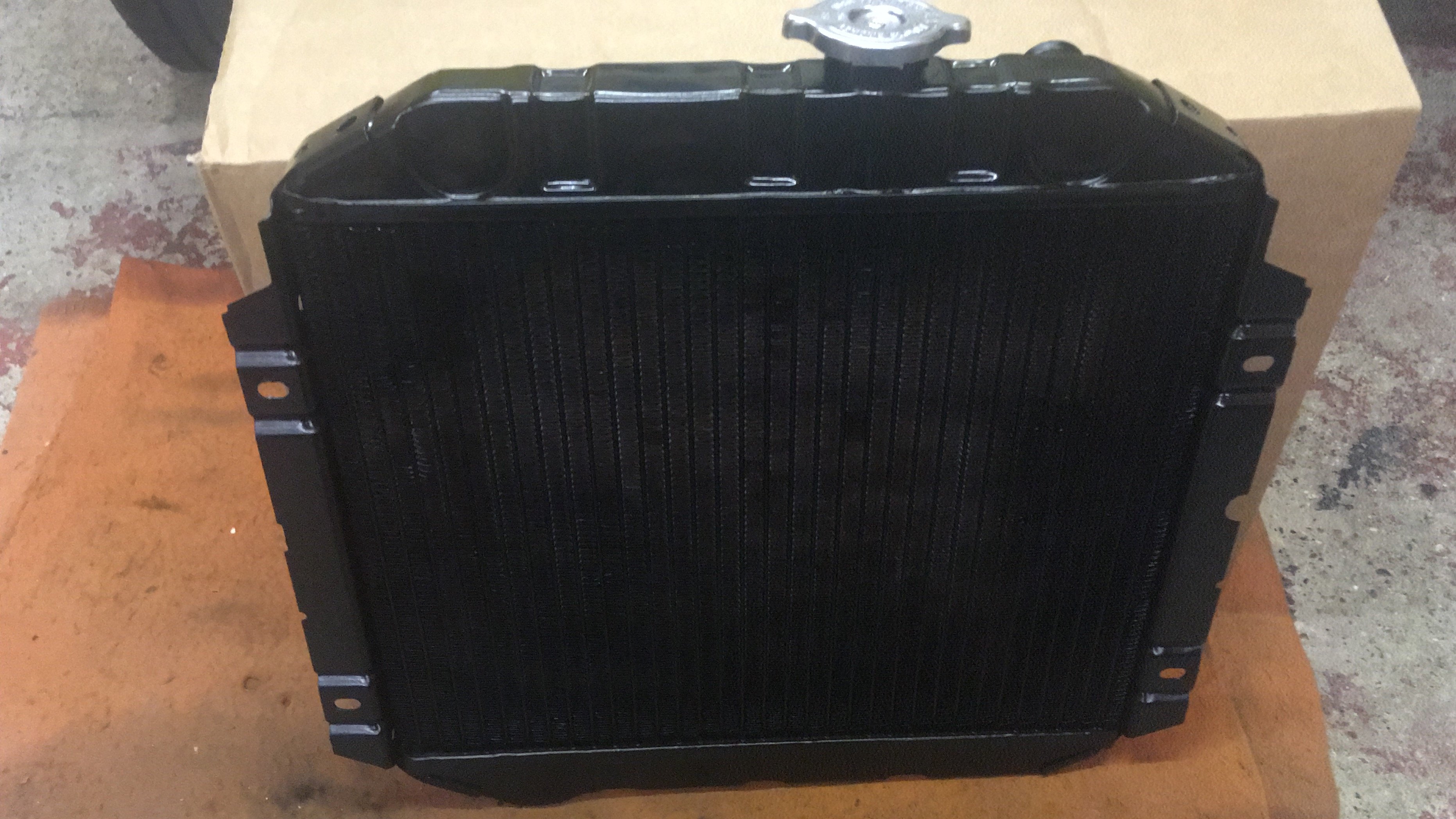

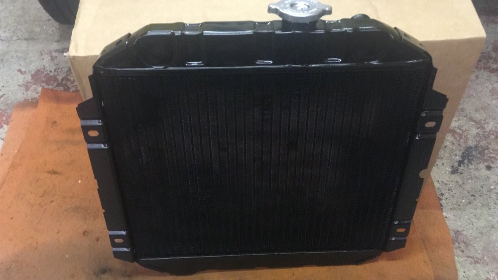

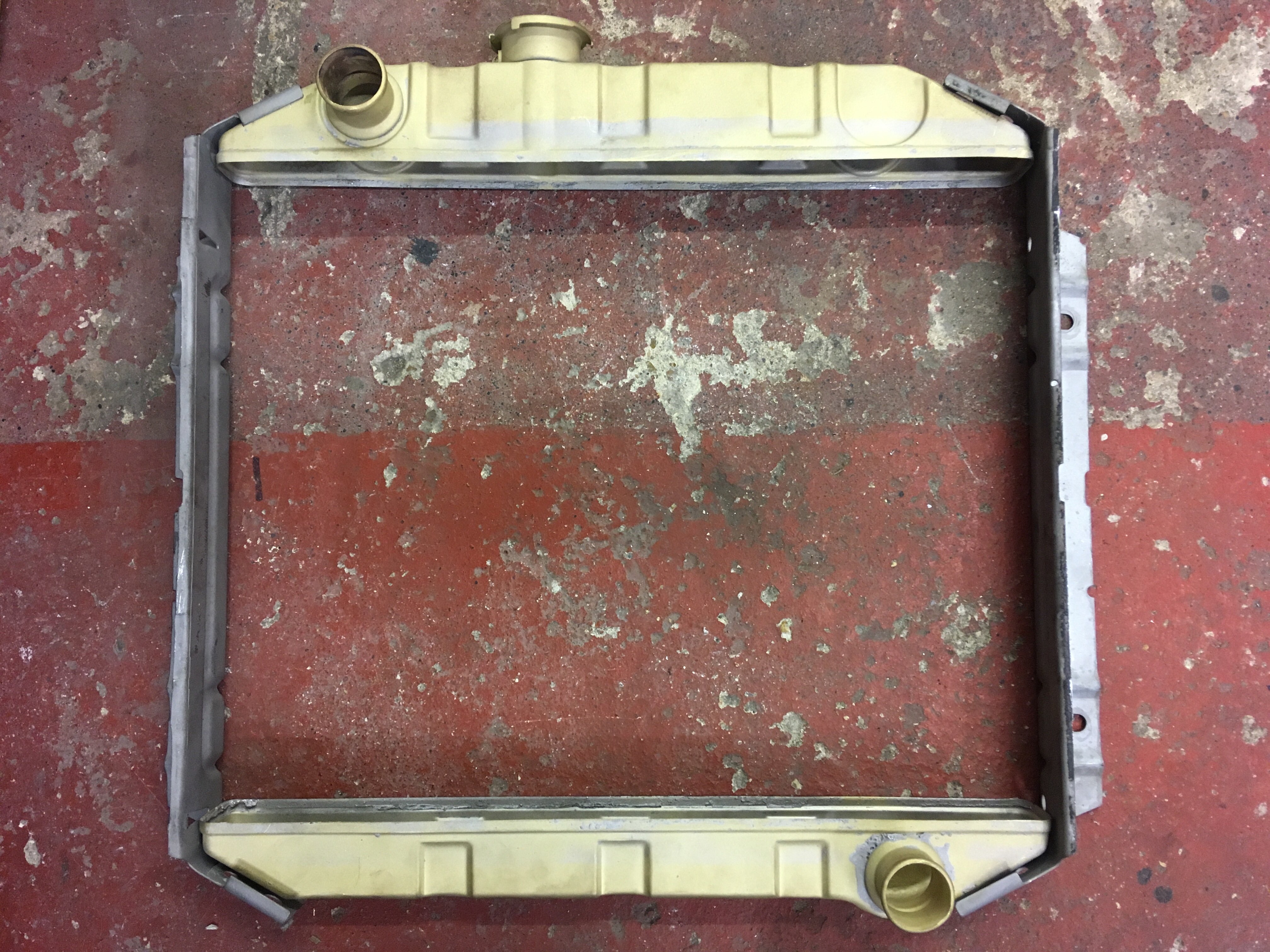

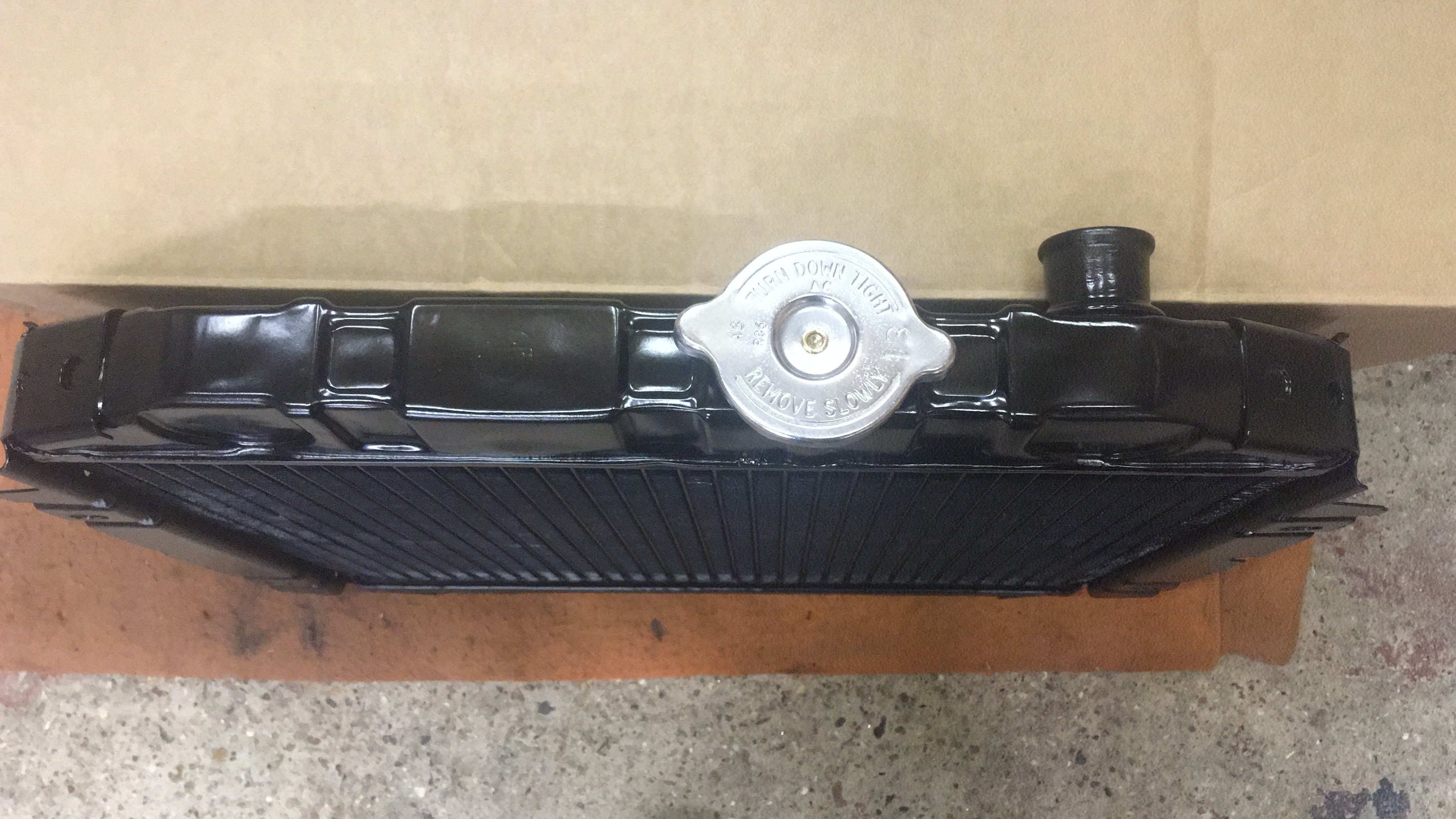

mk1 ford radiator( once recored ) with Ac Delco rad cap
under dash loom with ford labels
Nos heater blower motor

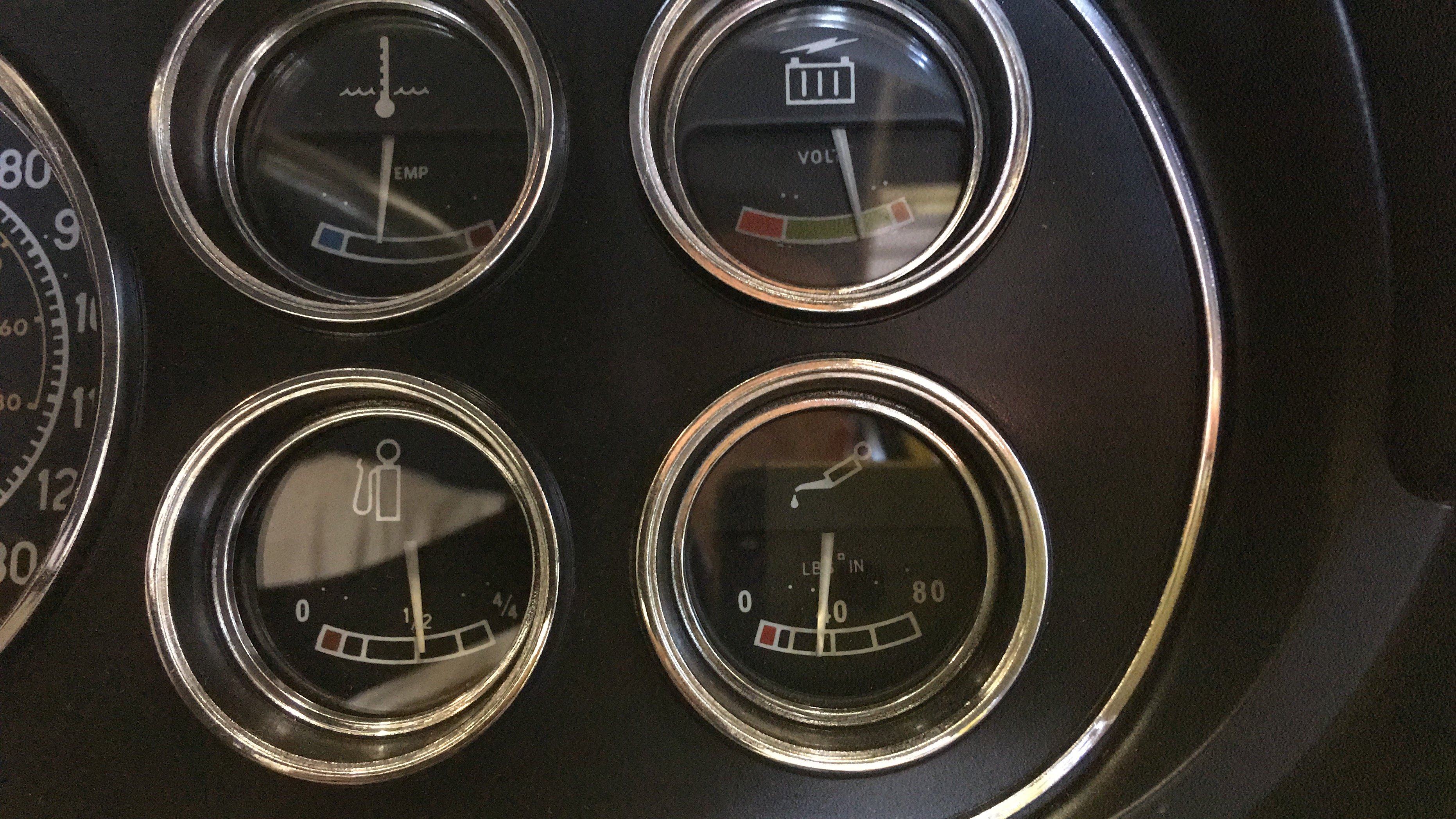

new clocks binnacle ( chrome ringed type )
Nos windscreen washer bottle

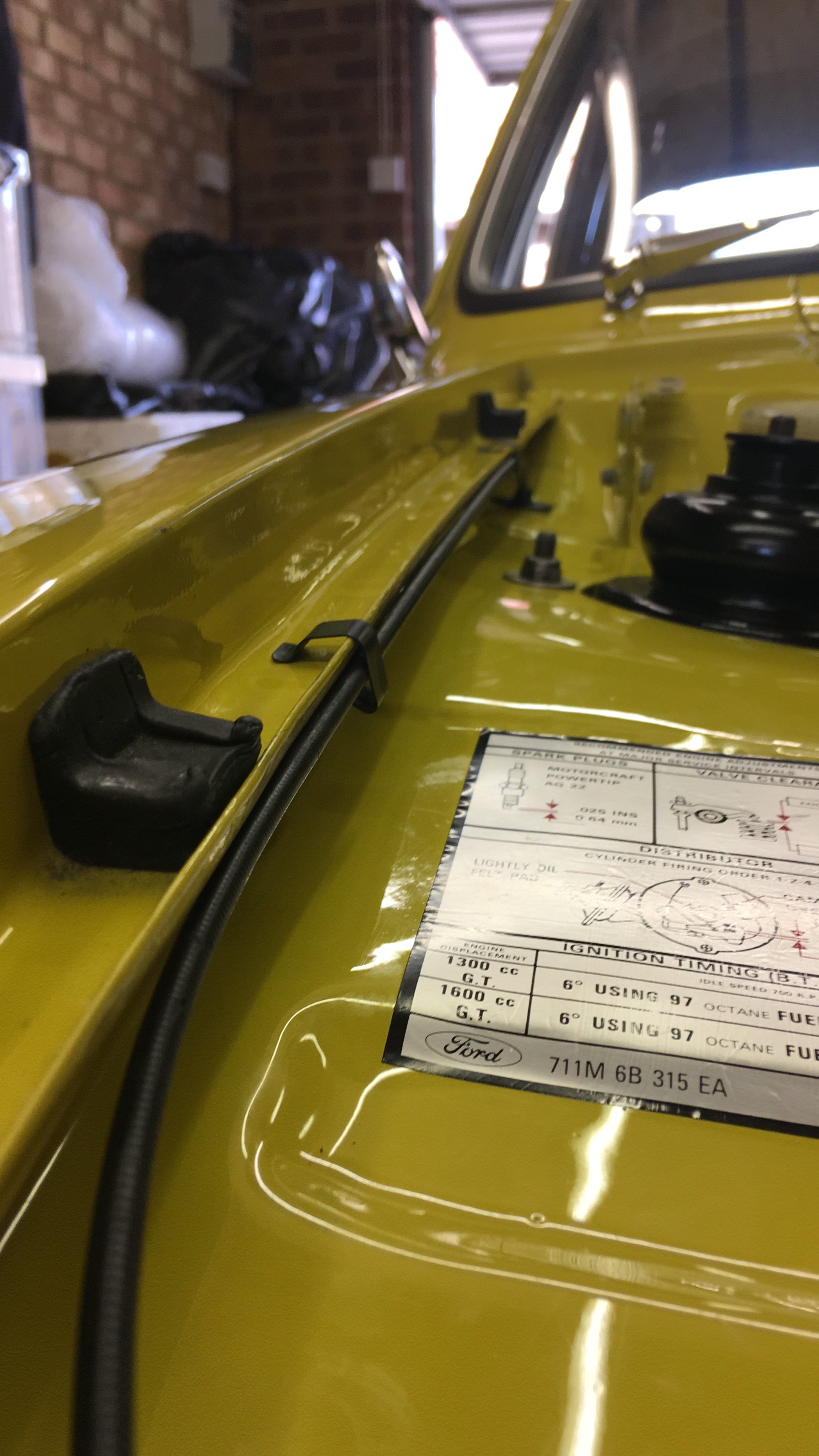

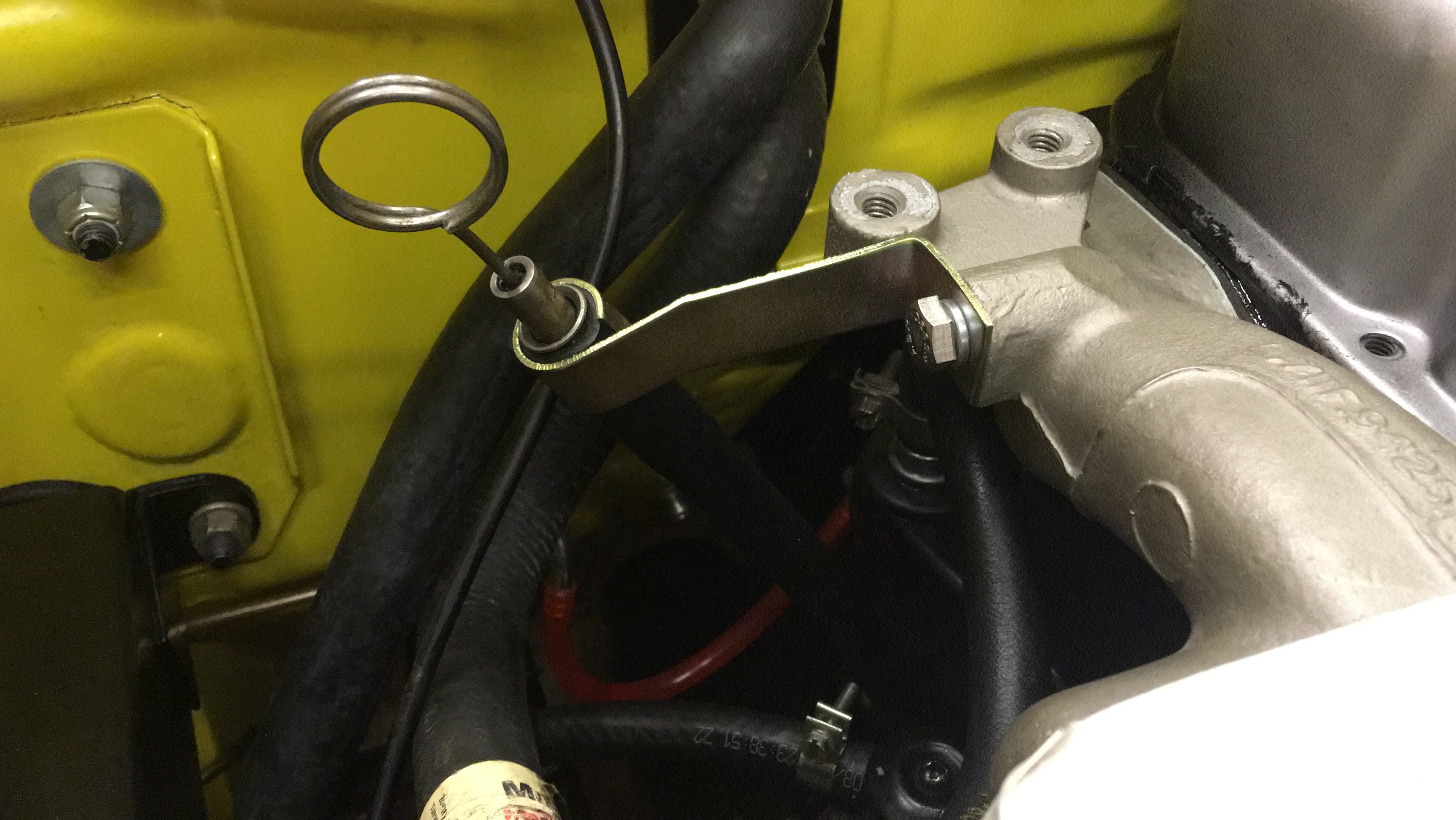

correct length bonnet release cable .

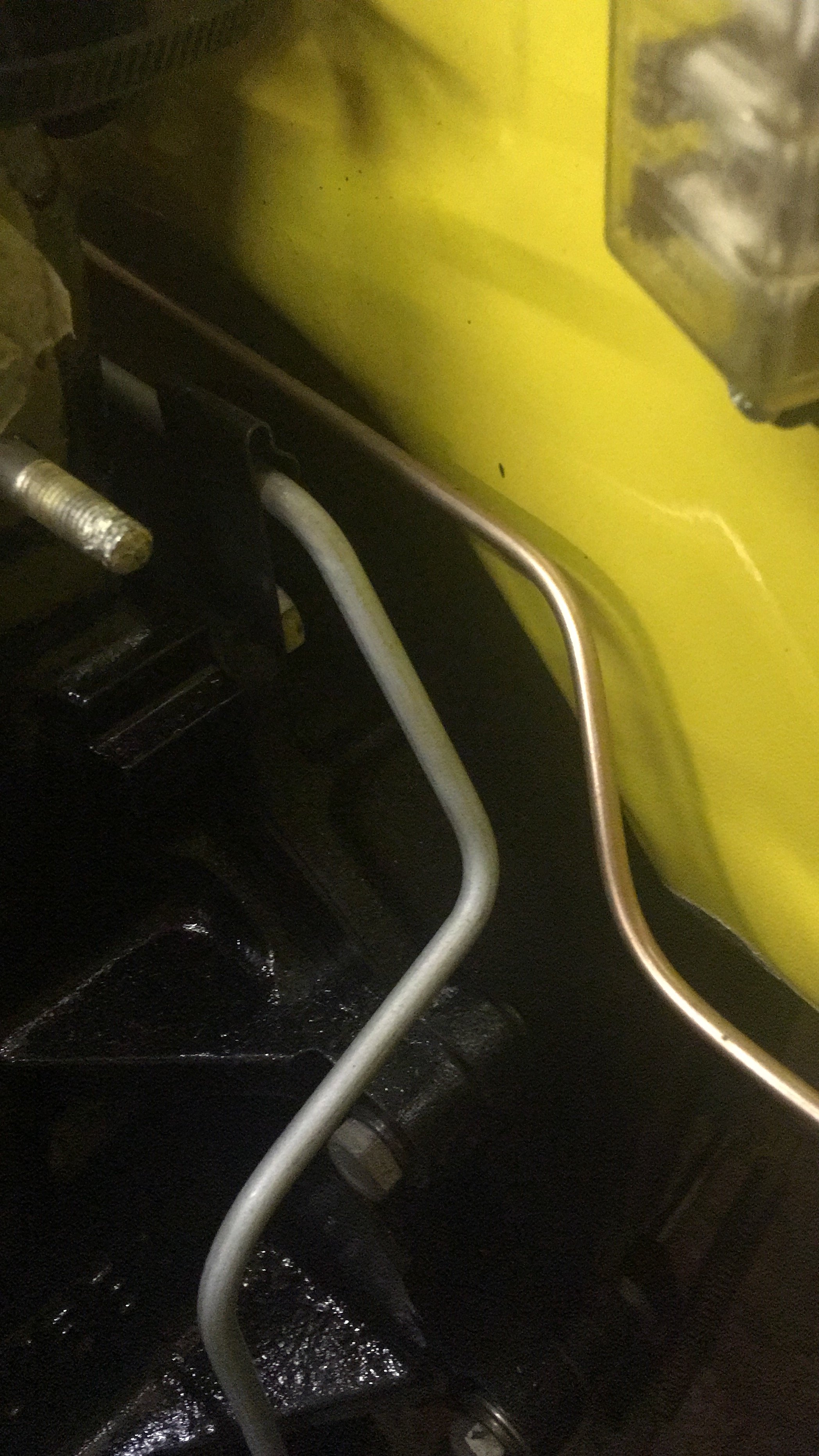

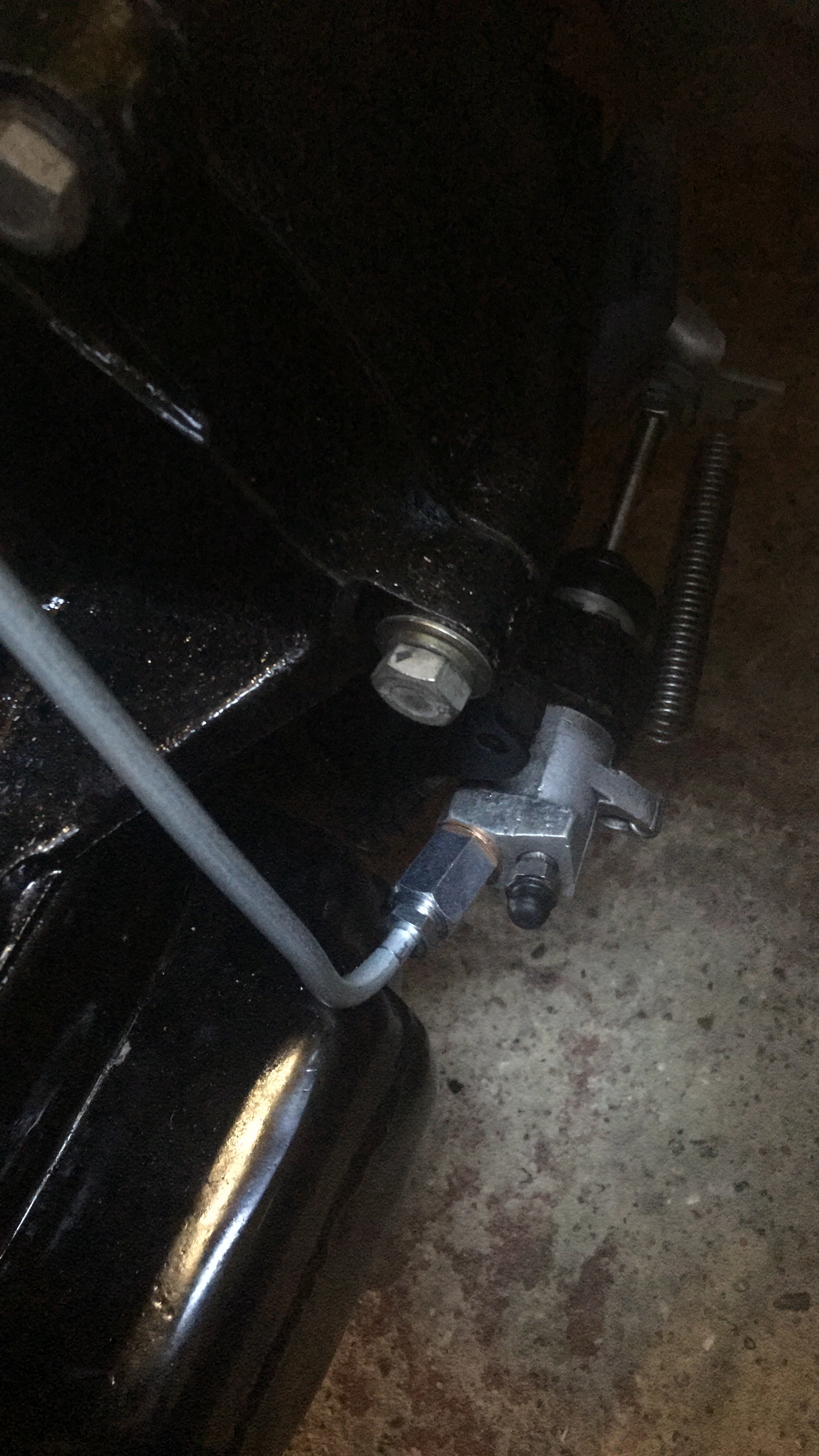

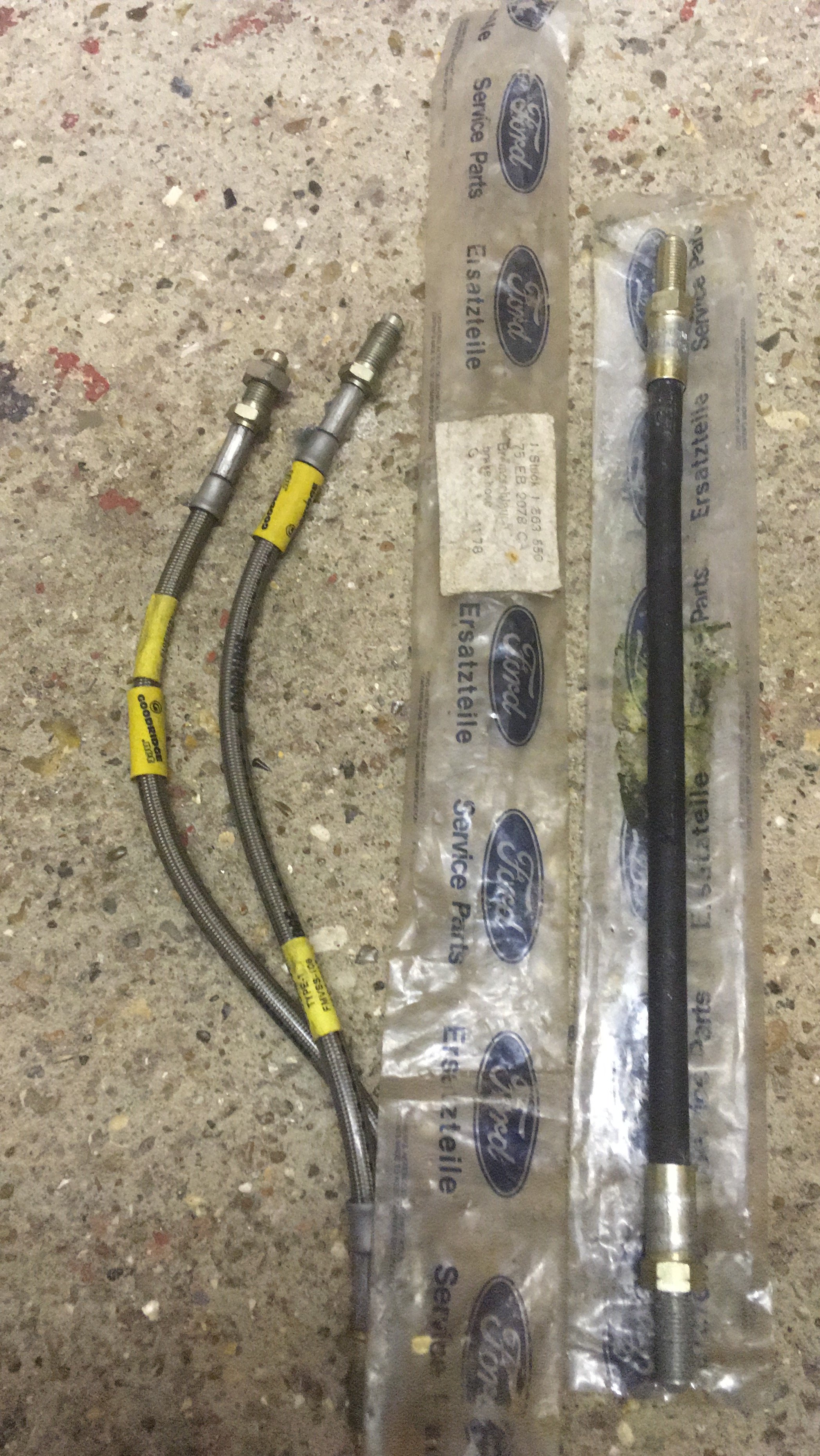

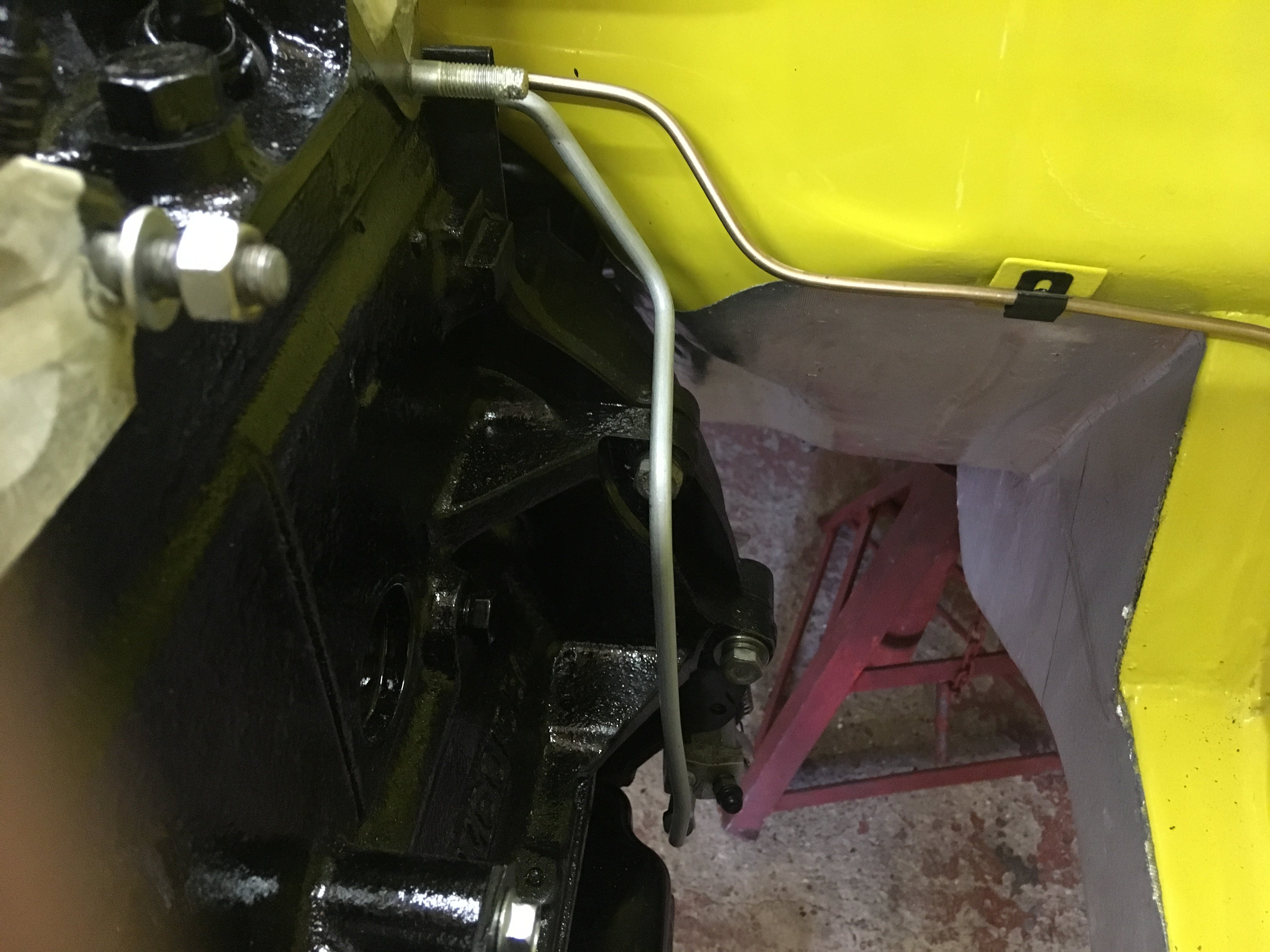

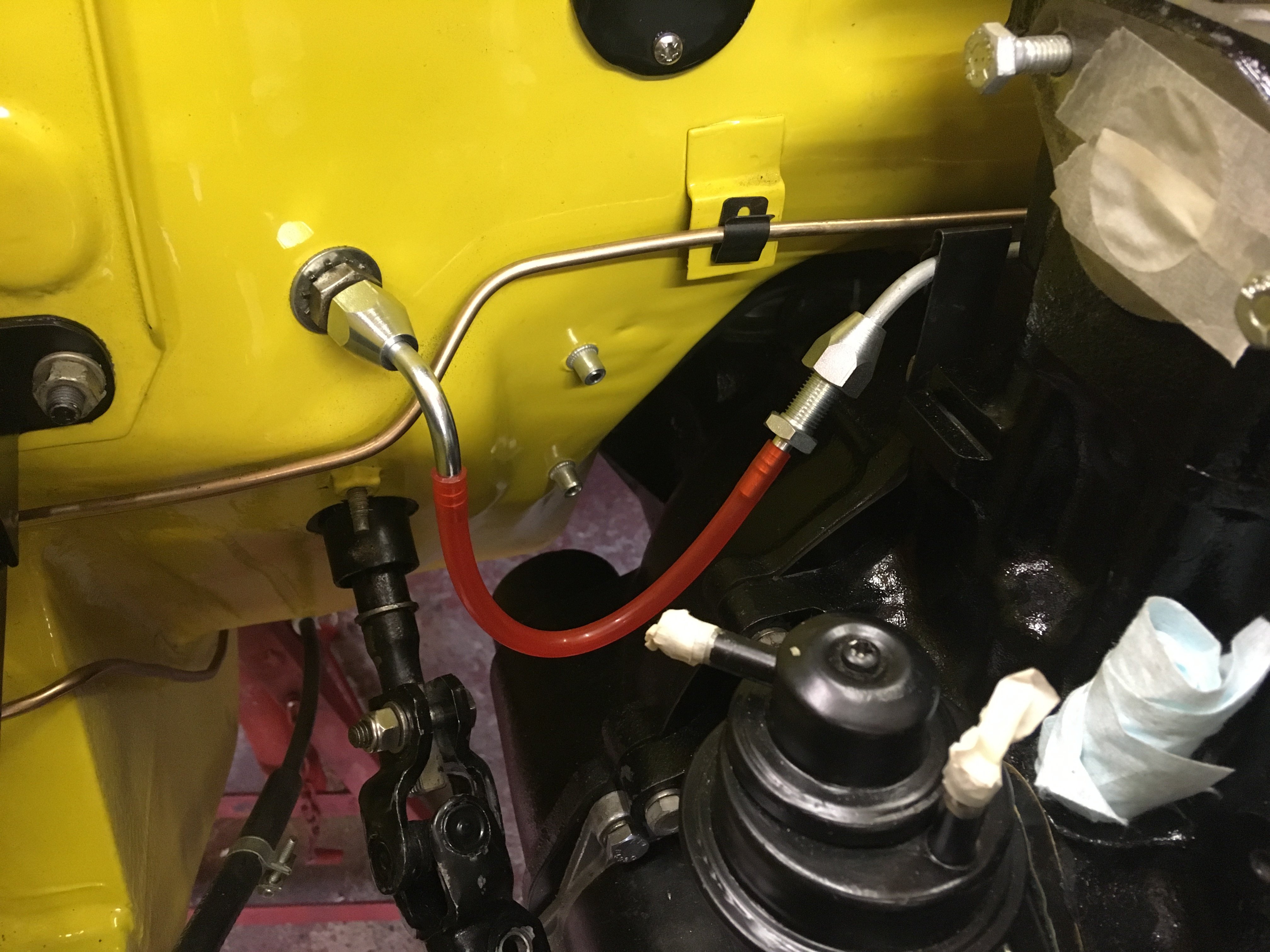

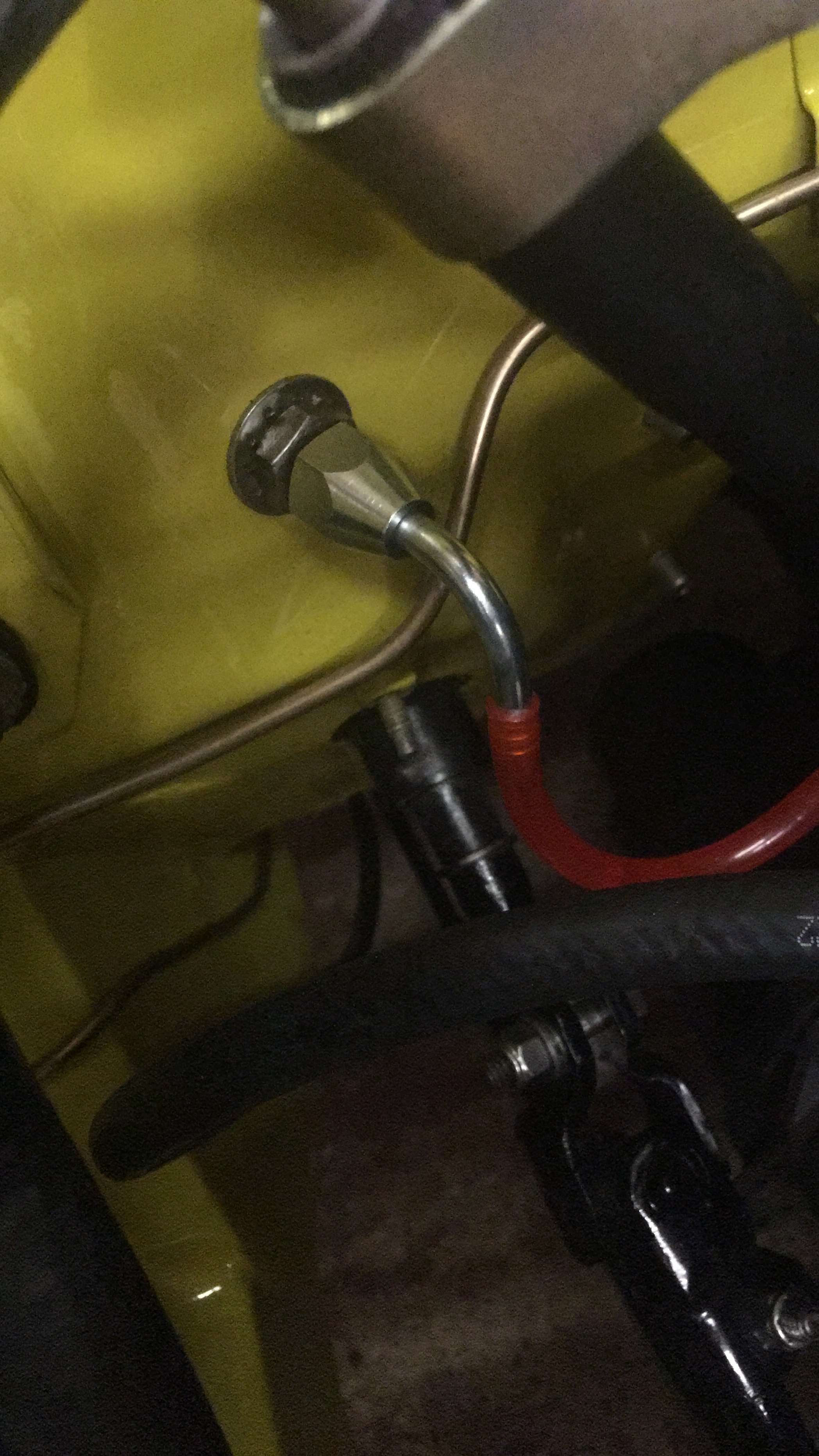

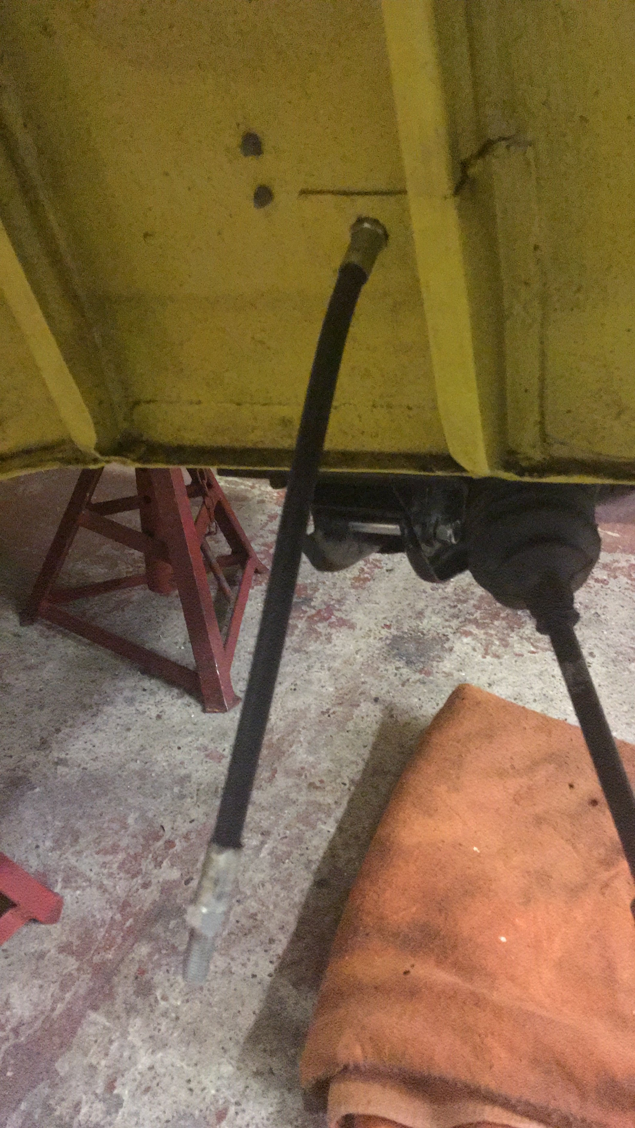

Also got rid of the old stainless steel braided hydraulic clutch pipe that was originally fitted in my original build  and fitted one of trevors ( stage 1 motorsport ) ones as its more correct and personally better looking .

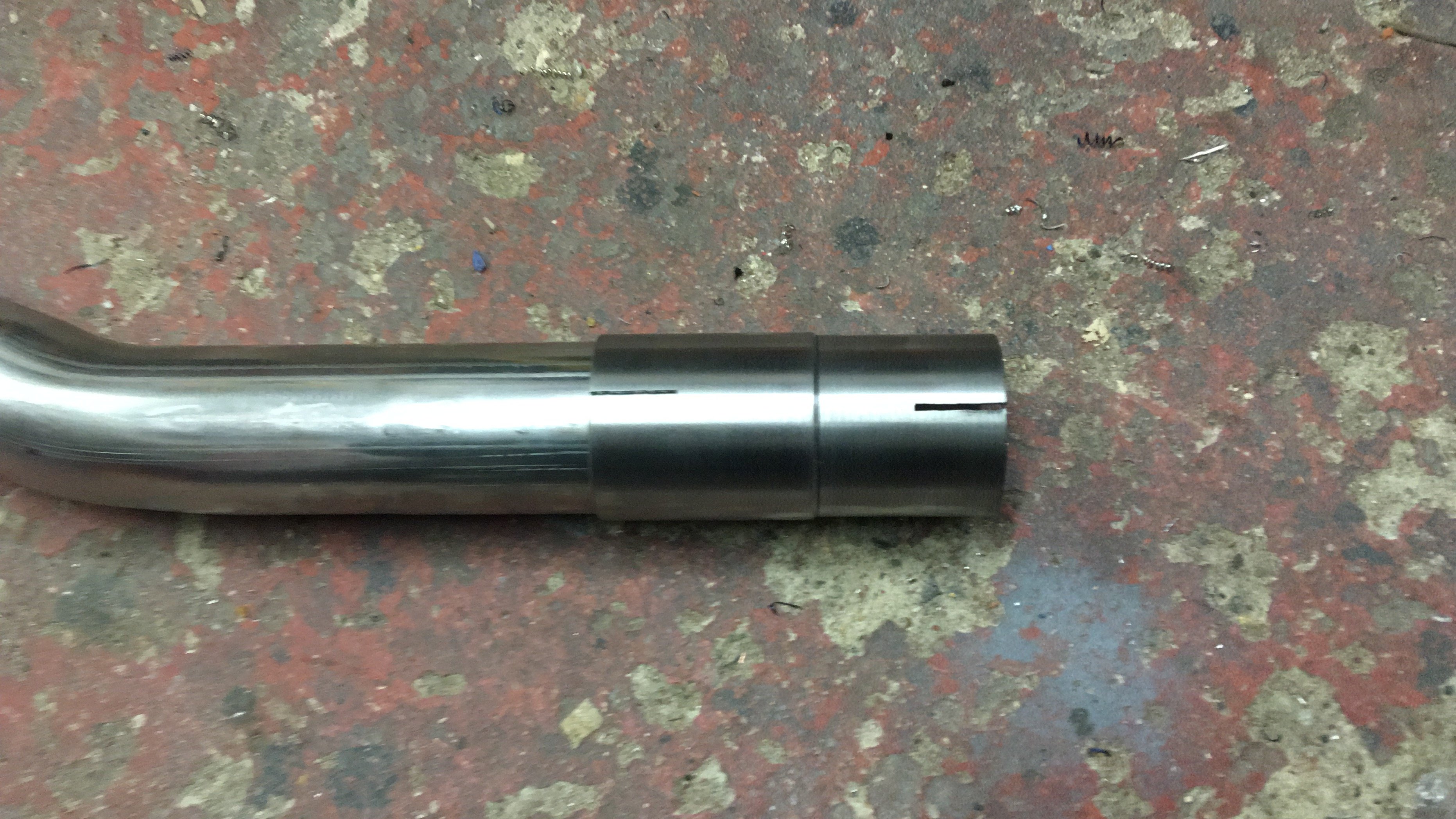

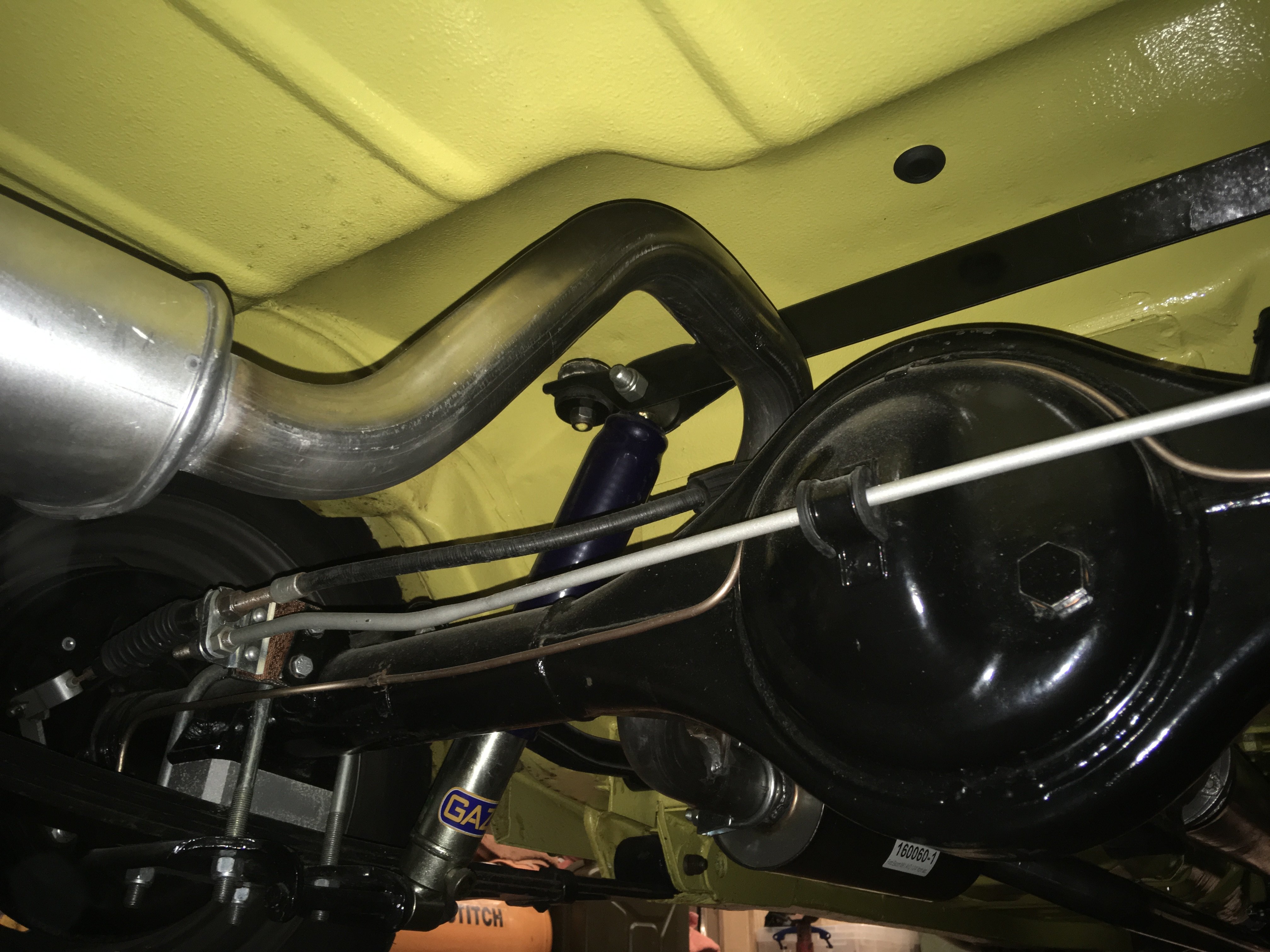

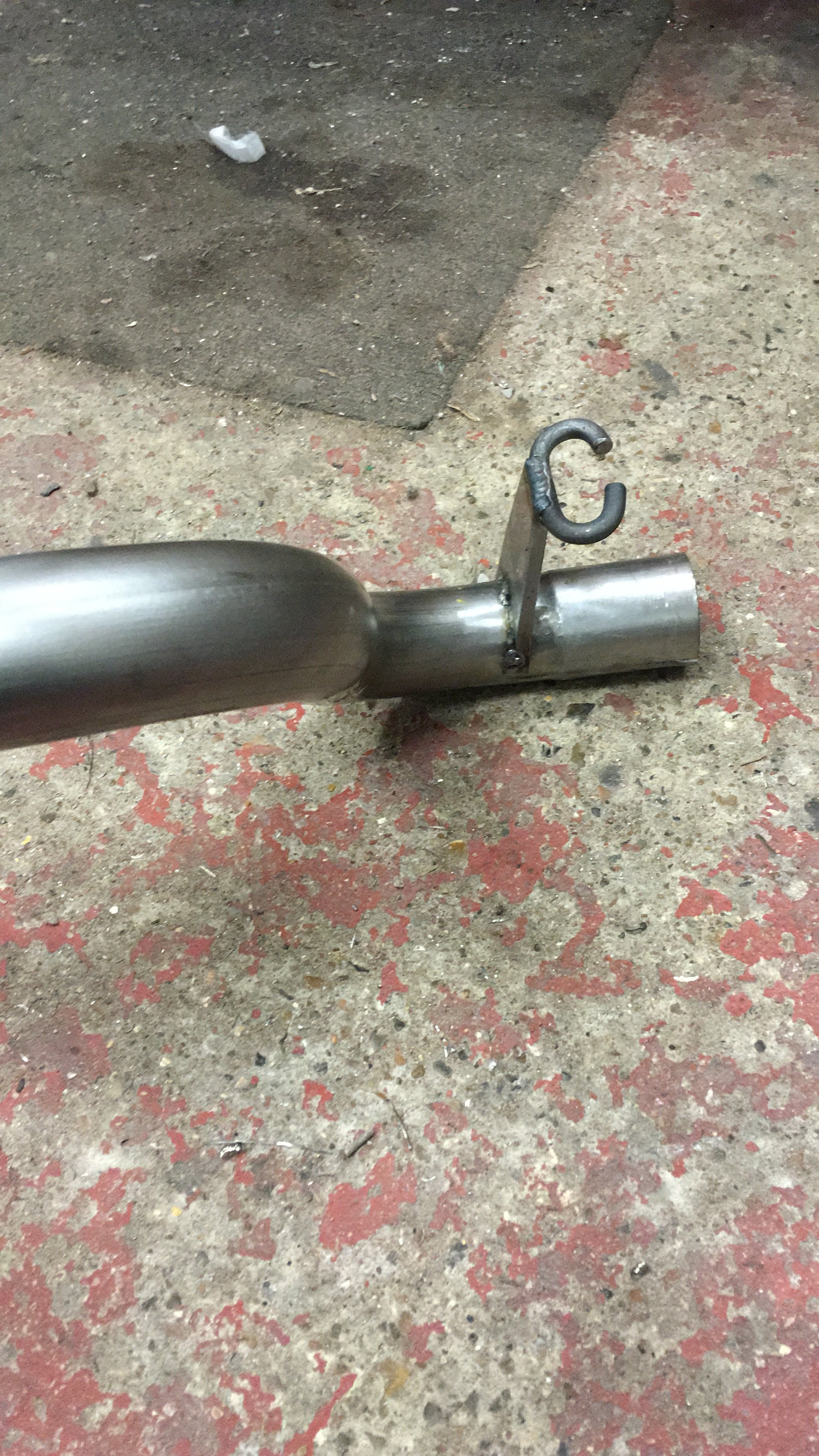

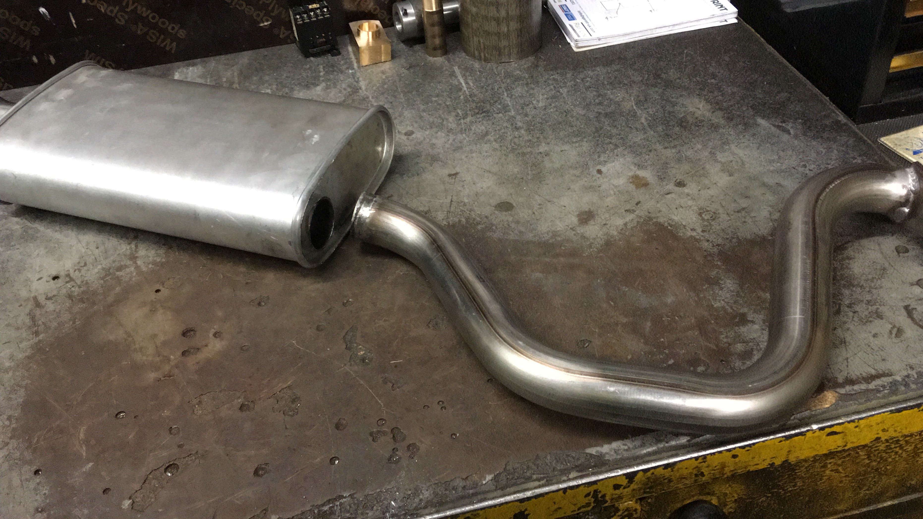

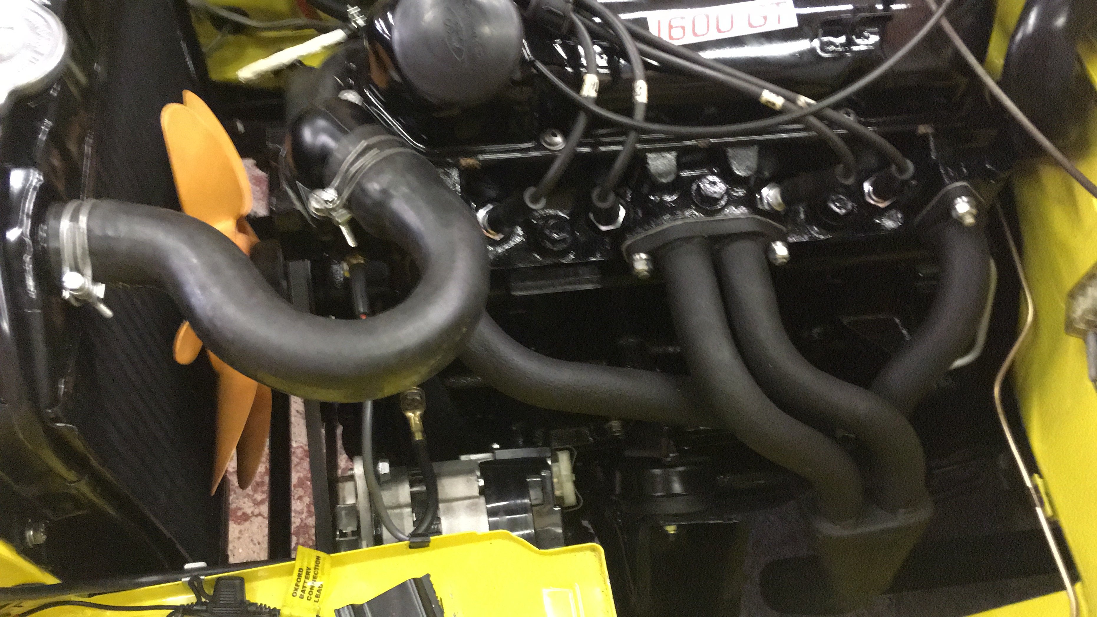

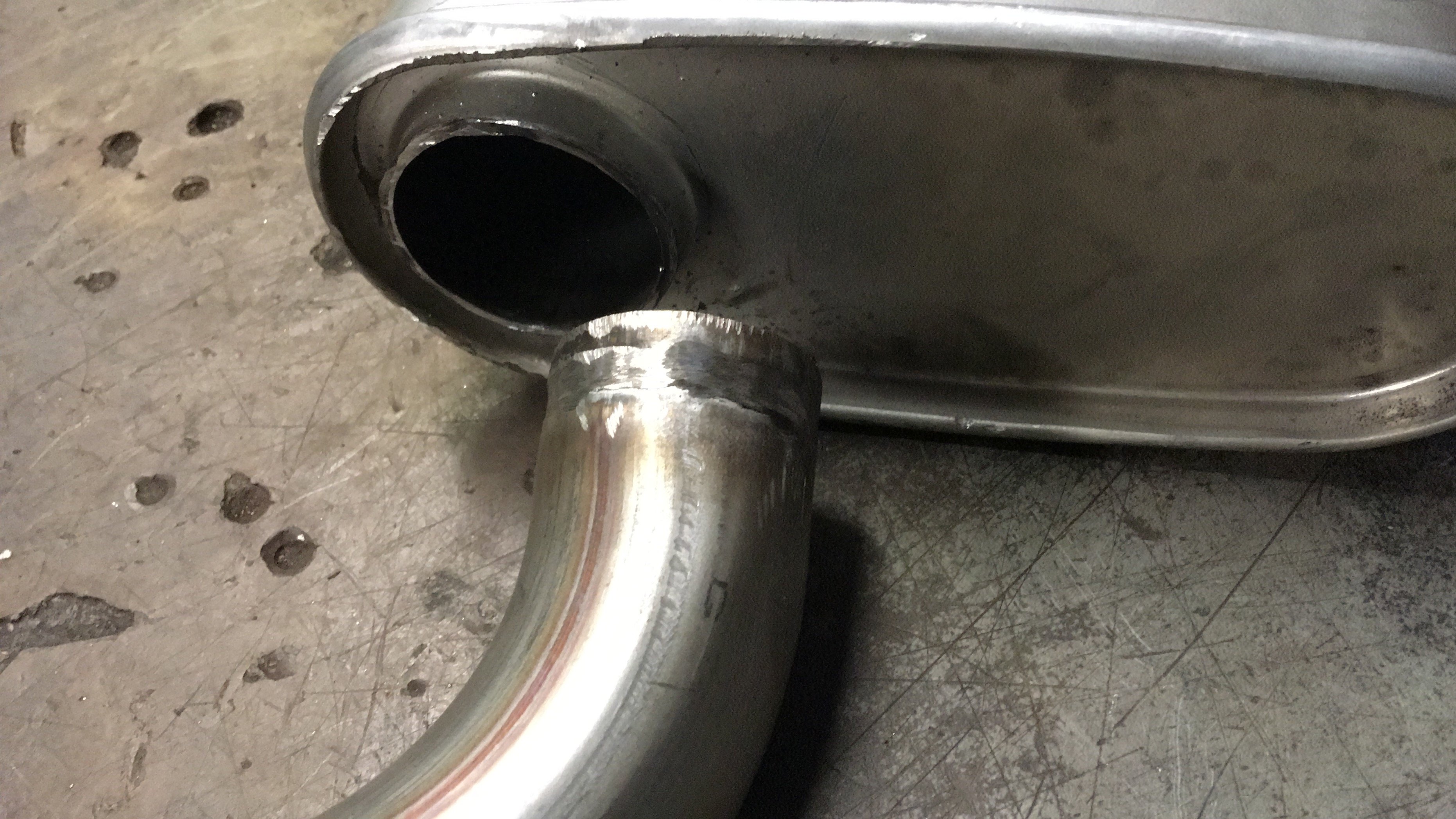

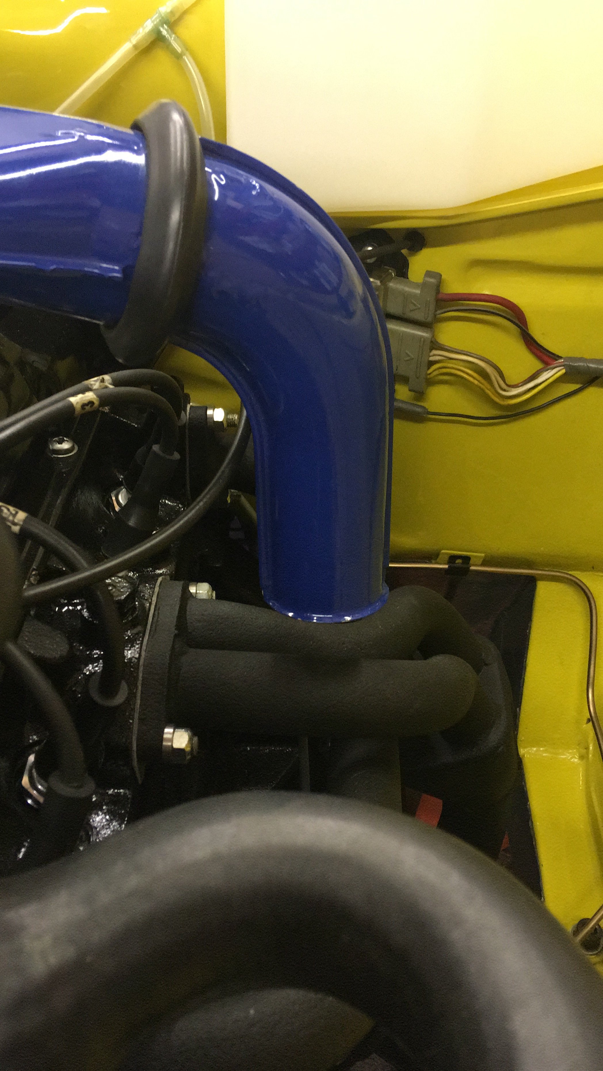

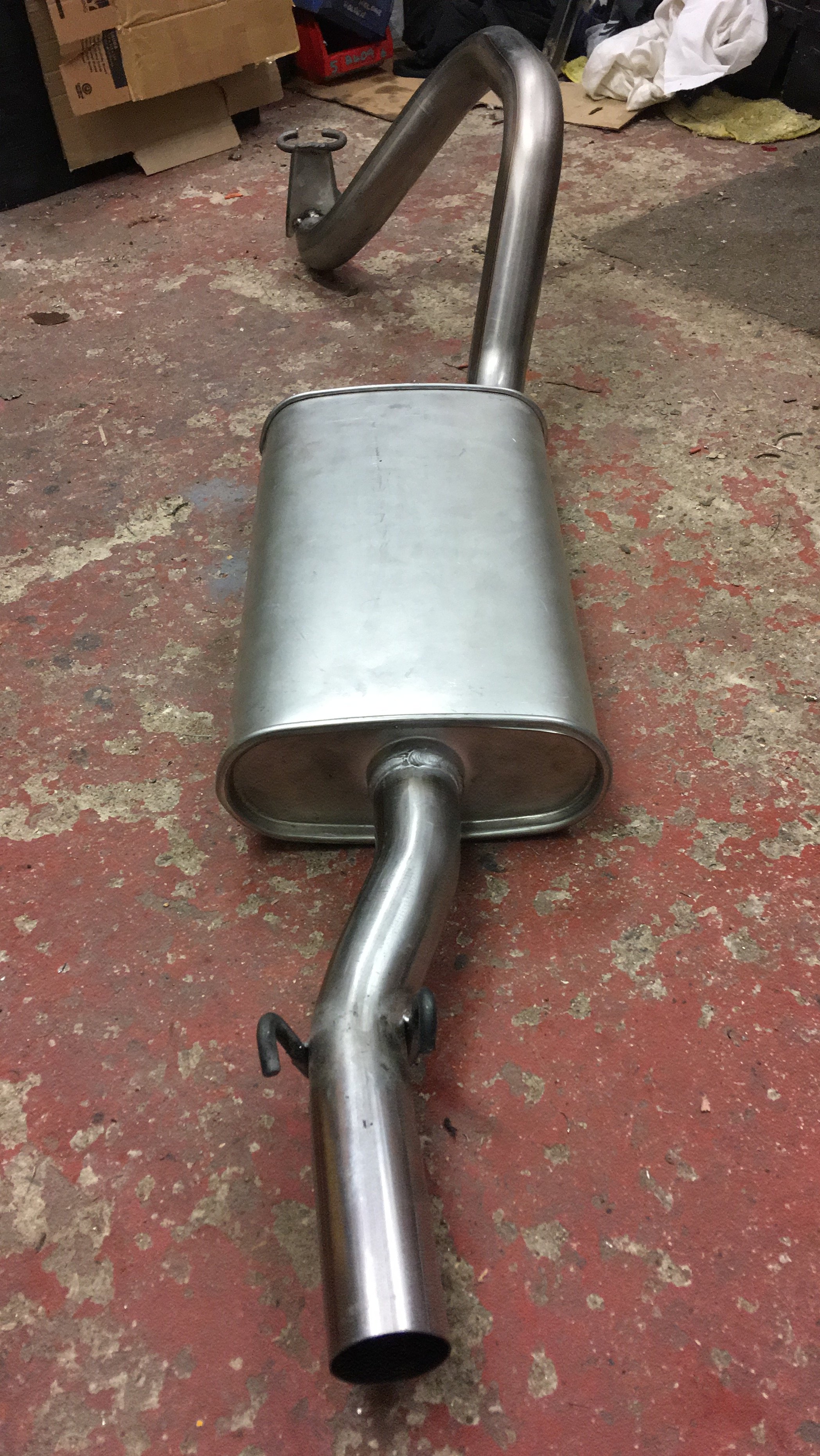

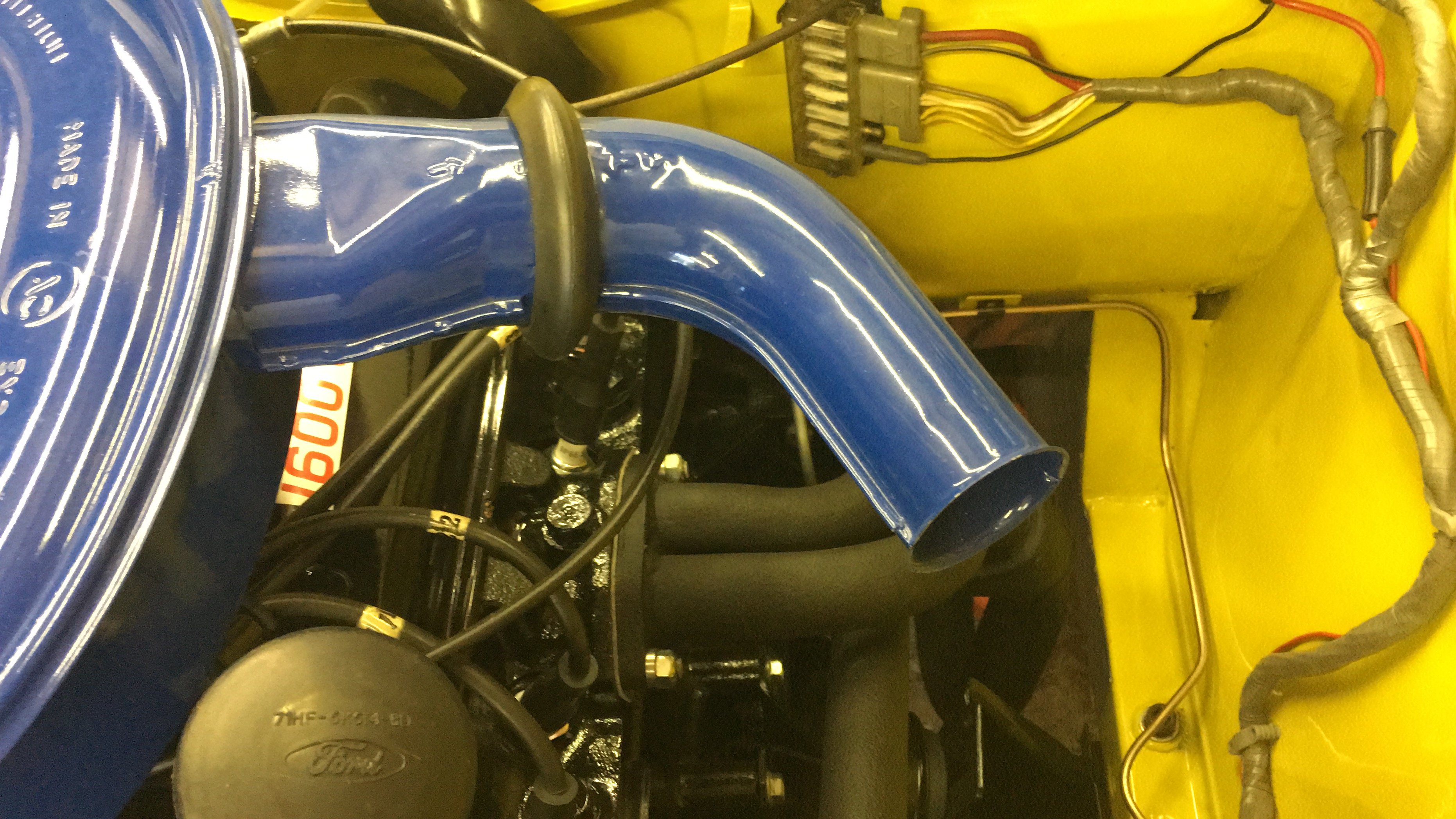

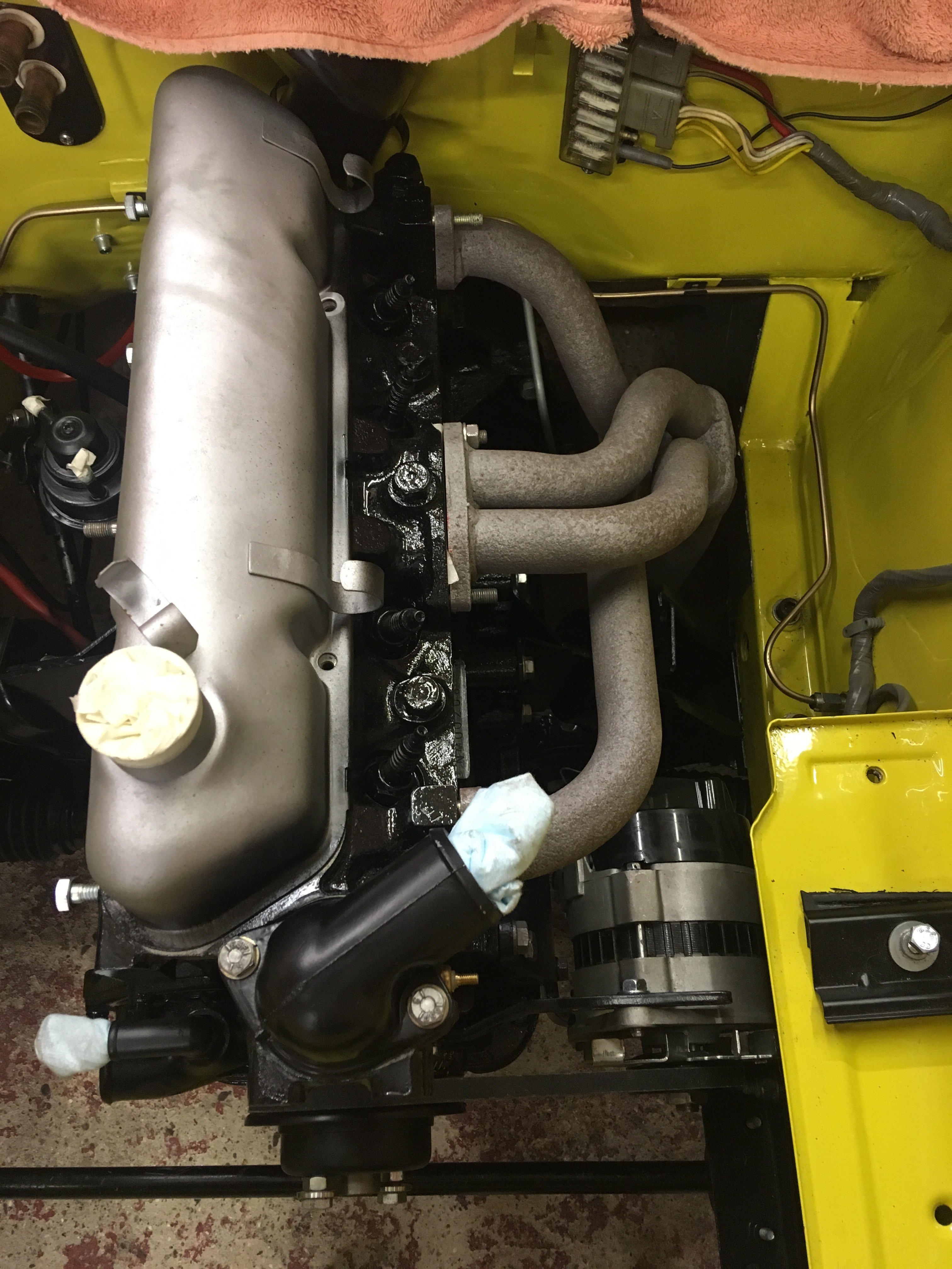

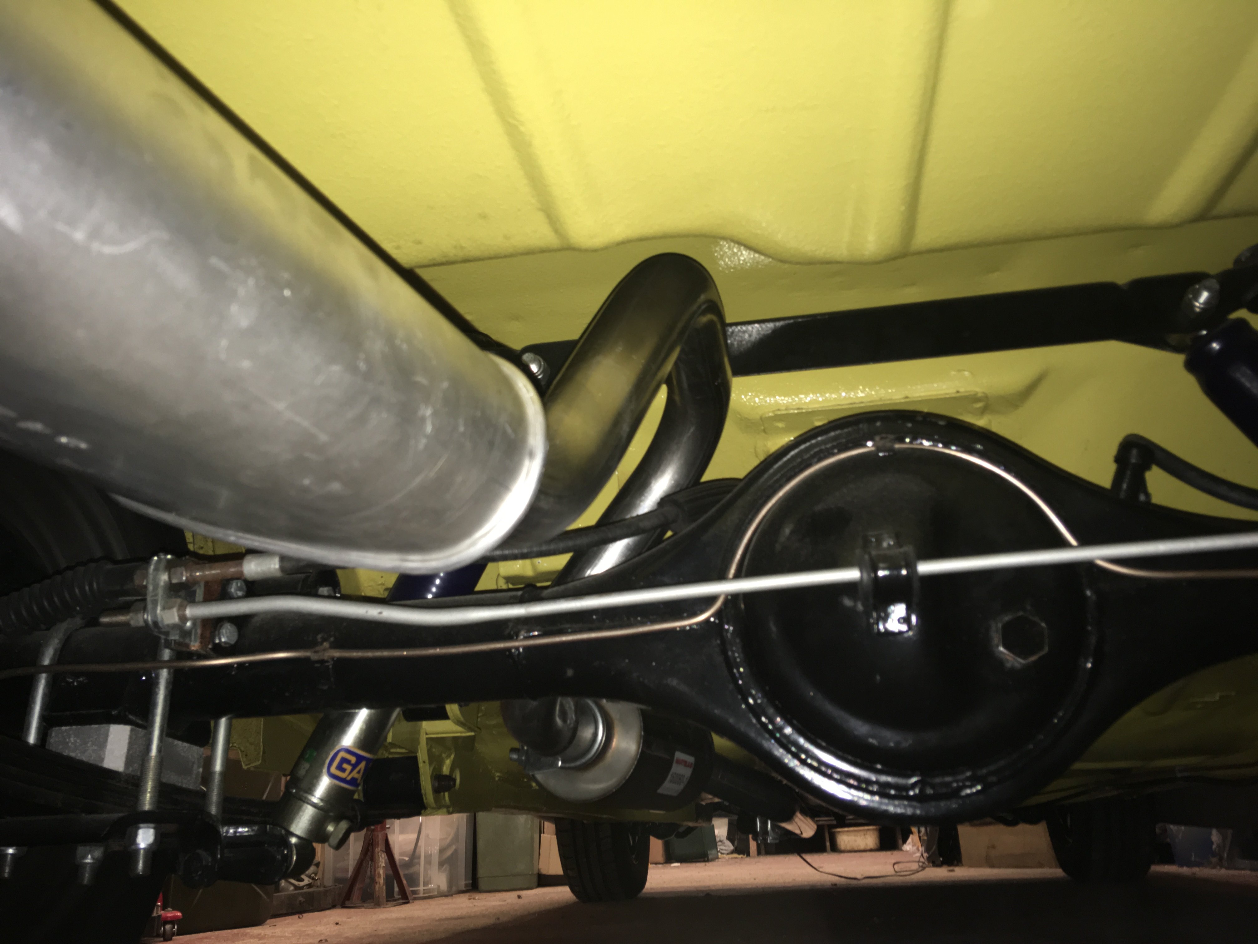

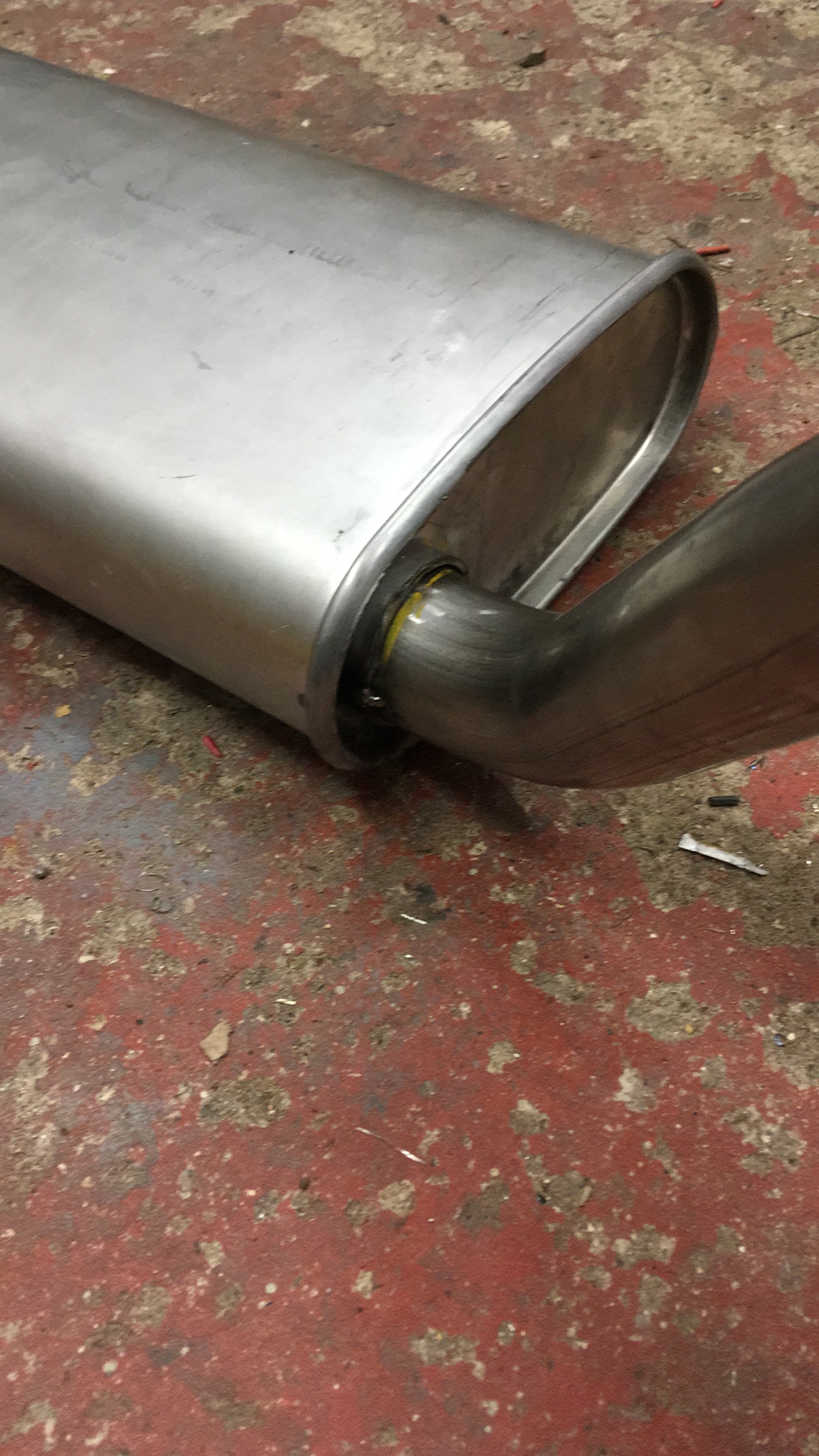

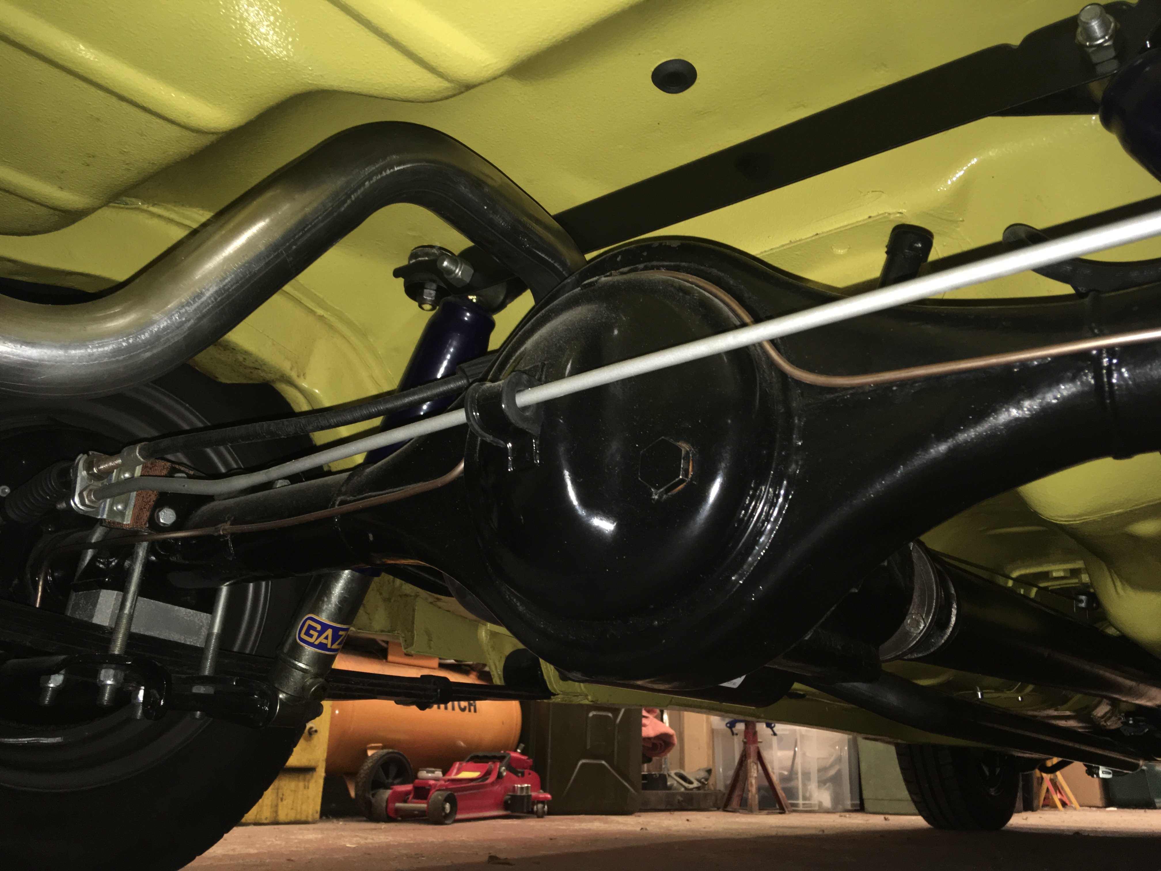

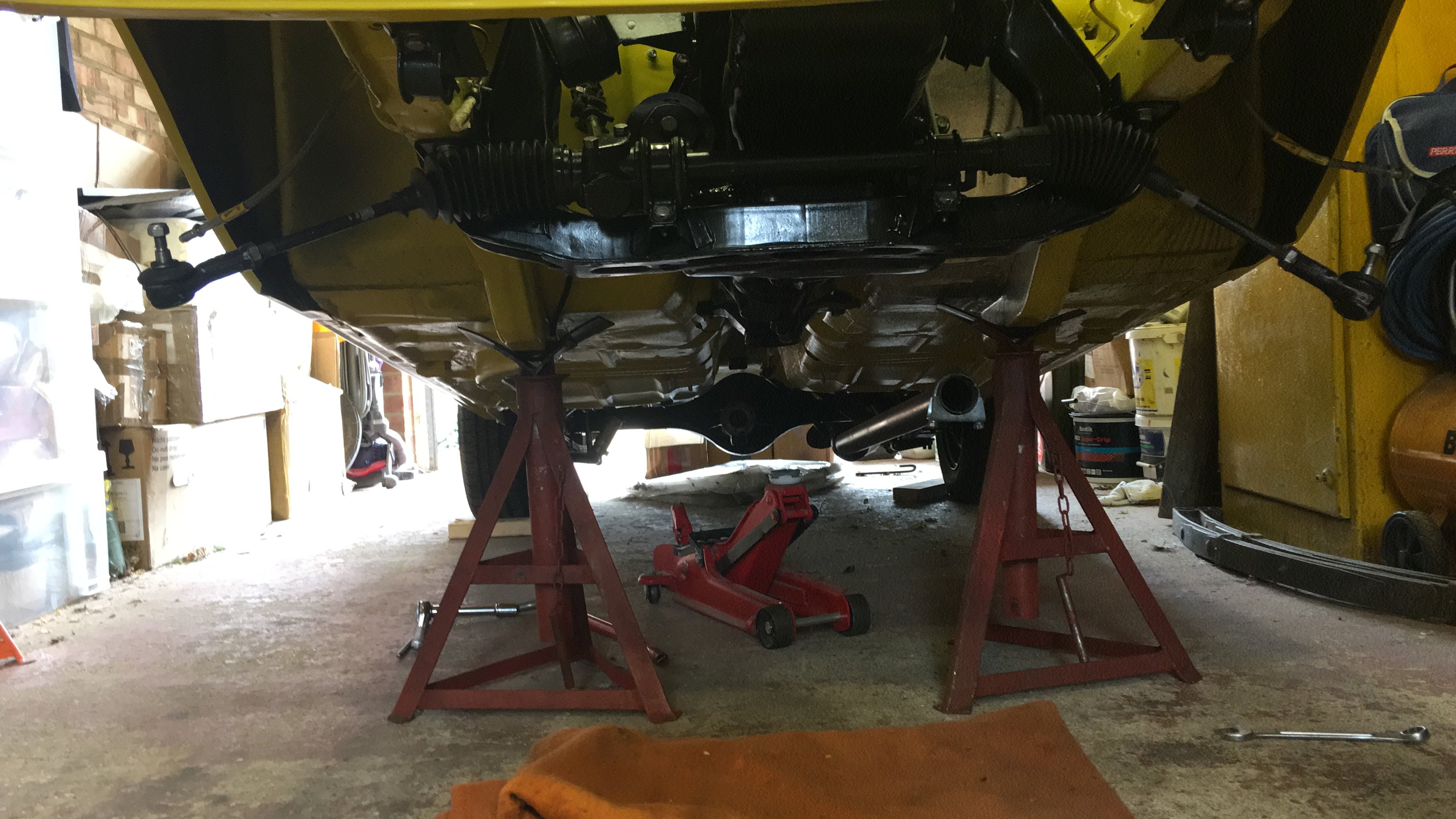

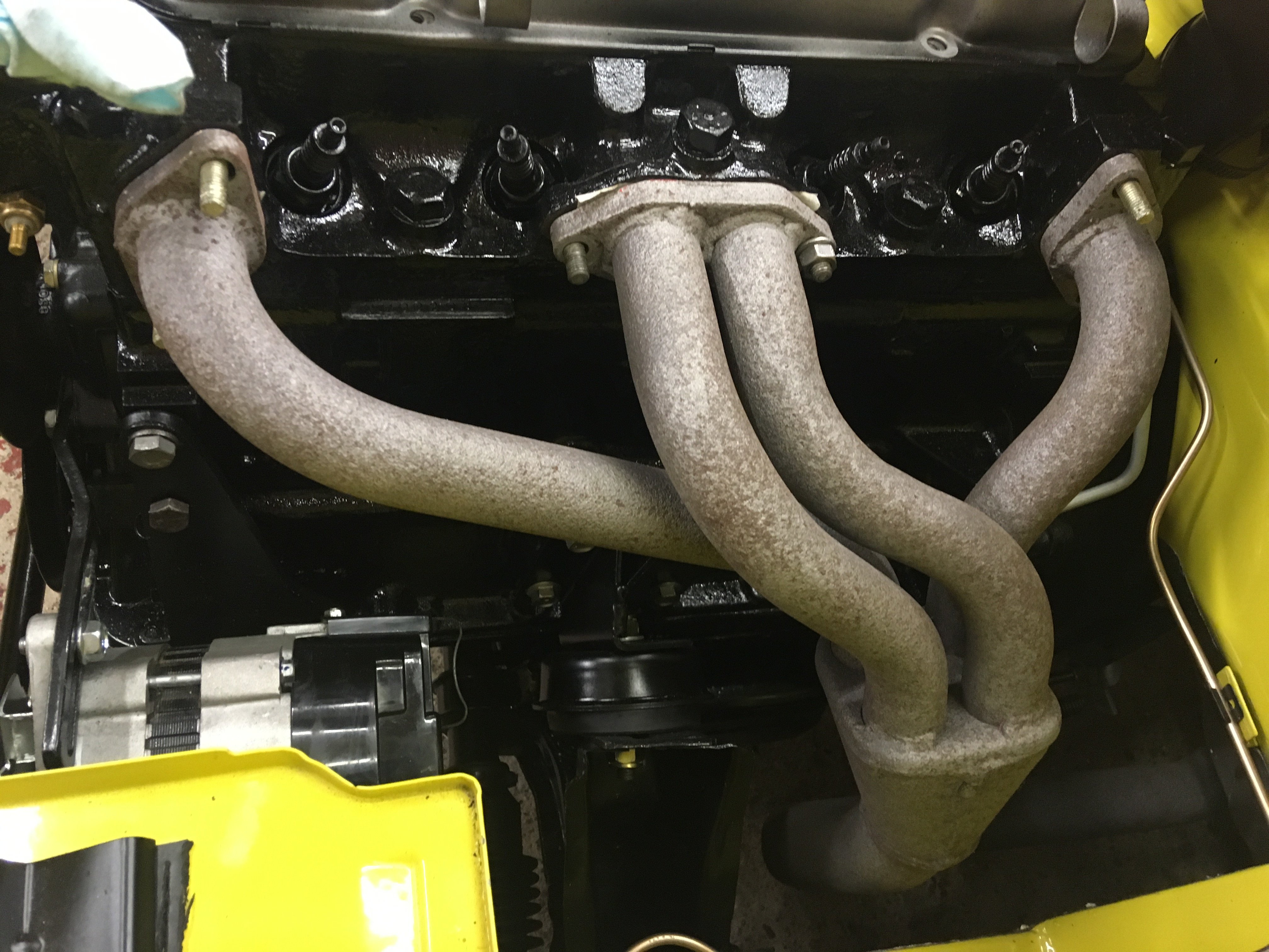

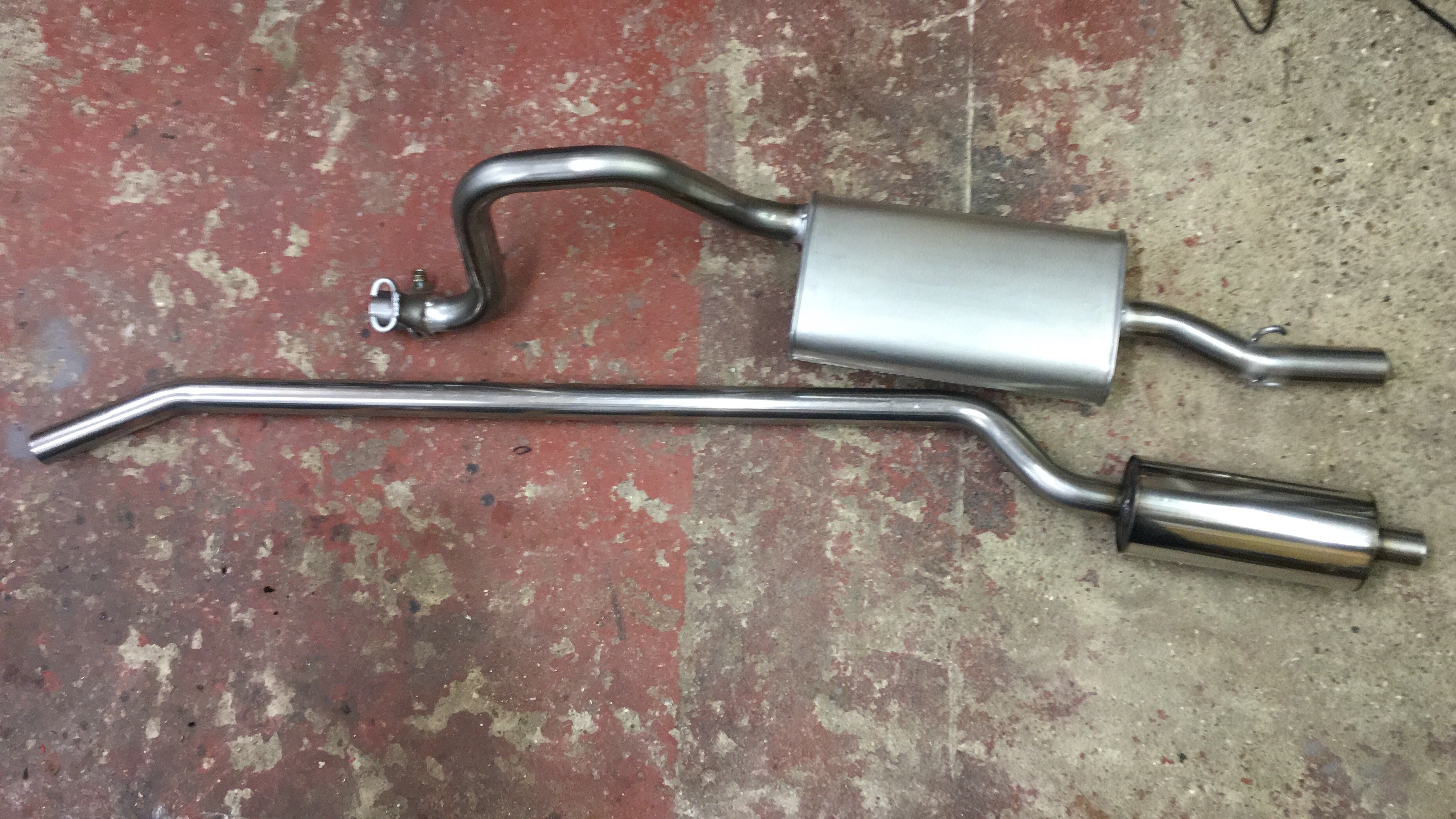

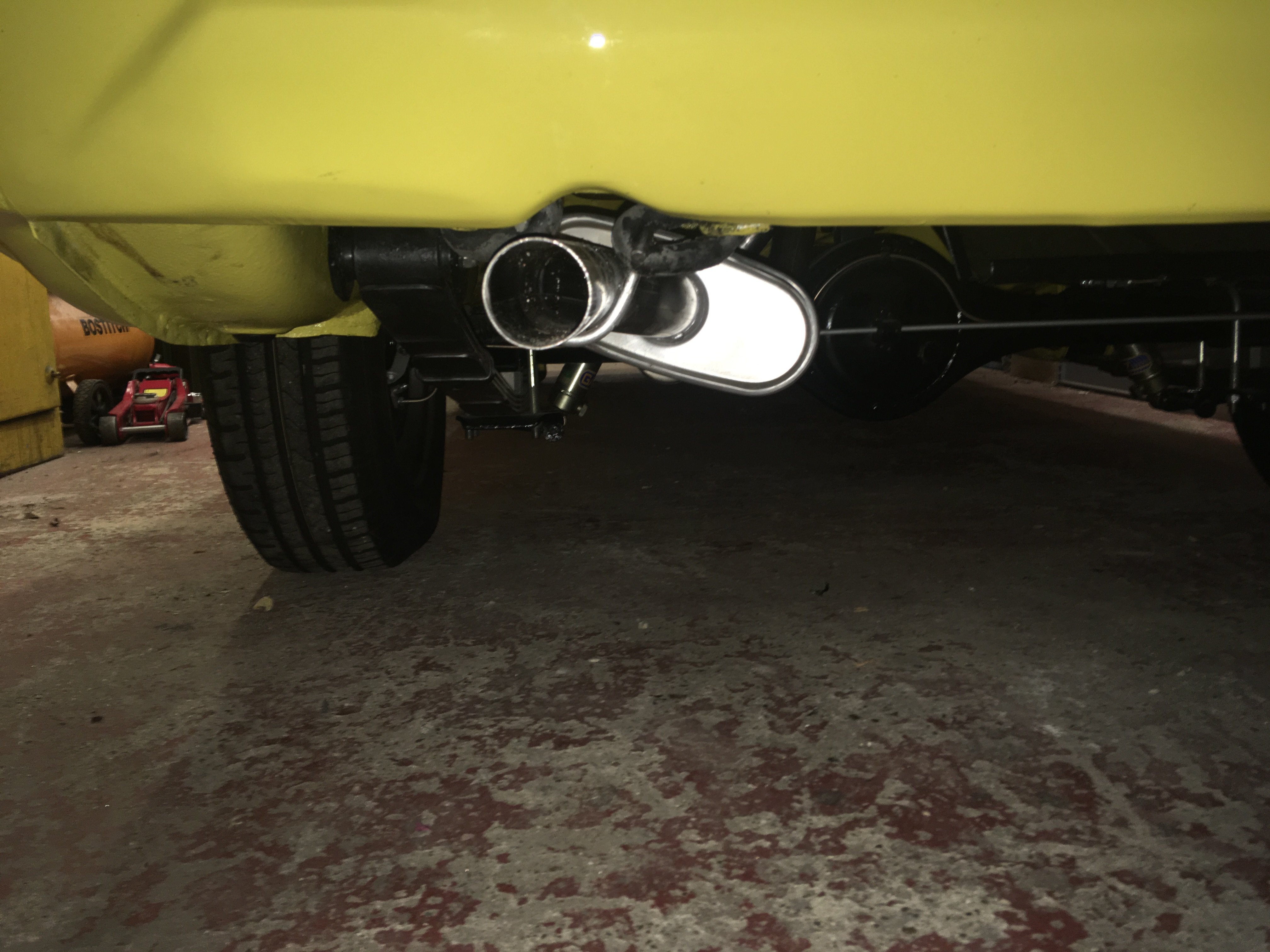

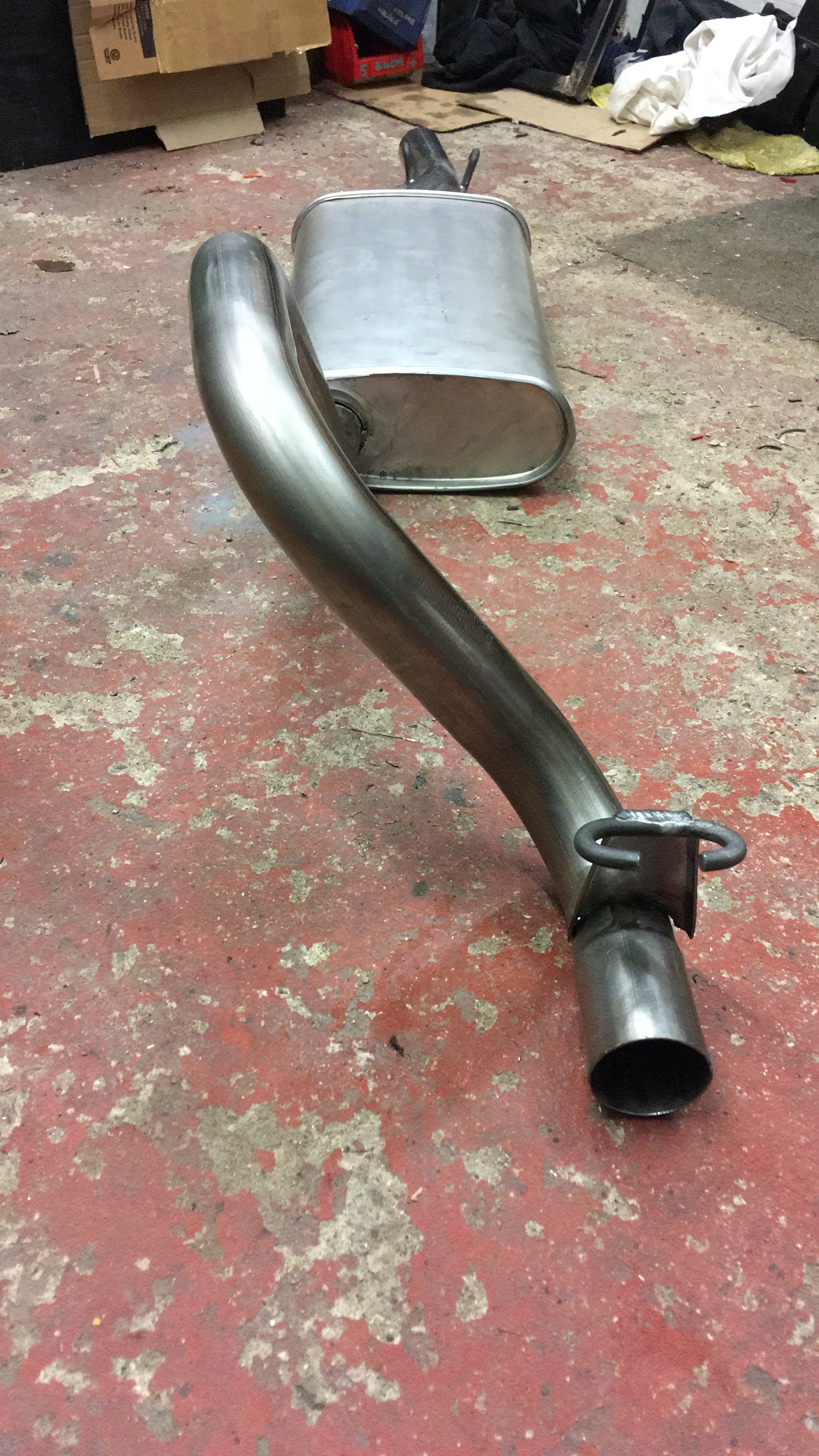

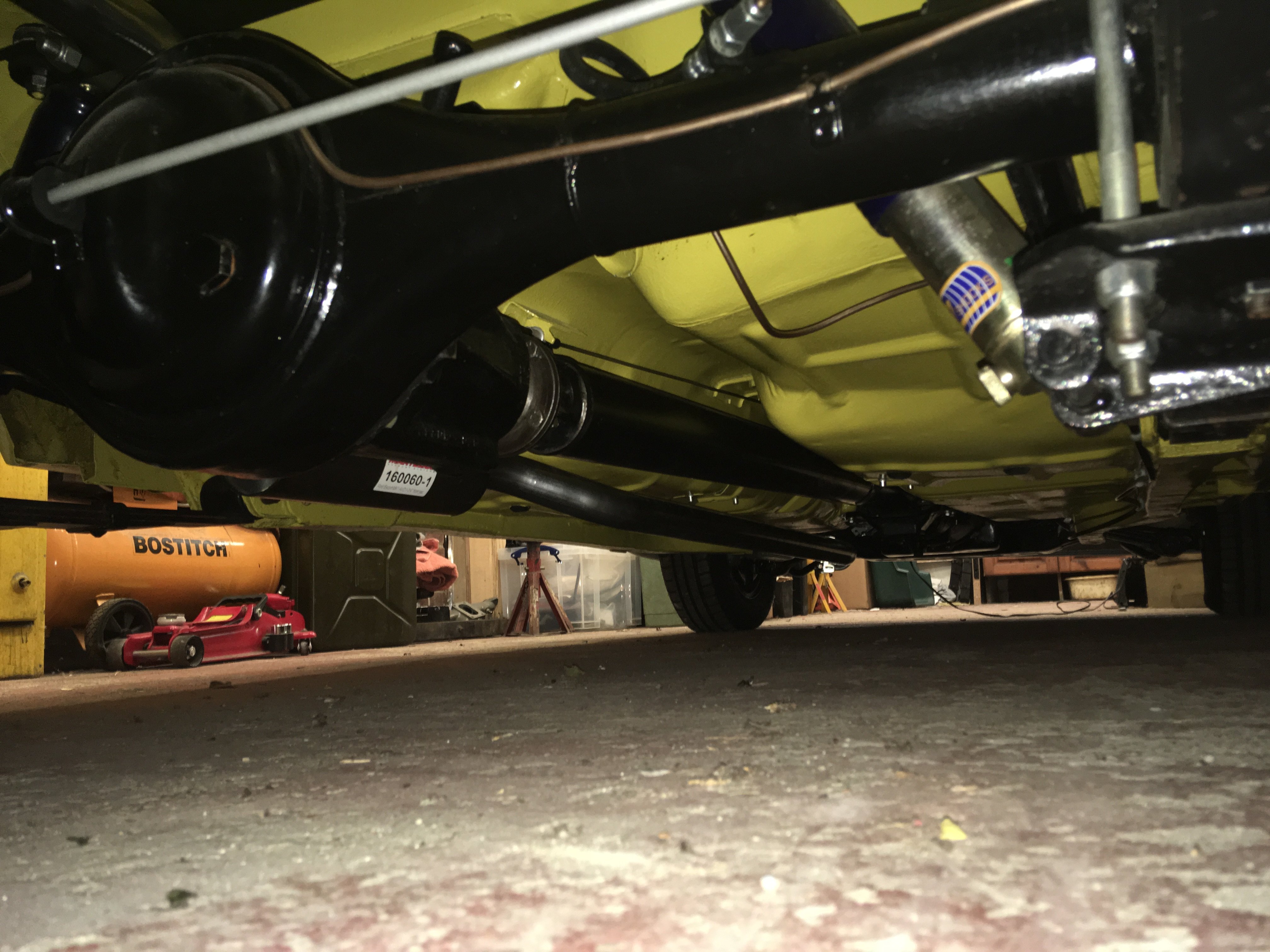

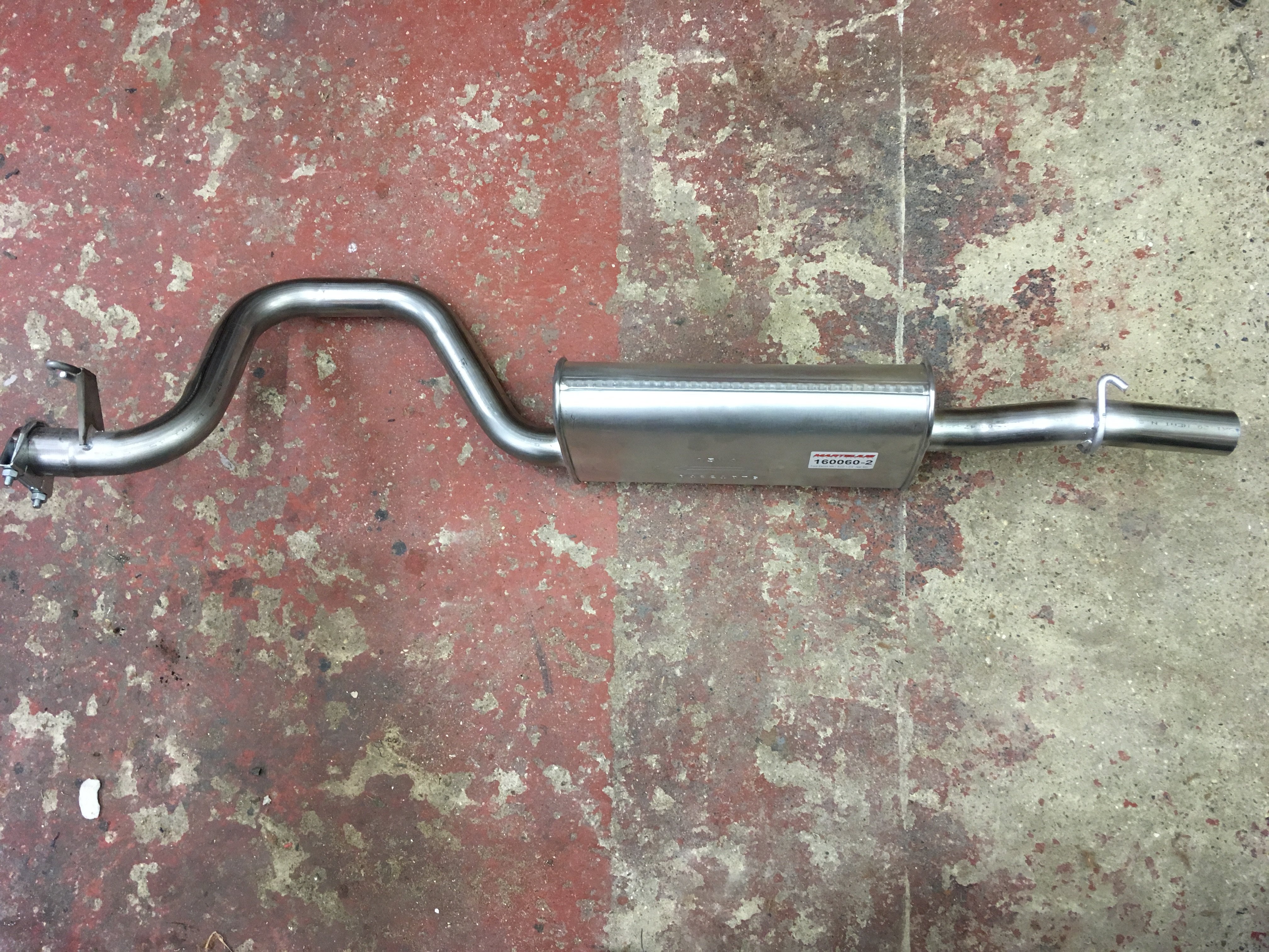

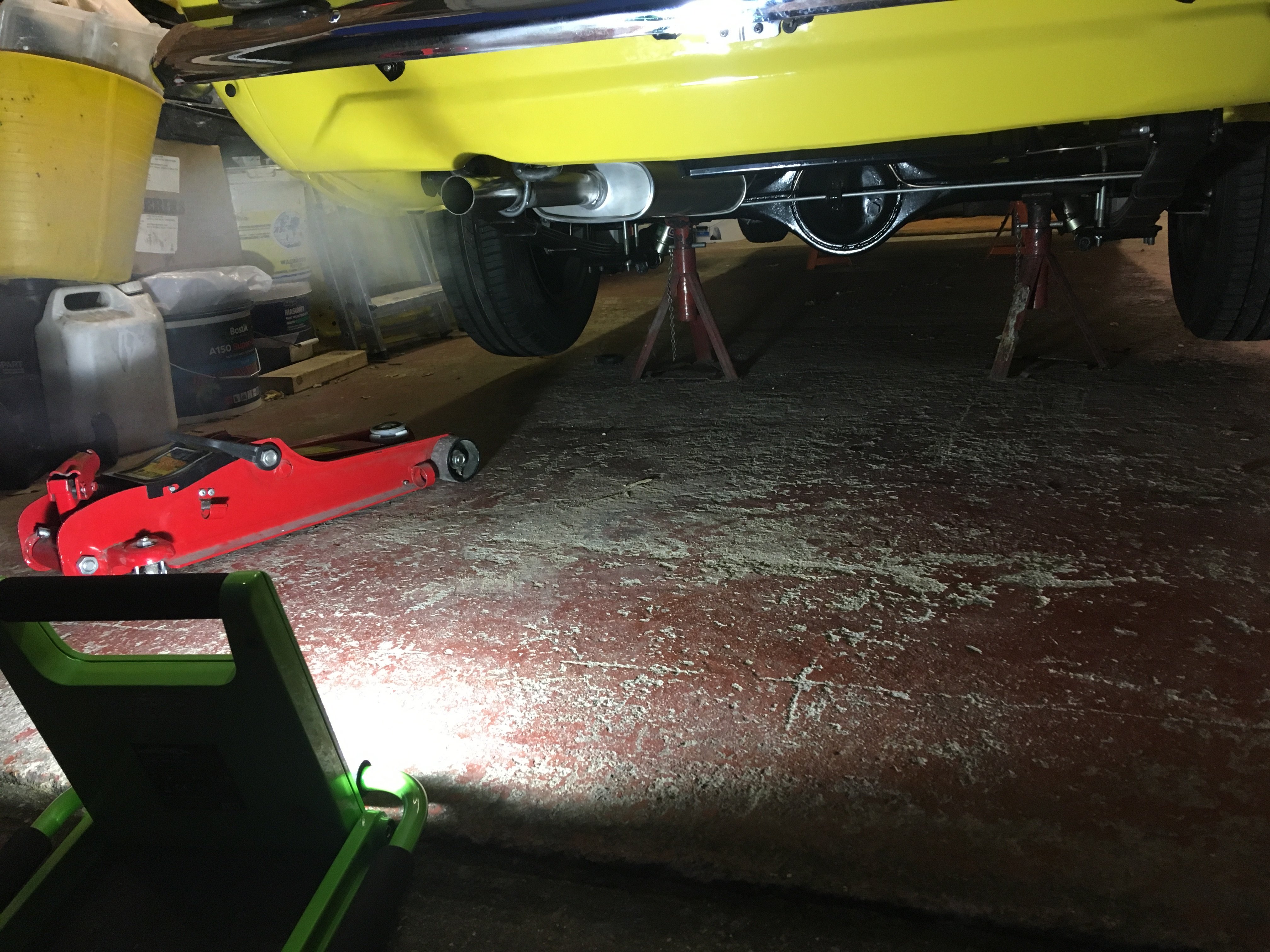

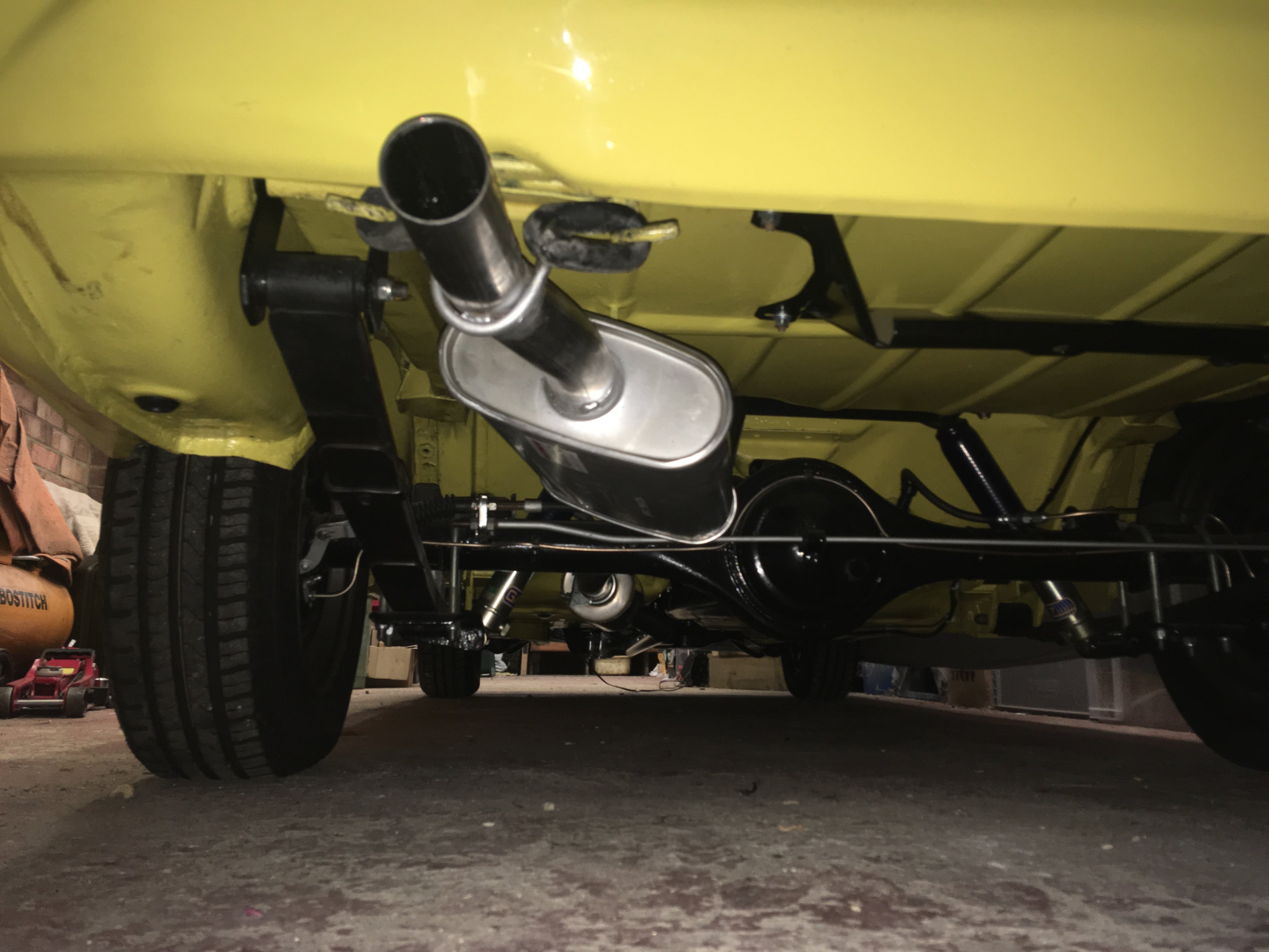

My next problem was i had a sportex 2” bore exhaust system originally fitted , which i hated to be honest as the headers were high in the engine bay causing a lot of heat high up even to the point of melting the 1600GT decal on the rocker cover !!. I was glad to have the 4 into 1 manifold in the correct 1 and 3/4” bore . The next headache was to find a mid and rear section to suit the bore size . I found a company in Finland called Martelius they had one of each in stock . I made a straight sleeve to couple up the manifold to the mid box . The last problem was the rear section  didnt fit the rear suspension set up on my car , this was designed for turreted shocks not shocks mounted on the frame . I had to angle it to clear this , but it made the rear box sit incorrect in relation the the boot floor .

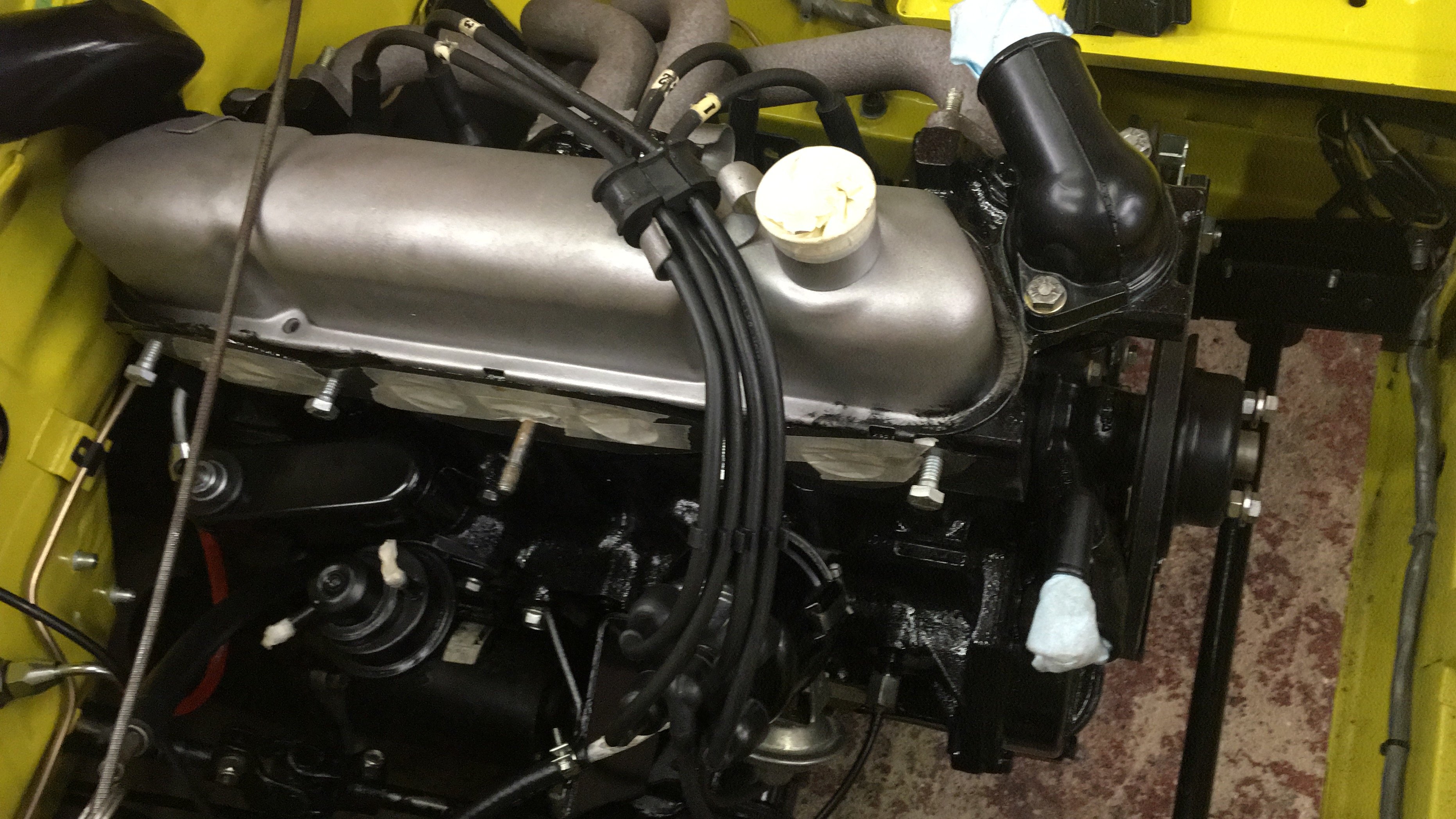

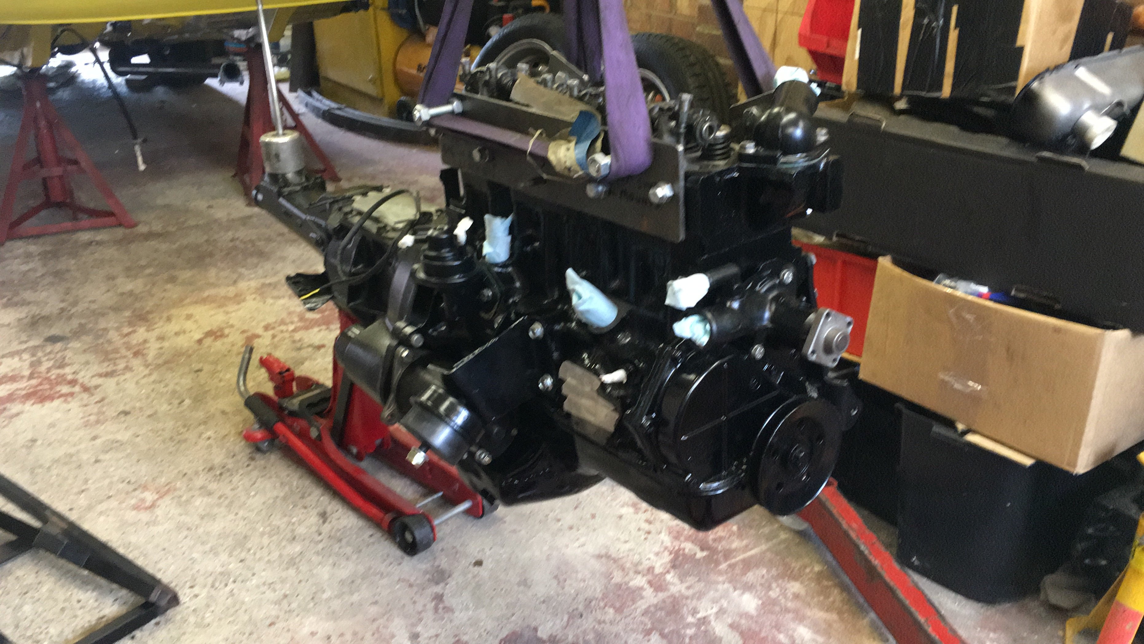

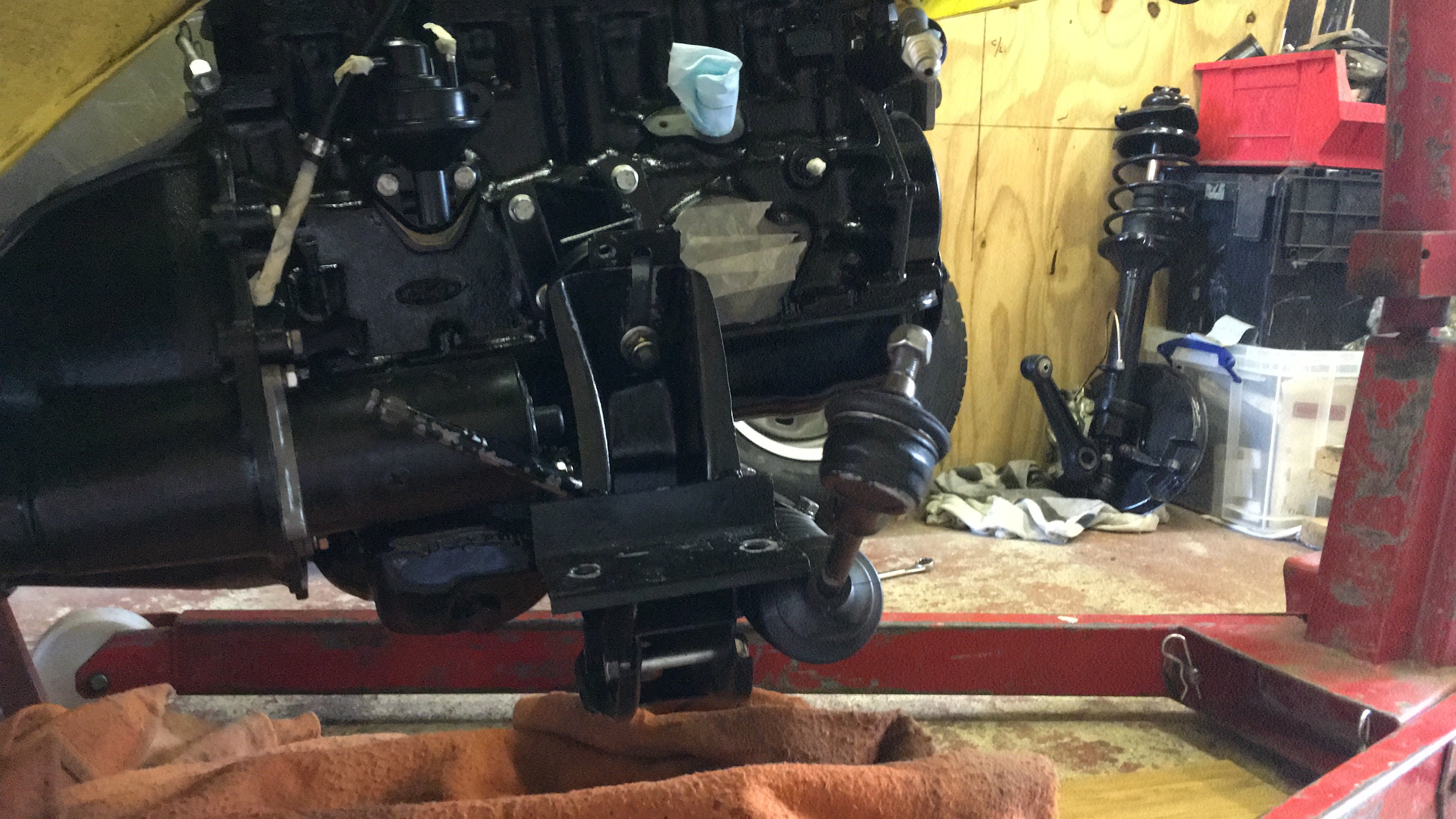

what size is the crank? Standard or reground already?
And what are the small ends like? Best to check whilst it’s  out?
 The original crank had already been reground so was beyond another regrind , it also had new pistons and little ends during the second rebuild as well . 👍

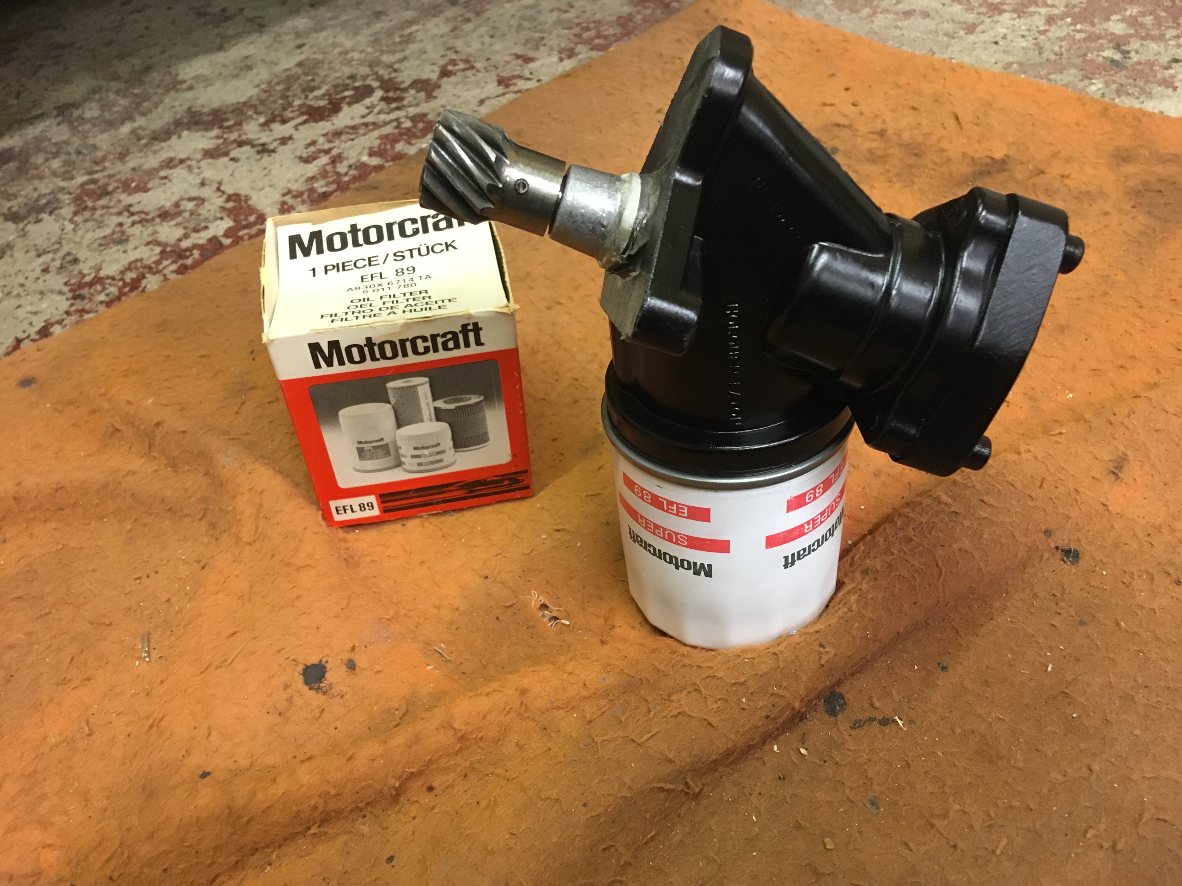

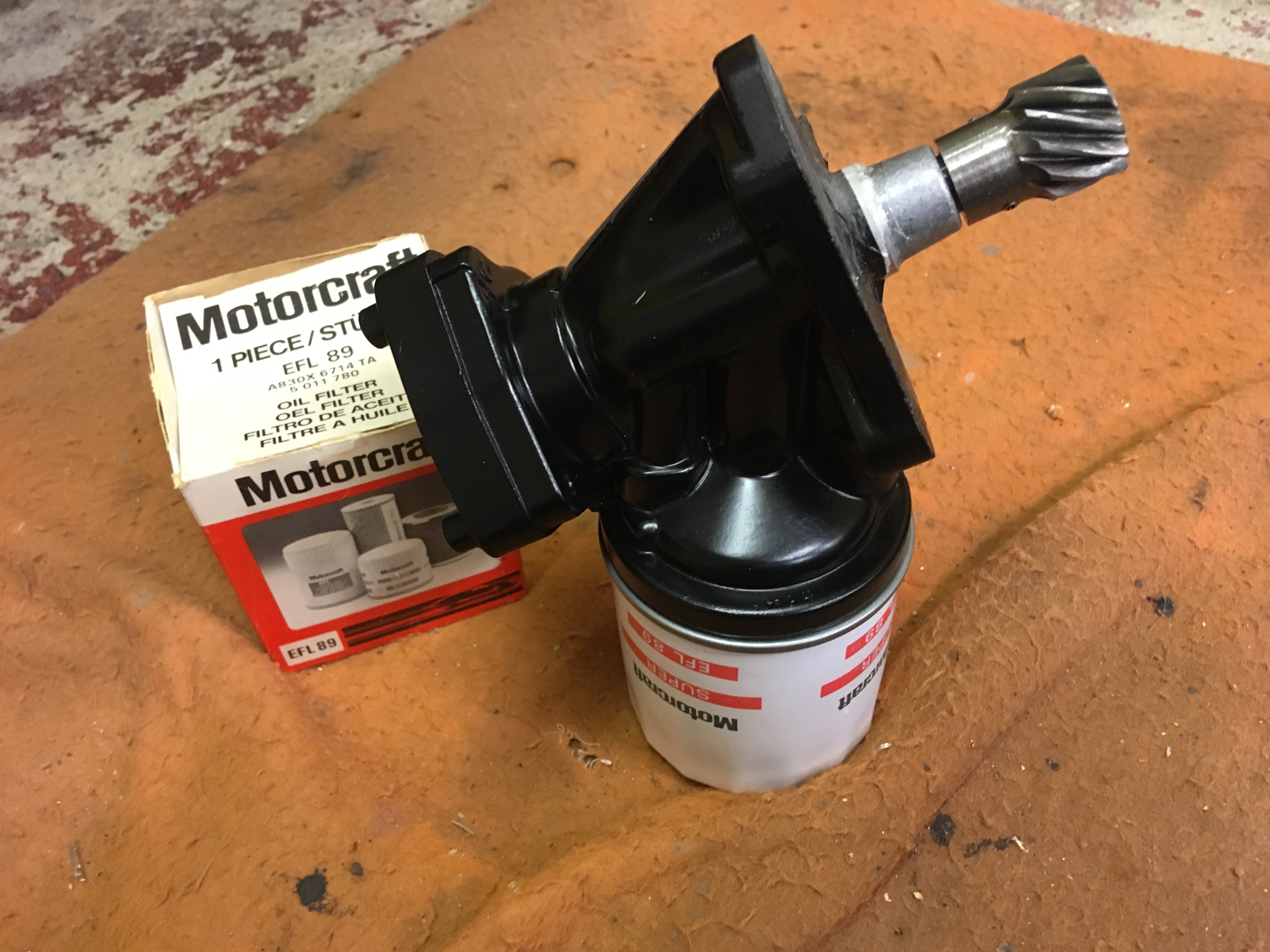

I have also fitted an Aldon ignitor electronic ignition to an original motorcraft dizzy that Ray very kindly built for me to the correct spec for the Mexico as the one that came with the car was totally wrong . Its also Now fitted with an Aldon flamethrower coil .The initial engine start up was nerve racking to say the least 🥴, but all was fine. Oil pressure is spot on now . On initial start up its around 55/60 psi dropping to around 30/35 psi when fully warmed up on tickover .  I have now covered just over 100 miles on the newly rebuilt engine and all seems good apart from an oil leak from the top of the gearbox cover plate with the breather hole in it somewhere !! Another job over the winter months to sort out .
Finally .

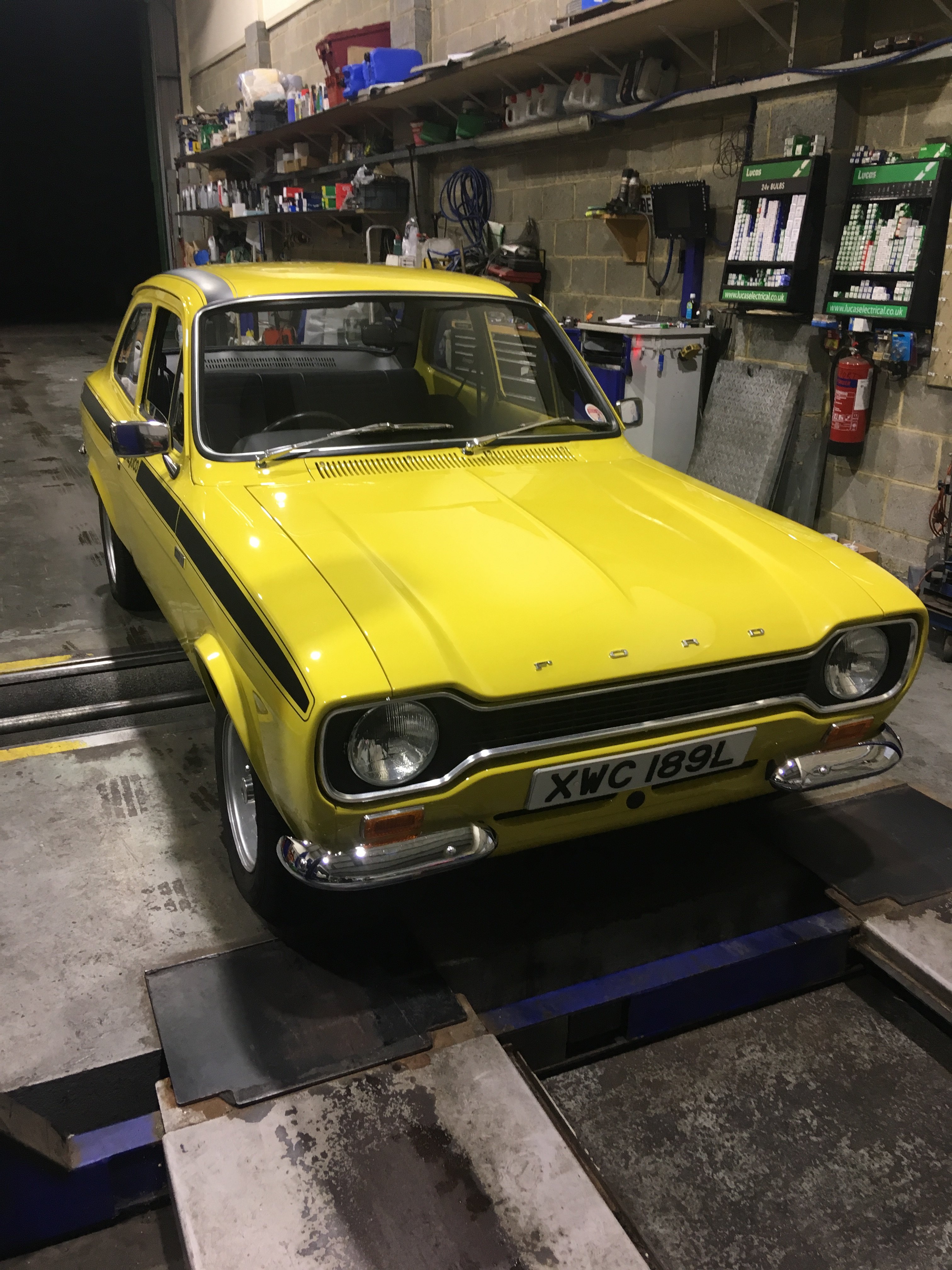

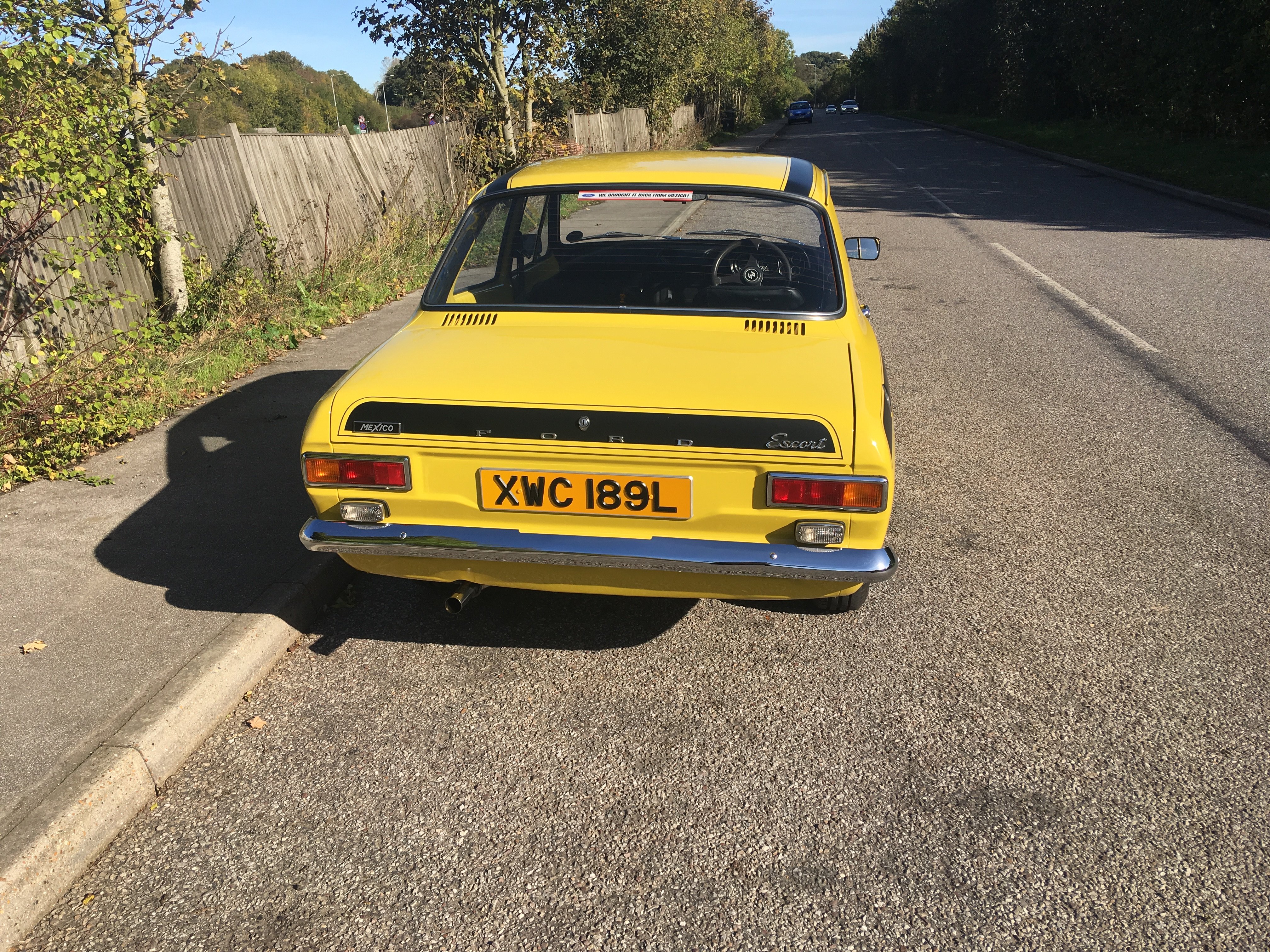

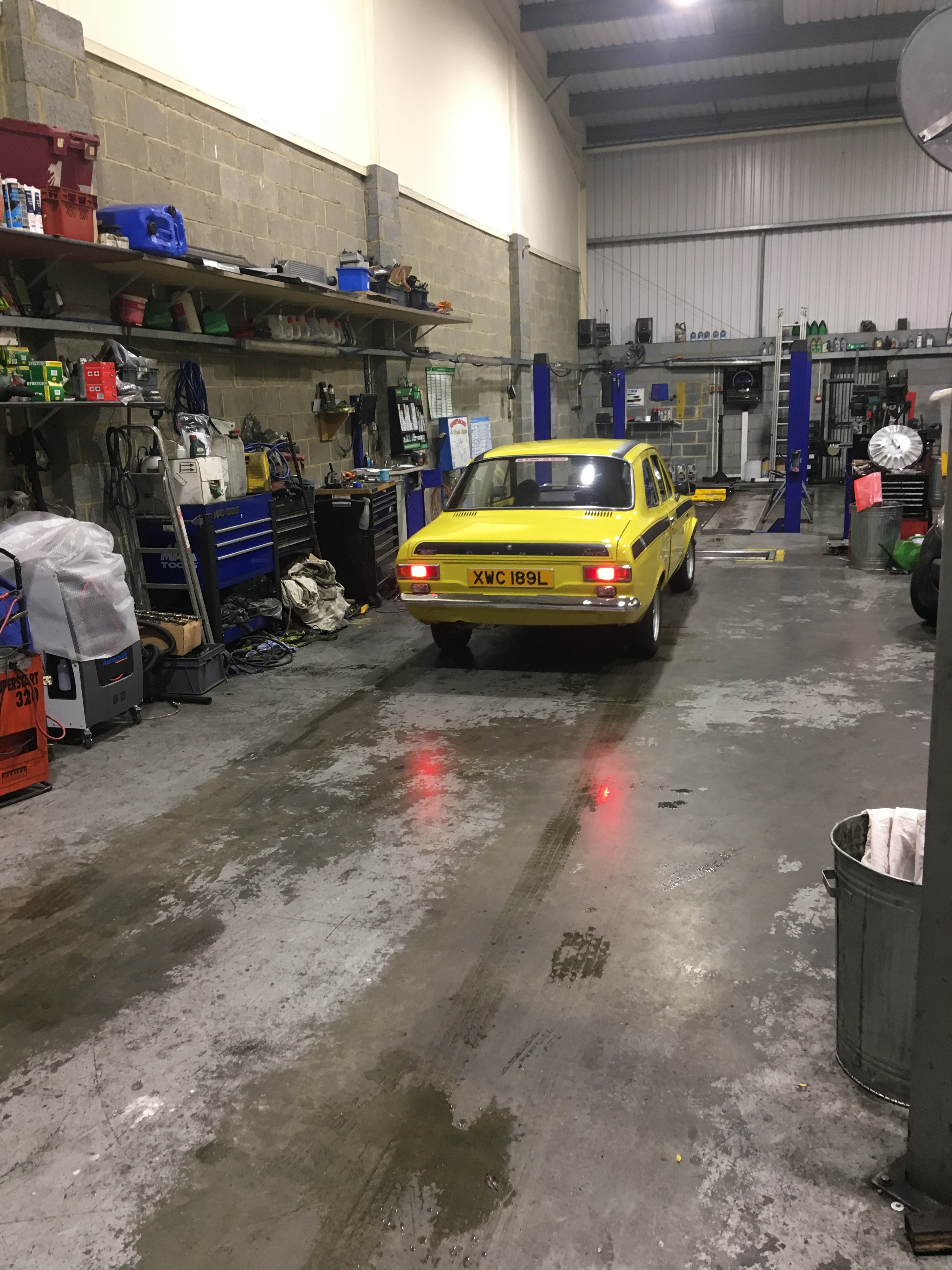

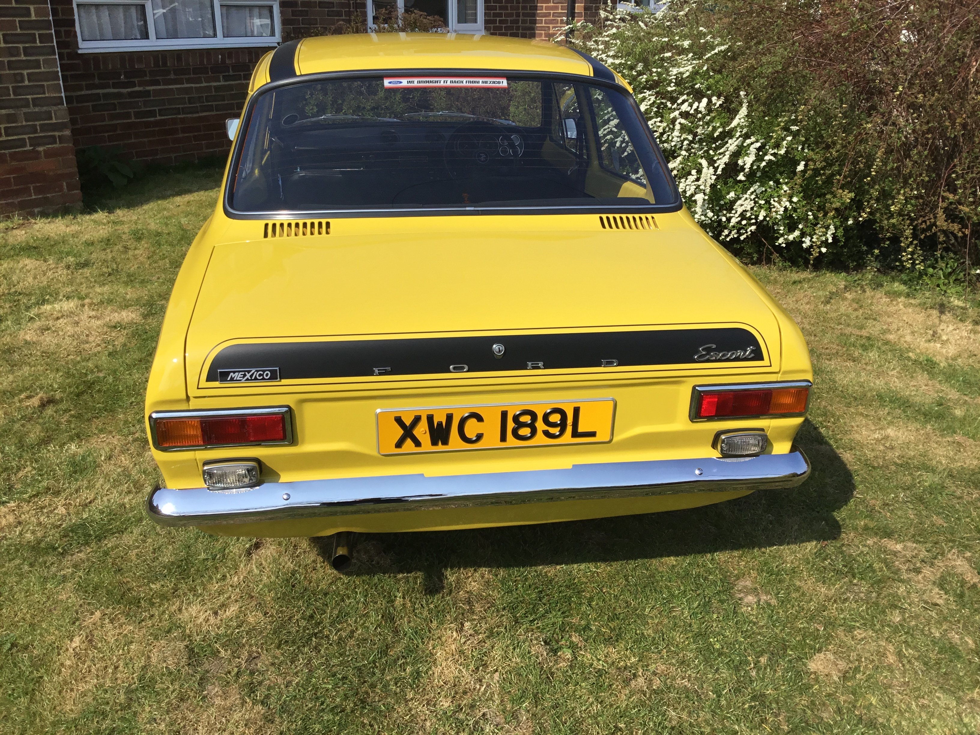

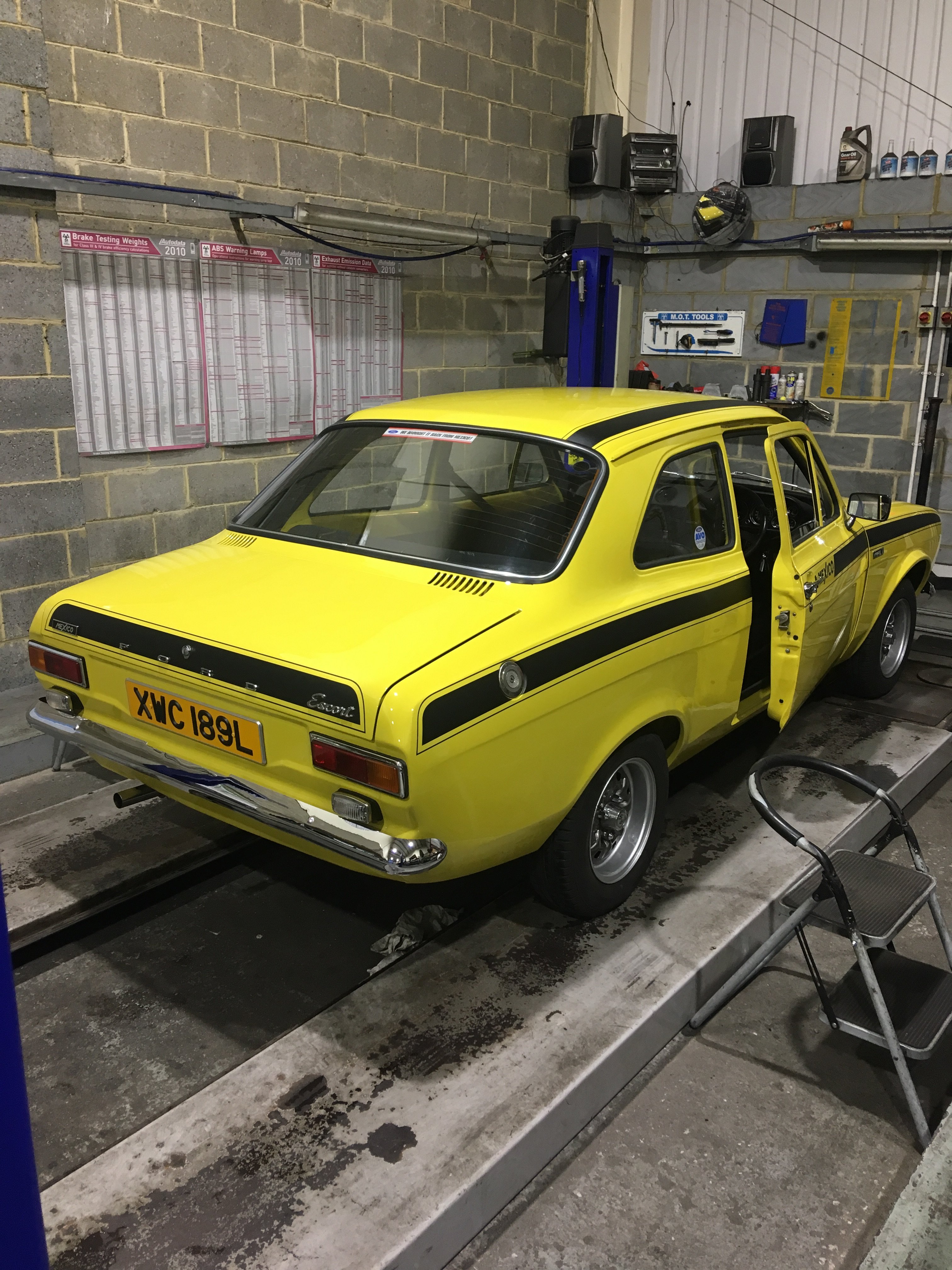

Last saturday the Mex went for its 3rd Mot since i have owned it and it was all good and passed ok . So now can look forward to using it on high days and dry days as they say . So at this moment in time all is well with the Mexico Finally 😁😁👍. Seeing as it was nice the day after the mot i took it out for a 45 mile run .....
my overall verdict .?
LOVE IT 👍.
