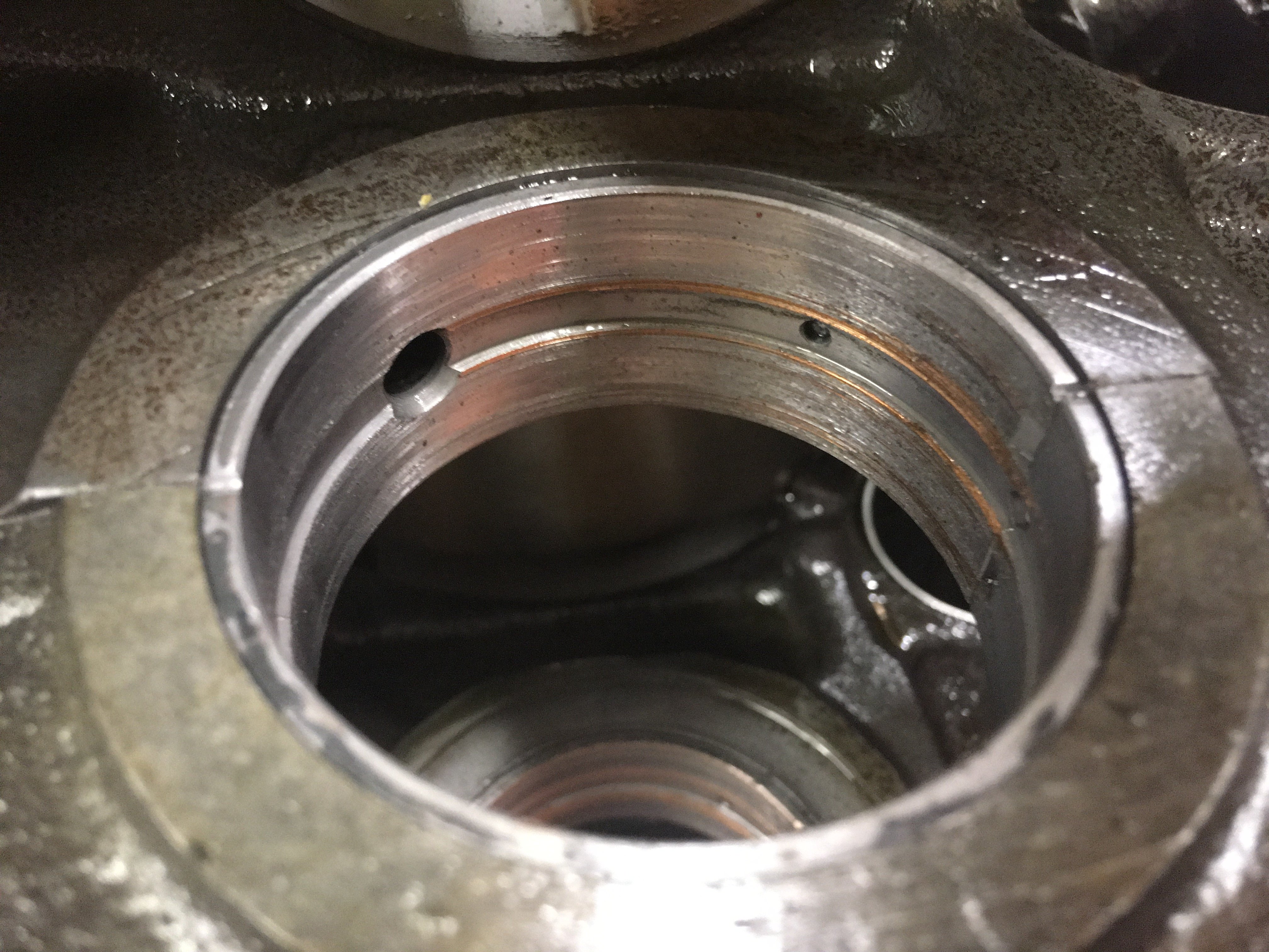

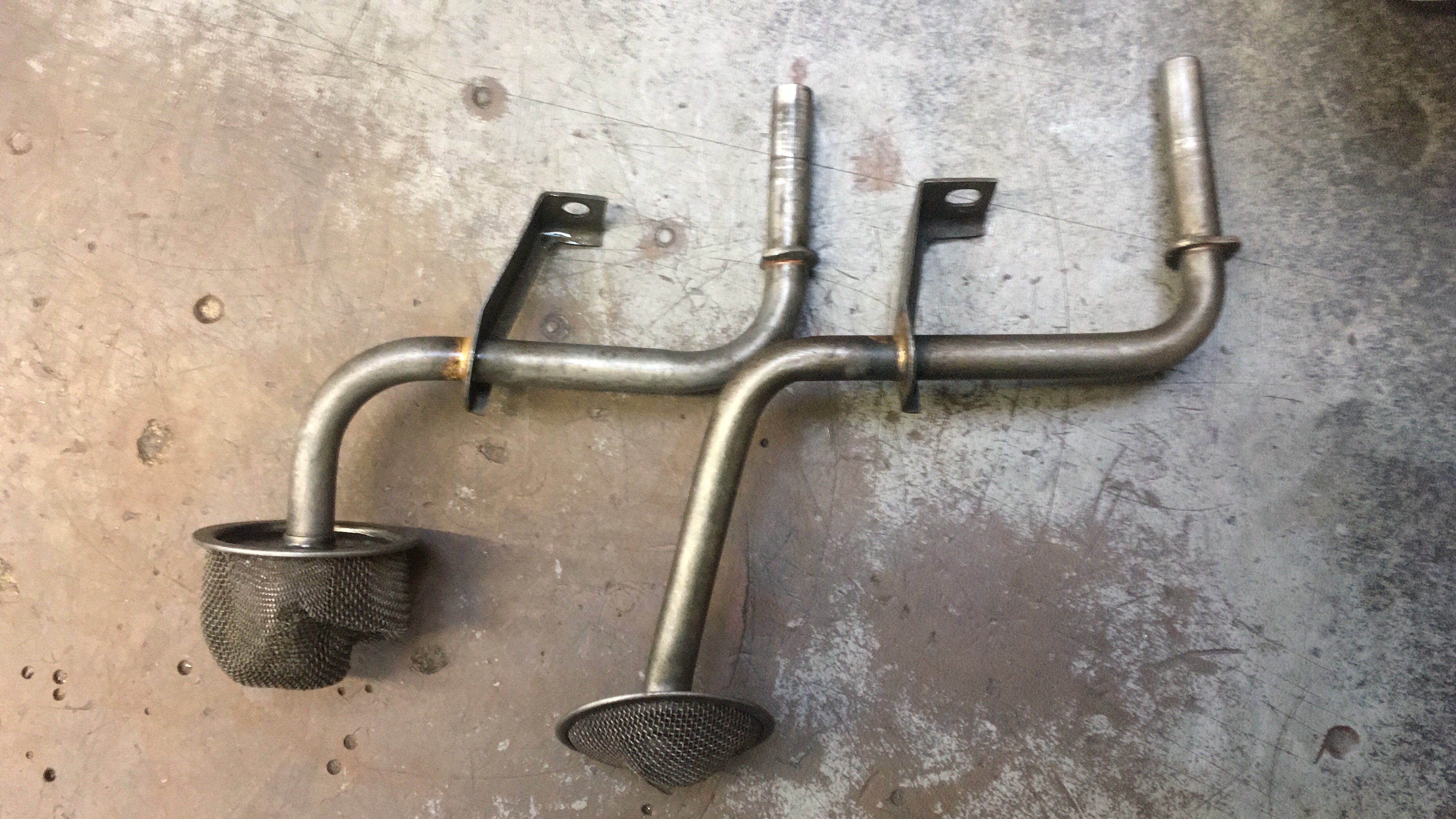

Jerrytom161 Posted October 30, 2019 Author Report Posted October 30, 2019 A bit of an update on my Mexico since the Mot in 2018 :- i have been gradually using the car less and less as it has been having oil pressure issues . It has always been fine on initial start up when cold with around 60/65 psi .... but once the engine has reached normal temperature it was dropping to at worst 10/12 psi ( on the red on the gauge ) maybe less . I have been concerned for the last 2 years and asked many people for their opinions and advice in different clubs etc , some said its normal keep using it , and some say you have a problem ( which deep down i suspected ) . Some said look at your oil pump . I originally started with a brand new high pressure one , then changed to high capacity one , then in the end it was high pressure high capacity one . This changed it for a while but in the end something had to be wrong , i also had a silvery type film in the oil during changes . In the end i stopped using the car for fear of damaging the engine . In May this year after much conversing with Ray ( 1300E’s) , he persuaded and advised me to ignore all the advice i had been given . It was decided to remove the engine / gearbox and investigate what was causing the low oil pressure . once i had done this i removed the sump to inspect . The bottom of the inside of the sump was all sludgy and contaminated , especially in the very bottom under the baffle plate . Prior to me doing this i discovered by chance looking at a Mexico big wing sump and oil pick up pipe for sale on e bay that mine looked different . I looked at old photos I had from my original engine build , there laid my cause of low oil pressure when hot . GUTTED to say the least . Someone in the history of my Mexico for whatever reason had fitted a standard 1600 crossflow oil pick up pipe not a Gt one. !!! Correct one on the right of the photo . Totally different in length and pipe shape 1

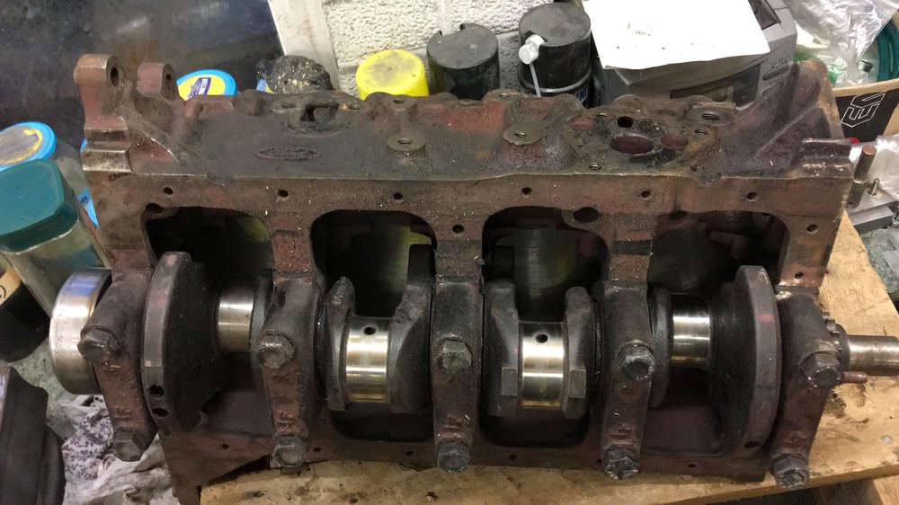

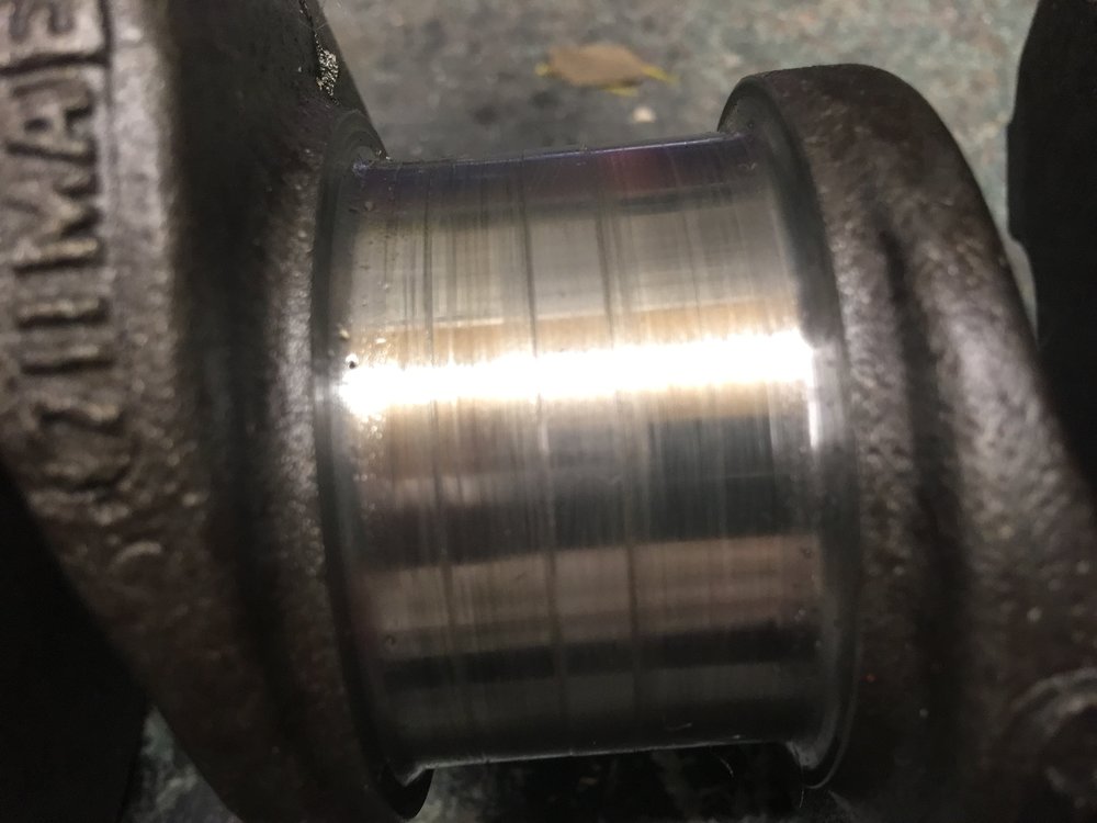

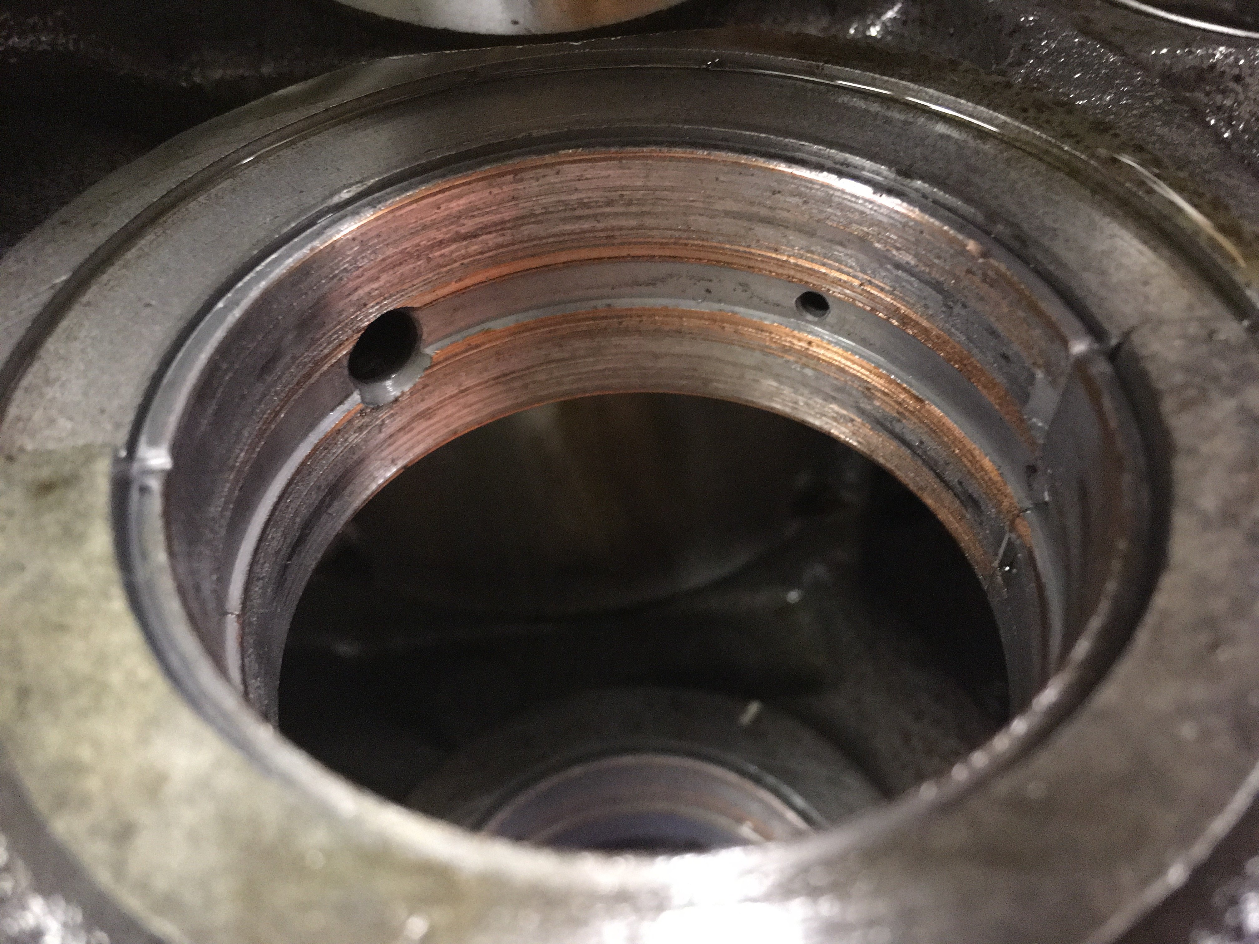

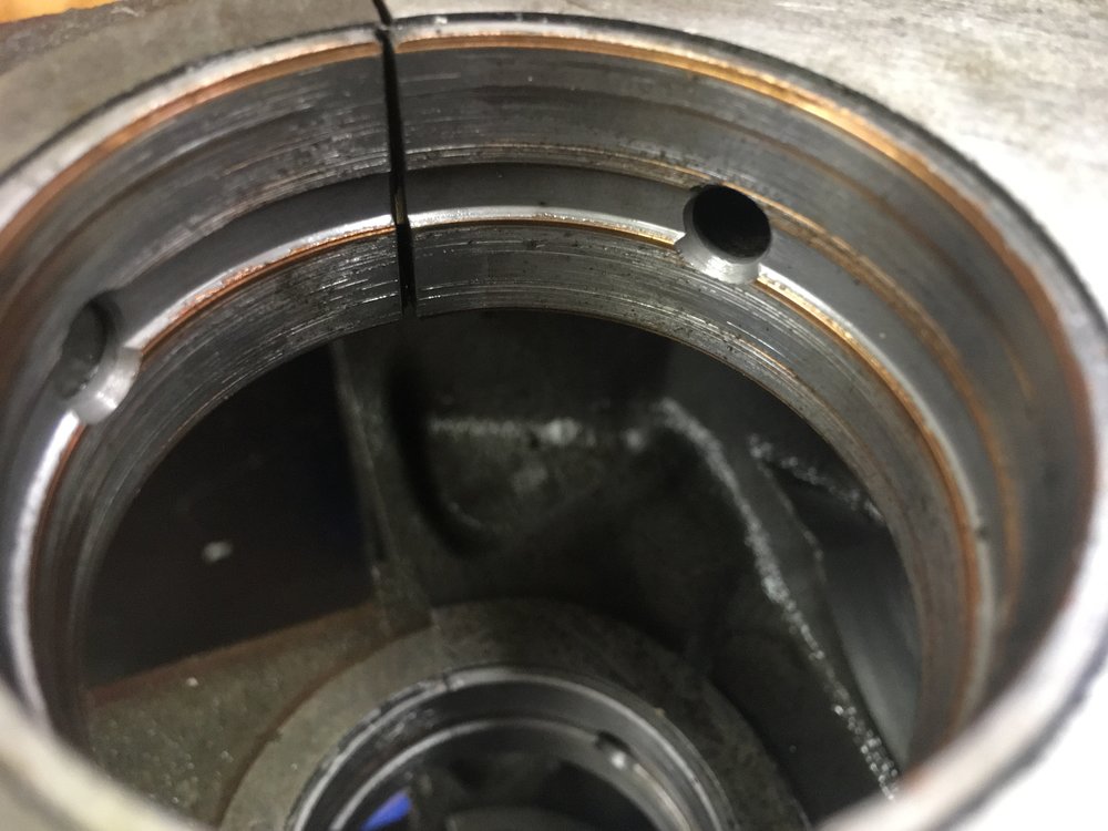

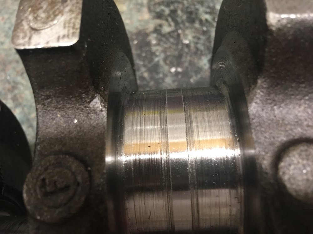

Jerrytom161 Posted October 30, 2019 Author Report Posted October 30, 2019 Ray then very kindly picked my engine up from my place and took it his engine builder in Essex for a total strip down and assessment of any damage . We were horrified to say the least . The crankshaft journals were all destroyed , main bearings and big end shells were totally ruined . 1
notenoughtime Posted October 30, 2019 Report Posted October 30, 2019 Ouch what size is the crank? Standard or reground already? And what are the small ends like? Best to check whilst it’s out?

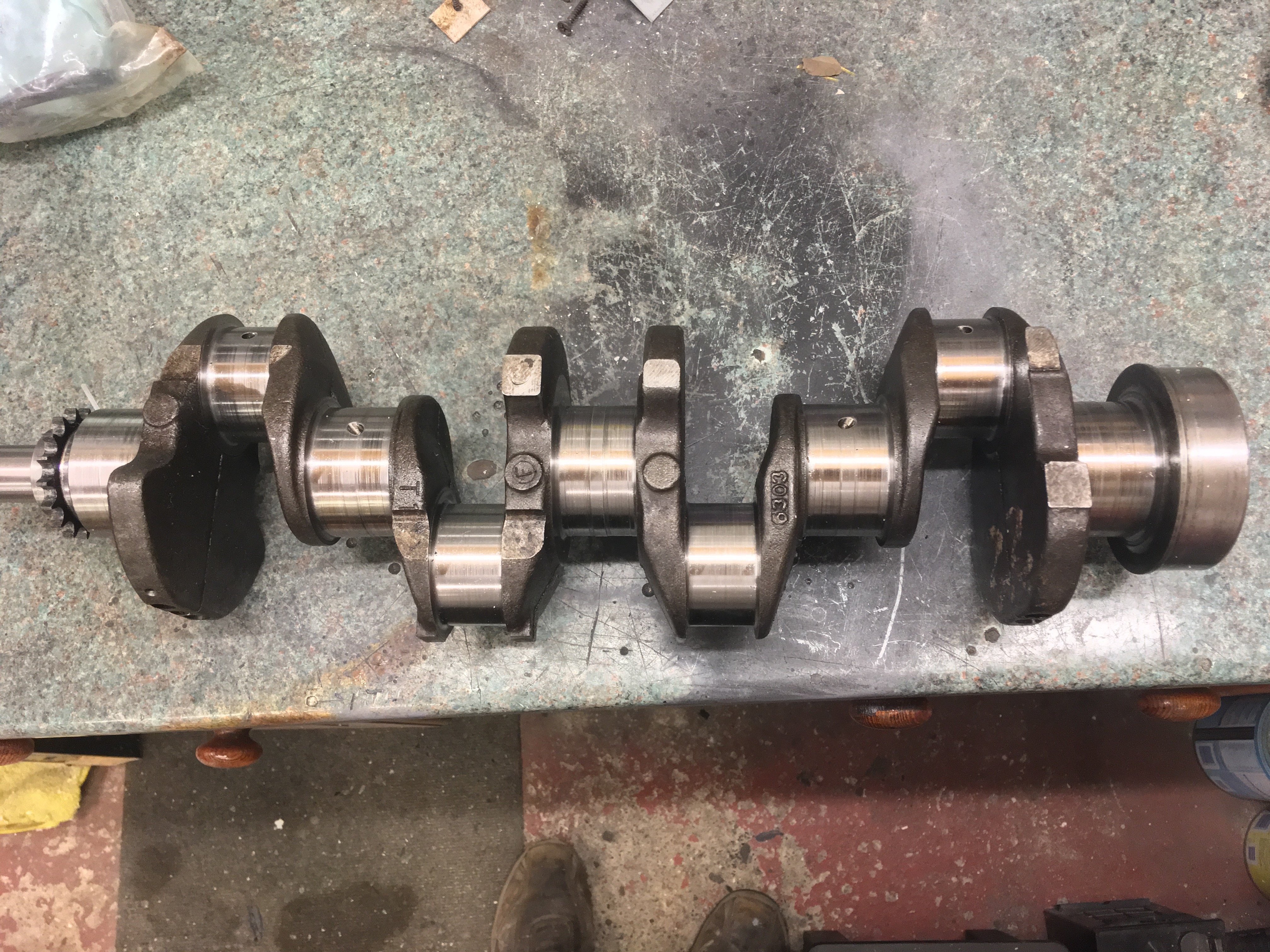

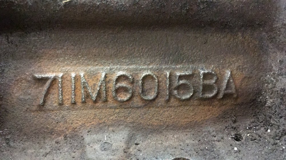

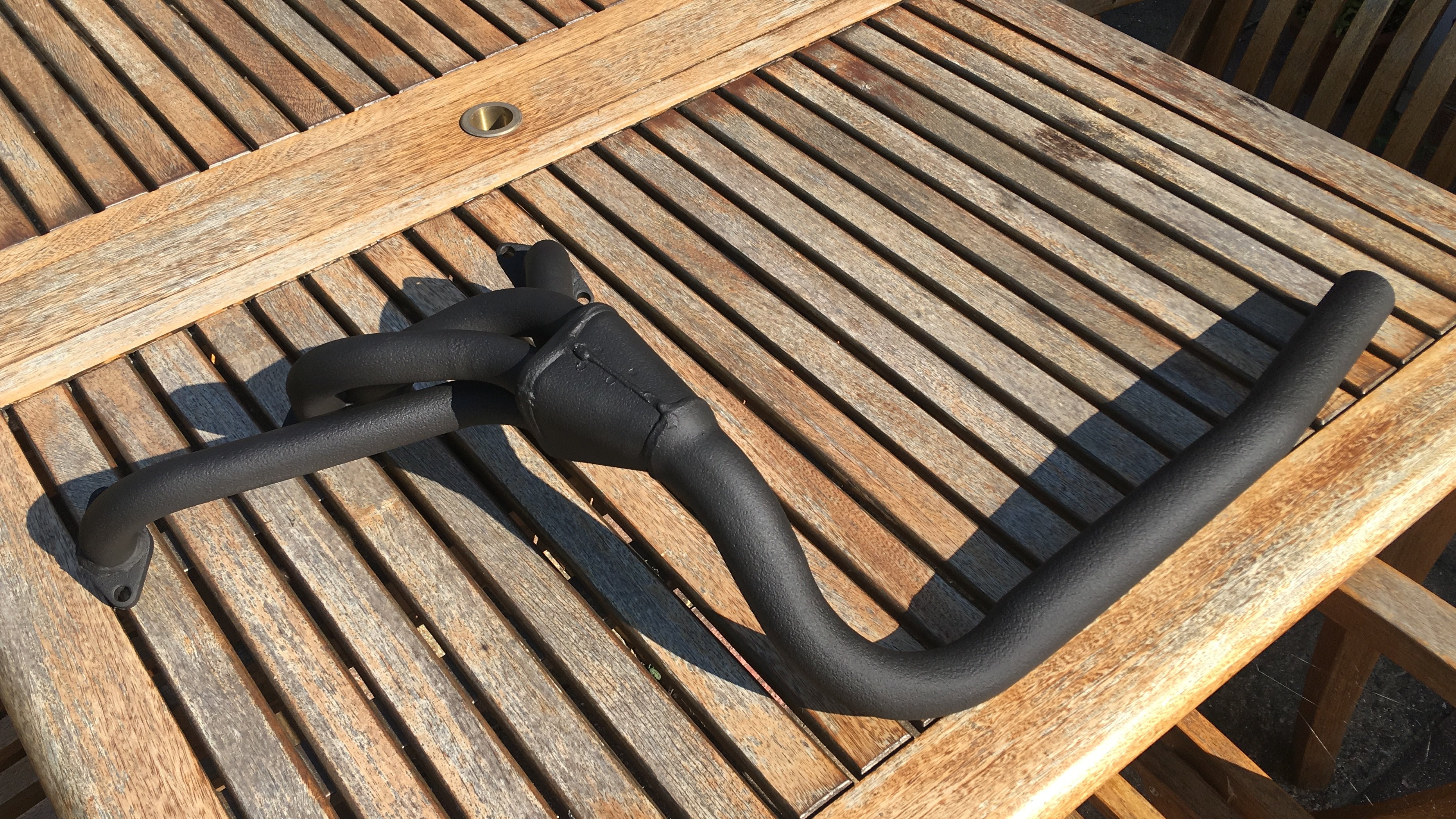

Jerrytom161 Posted October 30, 2019 Author Report Posted October 30, 2019 I was also not particularly happy with the block from the original build either in the respect it had to have sleeves fitted in all the bores due to excessive damage done . My aim was to keep it near original spec when i originally started out , but was persuaded to have it bored out to achieve 1700cc . I went with this at the time . Once the assessment was done on all the faults to my engine i started to find all the parts that i needed to rebuild the engine , i was very vey lucky to find a very good original block with correct casting numbers for my car along with an original spec crankshaft to go with it . Also one other great find was an original Ford mk1 Mexico 4 into 1 branch exhaust manifold . ( which i have been looking to get for years ) .

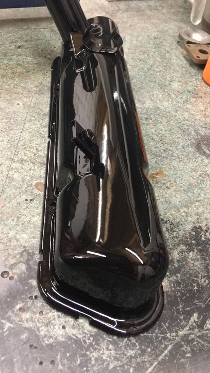

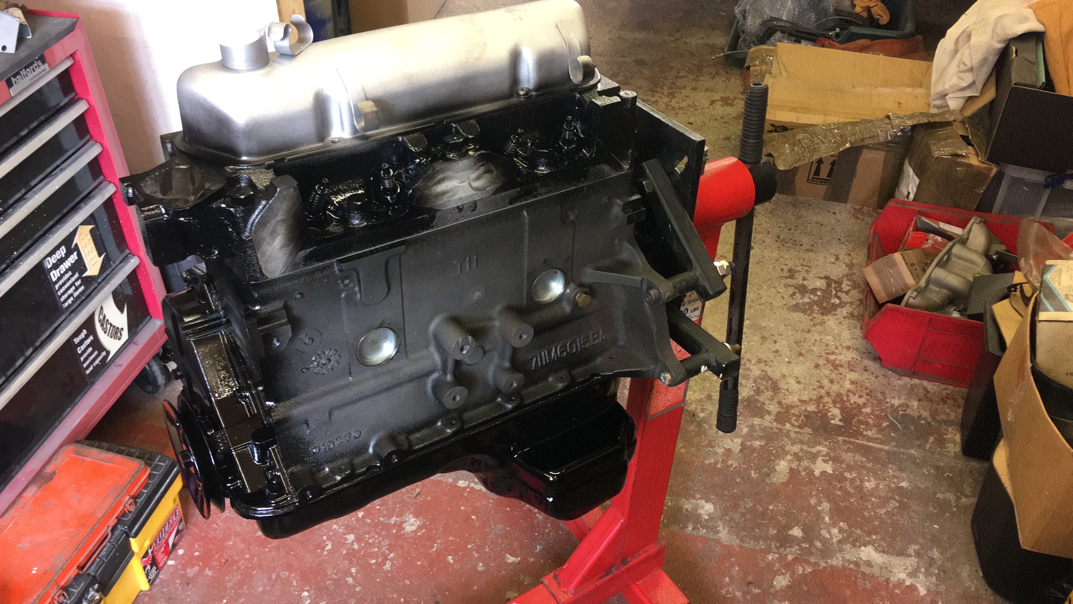

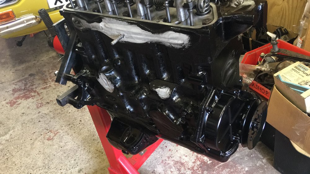

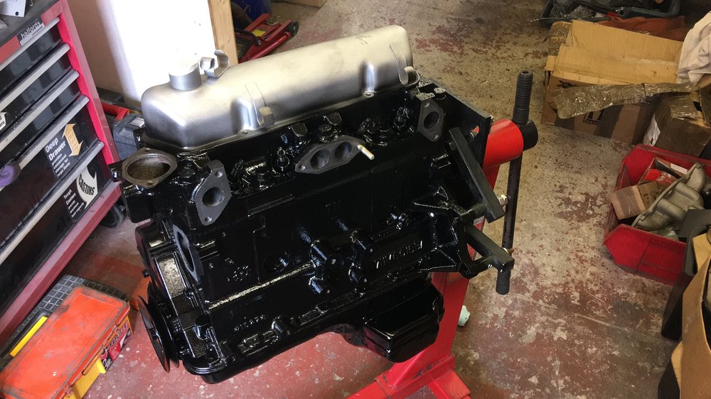

Jerrytom161 Posted October 30, 2019 Author Report Posted October 30, 2019 With all the parts now found Rays engine builder set about the task of rebuilding my engine to near original spec as it left the Avo factory . Once it was done Ray very kindly bought it back to me ready to fit back in the Mex. i had the easy task of just repainting it and fitting all the ancillaries . 1 1
