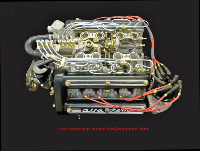

Admin Vista Posted April 20, 2017 Admin Report Posted April 20, 2017 All the regular V8's are dynosaurs unless your talking about Fords Coyote V8 or Chevy LS engines or German BMW & Merc & Audi engines. Cough Alfa Romeo cough cough. All alloy v8 with quad OHC, dry sump lubrication, fuel injection and electronic ignition all out the box as long ago as 1970. 1
colr6 Posted April 20, 2017 Report Posted April 20, 2017 Cough Alfa Romeo cough cough. All alloy v8 with quad OHC, dry sump lubrication, fuel injection and electronic ignition all out the box as long ago as 1970. No doubt have a hefty rebuild bill to go along with them, that might be what's causing your cough Vista....lol 1
Admin Vista Posted April 20, 2017 Admin Report Posted April 20, 2017 No doubt have a hefty rebuild bill to go along with them, that might be what's causing your cough Vista....lol They did.....but as the cars are getting rediscovered the availability of parts has improved and the costs have dropped. The difficult but is the injection pump and it's set up as there are few experts around.
