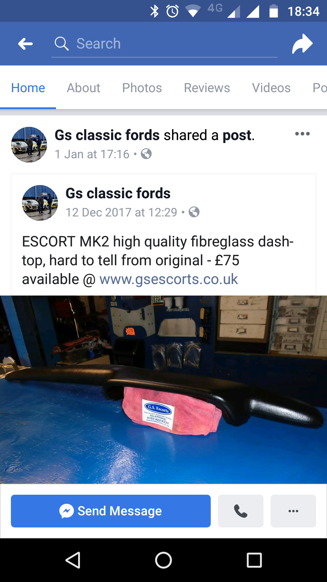

DT36 Posted January 7, 2019 Report Posted January 7, 2019 There you go Col, don't F about with it... 1
Monza Posted January 7, 2019 Report Posted January 7, 2019 I repaired my mk1 dash top in quite a few places using a 2 pack sandable filler that I found on web. Cut off the proud bits, filled, sanded and painted satin black. Not textured anymore but good enough for now.Spoke to Frost about what I wanted and they advised however it was out of stock. Found tha same stuff cheaper on ebay in USA but was not allowed to bring it over...Mine will do for now until I can be bothered to source a fibreglass top....which actually look quite good...Sent from my SM-G900F using Tapatalk
