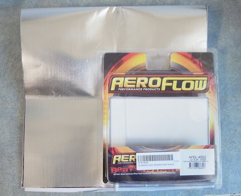

Ok I found a reasonable quality one that will stick to the underside. Will one foot square be enough to order do you think? There is a more than reasonable air gap between the floor and the new exhaust. It silts a bit closer to the chassis rail than I would like as the brake lines are right there also. The main difference to the old one is that its now flanged whereas the old extractors were welded to the exhaust and the flange is alot closer to the floorpan than the previous join as you would expect as its alot thicker at that point. So will put a bit of shielding centred on the flange and fold it against the chassis rail covering the brake lines and also where the speedo cable comes at its closest point to the manifold. 40cm length would be ideal but it only comes in 30 and 60cm lengths so was hoping 30 would be enough?
  • Moderator
I ended up getting a 12x24in sheet of this stuff, supposed to withstand over 1000 degrees. It seems to be a thick silvery cloth based sheet material with an adhesive back.
Will have to clear off 30 years of road grime and a bit of Por15 before I stick it on.
