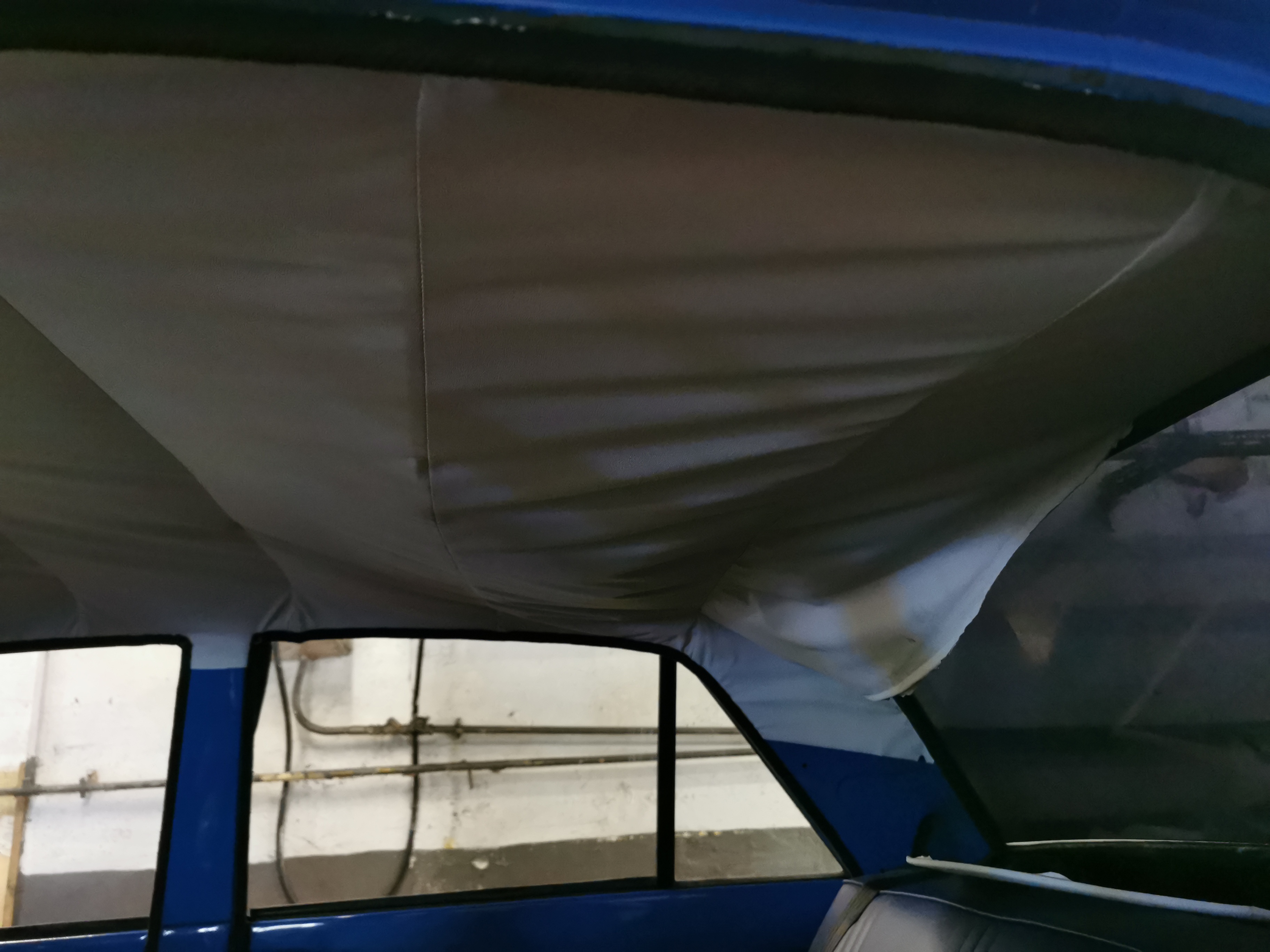

chinkamon Posted June 4, 2021 Report Posted June 4, 2021 Went to check on the cortina after work. An seen the back headlining has fallen whilst sat in storage🤷🏻♂️ looked to see what's going on but I've never fitted a headliner before? Anyone any hints?
katana Posted June 4, 2021 Report Posted June 4, 2021 Its maybe been installed without removing the glass and rubbers? Ideally, you get the body of the headliner taut all over and wrapped over the window rubber body flanges - some people glue, some hold with clips whilst installing the rubber seals. This traps the vinyl and the glass reinstallation locks it in place. I've never done one just seen how after removing windows. 1
Johnny Boy Posted June 4, 2021 Report Posted June 4, 2021 I think you will need to take the rear window out and reglue it. Looks like the plastic ends of the wire retainer have broken, as its fallen down also ? 1
chinkamon Posted June 4, 2021 Author Report Posted June 4, 2021 4 hours ago, Johnny Boy said: I think you will need to take the rear window out and reglue it. Looks like the plastic ends of the wire retainer have broken, as its fallen down also ? Window out 😬😬😬ummmm that's not something ive ever wanted to try if I'm honest! I poked my phone up in the lining an then my hand, the bars are all in place although one was out on one end but I placed it back in, but it won't sit up like the others, it wants to push down rather than up an I can't change its mind, it seems to pull straight when I pull the lining back tight but I can't get it to fix anywhere, without removing the glass and or seal 😭😭
notenoughtime Posted June 4, 2021 Report Posted June 4, 2021 Looks like the bars have dropped but needs to fit under rear screen 1
