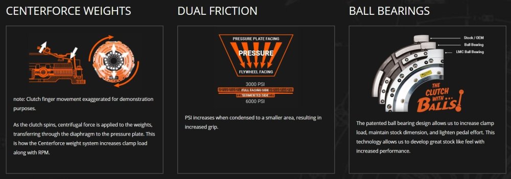

Moderator Rally Pack 2000 Posted October 15, 2021 Author Moderator Report Posted October 15, 2021 Are these CentreForce Clutches a worthwhile technology or just gimmickry?
