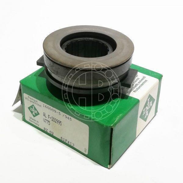

Moderator Rally Pack 2000 Posted July 22, 2024 Author Moderator Report Posted July 22, 2024 So do you think these Original Ford Motorcraft Clutch bearings are really Chinese? As Katana pointed out although Germany is prominently printed on it you can see "INA" with the start of the word cut out to the right at the 4 o'clock position? The wrap paper is made in England! LOL
Miniliteman Posted July 22, 2024 Report Posted July 22, 2024 Who said they were Chinese? INA is INA Bearings from Germany a well known company for their quality parts. 1
Moderator Rally Pack 2000 Posted July 23, 2024 Author Moderator Report Posted July 23, 2024 19 hours ago, Miniliteman said: Who said they were Chinese? INA is INA Bearings from Germany a well known company for their quality parts. LOL It was a joke made earlier in this thread but with so much manufacturing being transferred to China these days it was a real possibility! But your reply was exactly what I wanted to know. Was it the end of the word China or did INA stand for something, which it does! So did this INA group also have a factory in France? Earlier in this thread there is a picture of another one but references Lizenz Verto France as well as the INA Germany markings.
Moderator Rally Pack 2000 Posted July 23, 2024 Author Moderator Report Posted July 23, 2024 Interestingly is that the appear to still make them today!
