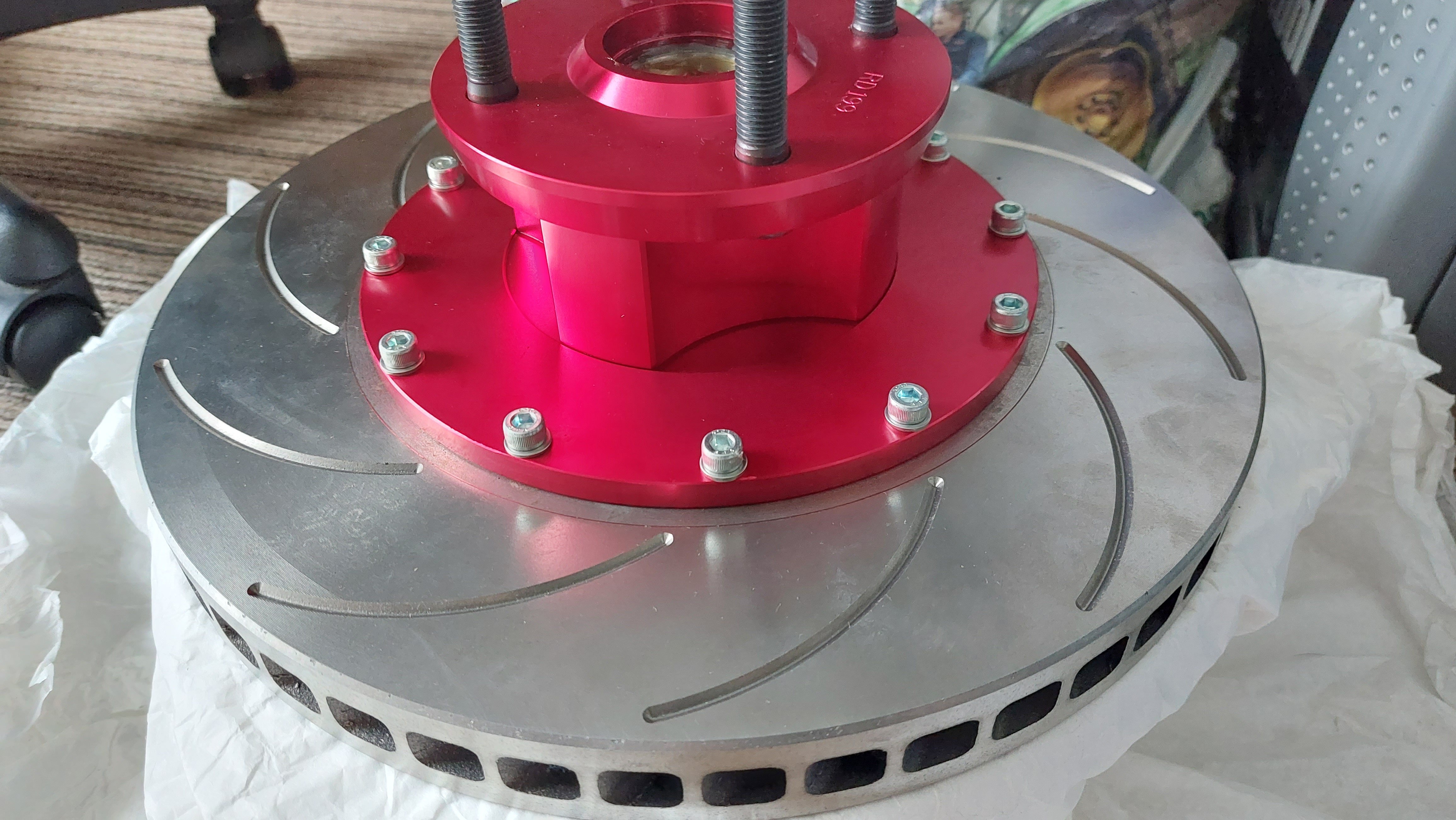

Gareth_C_79 Posted May 5, 2022 Report Posted May 5, 2022 Ok guys, just want an idea of what you fellas use on your motors. I've just picked up a new set of solid drilled and grooved discs that a local rally driver ordered by mistake. Im running M16 calipers so was wondering what the best combination of disc and pad is? I don't do track days and wouldn't say I'm a 'fast' road driver.
