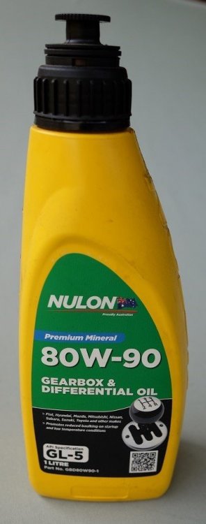

Moderator Rally Pack 2000 Posted June 20, 2022 Author Moderator Report Posted June 20, 2022 You know I never even took notice of the GL tags on these oils till you guys started quoting them on this thread I always just used the viscosity rating. Wasn't even sure it was used by local manufacturers but found an unopened multi-grade one in the shed, (who knows when I bought that!) and sure enough there as plain as day GL-5. So use that one in the diff and get something with a 4 rating with a wider range for the gearbox? I dare say that one above is just a cheapy I bought in my travels so now that the old bomb is worth something should I take better care of it and upgrade to a better semi synthetic (or fully synthetic?) oil 75w 90 for both like Col suggests? Always been a bit lax when it comes to getting the old fluid out, just a bit of a syringe to get some of the old stuff but then just topping it up. Now than Im changing the type of oil I should probably do a better job or extracting most of the old oil this time and the little syringe isn't going to cut it. Do you guys have reasonable home DIY oil extraction system?
