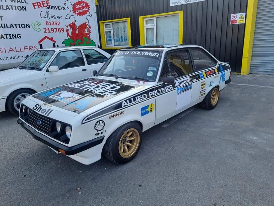

I run 185/60s NS2r's on my 8" minilites and they dont really look stretched but the side wall is massive compared to other 60s on the market.
