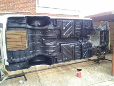

  1. Bought this gt off jiffer a while back, turns out it needed quite a bit so I gave it a full resto as best I could in my garage, loads of new panels, fibreglass bonnet and bootlid, full respray in its orginal colour, engine has bcf3 cam, skimmed head, later clutch conversion, interior resto, had rack conversion when I got it already. Most parts were made by me as I'm a machinist by trade. I've got hundreds of resto pictures but I'm to lazy to sort them out!
