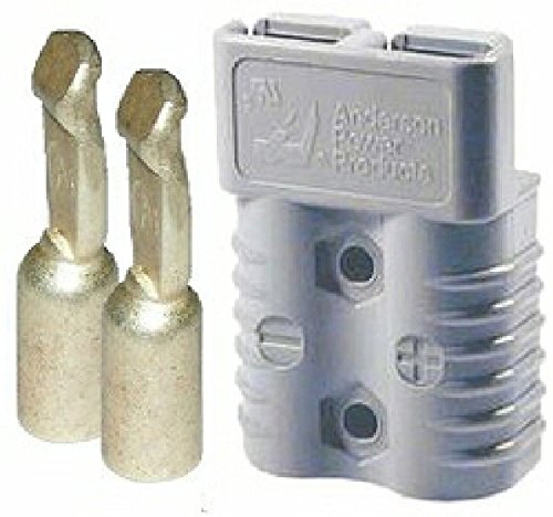

Danish Posted January 27, 2015 Report Posted January 27, 2015 I'm connecting my boot battery with a 175 amp Anderson connector So I can disconnect the battery, and I have the option of having a small battery for running quarter miles, and a large battery for winter and long trips. 2

The Transplanter Posted January 27, 2015 Report Posted January 27, 2015 I'm connecting my boot battery with a 175 amp Anderson connector So I can disconnect the battery, and I have the option of having a small battery for running quarter miles, and a large battery for winter and long trips. Good Idea, you could even use them on a jump pack and run the 1/4 on the alternator
