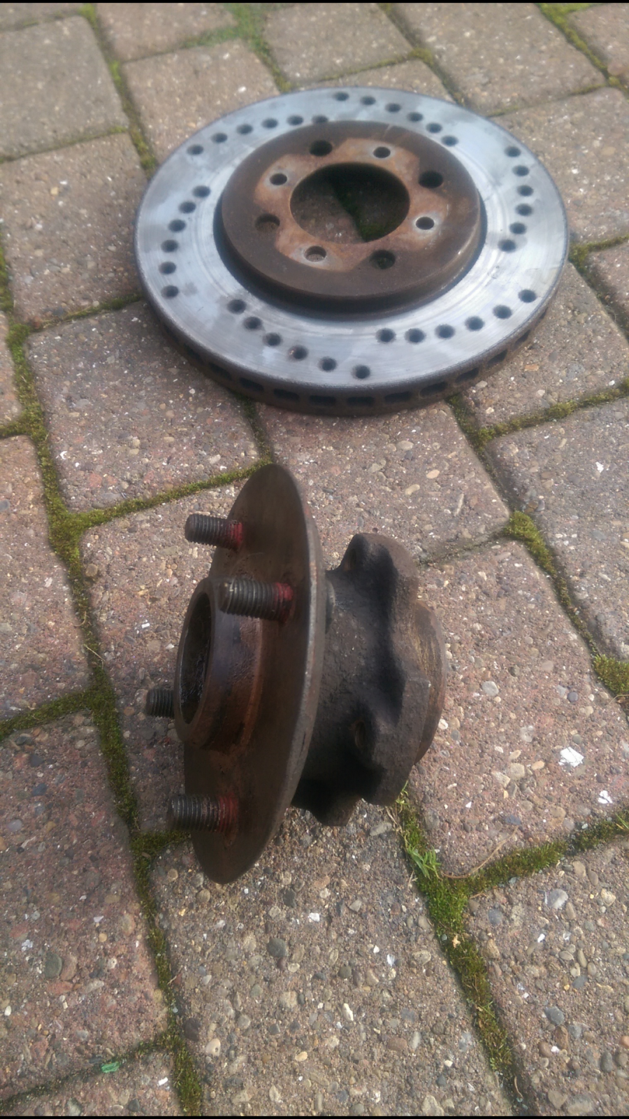

seaneylad Posted April 7, 2015 Author Report Posted April 7, 2015 Thanks all while im on the subject if it was my hubs to be proved the issue These are my current ones, i take it these are standard escort ones out of cast iron or something Seen two types on Burton, the exact replica is alot more than the other ones which widens the track 10mm, noth should fit if im right?So am i best with the £59 ones? as can use all normal bearings etc but saves paying the extra for exact copy? GRP4 Fabrications std alloy hub, Escort Mk1/Mk2 RS, Capri (not 3.0) - exact replica Web Only (Incl VAT):£91.16 GRP1 alloy front hub (RS2000). Billet machined from 6082T6 aluminium this hub replicates the RS2000 hub. i.e. Does not increase track by 10mm per side. http://www.burtonpower.com/std-alloy-hub-rs-escort-capri-exact-replica-mp1000.html Gp4 alloy hub, Escort Mk1/Mk2 RS, Capri (not 3.0) Web Only (Incl VAT):£59.42 http://www.burtonpower.com/gp4-alloy-hub-escort-mk1-mk2-rs-capri-not-3-0-mp325.html
John escort mk1V6 Posted April 7, 2015 Report Posted April 7, 2015 Thanks all while im on the subject if it was my hubs to be proved the issue These are my current ones, i take it these are standard escort ones out of cast iron or something Seen two types on Burton, the exact replica is alot more than the other ones which widens the track 10mm, noth should fit if im right? So am i best with the £59 ones? as can use all normal bearings etc but saves paying the extra for exact copy? GRP4 Fabrications std alloy hub, Escort Mk1/Mk2 RS, Capri (not 3.0) - exact replica Web Only (Incl VAT):£91.16 GRP1 alloy front hub (RS2000). Billet machined from 6082T6 aluminium this hub replicates the RS2000 hub. i.e. Does not increase track by 10mm per side. http://www.burtonpower.com/std-alloy-hub-rs-escort-capri-exact-replica-mp1000.html Gp4 alloy hub, Escort Mk1/Mk2 RS, Capri (not 3.0) Web Only (Incl VAT):£59.42 http://www.burtonpower.com/gp4-alloy-hub-escort-mk1-mk2-rs-capri-not-3-0-mp325.html I did have some hubs like these , i bought them for saving weight but the brake discs did not good center and also the wheels did not good center becourse they the hub where the wheel should center on is not for standard road use wheels.
seaneylad Posted April 7, 2015 Author Report Posted April 7, 2015 I did have some hubs like these , i bought them for saving weight but the brake discs did not good center and also the wheels did not good center becourse they the hub where the wheel should center on is not for standard road use wheels. Ah really. I'm best with the exact replica ones then and d pay the extra ££

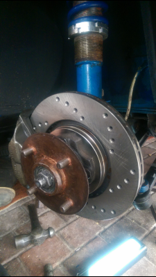

katana Posted April 7, 2015 Report Posted April 7, 2015 May be an optical illusion but the top, front most stud looks canted and not perpendicular to hub face?

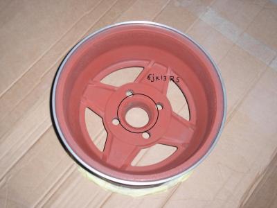

John escort mk1V6 Posted April 7, 2015 Report Posted April 7, 2015 Ah really. I'm best with the exact replica ones then and d pay the extra ££ The most one`s i can find are the same as these , so these hubs don`t support the wheels , especially the RS 7,5 RS.
seaneylad Posted April 7, 2015 Author Report Posted April 7, 2015 specific to rs2000? I ordered ones stating rs and mexico models. Thanks The most one`s i can find are the same as these , so these hubs don`t support the wheels , especially the RS 7,5 RS. I see what you mean, these are mind and they are different. If the tie rod ends Dont fix it and it is the hub then I may struggle to find a replacement :s
seaneylad Posted April 7, 2015 Author Report Posted April 7, 2015 May be an optical illusion but the top, front most stud looks canted and not perpendicular to hub face? I'll double check, may just been the pic angle.

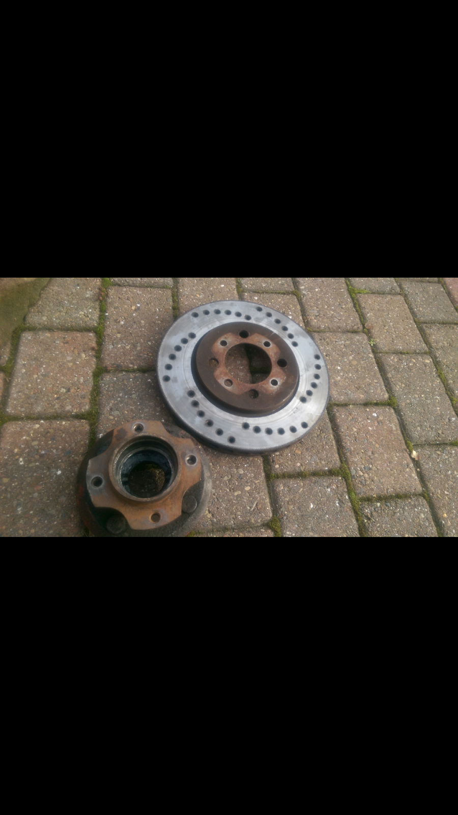

seaneylad Posted April 13, 2015 Author Report Posted April 13, 2015 That's interesting. I would never have ever thought of that! Just to throw another curve ball in to the discussion, do you use locking wheel nuts by any chance? I had a set years ago that were much heavier than the standard nuts and would set up a noticeable vibration through the steering wheel when fitted to the car. Tie rods ends still havent turned up to try first orded hubs from GS escorts, is it worth even trying these and they looks theyve been hit or damaged? or is it worth sending them back and trying to get a better set.
irishtorag Posted April 13, 2015 Report Posted April 13, 2015 send them back I know they are second hand but don't take dirt
Tackleberry Posted April 13, 2015 Report Posted April 13, 2015 Looks like they were recovered from the titanic.?
