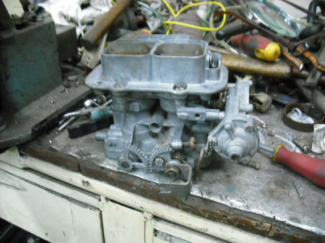

Going to have my carbs cleaned, is it best to strip carbs as much as poss or just float chambers and jets ? Don't want to take them and they say oh we had to strip and that's cost me some more cash!

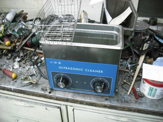

I got mine from Maplin's - 2.5L model that will take a single bike carb when broken down. A unit to take a DCOE for instance would be a small commercial unit with a corresponding price tag - mine was about £90 new
Just looked at those, was going to measure the dellortos I have to see if will go in the bowl. They also list a 3ltr model but bowl size exactly the same. As you say go any bigger than that it's loan time.
6 litre is minimum for a twin choke carb and not ideal. 10 litre capacity is advisable for ultrasonic cleanup of carbs.
I use Tickopur R33 ( 3-5% mixture with water ) as a cleaning solvent at about 60-70' Celcius for about 30 minuts.
Don't do a carb for more than 45 minuts as the ultrasonic vibrations will damage the carb badly ( I did test that ).
Best is 30 minutes maximum in the ultrasonic bath.

Found a 6ltr one on the net for about £100. Going by the size would have thought it would be adequate 300x300x180 not doing a lot of parts problably only use it a couple of times then like lots of other stuff I have on the shelf
It can be done using the 6litre one, its a bit more hassle that's all. Its the one I use at home.

I have the same, only digital version. It says 6 litre but it isn't. It only holds about 4,5 litre of solvent. But it will work.
Weber DGAV or DGAS is a very tight fit and might be better done in two sessions. Base first and all the other parts ( top cover, side covers needles etc.) next.
Don't use an Ultrasonic cleaner without the basket. There needs to be some room between the bottom and the parts to clean otherwise it wont work. The basket will provide that.

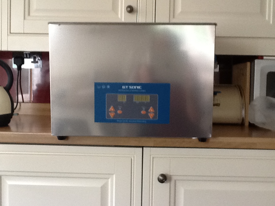

Been having a look around going to go the way Ray suggested 27ltr one. In for a penny in for a pound! Would get most things in that I need cleaning. Will have to do some studying to see what can and can't be cleaned using one. Just going to tell the wife it's for cleaning her jewellery.

Well it's arrived
My new 27ltr ultrasonic digital cleaner, was hoping to get a bike in it so I could enter show and shine at retro show but it won't fit ! Means I'm going to have to buy the dragon some more jewelry now, that's what I told her it was for cleaning
