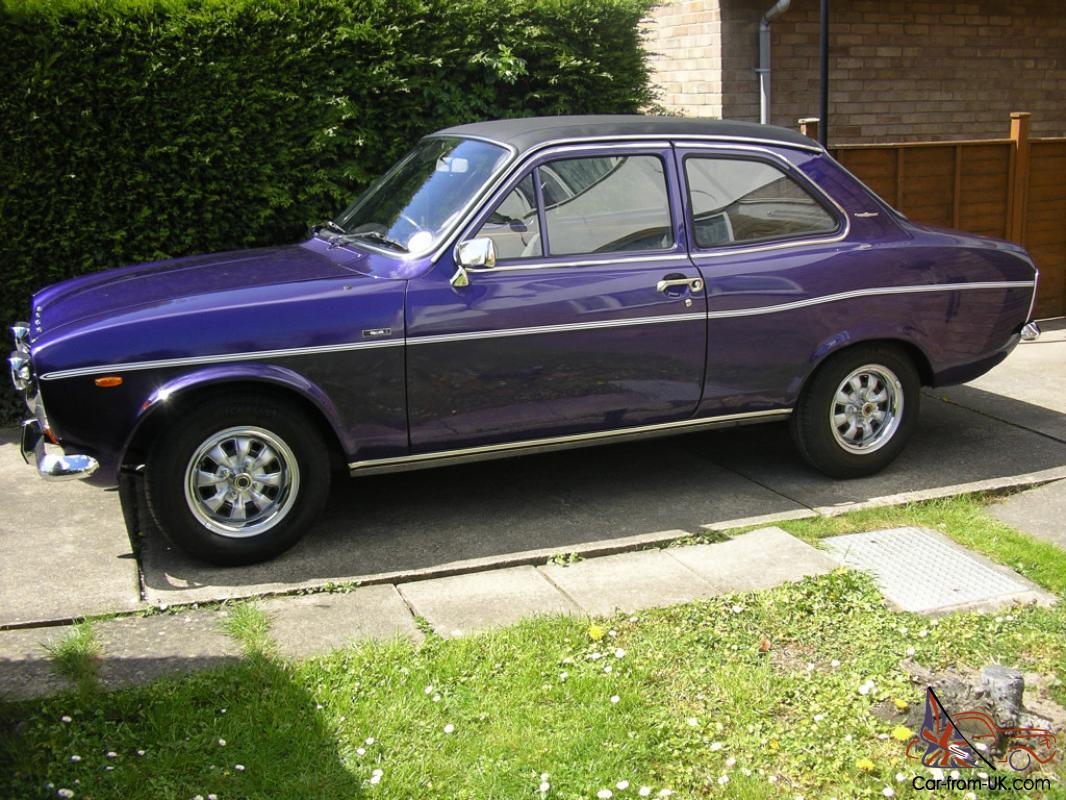

ok, purple shell goes into paint at the end of September, but I'm in a dilemma of what the colour really looked like in 1973, ive found the following photos on the net, they give a varying degree of depth and shine, can any of you oldies advise what would have been the closest to production

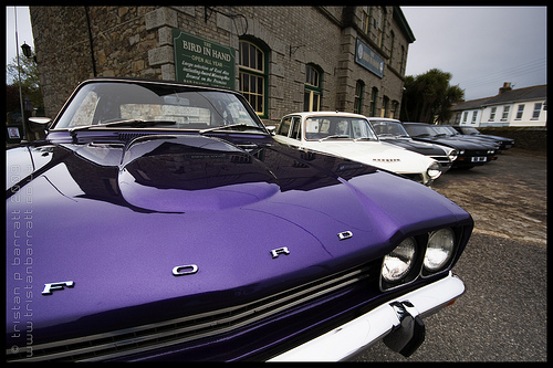

whilst I like the deep shine on the crapri, I'm not sure it would suit an escort
Would say pic three, varying light changes the look of the colour. Pic 4 is far to light. The finish on that Capri is unreal, the photo has been taken to high lite the flatness of that paint job. Obviously depends on how many coats and quality of lacquer you put on it will alter the depth look

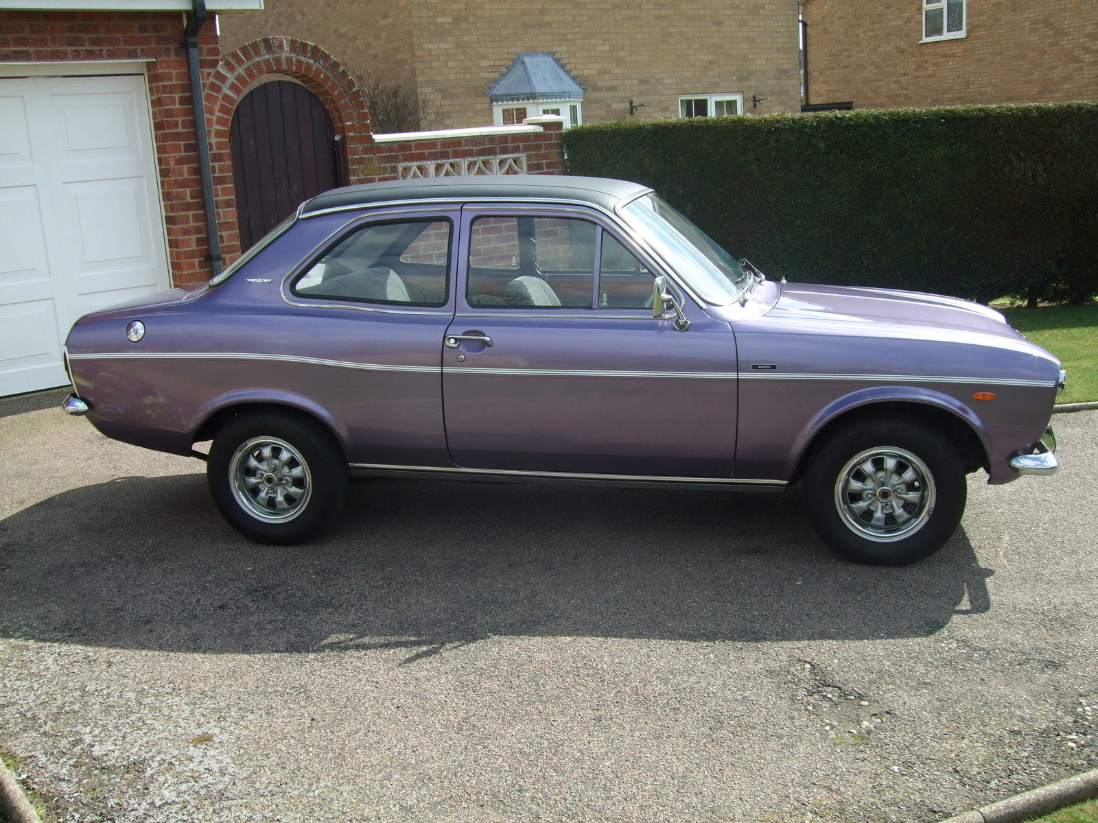

From what I have seen you probably will have a harder time than I ever did. Period Metallic Purple finishes are the hardest to get right. So much so I would suggest you pick the one you like best from the modern finishes as replicating the original will be near on impossible. Get close to the shade and you will find the deep gloss over the original can be attributed to you keeping it well groomed and cared for rather than a paint miss match. Like Col I like the third photo with the Mk1 Escort. The 4th looks like its faded even if that's probably how it was meant to be.

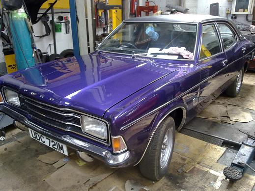

And that deep shine purple on the Capri so would look just as good on the Escort and Cortina - you cannot beat a really deep shine on any car IMO, and the colour is lovely.
