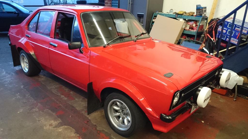

Moderator Rally Pack 2000 Posted January 25, 2018 Moderator Report Posted January 25, 2018 From the front Or Racing 1

oldwheels Posted January 26, 2018 Author Report Posted January 26, 2018 Thanks to Rally Pack 2000 for the pics I wonder if the rear doors on the black car open? and to everyone else for positive comments as has been said it is my car, just trying to get an idea on the best way of moving forward with this, just trying to find someone who has carried out this job, thanks
Moderator Rally Pack 2000 Posted January 26, 2018 Moderator Report Posted January 26, 2018 Just now, oldwheels said: Thanks to Rally Pack 2000 for the pics I wonder if the rear doors on the black car open? and to everyone else for positive comments as has been said it is my car, just trying to get an idea on the best way of moving forward with this, just trying to find someone who has carried out this job, thanks The Arch conversion is pretty much normal, where some encounter problems is when they go fitting a cage to match. Note that the Red Car effectively has a 2 door cage fitted inside. Some specialists also make some specifically for 4 doors but if you go down that route be sure to test it first that you can fit through the door. The cages themselves can intrude on the actual door opening so if you get one tailored for the smaller door opening of a 4 door it can become tight if you dont keep an eye on the installation. If you have ever tried to get into an MG Midget? It feel pretty much like that. Some then choose just to fit a 2 door cage but it does show in the back window which some may object too. Just things to consider before jumping in.
