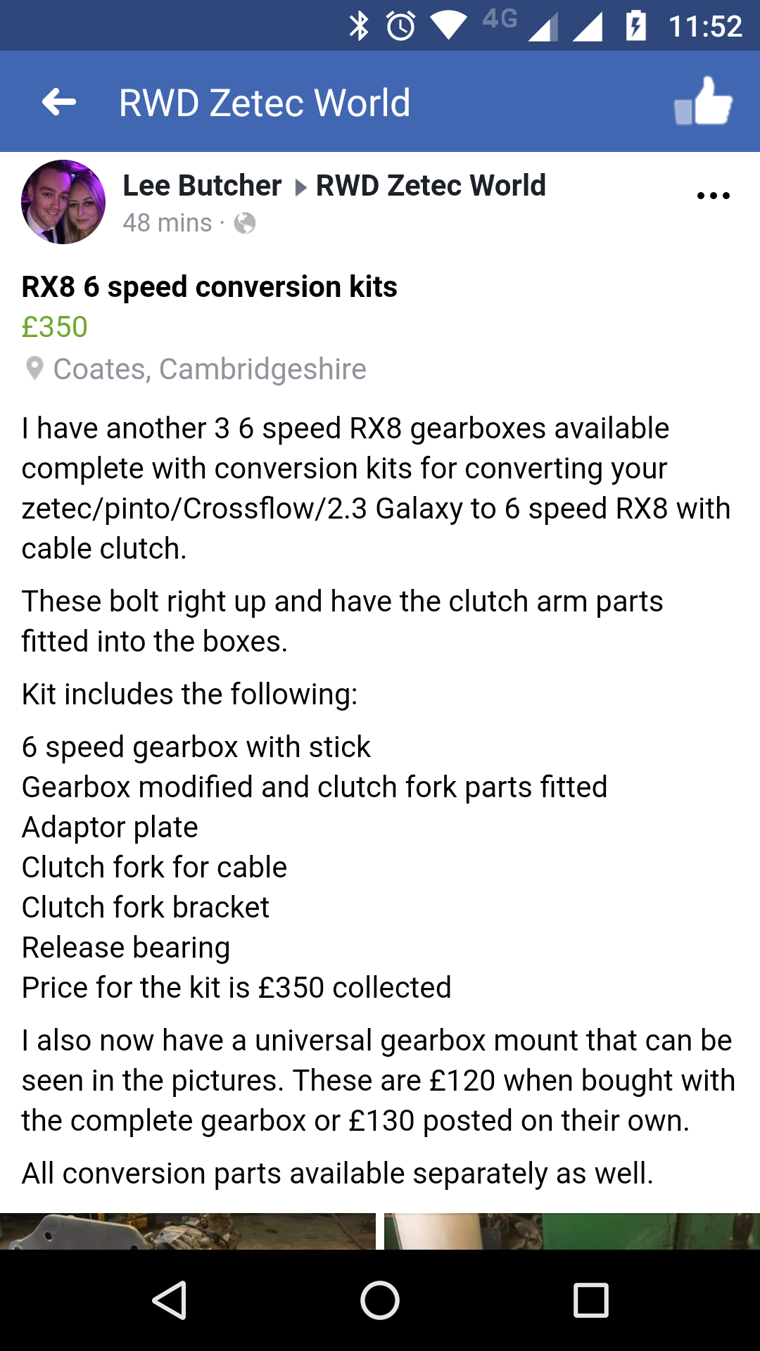

DT36 Posted January 2, 2019 Report Posted January 2, 2019 I've heard that 1st gear on the 6 speed is extremely low and that people pull away in 2nd. 250bhp Type 9 with taller first is good, but expect to spend close to £1k for a warranted refurbishment. Rx8 could be cheaper option, but don't know if prop needs modifying: https://m.Retards Club.com/groups/169461016471131?view=permalink&id=2036949853055562
