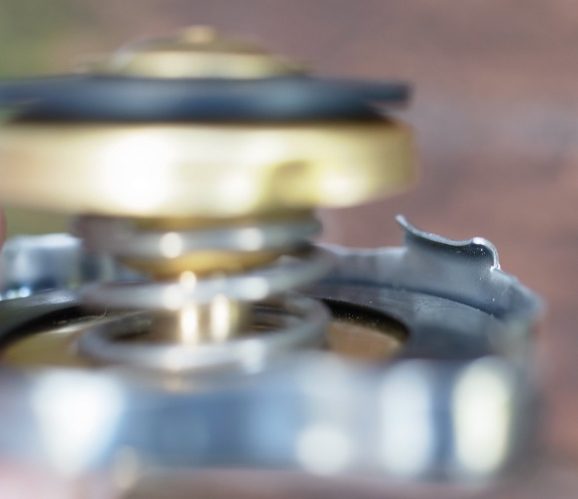

Moderator Rally Pack 2000 Posted November 4, 2021 Author Moderator Report Posted November 4, 2021 I had an idea and just took the cap off the Twincam. I bought both caps at the same time. One has a lever pressure release that I put on the Twincam and then the regular type on the Mk2. Both are stainless Fah-ler 13lb caps. When compared the seals show surprising differences. Its like the regular has been barely sealing? 1

Moderator Rally Pack 2000 Posted November 6, 2021 Author Moderator Report Posted November 6, 2021 I suddenly remembered at the time I bought the cap in question I bought another as a spare as it saved on postage and all that. Even though brand new this cap was ever worse than the first and simply would not lock into place and just constantly rotate. The tabs on it are just not bent correctly. Fah-ler caps with the pressure release lever have much better tabs and lock into place properly. Someone over there goofed for a batch of these things. They are supposed to be premium caps though.

Ray Posted November 6, 2021 Report Posted November 6, 2021 39 minutes ago, Rally Pack 2000 said: Anyone deal with this company? https://www.rc-supplies.co.uk/classic-ford-stainless-steel-radiator-pressure-cap Caps are a reasonable price at ten quid but its costs 20 quid in postage to me LOL Free postage if you live in the UK, lucky pups! i can see from the picture your wasting your time, the bent clips are a fraction of the correct size, unfortunately its the case with most of them, and they just spin off, if you can find a new old stock quinten hazel one, they are ok, but dont buy the modern quinten hazel junk made by firstline, theyre rubbish as well, as is much of that junk they sell, they cant even get the bush bore diameter correct in their track control arms the other option is to have a chat with your aussie mate justin, he usually has a genuine ford one tucked away somewhere for about a hunded quid 1
Moderator Rally Pack 2000 Posted November 6, 2021 Author Moderator Report Posted November 6, 2021 20 minutes ago, Ray said: i can see from the picture your wasting your time, the bent clips are a fraction of the correct size, unfortunately its the case with most of them, and they just spin off, if you can find a new old stock quinten hazel one, they are ok, but dont buy the modern quinten hazel junk made by firstline, theyre rubbish as well, as is much of that junk they sell, they cant even get the bush bore diameter correct in their track control arms the other option is to have a chat with your aussie mate justin, he usually has a genuine ford one tucked away somewhere for about a hunded quid Im glad im not the only one that has had caps spinning out! (But both bought at the same time?) Im in the process of buying a car this month so I would have to use my car money to buy an original cap from Justin so best I go QH I think! 🤣 1
Moderator Rally Pack 2000 Posted December 10, 2021 Author Moderator Report Posted December 10, 2021 A couple of developments with these. I actually made contact with the Fah-ler Factory in Turkey about their caps not clamping down properly. As it turned out there is a dealer in the UK that stopped being an official dealer but instead started selling knock-offs under the same name. They are trying to put a stop to it but its a slow process apparently. So naturally they were under no obligation to address any problems with someone elses fake caps but regardless they were very generous and sent me two replacements anyways. I certainly wasnt expecting such a good response and as such had already ordered some others from the UK! LOL. Anyways the first lot to arraive are the replacements from Turkey and they are definitely better made. They clip in as they should and you can feel the spring seal clamping into place. There are differences in appearance between the genuine and the fakes you will be able to see a comparison below. The genuine one is on the right and has an extra stamp "Since 1969"under the Fah-ler name. I will post again when the British made stainless ones arrive to see how they compare.
katana Posted December 10, 2021 Report Posted December 10, 2021 From the piccy, i'd assume the best quality chinesium knock off! You can usually tell by the letter work - its poor, shallow and indistinct! I hope the Turkish guys get some satisfaction by putting the bad guys out of business! 1
