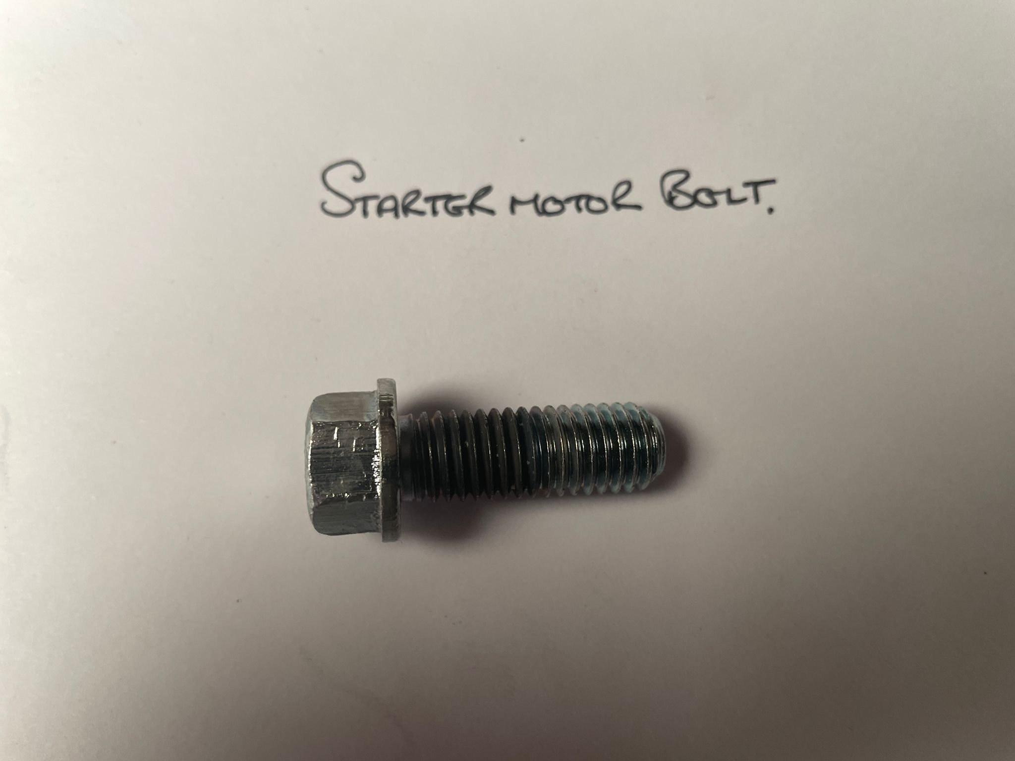

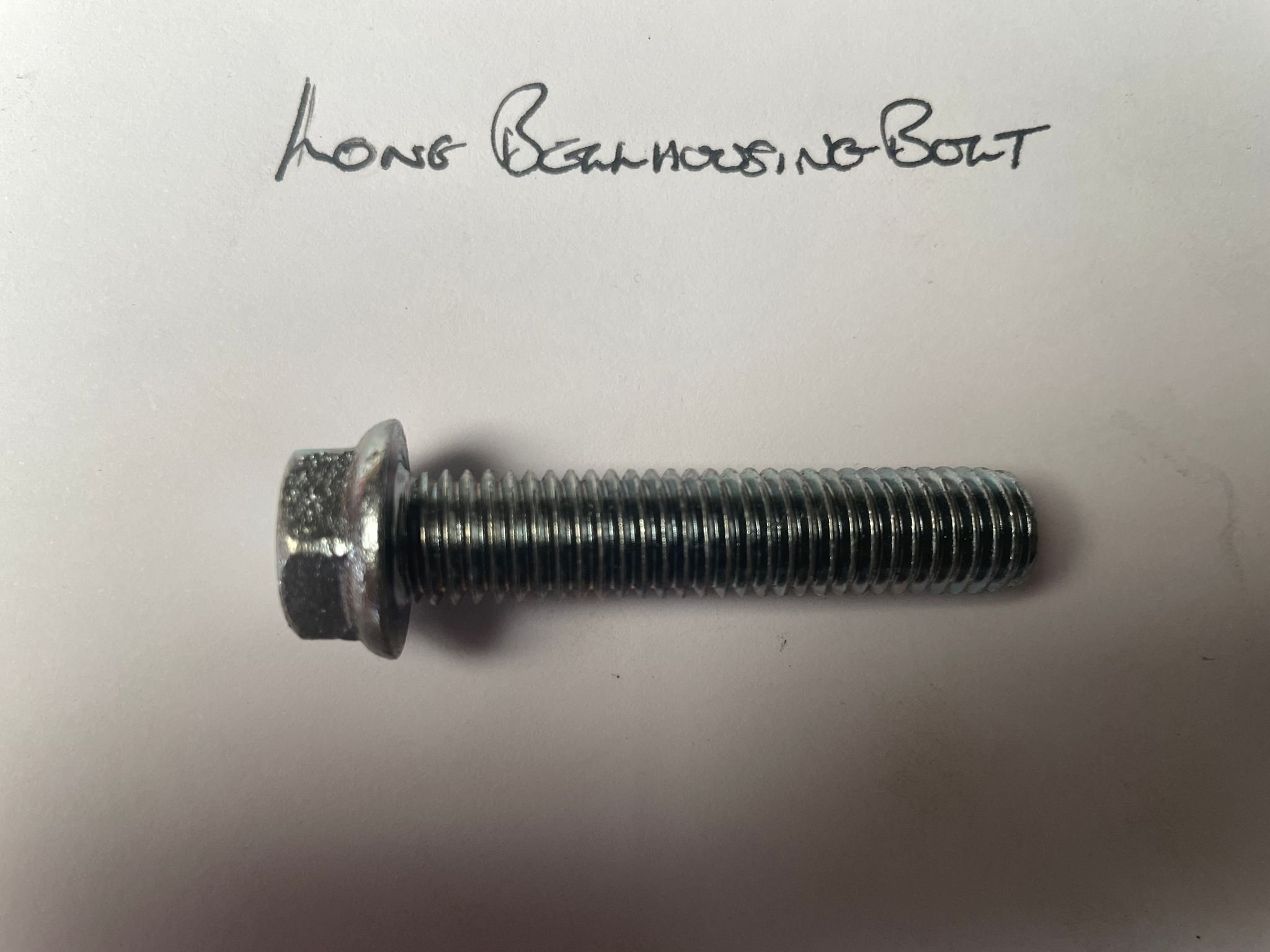

wanted, a set of original ford bolts (all 3 types) that hold the bell housing to the engine and the starter motor to the bell housing (inertia starter), for a crossflor engine with a type 2 box, they were/are very much specials, as todays bolts have a bigger head these comprise of 4 longer bolts, M10x1.5 pitch, just over 2.1" total length, full thread, with curved flanged washered head (17.5mm dia) and socket size of 13mm, main bellhousing body, 2 per side and screw into the bell housing 3 shorter bolts, M10x1.5 pitch, 37.5mm total length, full thread, with a squared flanged washered head (17mm dia) and a socket size of 13mm, for the starter motor and screw into the bellhousing 2 shorter bolts, 3/8 UNC, i dont have a picture to show of these, but almost identical to the 4 long metric ones, but imperial, with an approximate 37mm total lenth, full thread, with curved flanged washered head (17.5mm dia) and socket size of 9/16", for the top to positions of the bellhousing and screw into the block

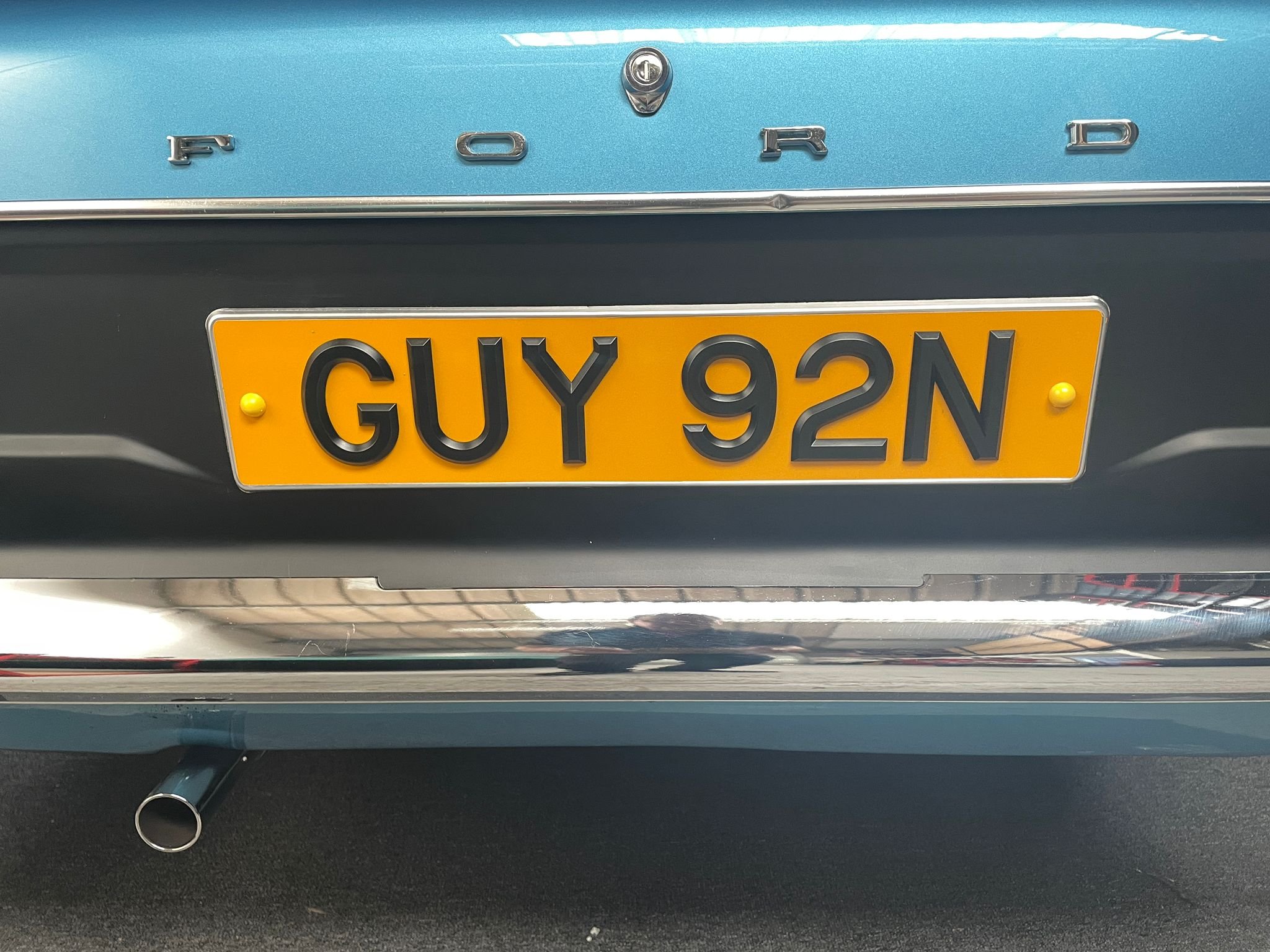

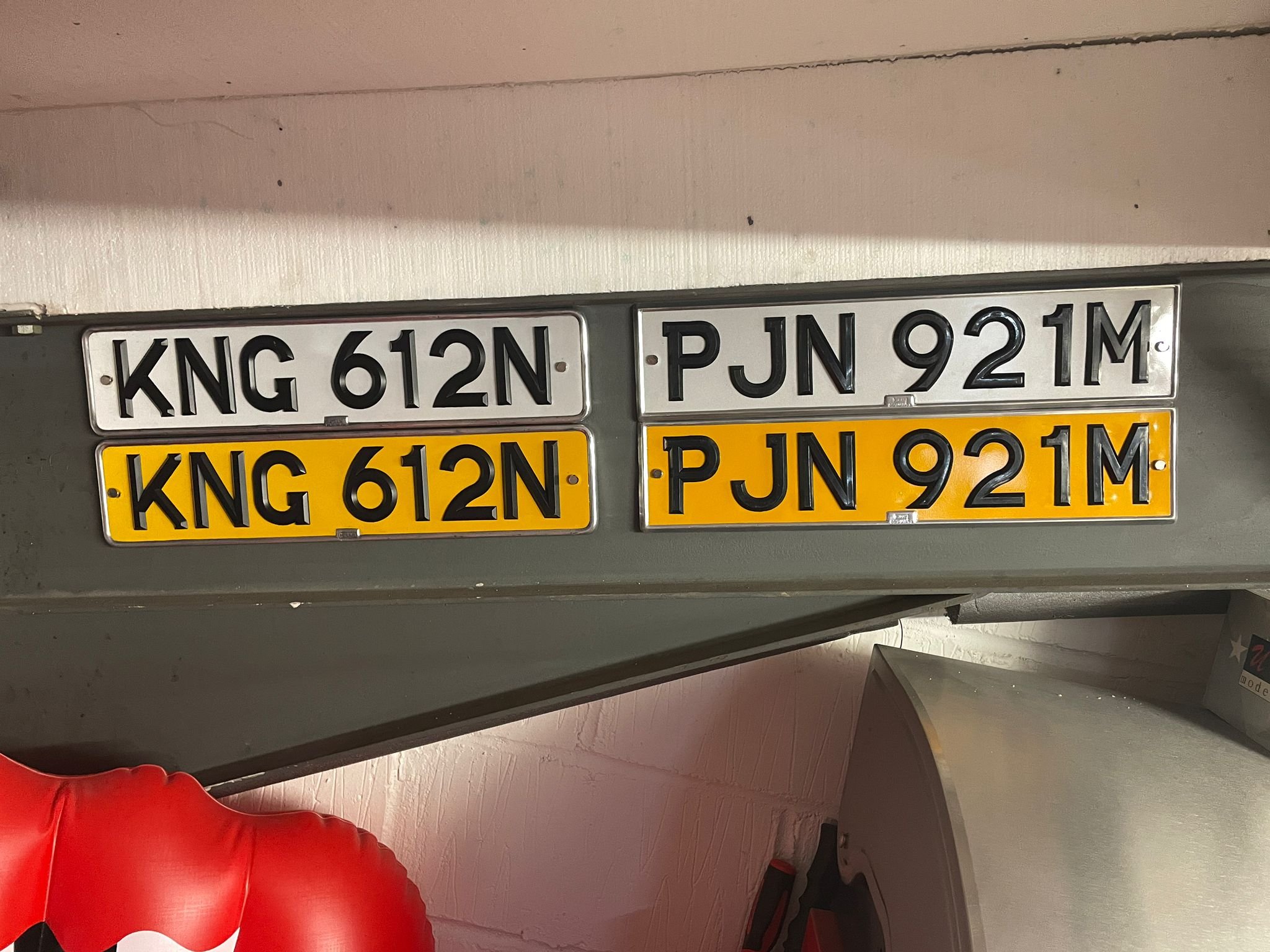

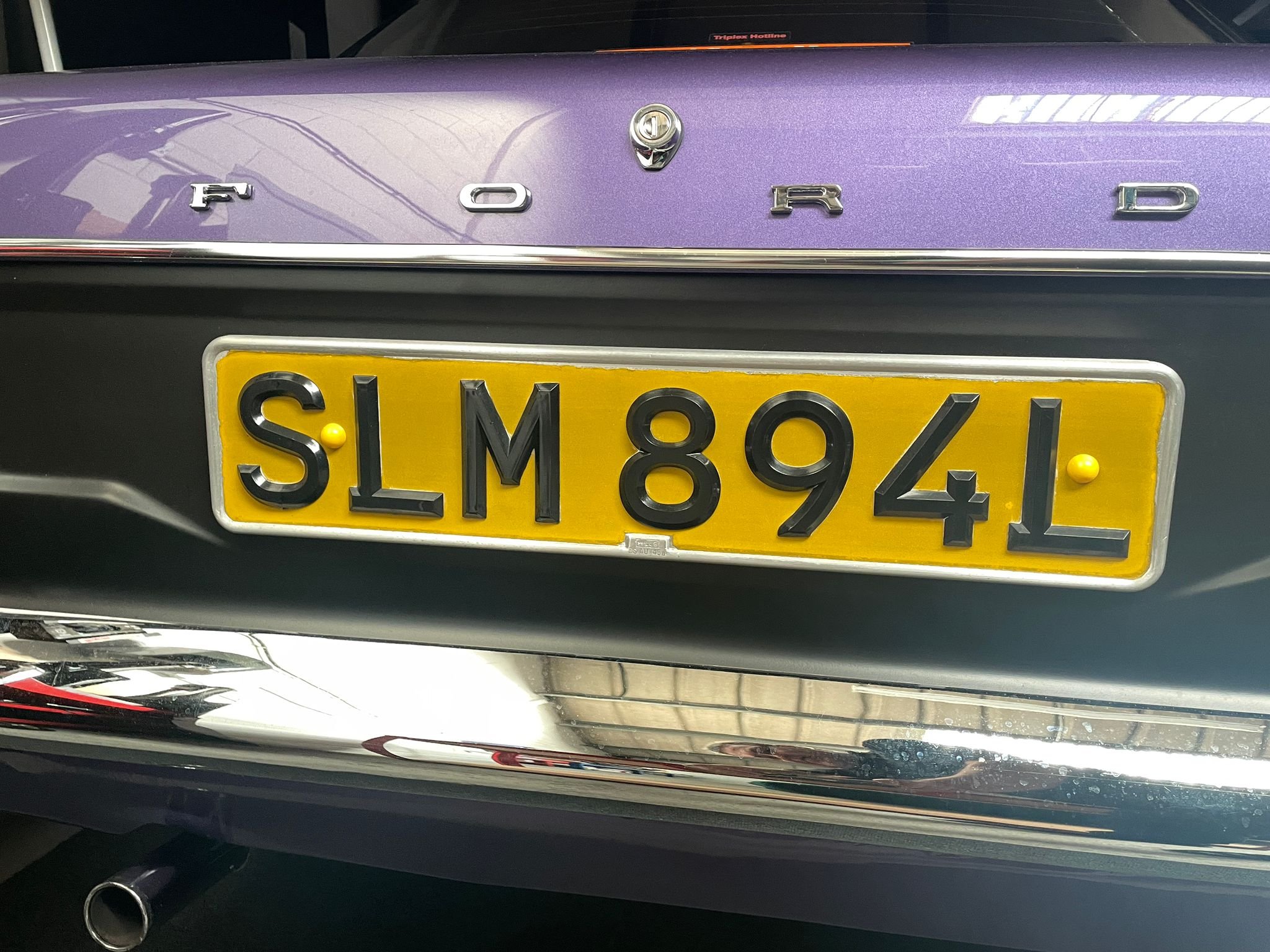

this is a Tippers 70 style, i only use these till i get the proper thing done these are what i have made and this is an original Hills plate
lol, where did i get that reputation from colin @colr6 ok, yes i use tippers, for 2 things, i buy their 70s style plate, but only as an interim, because as you say the fonts are all wrong so i then scour e bay for a while looking for several things, first is the digits in a style you want, and i dont look for a specific manufacturer, i just look for what pleases me, i also prefer the 3D raised opposed to the flat, some are very hard to find if your fussy tbh, the digits can be anything from NOS to fitted to an old plate like your picture, so sometimes you buy a plate to get what you want then your search also extends to a suitable back plate, Hills, Bluemells, or dosnt even need a name if your not bothered, once you have these original matching plates, paint strip them and polish the edges, then get the holes welded up, then begins your job of smoothing the welds once you have your letters and welded plates, you need to send them to tippers, they will fit reflective vinyl and fit the digits at the correct spacing unfortunately ive not found anyone to replicate the original reflective paint tioppers can put a sheet in to make the plate smoother, but you loose the depth when you get it back from them, there will be air bubbles, but mine disapeared after a month, i also take the digits off and clean the hole backs then re fit the digits, as they leave them burred i have quite a lot of digits over, pm me if your looking for something, but i dont have full sets, so may not have them all, or in the style you want
