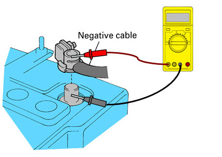

DT36 Posted September 22, 2015 Report Posted September 22, 2015 Remove the negative lead and put a multimeter inline, between the cable and battery post, set to Amps. This will test for current flow or a parasitic drain from a component/consumer. If you do have a current drain, but can't pinpoint it, remove and refit individual fuses one at a time to see if any of them stop the current flow. This will then at least pinpoint the circuit where the current is flowing through. I'm not really up on dynamos, but might be worth looking at your dash in the dark to see if you have a minute glow from your charge light with everything switched off. Possible that the dynamo is backfeeding itself, but this is purely a guess, as not done anything with them personally. I use an automatic trickle charger on my car when it's laid up and fingers crossed I've not had any battery issues. Probably just jinxed myself now though... 1

DT36 Posted September 22, 2015 Report Posted September 22, 2015 OK, then do the amps test with the immobiliser set. Got to be worth a crack just for peace of mind.

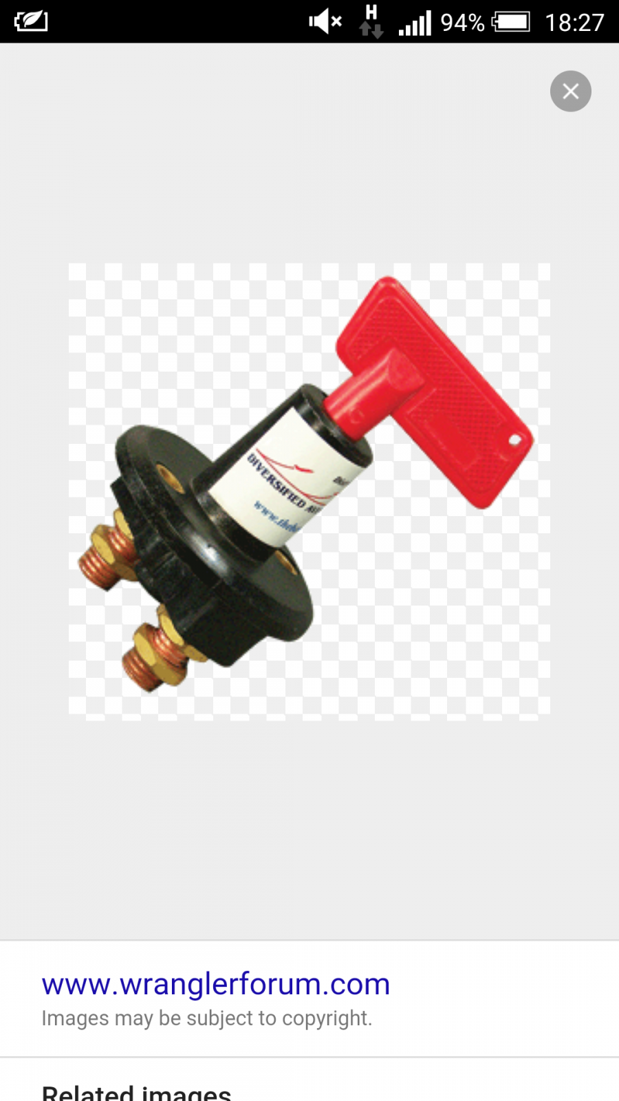

chinkamon Posted September 22, 2015 Author Report Posted September 22, 2015 Immobilised or disconnected? I.e. Do you mean you have a modern immobiliser on it or an old school battery isolator that completely cuts off the battery? If the latter, are there any auxiliary connectors also connected to the battery and are these also isolated by the cut off switch?Sorry guys I have the red key type isolater that switches the liveSimilar to the one in the pic
Admin Vista Posted September 22, 2015 Admin Report Posted September 22, 2015 But is it switching off everything or are there other auxiliaries connected directly to the battery that still have power when that is off?

chinkamon Posted September 23, 2015 Author Report Posted September 23, 2015 But is it switching off everything or are there other auxiliaries connected directly to the battery that still have power when that is off? But is it switching off everything or are there other auxiliaries connected directly to the battery that still have power when that is off? Yea it is on the live straight from the battery and there's no aux connectedd to it an no bridge, so it's as straight forward as a normal switch
