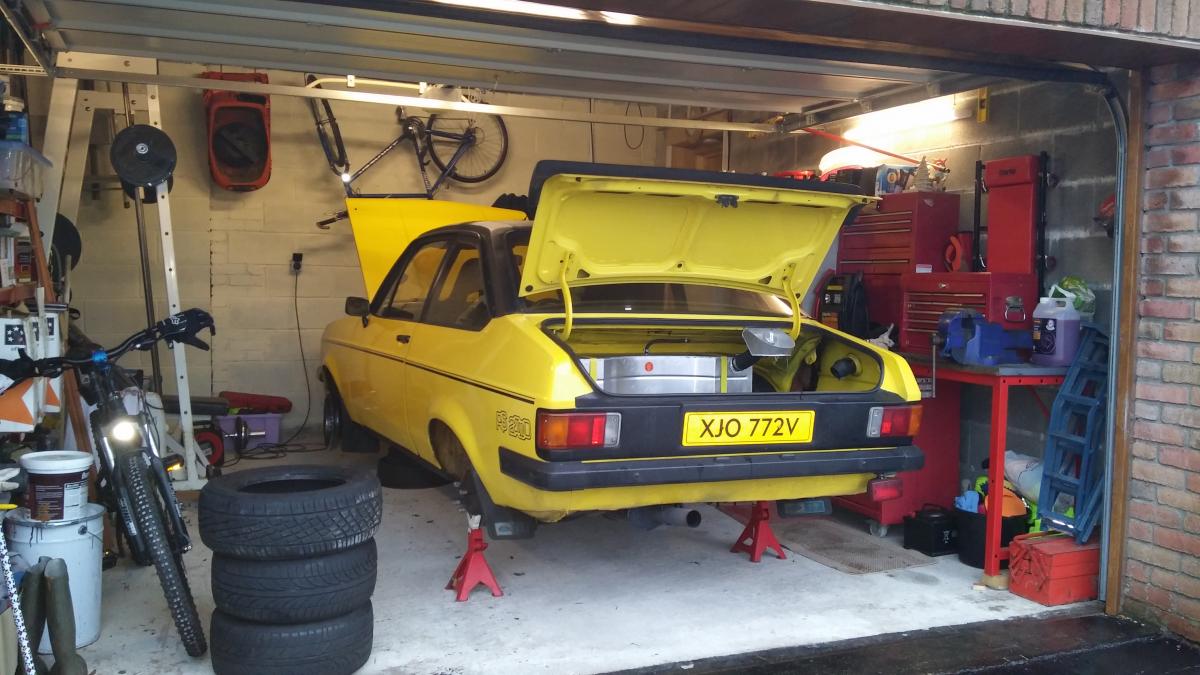

Moderator Rally Pack 2000 Posted February 15, 2016 Moderator Report Posted February 15, 2016 I noticed the other day the rear tyre on the MK2 looked like it was cracking and starting to de-laminate. They were old and well past their use by date. They had gone so hard I thought I was Fred Flinstone but I was just keeping them on till I finished the painting and body work I was very slowly doing. Just too dangerous though so I thought the Mk1 had a set of Yokohama 008R's on it that only had a few dozen kms on them so I thought I would swap them over to the Mk2 before they too started cracking from age. Trouble is they appear to have flat spotted from sitting idle on the Twincam for so long. At about 42kph the steering would shake violently. trying to isolate if all the tyres were at fault or just the fronts as the rears has been stored off car. I tried rotating the fronts to rear. This did improve things quite noticeably and you can drive past the 42kph threshold to 60kph where things seem fine. You do notice a bit of a wobble at 42kph still but you can drive past it whereas before the rotation there was no way you could get the car past 42kph. The strange thing is that the worse pair now on the back you would think you would still feel them out of balance but you dont. Second strange thing is that with two completely different tyres on the front you would think if they were also out of balance due to flat spots that it would occur at a different speed to before. The shimmy, though not as bad still occurs at exactly the same speed. Would rebalancing the wheels help at all? Has changing the wheels amplified a faulty bush, control arm or tie rod end that I never noticed with the old wheels that were more inset than the ones I just put on off the Twincam. I have read conflicting things online about Flatspots, some say you have drive them off over time with the heat and expansion making them go away and others say that its terminal for the tyres. Your thoughts appreciated.

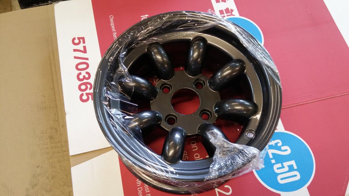

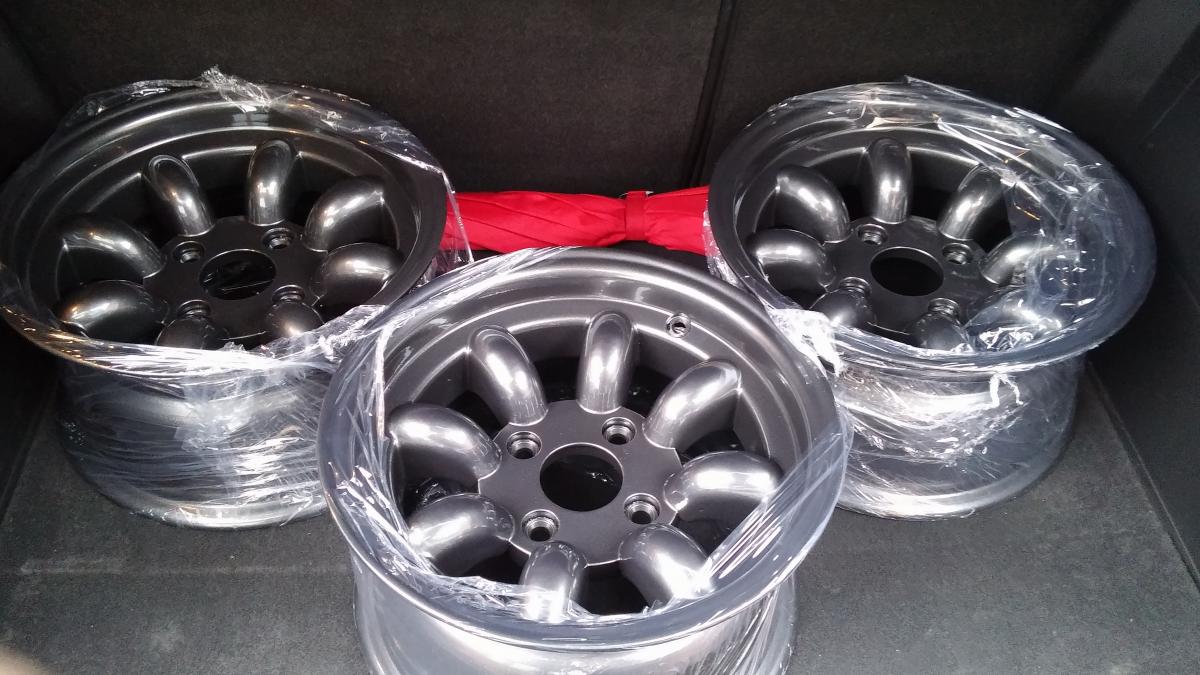

DT36 Posted February 22, 2016 Report Posted February 22, 2016 Nope and thats been a wide variety of different brands over the years. Keep in mind you will rarely see an Escort running 2 inches off the deck here like I see in a lot of cars on this forum. That size was also on the Twincam and only scrubbed if I took rear seat passengers over speed humps. Was a good excuse not to take passengers. On Mk2s however that size is very common. This is good to hear. I've just had my wheels powder coated this week and am about to get 185/60s put back on, instead of 175/50s. My MK2 RS has had it's arches rolled, but I was still a bit doubtful as to whether they would rub. Pleased with my new look wheels though:
Moderator Rally Pack 2000 Posted February 22, 2016 Author Moderator Report Posted February 22, 2016 This is good to hear. I've just had my wheels powder coated this week and am about to get 185/60s put back on, instead of 175/50s. My MK2 RS has had it's arches rolled, but I was still a bit doubtful as to whether they would rub. Pleased with my new look wheels though: Nice!!! I want those rims for my Twincam. One caveat I should have added to that statement is that I use 6in rims with only moderate offset. 1
DT36 Posted February 22, 2016 Report Posted February 22, 2016 I went with Gun Metal Grey. Looks nice against the yellow. Just waiting on mu strut brace, rocker cover, bonnet catches and fuel cap to be done now. pick them up Friday. Haha, now you tell me about the size of your rims... never measured these ones, as they were already on the car when I bought it. Fingers crossed though that they will be OK and the 185s will fit the rears without rubbing. The tyres are noticeably bigger though.
stephens_xpack Posted February 22, 2016 Report Posted February 22, 2016 New wheels look awesome, I like... 1
