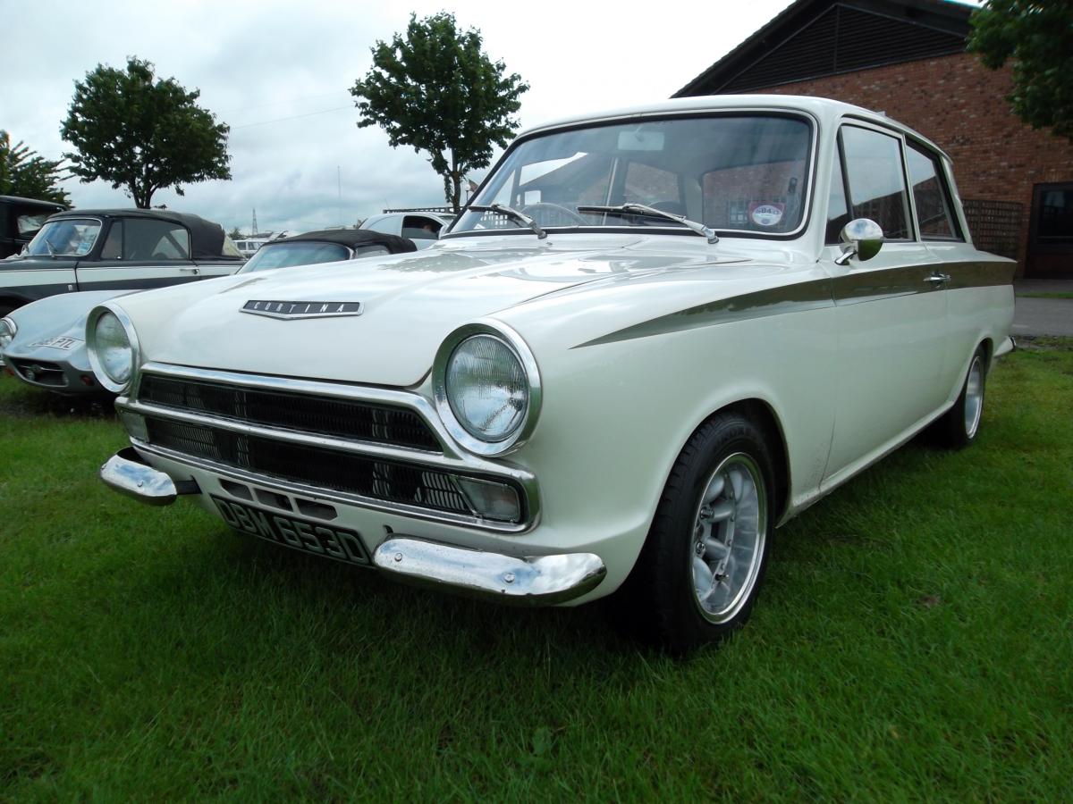

So now running out of important things to do to the car / getting a bit bored with important bits- an i keep looking at the tyres...
A chap I know has a mk1 lotus cortina an told me what he found the best for comfort and look etc
Whilst I'm happy with the front ( can't go any wider as they're almost rubbing )
The back I feel cud do with being an inch or two wider!?
What size tyres do you have on your lotus rims??
I have 185 70 13's ,but you can go as wide as you like as they are so far in from the arch.
puddy :)
You can go above this but is a bit pointless really as you distort the tyre as the rim is to small and would not get any benefit from doing so.
I reckon you could hang 205 60 13's on em if you wanted the really fat look .
People used to fit them on mk2 rs2000,s back in the day with 6j rs rims .
puddy :)

185 80 r13s on the rear......
I got 165 80s on the front
So a little wider on the back for now, 185s for the width but thinking 80s as the front are 80s already??
Thoughts???
Thoughts???
A definite NO if you could still get them they are huge in diameter
AH ok! So if I were to get 185 70s for the back (sticking with 165 80s on the front ) then would u notice the fronts are 80s an the backs are 70s??
Thought some Eagle eyed might spot the backs are a little shorter?!"
Yes the first figure is the width the second is aspect ratio, don't ask me to explain aspect ratio because I can't remember it was a long time ago !!
It's the percentage of the width.
