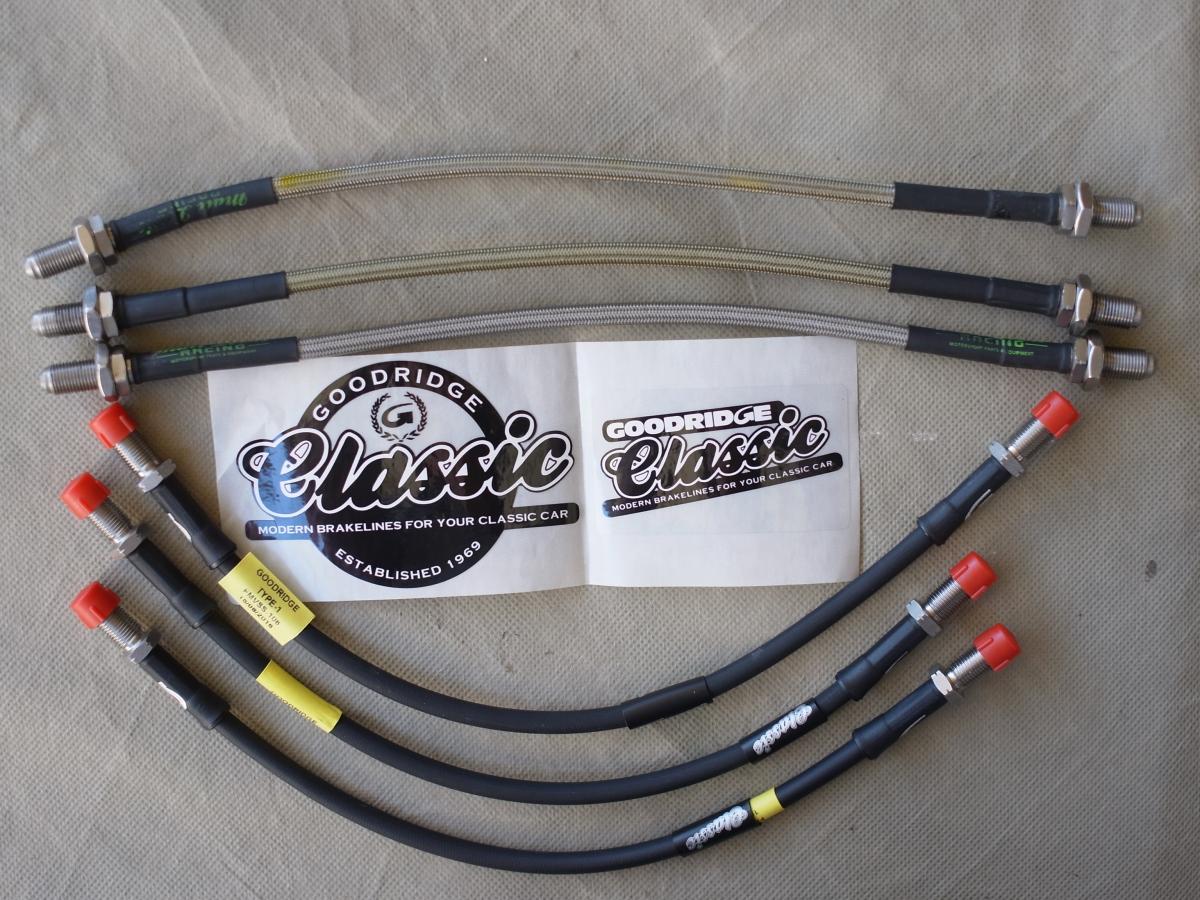

The Goodridge Classic SS brake lines arrived from Burtons promptly and without incident. They seem to be of good quality with a subtle look were no one would probably even realise they are in fact braided lines.

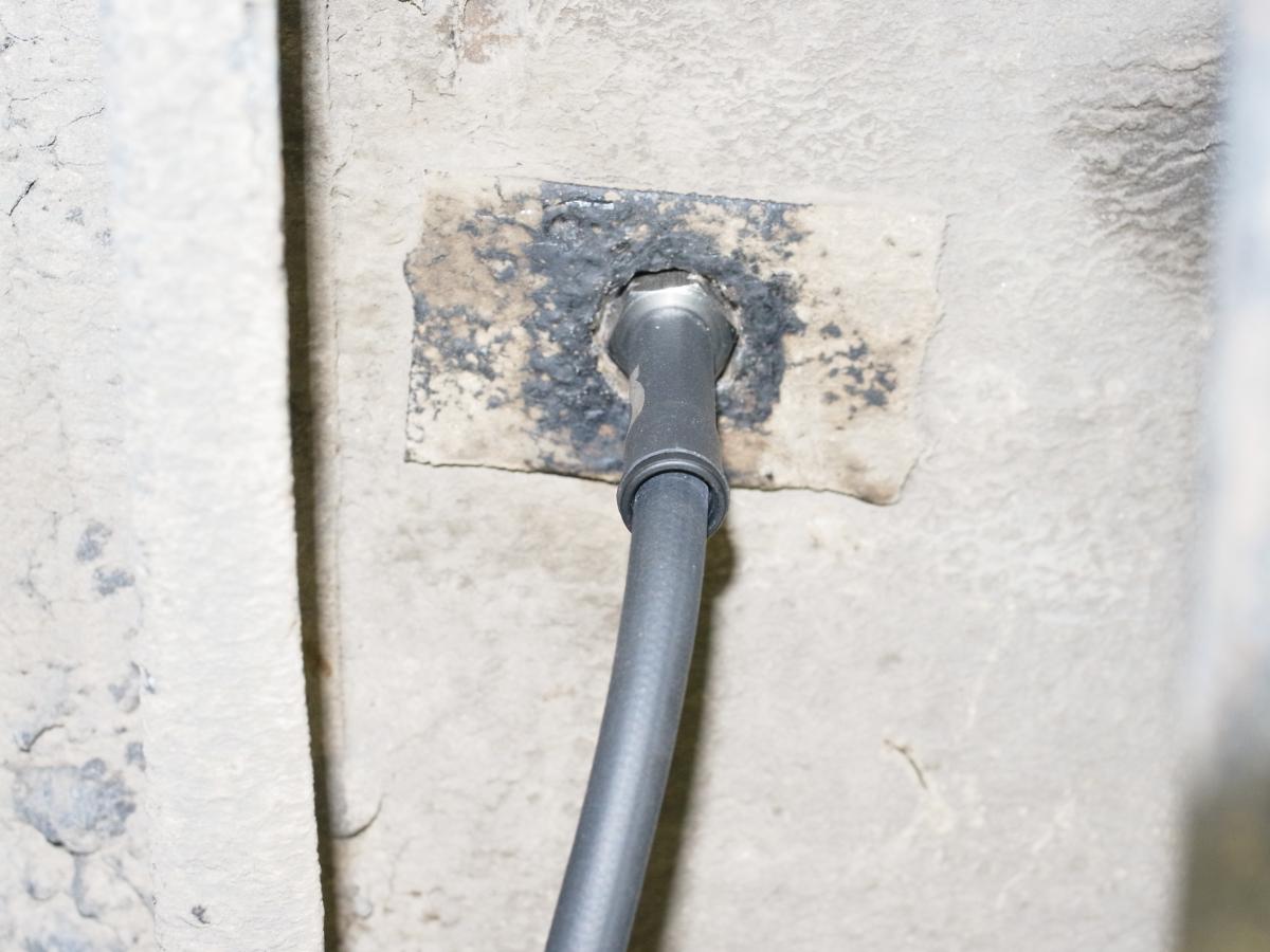

Fitting them though I discovered a glitch with them. Original rubber lines have a long hex section so that you can put a 14mm spanner on them so when you tighten the nut on the inner guard the hose wont twist with it. The Goodridge lines have a 13mm nut type flange incorporated into the stainless steel end. With Escorts however there is a recessed plate on the inner guard. With a conventional rubber hose the hex section at either end is so thick that it extends outside the recessed mounting point and you can still get a spanner on it. Not so the Goodridge lines that the 13mm hex section is so thin that its flush with the mounting depression and you cant get a spanner on it. The Teflon inner tubes of these lines is susceptible to strong twisting so you must have support for it to prevent that and also one day you will want to take the things off again. Natural solution would be washer of some sort but all off the shelf 10mm holed washers are too large a diameter to fit within the depression and too thin.
So far that only option seems to be drilling out some 8mm washers but would probably need at least three stacked to make up the gap needed. That seems a bit sloppy to me so looking for an alternate thicker spacer washer type deal. If anyone has come up with a neat solution having fitted these lines please let me know. Thanks

Don't forget also that the hoses that go through the inner guards will need half thickness nuts due to the multiple skins, if you use full nuts you may find the pipe nuts bottom out before nipping the pipe fully.
  • Moderator
Yes thats exactly the problem Im facing. In order to fit a spacer nut because Goodridge made the ends too small it means drawing the end further under the guard leaving less thread in the engine bay. I wrote Goodridge about it, why they put 13mm ends on it instead of 14 and they never replied. They cant have done any research it seems yet the ones I bought first which arent ADR compliant do have the correct 14mm ends. The system is broken somewhere LOL
