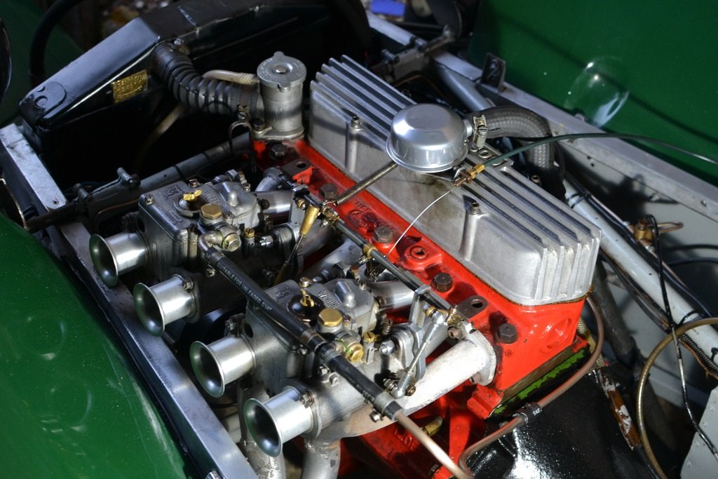

scalino65 Posted June 25, 2018 Author Report Posted June 25, 2018 p.s. Here's a pic of the car and the original pre-xflow engine that's currently in it. 2

Moderator Rally Pack 2000 Posted June 25, 2018 Moderator Report Posted June 25, 2018 Shes a beauty. Given the car I would keep the original engine in it. Always a few tweaks can be had to squeeze a bit more power out of it. A seven will always be fun regardless of power. Originality would win out for me though.
RWL81P Posted June 25, 2018 Report Posted June 25, 2018 cracking engine them 1500 pre xfs. i'd keep that in and tune it up a bit. mk1 cortinas go well with them in so that should be a flying machine.
