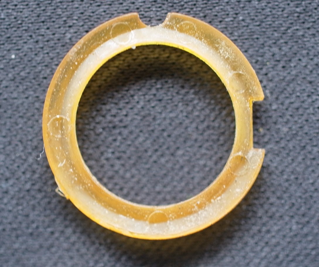

Moderator Rally Pack 2000 Posted May 2, 2019 Moderator Report Posted May 2, 2019 I was just wondering if anyone has ever had parts they were unable to source replicated by someone through a 3D printer? Is it only for reasonable sized items or can you get much smaller items replicated with fine accuracy as well? There are some small brown plastic rings that serve as a low fiction washer between the lock barrel and the door handle on Mk2 Escorts and Mk3 Cortinas. These plastic rings deteriorate very easily and will fall away in bits inside your door. The lock barrels are then able to move around more than they should, generally moving deeper into the handle. I still have a lone new one and I thought if the 3D process was accurate enough to whip a batch of them up? Most of the 3D printing I have seen in videos has been chunky and rough.

katana Posted May 2, 2019 Report Posted May 2, 2019 If it is as you describe - a washer? - then turn it up on a lathe in plastic or metal ? By the time you cad/cam it up, upload it to the printer and make one, your machinist will have 10 waiting for you. But for things that have 3d detail, hollows, reverse curves etc. then the printed plastic is an option - certain metals are now becoming an option! There is a limit to the 'smoothness' of the finished parts with plastic, as the nozzles can only be so fine before clogging occurs.

Moderator Rally Pack 2000 Posted May 3, 2019 Author Moderator Report Posted May 3, 2019 13 hours ago, katana said: If it is as you describe - a washer? - then turn it up on a lathe in plastic or metal ? By the time you cad/cam it up, upload it to the printer and make one, your machinist will have 10 waiting for you. But for things that have 3d detail, hollows, reverse curves etc. then the printed plastic is an option - certain metals are now becoming an option! There is a limit to the 'smoothness' of the finished parts with plastic, as the nozzles can only be so fine before clogging occurs. Yes I could only describe it as a washer in its basic form and function but just like you mentioned it has hollows on one side and and tapered curves on the other. So while it is a washer as such its a carefully sculptured one to prevent the locking barrel moving about as you turn the key. Looking at the photos I took today enlarged it may not be possible for a machinist to replicate.

katana Posted May 3, 2019 Report Posted May 3, 2019 3 hours ago, Rally Pack 2000 said: Looking at the photos I took today enlarged it may not be possible for a machinist to replicate. That really isn't a complex part! Depending on the cross section profile there are only about 5 or 6 operations on a lathe and another 2 to cut the squared shouldered and the half round slots on a mill. Given the potential size, it could be 3d printed but I don't think you would get crisp edges / corners in the slots (subject to print orientation!)
Moderator Rally Pack 2000 Posted May 3, 2019 Author Moderator Report Posted May 3, 2019 1 hour ago, katana said: That really isn't a complex part! Depending on the cross section profile there are only about 5 or 6 operations on a lathe and another 2 to cut the squared shouldered and the half round slots on a mill. Given the potential size, it could be 3d printed but I don't think you would get crisp edges / corners in the slots (subject to print orientation!) It was not so much the complexity on its own as such but how small it is and how difficult it would be to achieve the grooves and curves on such a tiny item. I didn't realise myself it was even shaped like that until I magnified it. If you think its not that big a task then I will ask the guy who did my brake bushes and see what he says

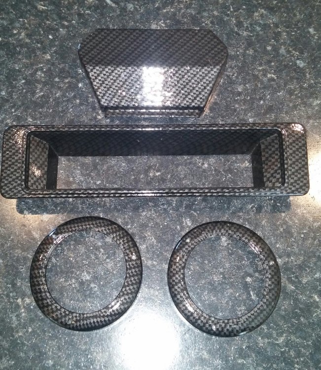

TheGentlemanMaker Posted July 25, 2019 Report Posted July 25, 2019 I've successfully 3D printed an adaptor to go between my speedo drive and the clock on the dash. The cable had previously been hacked and held on with tape...now it's a snug fit with a small machine screw securing it. Also printed the grille shown here to go in my bonnet vent. It's held in with Tigerseal and seems to be holding up even in this weather! 4
Moderator Rally Pack 2000 Posted August 9, 2019 Author Moderator Report Posted August 9, 2019 Can you sand this 3D printed materials? I ask because a guy has produced some replica Mk1 air vents. The earlier style which you cant seem to find in mind condition. The 3D printing has a very unsightly finish to it but was wondering if it could be sanded and finished to a more realistic standard?
Daniel13 Posted August 9, 2019 Report Posted August 9, 2019 2 hours ago, Rally Pack 2000 said: Can you sand this 3D printed materials? I ask because a guy has produced some replica Mk1 air vents. The earlier style which you cant seem to find in mind condition. The 3D printing has a very unsightly finish to it but was wondering if it could be sanded and finished to a more realistic standard? Yes 3D prints can be sanded pretty well, PLA at least any way, ABS is a touch more difficult. The ash tray holder in my MK1 Escort had all of its corners chipped off. You can get re-productions for about £30 on Ebay, which seemed a little steep to me, and I hate the little metal clip that holds it into place. I designed and printed a new unit that kind of self clamps itself to the centre console without added hardware. Sanded it and spray painted it satin black and honestly you wouldn't know the difference. I haven't got any pictures on the PC however. I have also printed some custom GT style centre caps, which I do have pictures of. I didn't do them to as high of a standard because they are on the wheel and will be getting hit by chippings and debris from the road, but are still pretty effective. On this note, if anyone can think of any hard to find parts, like the air vent above, that would benefit from being reproduced, I'm always keen to take on a new challenge! 3

TheGentlemanMaker Posted August 9, 2019 Report Posted August 9, 2019 I'm just learning that printing the item at an angle to the bed yields good layering results, i.e. not perpendicular/flat with the bed.
DT36 Posted August 9, 2019 Report Posted August 9, 2019 Perhaps a hydrodip will give them a smooth finish.
Moderator Rally Pack 2000 Posted August 9, 2019 Author Moderator Report Posted August 9, 2019 1 hour ago, dt36 said: Perhaps a hydrodip will give them a smooth finish. Does that stuff cover rough surfaces to smooth them out? I can get the early vents that are in rough condition and thought of using plastic filler and sanding them up. If they can be dipped in all black it should simply look like new wouldn't it?
Moderator Rally Pack 2000 Posted August 9, 2019 Author Moderator Report Posted August 9, 2019 4 hours ago, Daniel13 said: Yes 3D prints can be sanded pretty well, PLA at least any way, ABS is a touch more difficult. The ash tray holder in my MK1 Escort had all of its corners chipped off. You can get re-productions for about £30 on Ebay, which seemed a little steep to me, and I hate the little metal clip that holds it into place. I designed and printed a new unit that kind of self clamps itself to the centre console without added hardware. Sanded it and spray painted it satin black and honestly you wouldn't know the difference. I haven't got any pictures on the PC however. I have also printed some custom GT style centre caps, which I do have pictures of. I didn't do them to as high of a standard because they are on the wheel and will be getting hit by chippings and debris from the road, but are still pretty effective. On this note, if anyone can think of any hard to find parts, like the air vent above, that would benefit from being reproduced, I'm always keen to take on a new challenge! Your printing doesn't seem as jagged or rough as the vent I have pictured. Is something like that too complex to get a smooth finish or is it just the quality of the printer and materials used?
