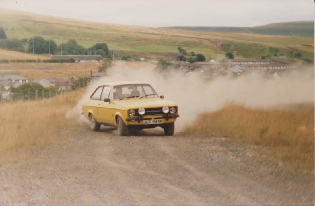

DT36 Posted October 15, 2019 Report Posted October 15, 2019 I can remember stripping out a Ghia for my 1300 Sport in the late 80s and I took out all of the sound proofing from under the carpets, along with any extra interior trim that my car didn't have. The car was parked up with a front end bump on our camp and belonged to one of the NAFFI girls. Apparently, she was going to get it repaired and went ballistic when she finally got round to it. Well, what did she expect from three seventeen year old Apprentices who had all bought Escorts as their first car. 😂😂😂

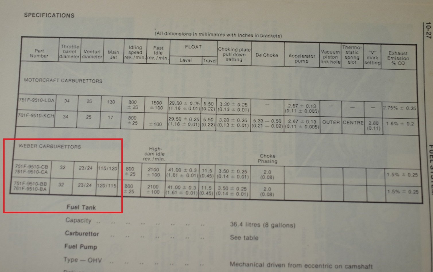

Moderator Rally Pack 2000 Posted October 15, 2019 Moderator Report Posted October 15, 2019 Its interesting that everyone is quoting a 32/36 DGAV/DGV as the carburettor for a 1600 Sport Engine. All our Mk2 GT Spec 1600 Kent engines only ever used the 32 DGAV (32/32). The 32/36s were only used for Pinto engines. The specs apparently vary from country to country. Ive added a image from the manual it only lists a 32DGAV for Mk2 1600 GT engine. I would be curious to know what models received a 32/36 instead.

RWL81P Posted October 16, 2019 Report Posted October 16, 2019 On 15/10/2019 at 19:07, dt36 said: I can remember stripping out a Ghia for my 1300 Sport in the late 80s and I took out all of the sound proofing from under the carpets, along with any extra interior trim that my car didn't have. The car was parked up with a front end bump on our camp and belonged to one of the NAFFI girls. Apparently, she was going to get it repaired and went ballistic when she finally got round to it. Well, what did she expect from three seventeen year old Apprentices who had all bought Escorts as their first car. 😂😂😂 still a cracking pic this! 1

colr6 Posted October 16, 2019 Report Posted October 16, 2019 20 minutes ago, RWL81P said: still a cracking pic this! What he doesn’t show you is it ended up on its roof after that, ambitions and capabilities......lol 1
