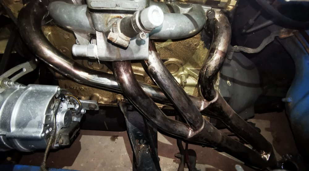

chinkamon Posted February 6, 2022 Report Posted February 6, 2022 On 26/01/2022 at 11:20, BaileyMex said: Yeah sounds familiar, think I'm going to try to take a trip over there one day next week to get it on their ramps How did you get on after? I bought a stainless manifold for my precrossflow then made the rest of the exhaust from there an topped it off with a cherry bomb muffler but then I am an old hot rodder so bore size, period looks etc never really come into it 😂
