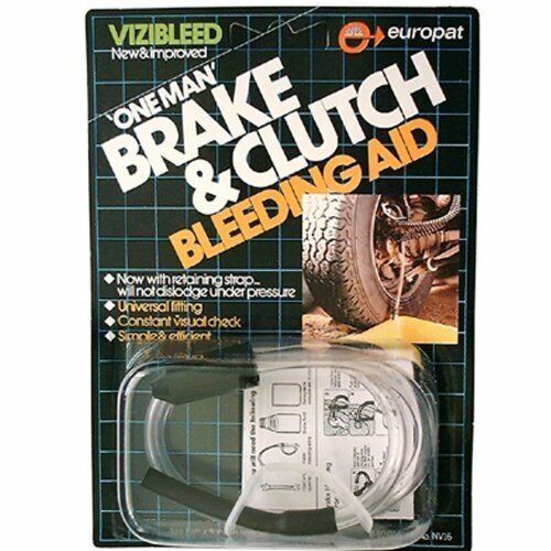

Moderator Rally Pack 2000 Posted December 13, 2022 Author Moderator Report Posted December 13, 2022 I found it! The one I used to use was the Europat Vizibleed. Its not available here any more but still seems to be around in the UK. There is a second version I haven't seen before with a bottle attached to catch the fluid. As you can see is nothing as complex as the vacuum ones. Just always had success with it and if something works I try stick with it. There is a YouTube Video even and the guy buys them from Halfords apparently.

Moderator Rally Pack 2000 Posted December 14, 2022 Author Moderator Report Posted December 14, 2022 9 hours ago, Ray said: when i were a lad a simple brake bleed tube like this sufficed, a blanked end tube with a slit in it, e bay item no. 162887837589 hovever these days i use a vacuum bleeder as this dosnt need a second person and modern vehicles it tends to be think again, as some ABS systems even that dosnt work, my transit for example has to have the ABS system bled with the diagnstic system, and it also forbids piston pushback without the bleed nipples open, ie all the excess fluid from push back must come out of the bleed nipples and not back through the system, and fresh fluid must be put in through the master cycinder, as the ABS system is very sensitive to the slightest of dirty fluid modern junk I guess thats why the one i pictured above is pretty much discontinued which just a bit of NOS laying about in the UK. Its pretty much unusable in anything built in the last decade. I will say it again ........ old cars are better!
