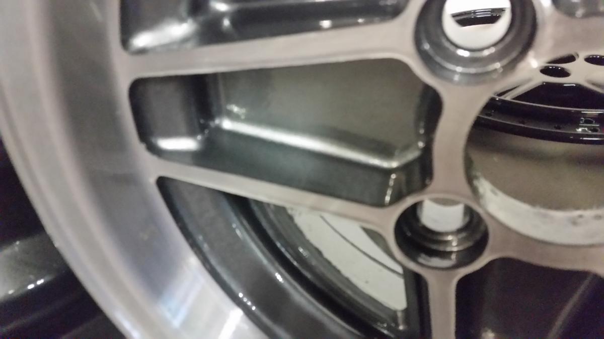

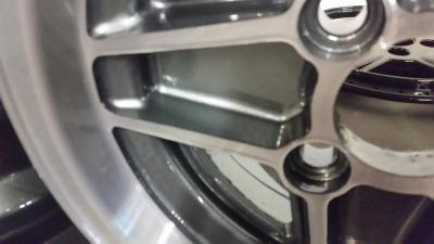

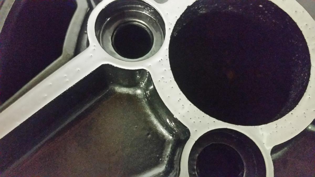

dalmarshall Posted December 18, 2015 Report Posted December 18, 2015 I put these in for a refurb a few months ago and firstly got them back untouched because they were buckled a little bit and they couldn't straighten them. So I find a place that can straighten them, powder coat and diamond cut them......brilliant!! I went to collect them last month and was disappointed to find the laquer was very thick and formed a 'ridge' at the bottom of each spoke. There was also a bit of black 'spotting' under the laquer. Not a great pic but you can see the ridge of clear laquer I obviously rejected them and asked him to do them again, as for £390 it wasn't good enough! (4 x straighten buckles and 4 x powder coat and diamond cut for £390) He told me that it's old alloy and it holds oxygen and that's why you get pitting and spots in the diamond cut surface , he can't really odds it! It'll never come out like a modern alloy! So, today I go back to collect them after another cut and laquer and this is what I'm presented with They're even worse!!!! As well as all the popped bubbles, the rim is Cloudy under the lacquer. He's doing them AGAIN now but tells me that he can't guarantee they'll be any better due to the oxygen in the alloy. I'm no alloy expert but I've seen many decent rs alloys without these defects, is this bloke fobbing me off??

JP. Posted December 19, 2015 Report Posted December 19, 2015 Its not bolloks. Its what you can expect to happen with those poor moulded quality aftermarked wheels like Midland sels. They are bad moulded with insufficeint quality alloys ( mostly scrap alloy from Russia ) and contains lots of air bubbles and air pockets inside the moulding. Genuine Ford RS alloys are much better quality and more suited to recieve the diamond cut threatment.

dalmarshall Posted December 19, 2015 Author Report Posted December 19, 2015 Yes they are genuine alloys, Grp1 ronal 6'. He also said that the result would be better if he wet laquered them rather than powder coat. I'm not sure how that makes a difference TBH!
Danish Posted December 19, 2015 Report Posted December 19, 2015 I'm not 100% sure, but I think the guy who does my wheels heats them in the powder coating oven first to drive out any gas, then later puts the powder on and heats them again.
katana Posted December 19, 2015 Report Posted December 19, 2015 Looks like contamination to me! I would guess they haven't been thoroughly degreased after being cut! Porous casting is possible but unlikely to occur at powder coat temps!

dalmarshall Posted December 19, 2015 Author Report Posted December 19, 2015 The markings are on the backs of these, although you can barely see any now due to the thickness of the powder coat!

dalmarshall Posted December 19, 2015 Author Report Posted December 19, 2015 I gave him the option that I'd take them elsewhere and just pay him for the straightening, but he said he'd cut them again then call me to inspect them before lacquer. If he's fobbing me off with the oxygen story then I suspect it's as Katana says...contamination. I suspect he's also probably inexperienced, 25-30 years old max
guido Posted December 20, 2015 Report Posted December 20, 2015 when i look at close-up 20151218_132439.jpg i would say it has something to do with the process of prep. and coating. Some residue or deposits from grease or oxidation or something with the coating powder or paint aint right. I don't think its the material of the wheels. If there any air pockets due to imperfect casting, they are so small within tolerances a layer of powder coat shuts them of, you wont notice hardly any of them, such tiny are they. just a note, if you put your fingers to it even after washing them before, it can leave little grease and acids from skin behind, especially when sweaty too. So i always using cotton /synthetic gloves for paintwork

mk1parv Posted December 28, 2015 Report Posted December 28, 2015 i work at pristine and unfortunately the casts of old 70's and 80's wheels are not great. they have cast holes inside the alloy and we never lacquer the machined areas on those wheels along side the triumph stag wheels, dolomite or anything as old as that. 2
dalmarshall Posted December 28, 2015 Author Report Posted December 28, 2015 Would it better maybe to leave them with NO clear coat? I assume they would be quite porous and need regular autosol!
mk1parv Posted December 28, 2015 Report Posted December 28, 2015 Would it better maybe to leave them with NO clear coat? I assume they would be quite porous and need regular autosol! That's how they came originally from the factory, autosol and maybe a wax like 'poorboys' helps them from corroding sooner. unfortunately its just the way it is and the best way to keep the shine. If the wheels were lacquered, the corrosion comes from inside out. 2

sierra1off Posted December 29, 2015 Report Posted December 29, 2015 That is a common problem with old alloy wheels. Cannot be helped, as they have said, air in the casting forms bubbles under the laquer ( even when they are pre heated)
katana Posted December 30, 2015 Report Posted December 30, 2015 This 'air bubbles in the alloy' is BS! There maybe air bubbles there, but unless 'surfaced' through when cutting, they'll never surface - they don't migrate to the surface like bubbles in water! Its a piss poor excuse for piss poor work. As said before, powder coating heats the alloy but not enough to 'float' air bubbles! and lacquer is cold application so shouldn't either otherwise..... how can some companies achieve flawless results with the same wheels, manufactured by the same companies, of the same age? 1
colr6 Posted December 30, 2015 Report Posted December 30, 2015 You do get so called air bubbles in aluminium,but would suggest these imperfections are more due to bad cleaning of wheel after cutting which has resulted in a reaction in the lacquer of which you would not normally see if done correctly
dalmarshall Posted December 30, 2015 Author Report Posted December 30, 2015 Hmmm....its hard to decide what I should do with these now, take them without lacquer or do them again. Lacquer ends up chipping or getting moisture underneath anyway so the answer might be to keep them diamond cut and maintain them regularly with autosol or some kind of wax? He can't keep cutting them until they're right as there will soon be no 'meat' left on them!
katana Posted December 30, 2015 Report Posted December 30, 2015 Personally i'd hand polish them ..... T-Cut or Autosol, your choice although I'd only use Autosol on dull / corroded alloy as it is quite abrasive for regular use and then use good quality wax regularly to maintain the look. Its std. practice on early bike alloy wheels which are rarely diamond cut but suffer equally badly on our salty roads once it gets under the japanese lacquer. 1
