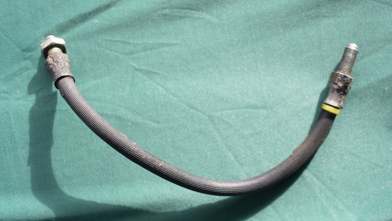

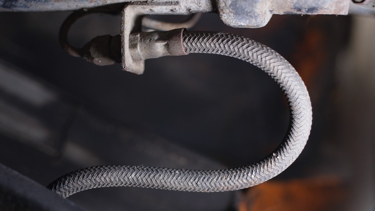

This is what Ray is after. These are the ones still on my Twincam (My apologies for the photo being on its side it is not in the original file but the new uploader system refuses to load vertical photos any more and automatically tilts them horizontal. That will be very problematic in years to come im sure.)
The second photo are the originals I just took off my Mk2. They have a more recognisable line pattern on them which still can be seen on virtually all rubber brake lines available today. On the car they seemed to look ok so they have never been changed since new but its one of those things that you don't really think of as a service part. When I undid the nut holding it on the rubber hose twisted ever so slightly beyond its normal movement from steering and the rubber just crumbled. It gave me a hollow scary feeling as to how really dangerous their condition was. I would imagine your salty winder roads would be even more destructive to yours there. Given the Twincams are even older and still on the car I cant imagine they have any life in them whatsoever even though they look fine on the surface.

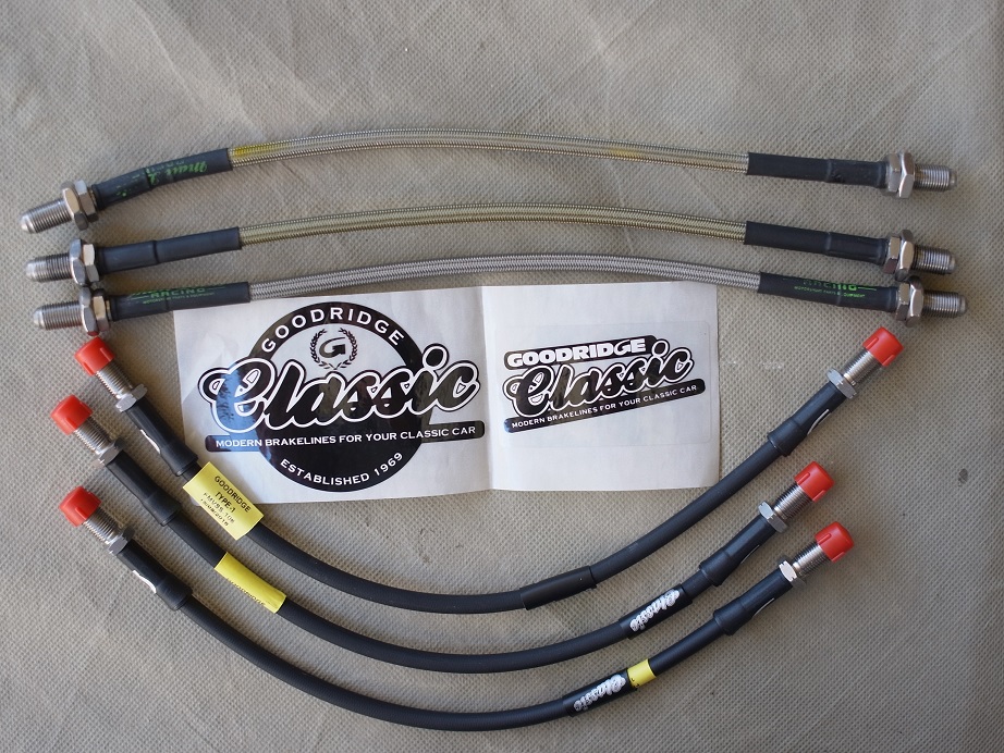

In another thread I discussed changing to braided stainless and went with the Goodridge Classic which has a conventional matt black rubber look to them. It highlighted just how far gone the rubber ones had gone. For at least a decade I remember thinking to myself these brakes a spongy and not as firm as they used to be. I put it down to my home alone do it yourself bleeding skills. It wasn't that at all it was the old rubber lines ballooning when I pressed the pedal. Adding that also to the replacement of all the plastic bushings in the pedals and booster with brass/bronze ones its now very very hard. So much so I am contemplating removing the Goodridge Stainless for conventional rubbers ones but new of course.
Having been fooled by the alarming degradation of the original lines on the Mk2 one day soon I will be in a similar position to Ray. With the Twincam you try to keep it as original as possible. These braided textured rubber lines seem to have vanished by the mid 70s where the more recognisable line type takes over. I don't think I would use the Goodridge Classic on the Twincam. While they have a traditional rubber look which to the casual observer they are just regular rubber lines the "original look" appeal is negated by the fact they are way thinner than conventional rubber lines. They almost look spindly in comparison when in fact the opposite is true. I can definitely show that the other rubber pattern type was used by Ford in the 70s so this design would still be considered period. The line imprint was not something that came out in the 90s or anything like that as my original Mk2 ones shows in the photo. Given that this pattern seems present in every new rubber type I see for sale today that's what I would use as replacement for the Twincam. Still rubber and still period. No one even at a concourse would fault the use of these, even if they noticed as most are unaware of the weave textured imprint early type. The Goodridge ones, even in their "Classic" guise are quite obvious to the trained observer. Not only with the thickness of the lines themselves but the end fittings. Goodridge didn't even bother to do their research and get the end nuts the right size that fits into a recess on the inner guard. As such they spin when you try to tighten them and you have to add a secondary 14mm nut to lift the end fitting out of the recess so you can put a spanner on it. On Rubber ones there is a defined conical fitting with hex edges to facilitate a spanner. The Goodridge as with most stainless lines just has a thin nut end and in the Goodridge case its the wrong size.
So Ray for for your own safety don't go fitting old rubber lines just to achieve that textured finish. Fit new rubber ones of the later 70s period that you can still get new today. If I got a set of rubber ones for my Mk2 to switch back from the Goodridge ones you would not be able to tell the difference to the original ones the car came out of the factory with. True when it comes to the Twincam it will have a slight difference in sheath pattern but it will look just as good and you can have the piece of mind that they will be safe for many years to come. The added bonus is that they are also the cheapest too!
