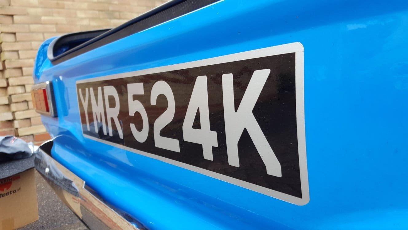

OSF Contributor Mexican Gerbil Posted May 19, 2022 OSF Contributor Report Posted May 19, 2022 I want this style of number plate made. Has it a name or type that it's known by. I've had a Google 70s style plates and there is a company in St Austell known as Tippers classic plates, but they don't have the same font. Anyone had any made recently or recommend a company?

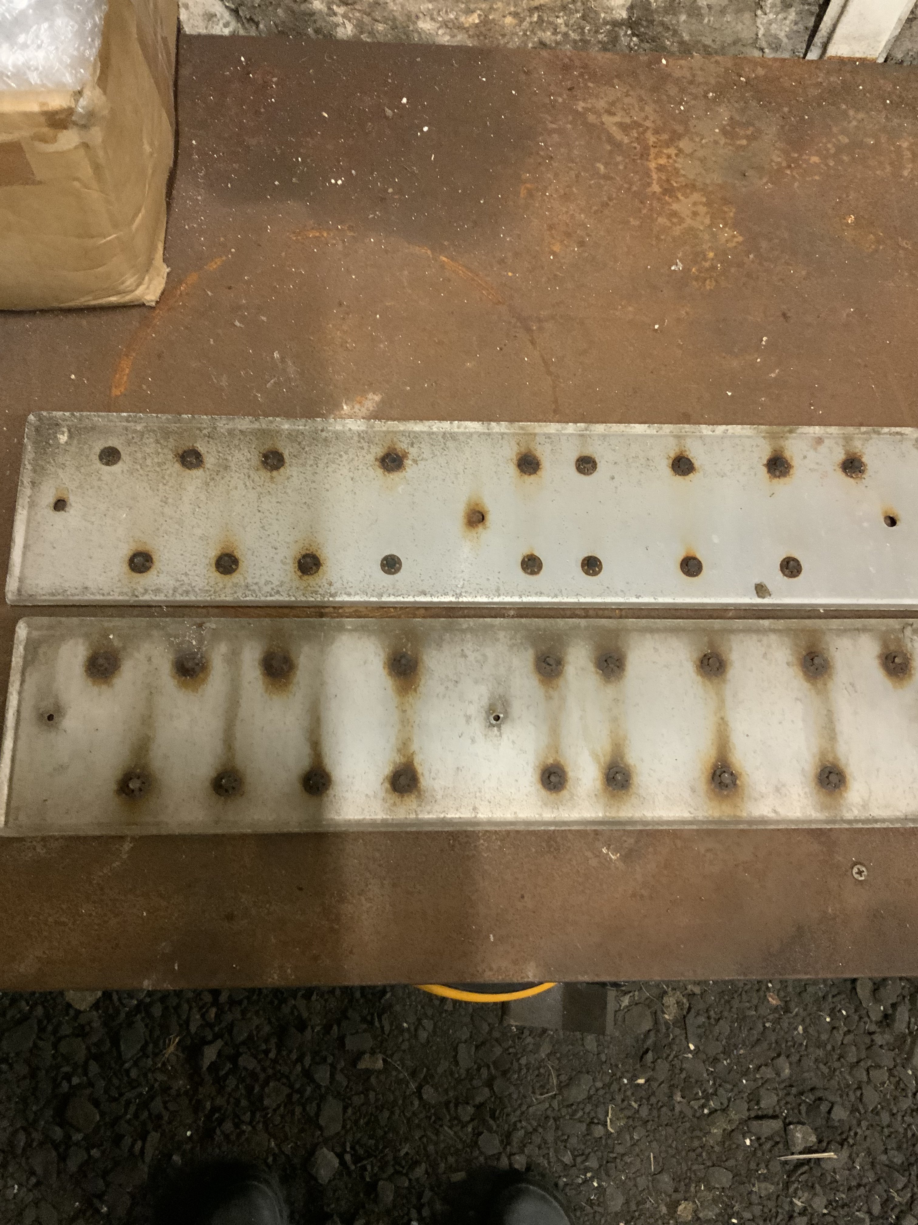

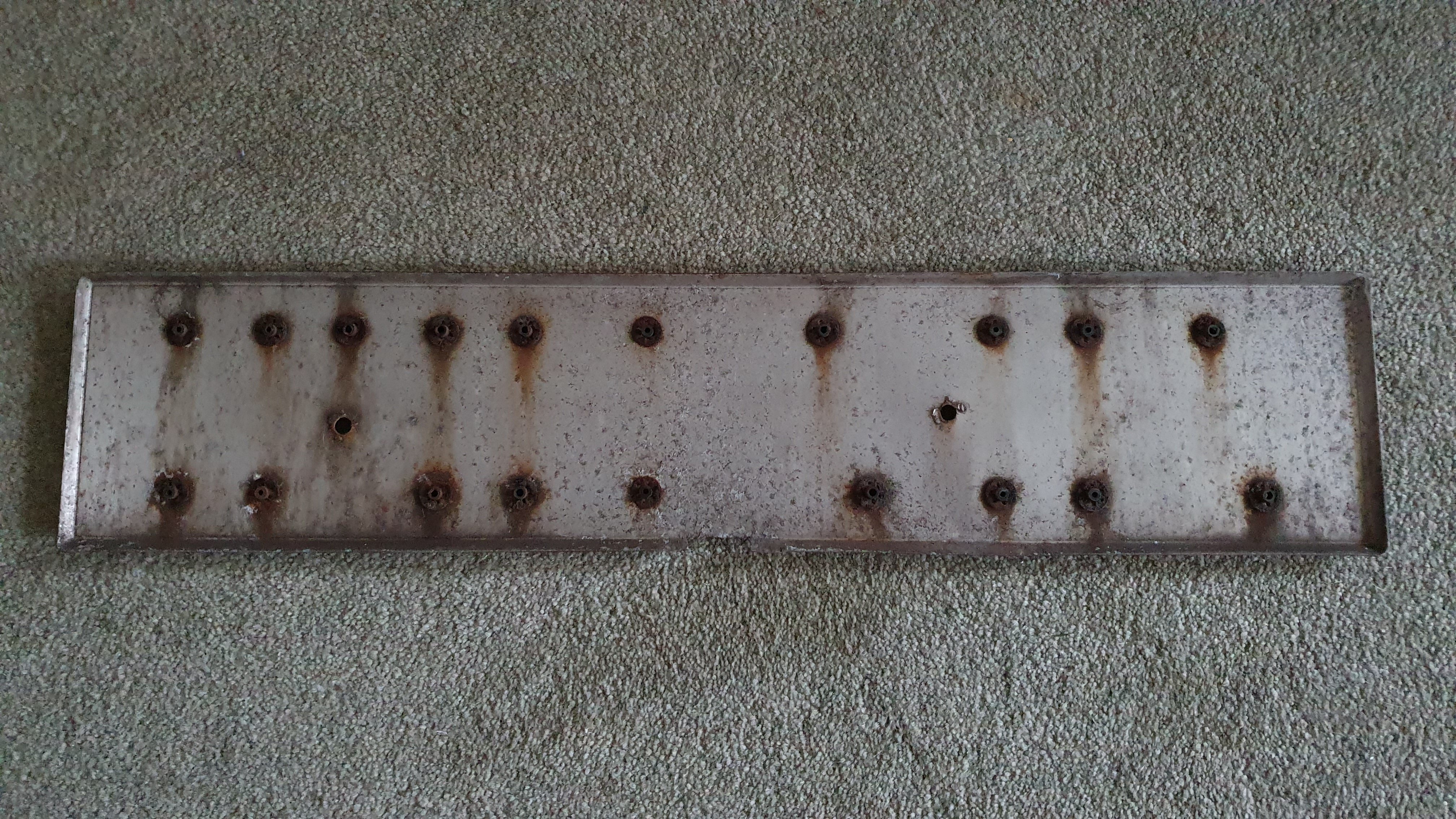

Ray Posted May 19, 2022 Report Posted May 19, 2022 lol, where did i get that reputation from colin @colr6 ok, yes i use tippers, for 2 things, i buy their 70s style plate, but only as an interim, because as you say the fonts are all wrong so i then scour e bay for a while looking for several things, first is the digits in a style you want, and i dont look for a specific manufacturer, i just look for what pleases me, i also prefer the 3D raised opposed to the flat, some are very hard to find if your fussy tbh, the digits can be anything from NOS to fitted to an old plate like your picture, so sometimes you buy a plate to get what you want then your search also extends to a suitable back plate, Hills, Bluemells, or dosnt even need a name if your not bothered, once you have these original matching plates, paint strip them and polish the edges, then get the holes welded up, then begins your job of smoothing the welds once you have your letters and welded plates, you need to send them to tippers, they will fit reflective vinyl and fit the digits at the correct spacing unfortunately ive not found anyone to replicate the original reflective paint tioppers can put a sheet in to make the plate smoother, but you loose the depth when you get it back from them, there will be air bubbles, but mine disapeared after a month, i also take the digits off and clean the hole backs then re fit the digits, as they leave them burred i have quite a lot of digits over, pm me if your looking for something, but i dont have full sets, so may not have them all, or in the style you want 1
OSF Contributor Mexican Gerbil Posted May 19, 2022 Author OSF Contributor Report Posted May 19, 2022 @Ray Thanks, I have just been looking through ebay thinking I might have to buy old plates to make them up. If thats the case i might as well keep and use this rear one and try and find letters to match for the front. Was gonna get a set for the Mk1 Mex but sound like alot of effort. will PM you with what im after.

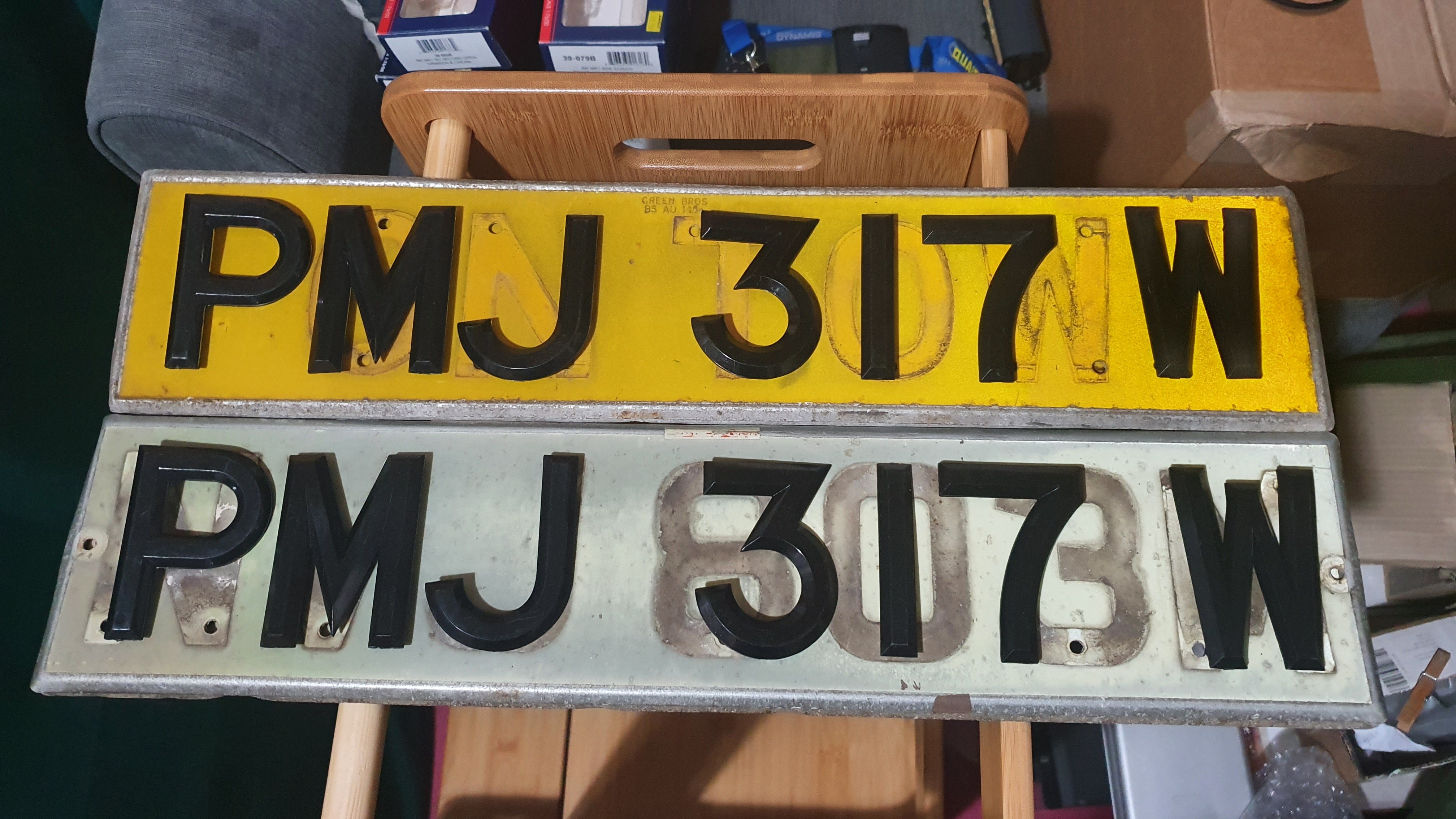

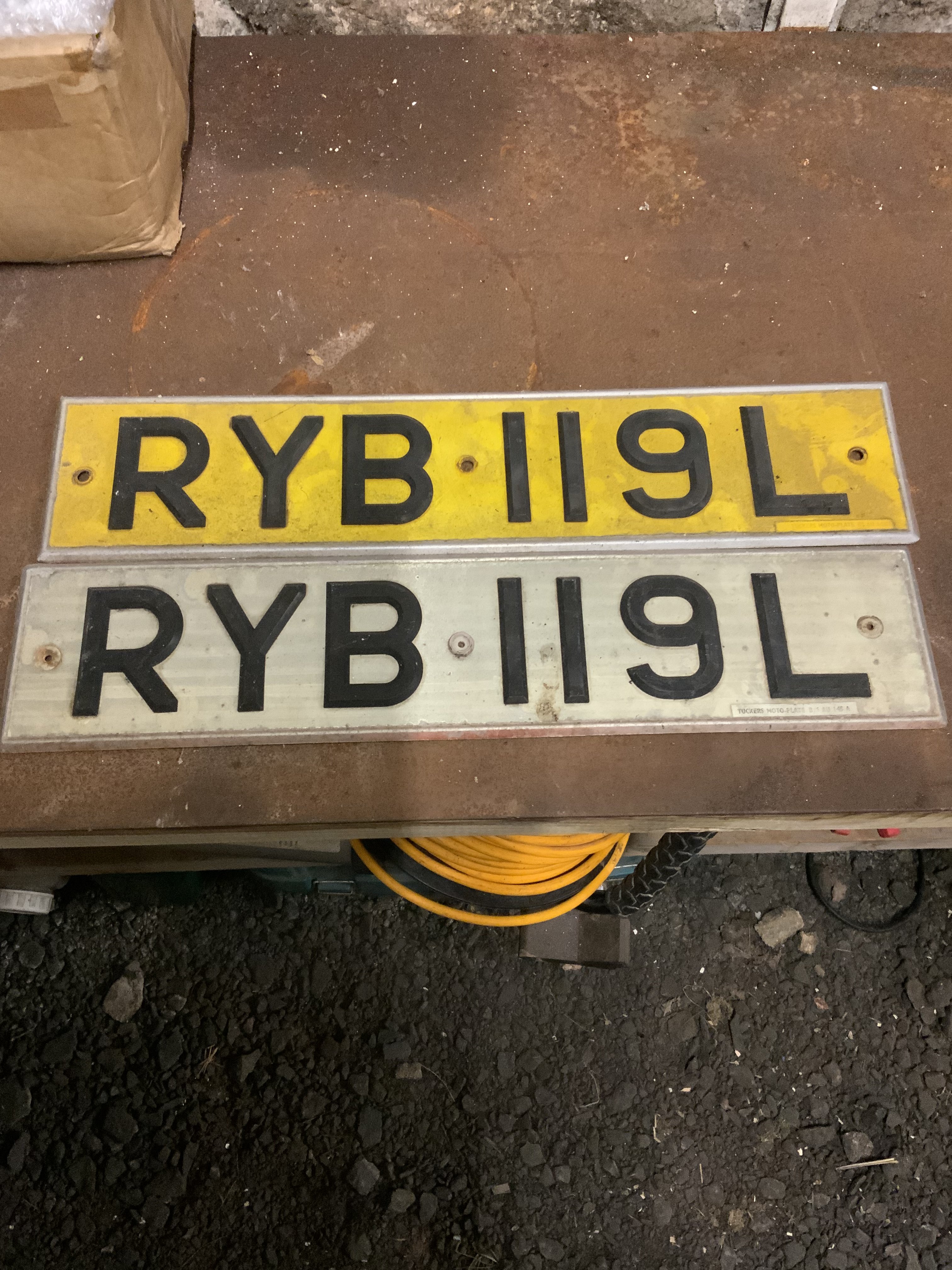

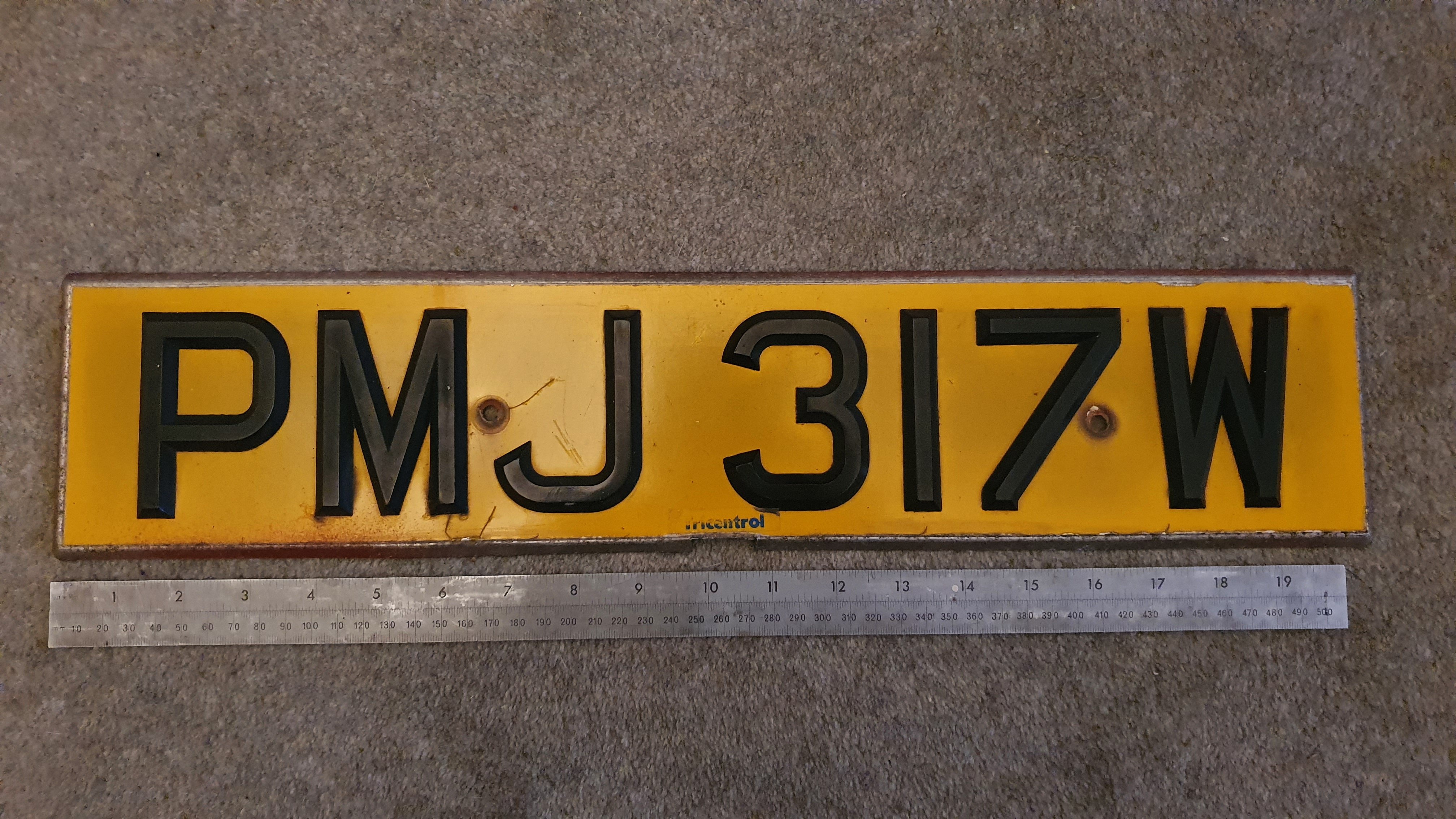

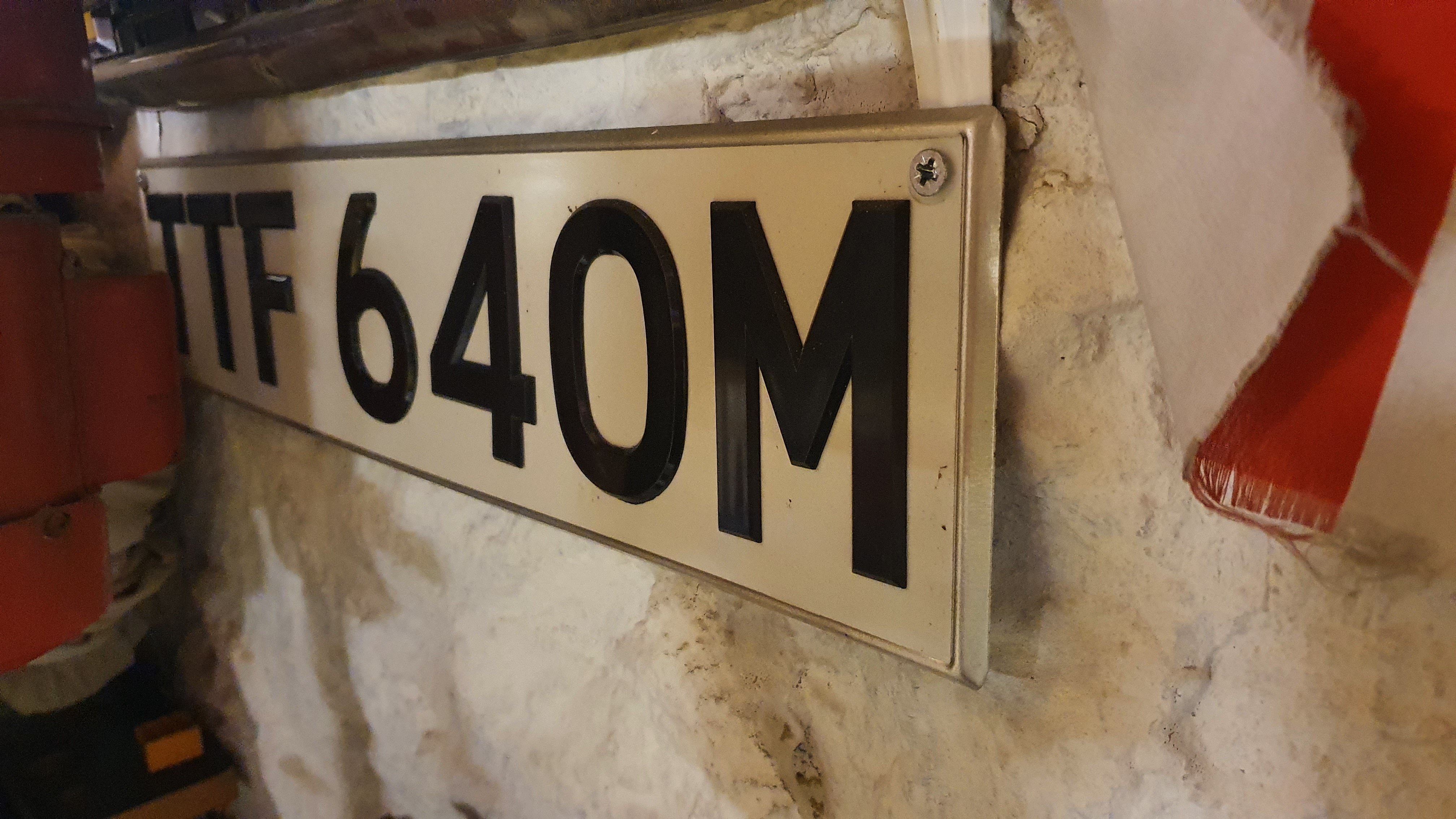

Ray Posted May 19, 2022 Report Posted May 19, 2022 this is a Tippers 70 style, i only use these till i get the proper thing done these are what i have made and this is an original Hills plate 1

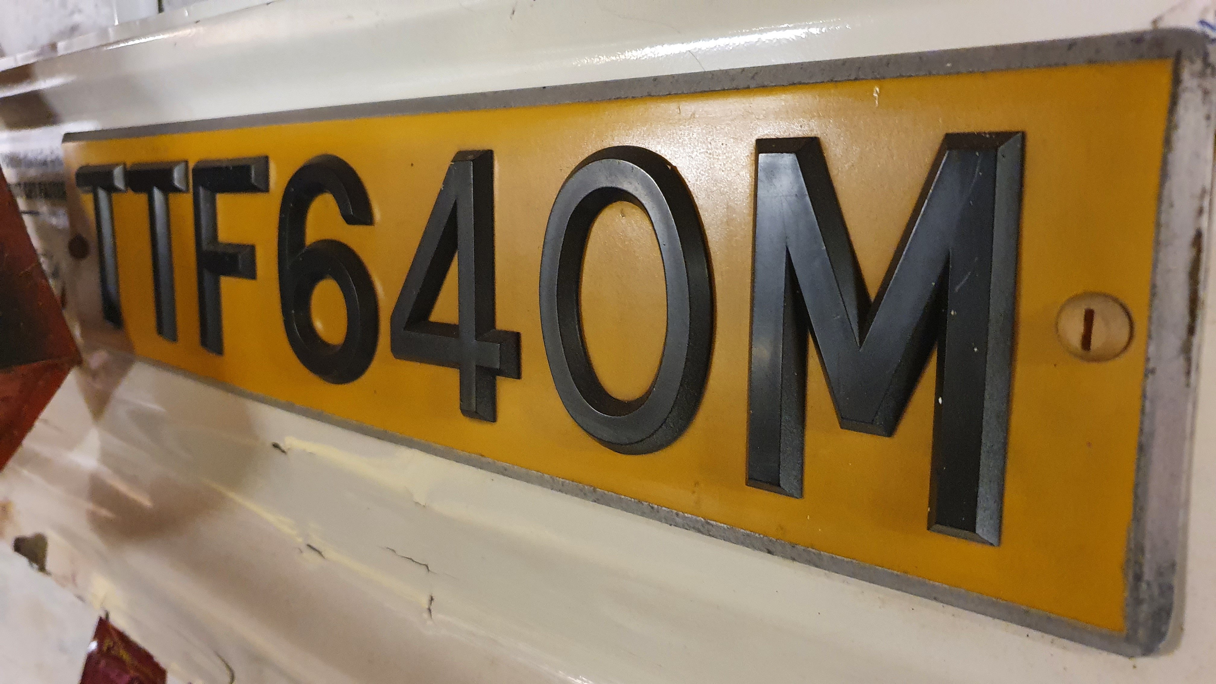

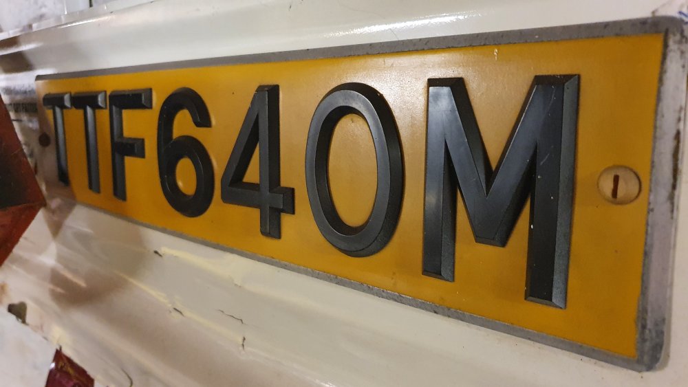

OSF Contributor Mexican Gerbil Posted May 19, 2022 Author OSF Contributor Report Posted May 19, 2022 I had this front one made up for my old white escort but it wasn't tippers and I've got no idea who made it. But it doesn't matter coz it too has the wrong font. Yellow one is the one that came with the car but pretty sure it's not the original.
