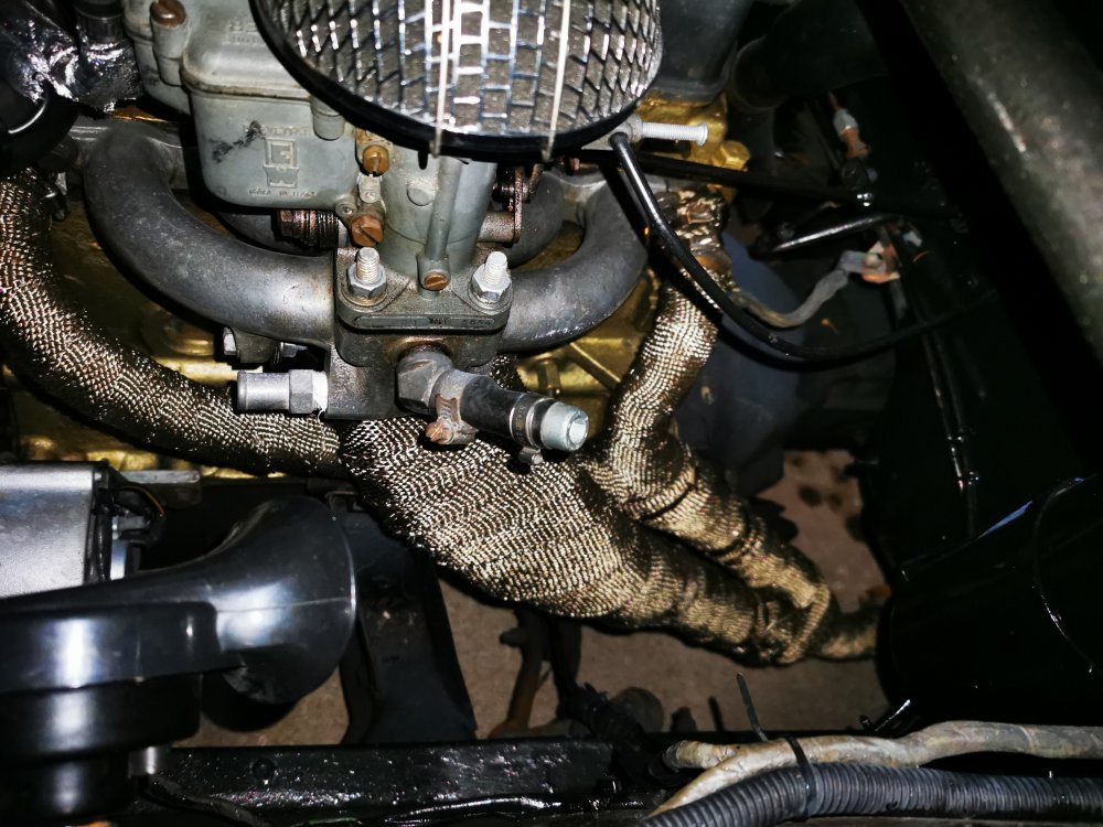

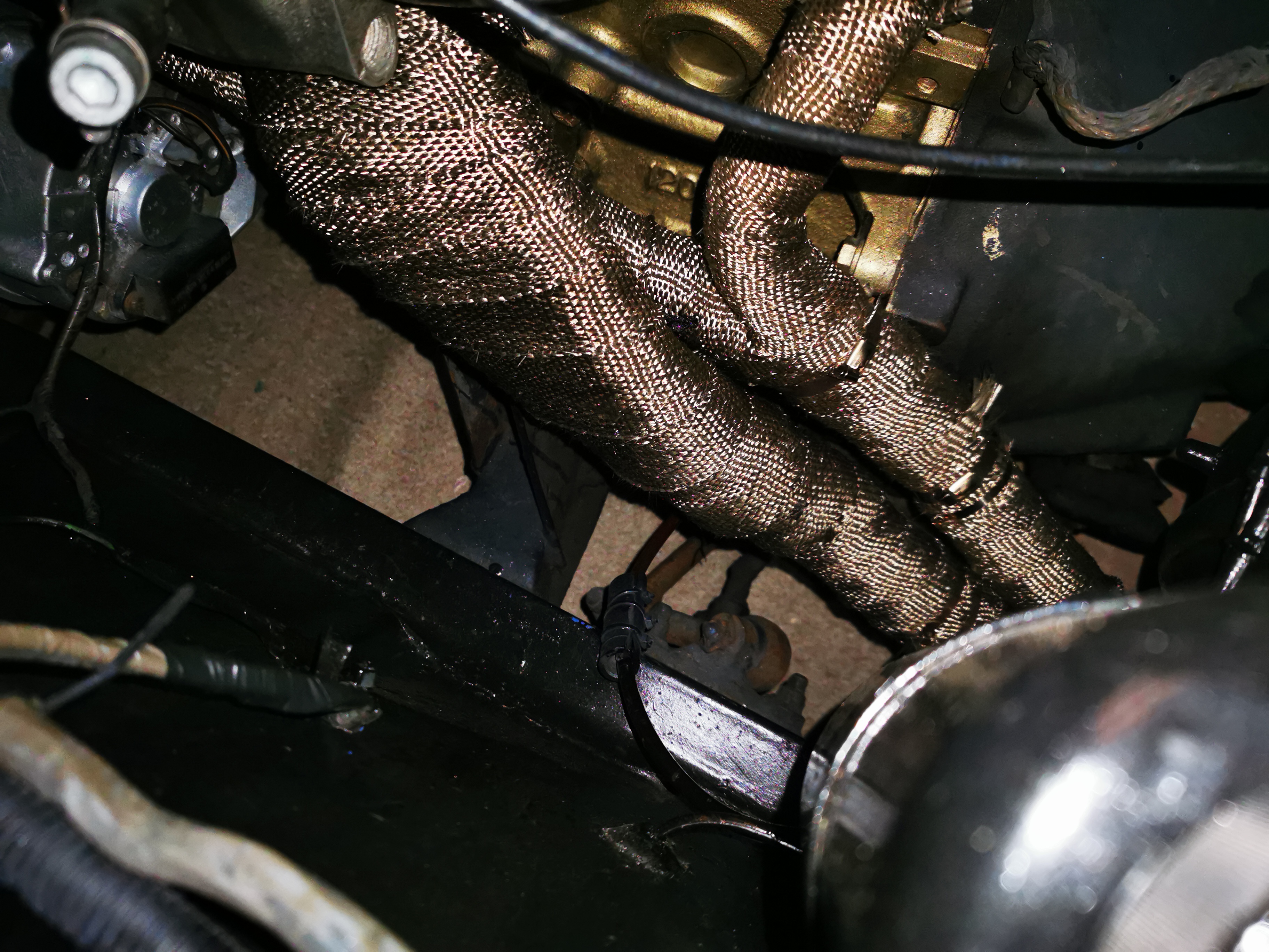

chinkamon Posted July 21, 2022 Report Posted July 21, 2022 10 hours ago, BaileyMex said: Cheers both Gordy, do you remember how many metres you used to wrap a typical 4 branch? Miniliteman, yeah I'd heard about getting them wet, certainly something to bear in mind 👍 I bought 5cm x 15m titanium wrap which done my 4 branch (precrossflow GT) manifold nicely still had a fair bit left over. I've used it on many of my car's over the years never had any issues yet. Since found locking wire is a neater way to fasten it rather than the metal ties unless you have the correct tool
chinkamon Posted July 21, 2022 Report Posted July 21, 2022 It wrapped all of that, down to about 2 foot under the car ( I got bored then)

BaileyMex Posted July 22, 2022 Author Report Posted July 22, 2022 11 hours ago, chinkamon said: I bought 5cm x 15m titanium wrap which done my 4 branch (precrossflow GT) manifold nicely still had a fair bit left over. I've used it on many of my car's over the years never had any issues yet. Since found locking wire is a neater way to fasten it rather than the metal ties unless you have the correct tool Cheers mate, any pics of it finished?

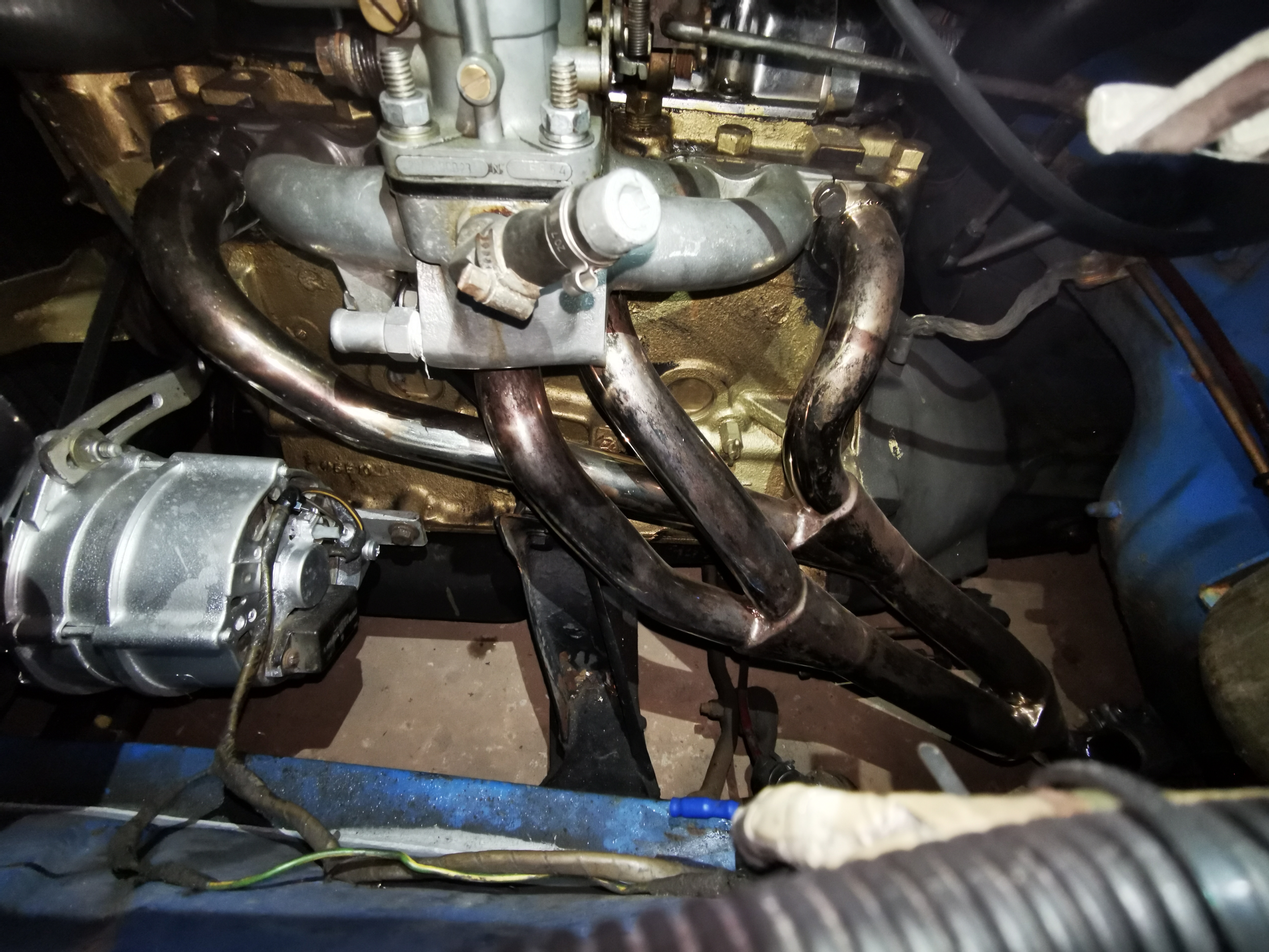

piekey Posted July 22, 2022 Report Posted July 22, 2022 We tried 2 different makes of wrap on a 4 into 1 pre x flow manifold, after both makes broke up & fell off. We had manifold blasted & coated just outside Horsham Hi-speccoatings.co.uk Wesley is the very he.pful guy to talk to. 0203002 0067 Not only does it look the nutz it has cut down under bonnet temps by loads. Also no corrosion. 1
chinkamon Posted July 23, 2022 Report Posted July 23, 2022 On 22/07/2022 at 08:50, BaileyMex said: Cheers mate, any pics of it finished? I haven't unfortunately I'll try an get one Sunday night as not near the car til then 1
chinkamon Posted July 24, 2022 Report Posted July 24, 2022 On 22/07/2022 at 08:50, BaileyMex said: Cheers mate, any pics of it finished? Not the best photos sorry, but not the best job either, I wrapped the two middle pipes as one as was an ass to do in place, leaning over the wing with my legs in the air ( I'm only short) Didn't want to try my luck removing the manifold as the bolts are bound to snap on me an there wouldn't be enough swear words in the world to help me through that 🤣
BaileyMex Posted July 25, 2022 Author Report Posted July 25, 2022 Nice one mate, looks tidy enough from those pics 👍 1
