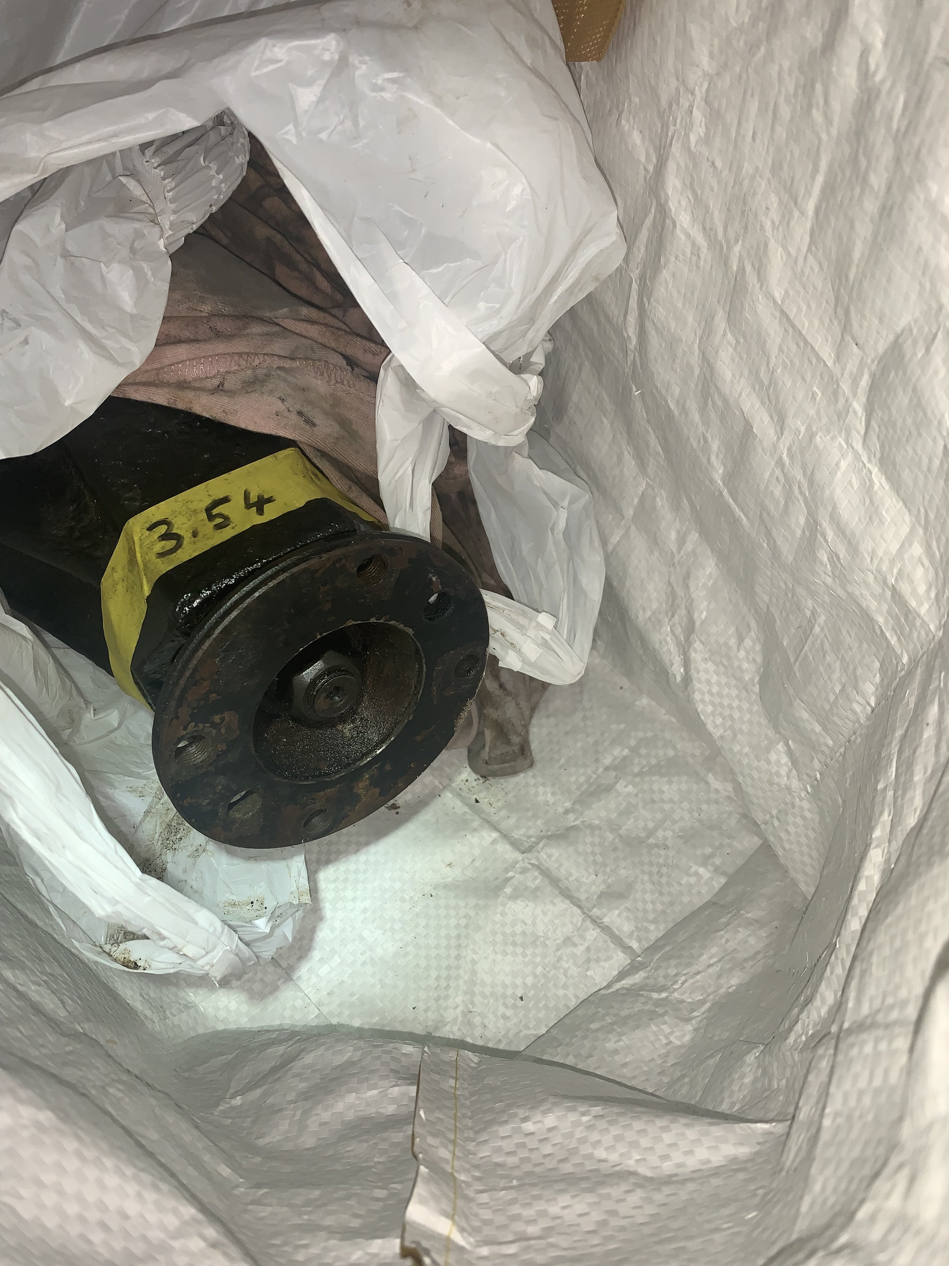

Dave Knight Posted September 18, 2023 Author Report Posted September 18, 2023 It’s an SA Borg Warner axle and one piece prop. I’ve got a 3.54 diff for the Timken axle. Can get a a pic of the diff.

Dave Knight Posted September 18, 2023 Author Report Posted September 18, 2023 1 hour ago, eeb43 said: what gearbox? what flange is on the diff?

Ray Posted September 25, 2023 Report Posted September 25, 2023 that diff picture is the large flange, can see that by the threads, thats usually associated with the split 2 piece prop, and uses fine thread metric small head bolts and spring washers to secure the prop, theres a place at heathrow that balances them if needed, the 2 piece as std should slot straight into a type 2 box, if your car has the centre mount bracket, then thats your simplest and cheapest option, as the props can be found at places like GS or escort tec, if you dont have the mount bracket, these can normally also be sourced, as its the one part magnum dont fit to their new floors, iirc, it also houses the nuts for the seat belt stalks the mexico used a smaller flange on the diff, this uses nuts and bolts, not just bolts to mount the diff, and uses a sigle piece prop but the gearboxes differ, so i would think possibly the front end where it goes into the box may differ by keeping it a std 2 piece, it will keep your costs down, as a std single piece prop wont mount to that diff without either alteration to the prop, or changing the flange on the diff, and the gearbox end would also still be an unknown area till you have a prop to try 1

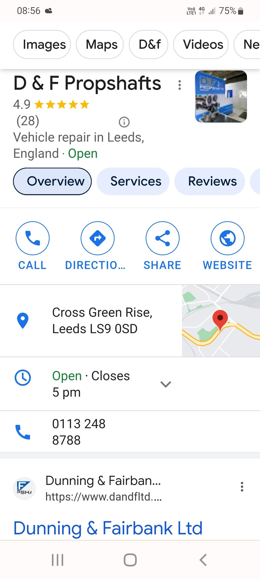

Vista Estate Posted September 26, 2023 Report Posted September 26, 2023 Hi Dave, I got a one piece through GS Escorts which actually came from D & F Propshafts in Leeds. They just needed flange size, gearbox type and distance between gearbox tail and diff flange. Give them a call.
