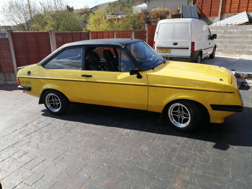

DT36 Posted November 25, 2021 Report Posted November 25, 2021 (edited) Top row of top pic is a 2" drop, bottom row is a 1" drop, both on the same 13" minilight rims. Car drives nicer at 1" and don't scrape exhaust so much now on speed bumps. The other pic is as it is now with 4 spoke 13" rims and at 1" drop. Edited November 25, 2021 by dt36 1
katana Posted November 25, 2021 Report Posted November 25, 2021 A 2" drop plus the 50 profile tyres is a particular 'look' generally termed the 'South London' look and in my opinion a bit extreme for our current pot holed and speed bump infested roads and scraped undercarriage is virtually guaranteed. The std profile tyres with alloys would have been 175/70's with 205/60's being preferred on the 7 and 7.5" rims. Any significant drop usually requires rolled arches as rubbing will occur. Personally I prefer a max 1" drop paired with 60 profiles - 185/60 in my case, looks ok and rides bumps better IMO! 2

CryptoWesty Posted November 27, 2021 Author Report Posted November 27, 2021 On 25/11/2021 at 21:07, dt36 said: Top row of top pic is a 2" drop, bottom row is a 1" drop, both on the same 13" minilight rims. Car drives nicer at 1" and don't scrape exhaust so much now on speed bumps. The other pic is as it is now with 4 spoke 13" rims and at 1" drop. Thankyou so much for this! I was debating wether to not raise it to 1 inch drop but now looking at yours I think it still looks great! what tyre profiles you running? thanks!

DT36 Posted November 27, 2021 Report Posted November 27, 2021 (edited) 8 hours ago, CryptoWesty said: Thankyou so much for this! I was debating wether to not raise it to 1 inch drop but now looking at yours I think it still looks great! what tyre profiles you running? thanks! 175/60/13 https://www.ebay.co.uk/itm/2-x-175-60-13-77H-Yokohama-A539-Performance-Car-Tyres-1756013-/142483075817?mkcid=16&mkevt=1&_trksid=p2349624.m46890.l49286&mkrid=710-127635-2958-0 Edited November 27, 2021 by dt36 1
CryptoWesty Posted November 27, 2021 Author Report Posted November 27, 2021 (edited) 14 minutes ago, dt36 said: 175/60/13 https://www.ebay.co.uk/itm/2-x-175-60-13-77H-Yokohama-A539-Performance-Car-Tyres-1756013-/142483075817?mkcid=16&mkevt=1&_trksid=p2349624.m46890.l49286&mkrid=710-127635-2958-0 Cheers mate! You have solved my problems! what’s the handling like? With the tyres less stretched would that mean the handling isn’t as good? It feels like it’s on rails at the moment have you ever tried the 185/60 ? what’s cruising like in terms of revs with your tyres? Does it feel like it needs another gear at 70? Edited November 27, 2021 by CryptoWesty

DT36 Posted November 27, 2021 Report Posted November 27, 2021 (edited) 1 hour ago, CryptoWesty said: Cheers mate! You have solved my problems! what’s the handling like? With the tyres less stretched would that mean the handling isn’t as good? It feels like it’s on rails at the moment have you ever tried the 185/60 ? what’s cruising like in terms of revs with your tyres? Does it feel like it needs another gear at 70? I messed up. Mine are actually 185s 😂 I had those in my watching in ebay, ready for when I get another 4 spoke rim for a spare. My car handles way better now since I raised my suspension. However, I did a few other suspension swaps on the rear at the same time, because my car was too harsh and firm. I think my best choice was taking the Bilstien shocks off and fitting adjustable AVOs. Bit of a read for you: Edited November 27, 2021 by dt36

Nige65 Posted September 29, 2022 Report Posted September 29, 2022 On 25/11/2021 at 21:07, DT36 said: Top row of top pic is a 2" drop, bottom row is a 1" drop, both on the same 13" minilight rims. Car drives nicer at 1" and don't scrape exhaust so much now on speed bumps. The other pic is as it is now with 4 spoke 13" rims and at 1" drop. Is that a 1" drop with 185/60's on 7" rims in the bottom picture? 1
DT36 Posted September 29, 2022 Report Posted September 29, 2022 Yes, the 4 spoke picture are 185/60/13. 7" wide rims. 1" lowering block on single leaf, normal curve. Shocks are AVO adjustable. Much better ride than when it was a 2" lowering block.
Nige65 Posted September 30, 2022 Report Posted September 30, 2022 Thanks for the reply The reason I ask is that I contacted JBW and enquired about purchasing a set of 7" Superlites -7ET along with 185/60's, the response was that they could but normally supply those width wheels with 175/50's due them sitting close to the arches so that left me thinking that would 185/60's on 7"s -7ET fit under the arches of a standard or lowered 1" 1600 Sport?
