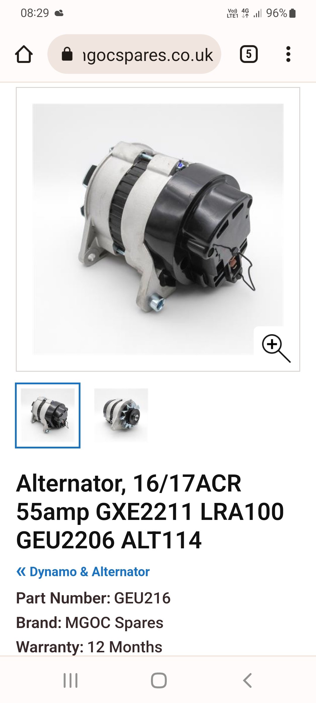

Vista Estate Posted August 9, 2023 Report Posted August 9, 2023 6 hours ago, Rally Pack 2000 said: Now pretty much convinced the new alternator is faulty. Auto electrician agrees. BBClassics is fine to replace it but they dont have any of them left so the choice is the 65amp Chrome Blingy one or a 45amp regular one? If I remember correctly the same alternator is used on an MGB. The mg owners club do an uprated 55amp lucas for around £55. Worth checking. They do deliver to Aus. https://www.mgocspares.co.uk/product/geu216/alternator-16-17acr-55amp-gxe2211-lra100-geu2206-alt114 1
Moderator Rally Pack 2000 Posted August 9, 2023 Author Moderator Report Posted August 9, 2023 7 hours ago, Vista Estate said: If I remember correctly the same alternator is used on an MGB. The mg owners club do an uprated 55amp lucas for around £55. Worth checking. They do deliver to Aus. https://www.mgocspares.co.uk/product/geu216/alternator-16-17acr-55amp-gxe2211-lra100-geu2206-alt114 Thanks for that. I will see if I can get a replacement for the one that I already purchased for I go buying any others. Those seem a good price though. It was the postage originally that made me go with BBClassics, to here it was exceptionally cheap compared to everyone else. 1

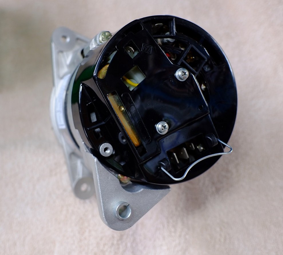

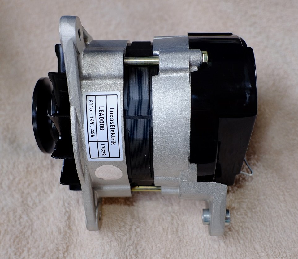

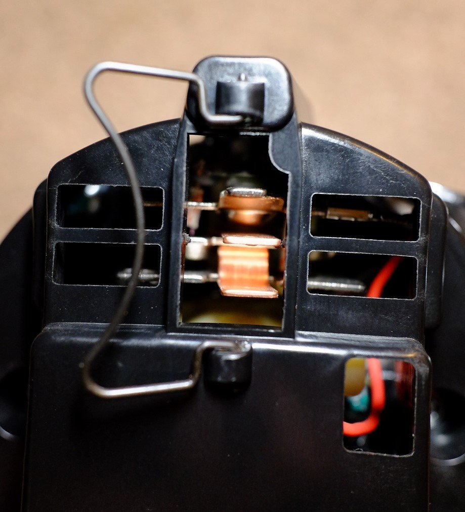

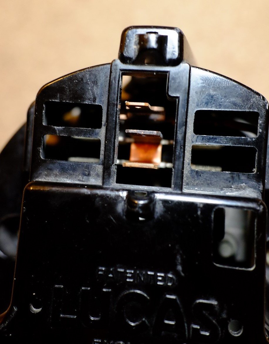

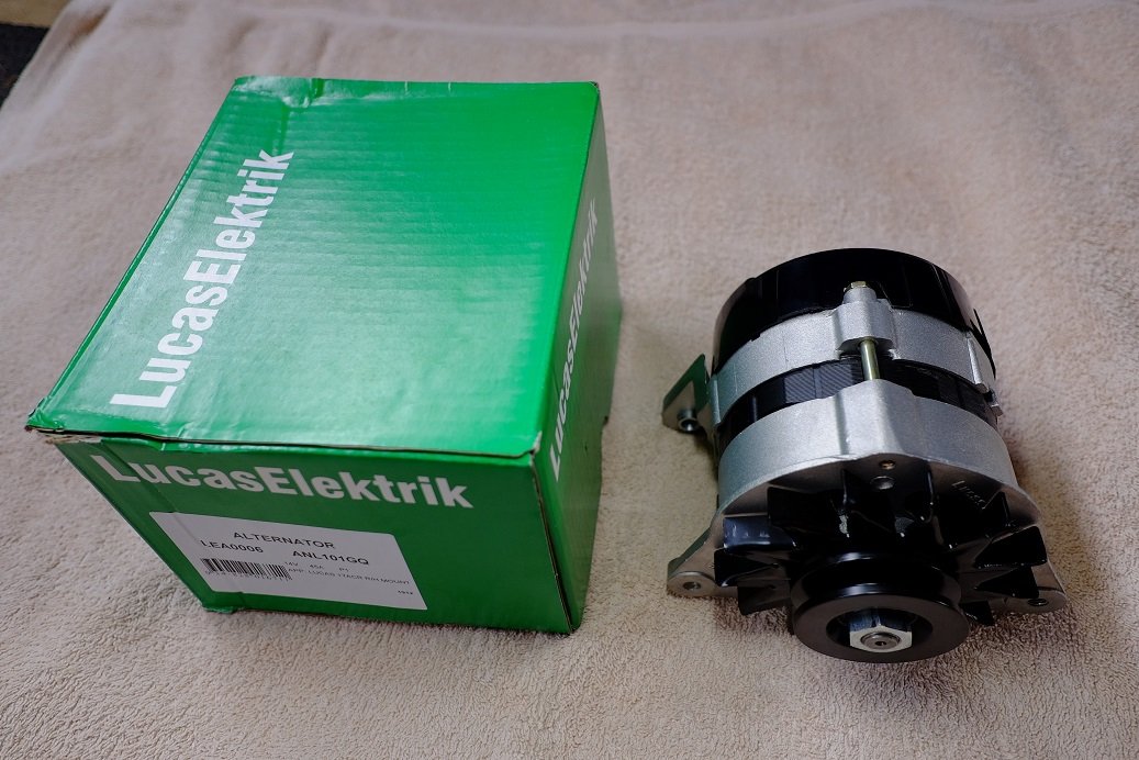

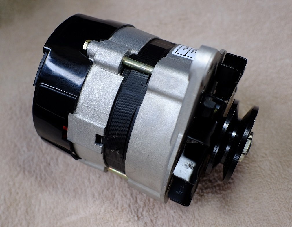

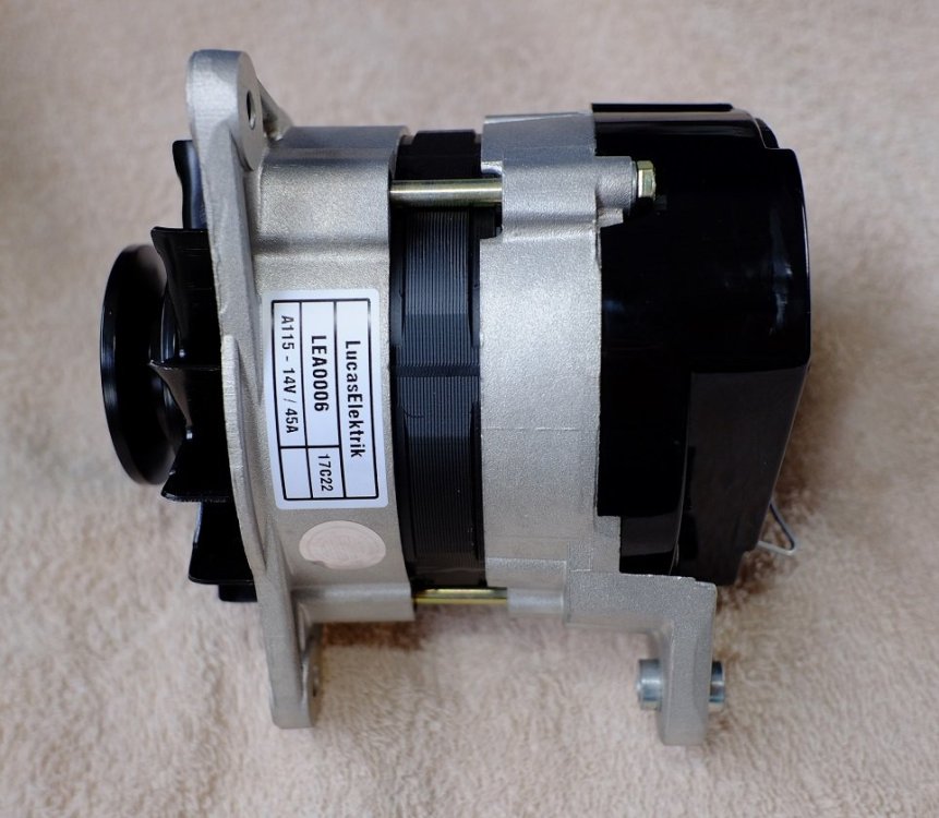

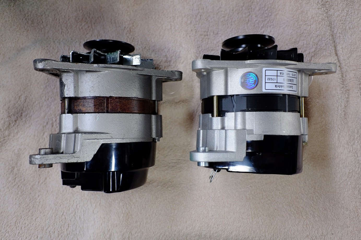

Moderator Rally Pack 2000 Posted August 14, 2023 Author Moderator Report Posted August 14, 2023 Still awaiting the replacement to come from BBClassics but I wasn't sure how long that would take nor am I comfortable with these Chinese replica ones. (Made by WAI Global in Shanghai China). So I stumbled across a Local seller offering an original Lucas 17ACR made by Lucas Electrik Turkey. What was interesting that although the mounting points and standard, Lucas rear plug are the same as older Lucas ACRs this one didn't have that really distinctive rear shape but instead a much shorter rear plastic cover making the unit more compact overall similar to the average Bosch unit. I have never seen one before nor did I even know there was a modern Lucas made 17ACR. Anyone heard or seen one of these before? Interestingly the factor clearly labels this a 17ACR Right Hand Version. But all the sellers of Lucas type alternators would call this a left hand version for Pinto engines. I have always thought this strange to call the Left hand version for cars where it would be mounted on the Right hand side of the car. So someone has been getting it wrong all this time. Complete with hologram authenticity label Same Lucas 3 pin plug with two large pins and one small and holding clip. Two Lucas 17ACR 45amp Alternators Old vs New The regulators and rectifiers in these older Lucas alternators aren't what you would call long wearing or reliable so Im hoping this newer design may address some of those issues of the older type. There does appear a few mm difference in the pulley mounting distance so fingers crossed there is enough flexibility in how these things mount that it still all aligns perfectly. 1
Vista Estate Posted August 14, 2023 Report Posted August 14, 2023 Interesting find. I wonder if they are available in the UK. Probably not with BREXIT. 🤬 Have BB Classics dispatched your replacement. If not ask for a straight refund. Let's hope the Turkish one fits OK. 1
Miniliteman Posted August 14, 2023 Report Posted August 14, 2023 Think LucasElektrik in Turkey isn't a Lucas company, they just use the same font for their products and same green colour. Official Lucas products come from Lucas Automotive. Same thing happened with Bosch; company in Poland or Czech Republic made Bosch-like products using Bosch font and packing but the company name was Bocsh. 1
Moderator Rally Pack 2000 Posted August 14, 2023 Author Moderator Report Posted August 14, 2023 4 hours ago, Miniliteman said: Think LucasElektrik in Turkey isn't a Lucas company, they just use the same font for their products and same green colour. Official Lucas products come from Lucas Automotive. Same thing happened with Bosch; company in Poland or Czech Republic made Bosch-like products using Bosch font and packing but the company name was Bocsh. It says that its trademarked from Lucas Industries UK on the box and the hologram authenticity sticker on the unit. So presumably they bought the rights as you say to make their own 17ACRs. But the casting quality appears finer than the original British Lucas one and has to be better than the Chinese one. Where the Chinese ones seem direct copies of the classic English ones even down to their not so favourable regulator and rectifier designs these Lucas approved Turkish ones seem to incorporate more modern internals. Hopefully that will translate to a long term reliable unit for RP2000, fingers crossed. 1

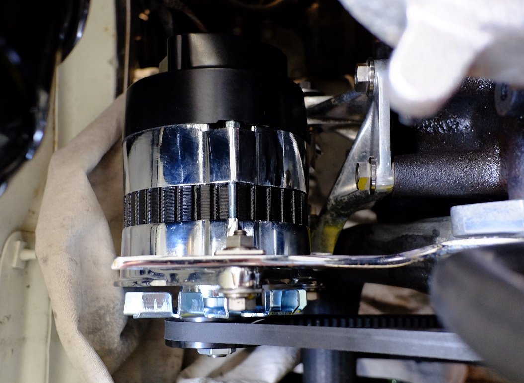

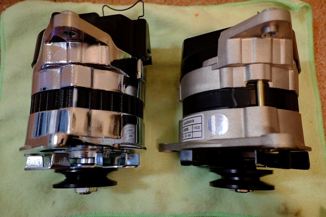

Moderator Rally Pack 2000 Posted August 14, 2023 Author Moderator Report Posted August 14, 2023 Well I wasn't expecting that but the replacement from BBClassics arrived today just one day more than it took for the Lucas Elektrik one to arrive from the same state. All they had left were the Chrome Blingy ones. Its stand out over a regular one thats for sure. But once in place deep down I dont think it would be as "Street Machine" like as I was worried about. So Which one should I fit then? Poll? lol Now while the first unit from BBClassics was faulty the friendly and extremely fast way to get me a replacement sent was pretty exceptional so it is a seller I would gladly deal with again. these replica alternators all come from the same source really and everyone here has has no trouble with them so I take them at their word that this type of event was just an unlucky one. But their response to the problem was as good as you could hope.
Vista Estate Posted August 15, 2023 Report Posted August 15, 2023 8 hours ago, Rally Pack 2000 said: Well I wasn't expecting that but the replacement from BBClassics arrived today just one day more than it took for the Lucas Elektrik one to arrive from the same state. All they had left were the Chrome Blingy ones. Its stand out over a regular one thats for sure. But once in place deep down I dont think it would be as "Street Machine" like as I was worried about. So Which one should I fit then? Poll? lol Now while the first unit from BBClassics was faulty the friendly and extremely fast way to get me a replacement sent was pretty exceptional so it is a seller I would gladly deal with again. these replica alternators all come from the same source really and everyone here has has no trouble with them so I take them at their word that this type of event was just an unlucky one. But their response to the problem was as good as you could hope. I would try the Turkish one as its more compact and you could be the guinea pig for us all 🤣🤣. If that's ok you could then move the bb one on. 1
katana Posted August 15, 2023 Report Posted August 15, 2023 just looking at the comparison the quality difference is clear - just look at the pulley profiles - bumpy lumpy chinky or smooth straight taper with the turk, same with the fans ! Likely they'll both work but maybe for longevity,Jthe Turk gets my vote! 1
Miniliteman Posted August 15, 2023 Report Posted August 15, 2023 Difficult to see from just one photo but agree with katana. Unless the offset of the fanbelt-pulley is too big. 1
Moderator Rally Pack 2000 Posted August 15, 2023 Author Moderator Report Posted August 15, 2023 6 hours ago, Vista Estate said: I would try the Turkish one as its more compact and you could be the guinea pig for us all 🤣🤣. If that's ok you could then move the bb one on. 5 hours ago, katana said: just looking at the comparison the quality difference is clear - just look at the pulley profiles - bumpy lumpy chinky or smooth straight taper with the turk, same with the fans ! Likely they'll both work but maybe for longevity,Jthe Turk gets my vote! 3 hours ago, Miniliteman said: Difficult to see from just one photo but agree with katana. Unless the offset of the fanbelt-pulley is too big. Well as fate would have it while the Turkish one got the vote it appears your views on quality just by one photo were totally correct and it won by default anyways. On close inspection, (Lucky I didnt fit it first before plugging it in) the Chinese Chrome one has its rectifier totally out of alignment that the pins are shifted so far to one side that you could never get the Lucas plug in it. I dare say it could be disassembled and centred but it really shouldn't be necessary and I bet most wouldn't even spot the issue till they had installed it and wondered why the plug wasn't going in. I know some often see me gripe on here about the quality of Chinese stuff and think im overly pedantic even bigoted about their manufacturing standards but this is why I constantly harp on about it. Both alternators faulty out of the box. Original Lucas Unit that came out of the car. Chinese Chrome Unit Lets hope the Turkish Unit fits without issue. As Miniliteman says there is a slight pulley length difference but Im hoping that the rear mounting collet on these type of alternators can be shifted one way or other to compensate.

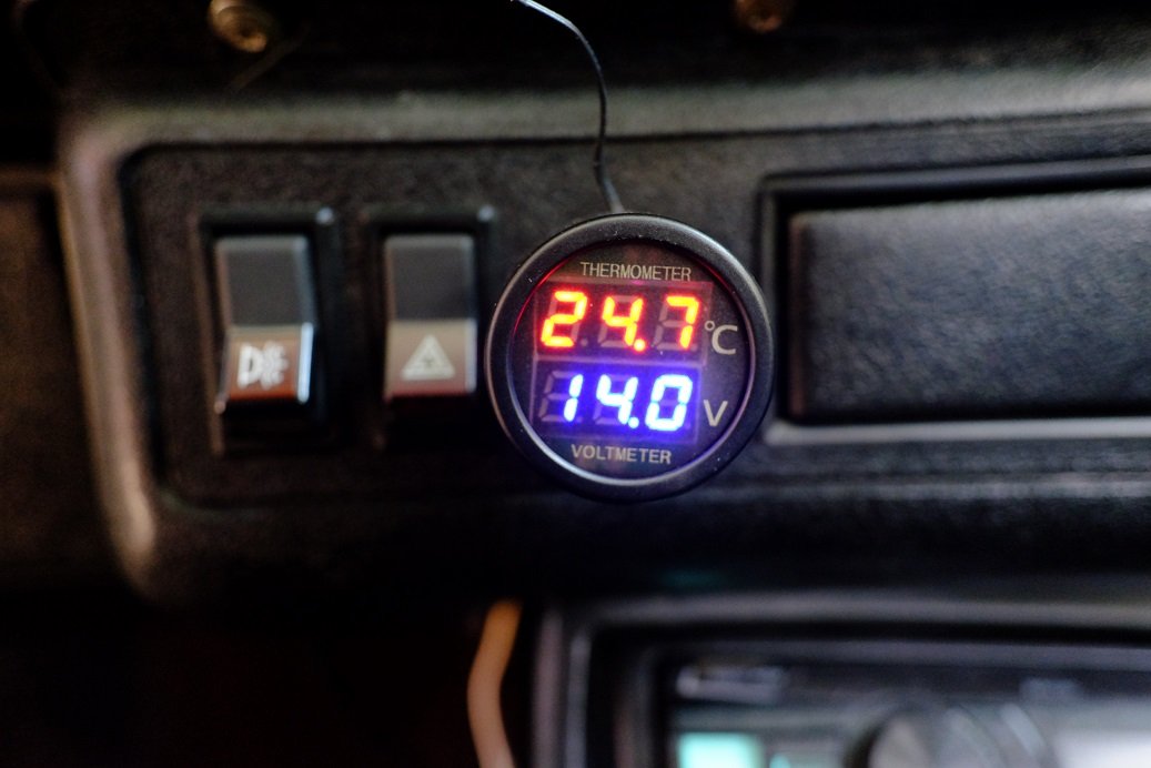

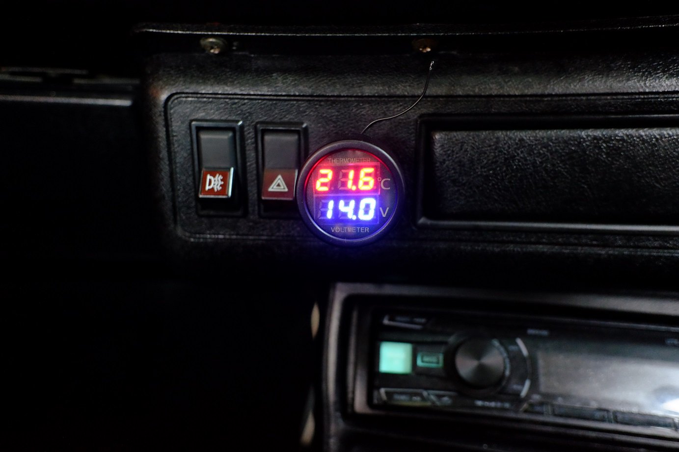

Moderator Rally Pack 2000 Posted August 22, 2023 Author Moderator Report Posted August 22, 2023 Took the cover off the replacement shiny replica alternator and the rectifier had just been installed crooked so unbolted it and straightened it up. Then thought it was pointless to put it back in its box without testing it so popped it in the car and started it up. Having only ever used my little voltage monitor on faulty units I didn't realise how stable and constant they are supposed to run at 14 Volts! LOL So that was a pleasant surprise but then I thought rather than change it for the 5th time why not just leave it for now and use it and save the good Turkish one for when this one craps out next month. It is a bit too um ....... blingy though, was there ever a Lucas Decal or something on these things in the past that I can possibly cover up some of the chrome? LOL Its a bit chilly here 25 degrees inside the car in Winter while still under cover ....... brrrrrrrr
Vista Estate Posted August 22, 2023 Report Posted August 22, 2023 24 minutes ago, Rally Pack 2000 said: Took the cover off the replacement shiny replica alternator and the rectifier had just been installed crooked so unbolted it and straightened it up. Then thought it was pointless to put it back in its box without testing it so popped it in the car and started it up. Having only ever used my little voltage monitor on faulty units I didn't realise how stable and constant they are supposed to run at 14 Volts! LOL So that was a pleasant surprise but then I thought rather than change it for the 5th time why not just leave it for now and use it and save the good Turkish one for when this one craps out next month. It is a bit too um ....... blingy though, was there ever a Lucas Decal or something on these things in the past that I can possibly cover up some of the chrome? LOL Its a bit chilly here 25 degrees inside the car in Winter while still under cover ....... brrrrrrrr You're making us all jealous with the temperature @Rally Pack 2000. Did they supply you with sunglasses for the alternator 🤣. Now you've got to shine up the rest of the engine bay and the car. 🎆🎆💎 1
Moderator Rally Pack 2000 Posted November 13, 2023 Author Moderator Report Posted November 13, 2023 Ok well my nice new shiny replacement alternator for the first faulty one sh*t itself over the weekend. It started producing 16.5 volts (hope it didn't cook my battery) and the alternator warning like jammed on. I tried to unplug it at the back at the coffee and cars meet and you could feel the rectifier seems to be loose inside. After that coming home it stayed on about 11.5 to 12 volts only. I can see some new old stock UK made rectifiers and regulators, Im going to try get a couple of each and try get these Chinese crappers to do the right thing. If the Chinese cant make a primitive Lucas ACR replica that works it cant bode well for the complete electric cars they are churning out.
