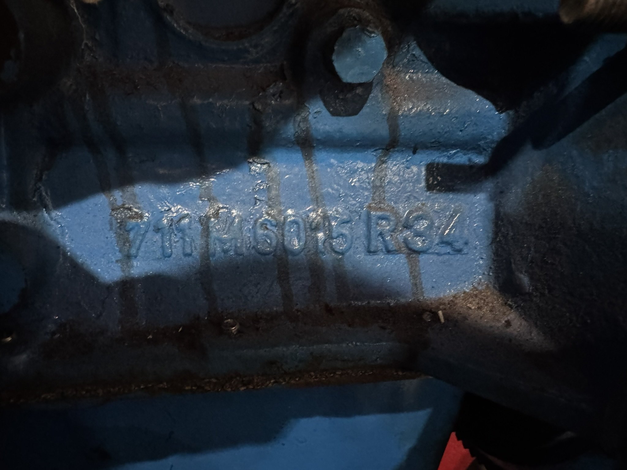

Johnny Boy Posted March 1 Report Posted March 1 On 28/02/2026 at 17:24, Nige65 said: Is their a straight forward way of identifying the AX block? I have a SA Escort 1600 Sport and was intrigued as to whether it had one fitted. My 1980 SA Escort Sport has an AX thick wall block, but its not marked AX ,Its marked 831C 6015R34 with out the AX cast into it. Apparently some 831C blocks don't have AX cast into them as well .

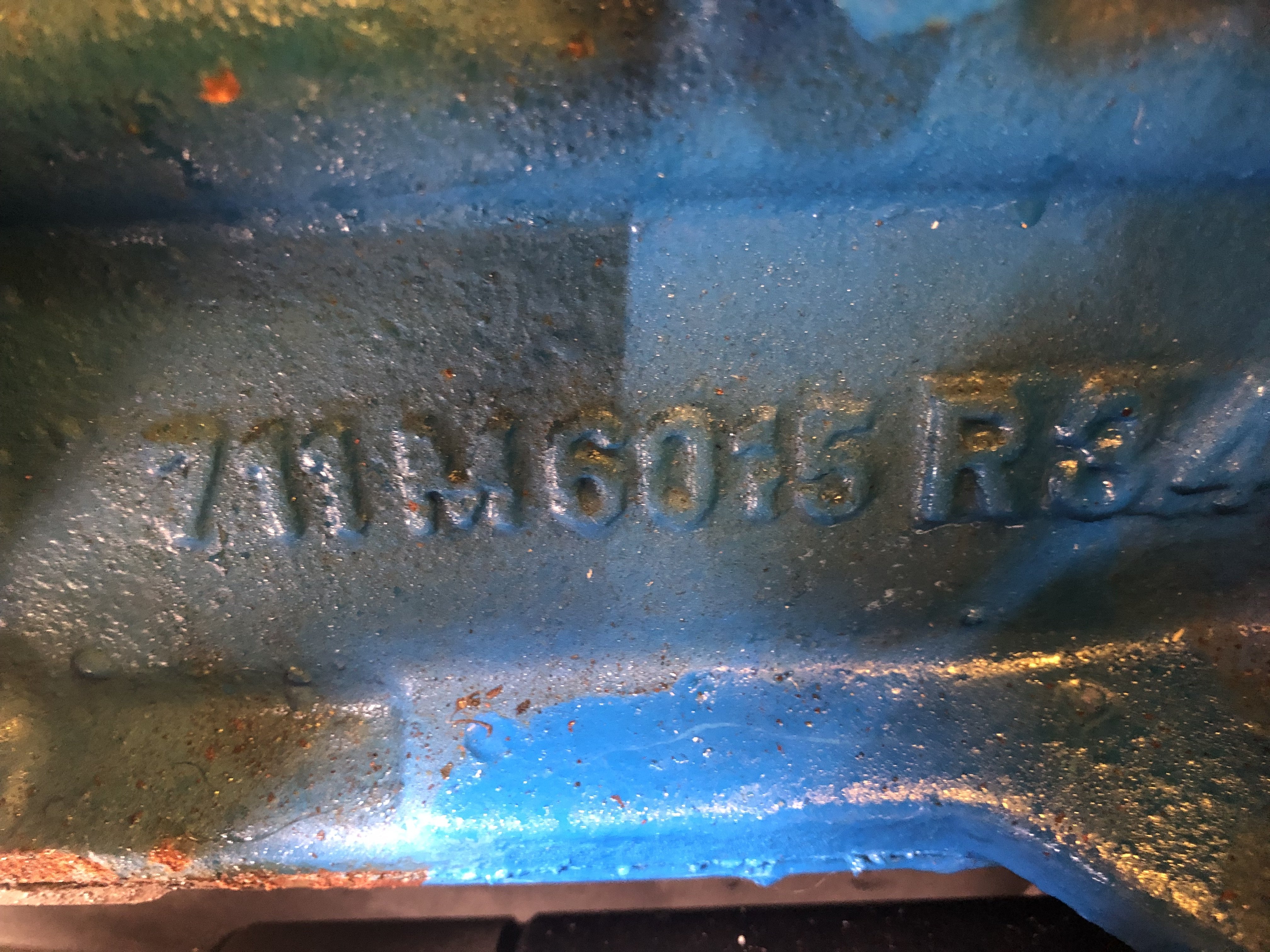

GrahamU Posted March 2 Report Posted March 2 The block from my SA sport has a 711M number but not one I recognise 711M 6015 R34 Anyone know what it is?
