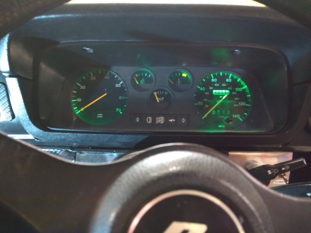

Original RS Oil Pressure Gauge in the Dash is pretty pants.  Mine is disconnected and the pipe has been re-directed to a Gauge fitted where the radio used to sit.  Also have a decent volt meter beside it.
  • Thanks 1
Well that's 3 people condemning the RS dash !! Glad you put that pic up dale as its brought another couple of questions. On the glove box is the panel to the left part of the box or a seperate panel? Plus my sport vynal dash panel has a small corner missing so may replace with the custom clock holder?
They do look pretty good there is no denying that, although sport ones aren't that much different give the two main gauges are identical and interchangeable with RS ones. I even have a set myself but bought them before the prices went crazy. If you dont have an RS now though Sport / Ghia instruments are the way to go.

Well I am going to buck the trend and say I like the RS dash over the sport. An oil light doesn't cut it for me, I want to see the needle if it's low not just get a light when it's so low it's a risk.
  • Moderator
When the sun comes up I will take some photos of the different dash options for you. I even have a European RS dash clock like dt36 in storage even though our cars never had it. I experimented converting the clock to LED illumination. Seem to work better than the single bulb original light.
Certainly agree on the gauge front, usually by the time the light comes on the damage is already done! But if they're inaccurate as suggested, no point. Go for normal extra oil gauge of better quality. Just like the look of the RS cluster.
You can still run a T-Piece off the oil pipe going to the dash and tap it off to another PSI gauge. Best of both then.
Green LEDs work really well in an RS Dash.

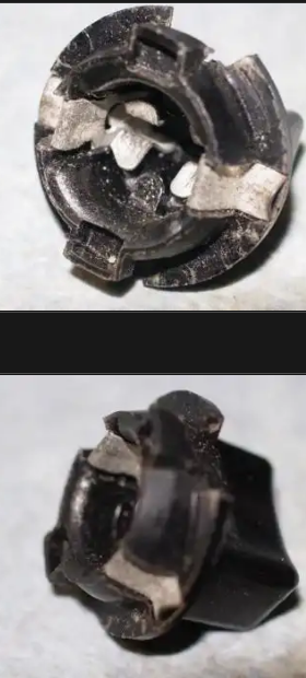

eeb43, have you got one of these bulb holders for the back of a rev counter?   You've got everything else... :-)
