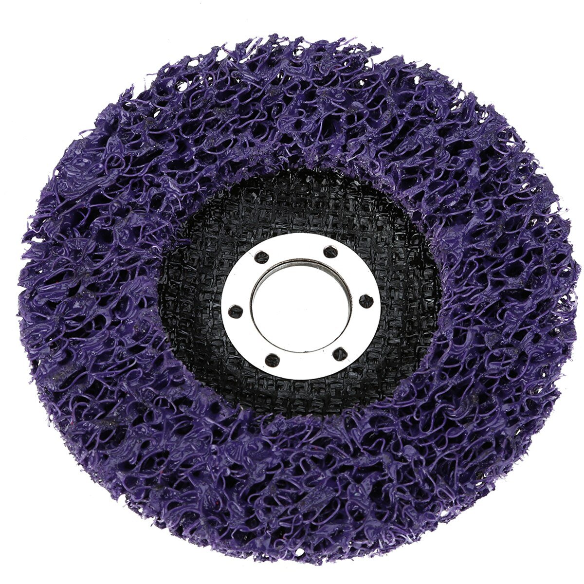

Johnny Boy Posted September 18, 2021 Report Posted September 18, 2021 Is there a reason you want to use a paint stripper ? it's very messy. I stripped my complete car with poly strip wheels, dusty but cleen.

Johnny Boy Posted September 18, 2021 Report Posted September 18, 2021 9 hours ago, Ray said: im going to take a guess that he wants paint stripper, as blasting methods can so easily warp a panel if done incorrectly, and bonnets are particularly at risk of it A poly strip disc is not a blasting method, I guess if you havent used them, you won't know why you wouldn't use anything else for stripping paint rust and filler.
Johnny Boy Posted September 18, 2021 Report Posted September 18, 2021 It takes evey thing off, without dammaging the metal .
Ray Posted September 18, 2021 Report Posted September 18, 2021 this sort of thing, a preparation wheel from screwfix Non-Woven Preparation Wheel 115mm | Cleaning & Preparation | Screwfix.com with these you still have to be careful of heat build up, but ive used them, and yes very dusty

Johnny Boy Posted September 18, 2021 Report Posted September 18, 2021 I used quite a few 4.5 inch ones an an angle grinder to bare metal the car, but they are cheap if you buy 5 at a time, and I used small twist loc ones on a small 75mm angle grinder, and air tool for the hard to get at area, and a wire wheel on a drill, for they very tight areas. 1

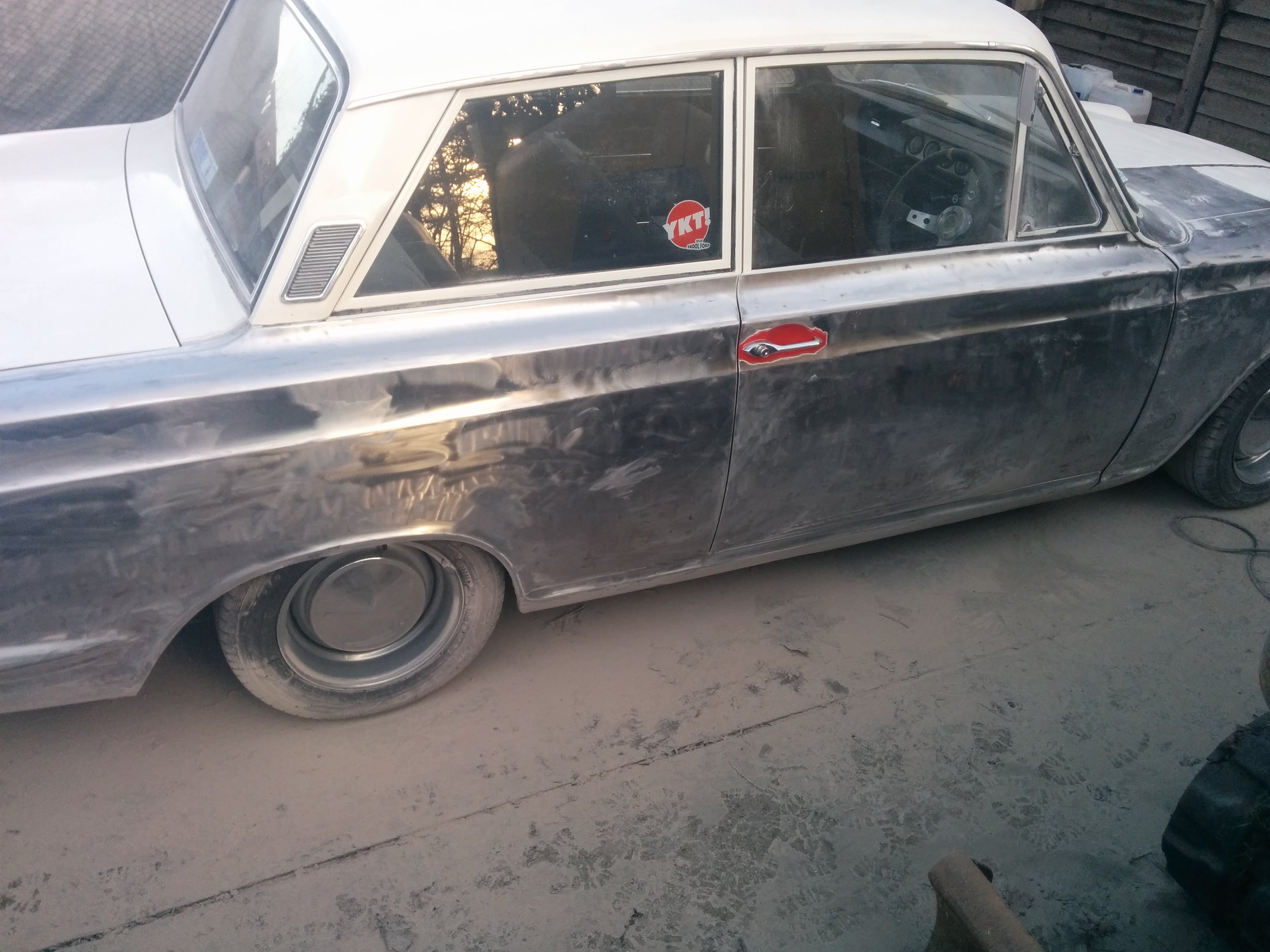

chinkamon Posted September 19, 2021 Report Posted September 19, 2021 15 hours ago, Johnny Boy said: I still like the idea of a bare metal lacquered MK1 😍 must be the hot rodder in me, problem is mine would probably only be 2/3 metal 1/3 filler 😂😂
Johnny Boy Posted September 19, 2021 Report Posted September 19, 2021 6 hours ago, colr6 said: Just ordered a pack of 5 discs, see how it goes. Never know unless you try. The 4.5 inch poly strip discs on a angle grinder worked like magic for me. A lesson learned was to do it outside, as they make a lot of dust.
